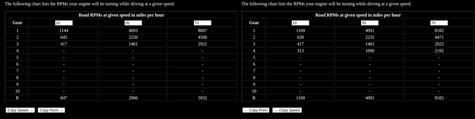

Did you plug in the numbers to grimm jeeper with the gearing you want? Just a quick comparison on 4.10s. Left is the 32RH.

I hadn't gotten that far yet, was kinda wondering why I hadn't read much about it on here. I see that the OD is crazy low in the AW4, are you unable to switch it off like in the 42RE? Because otherwise they seem similarly geared.
