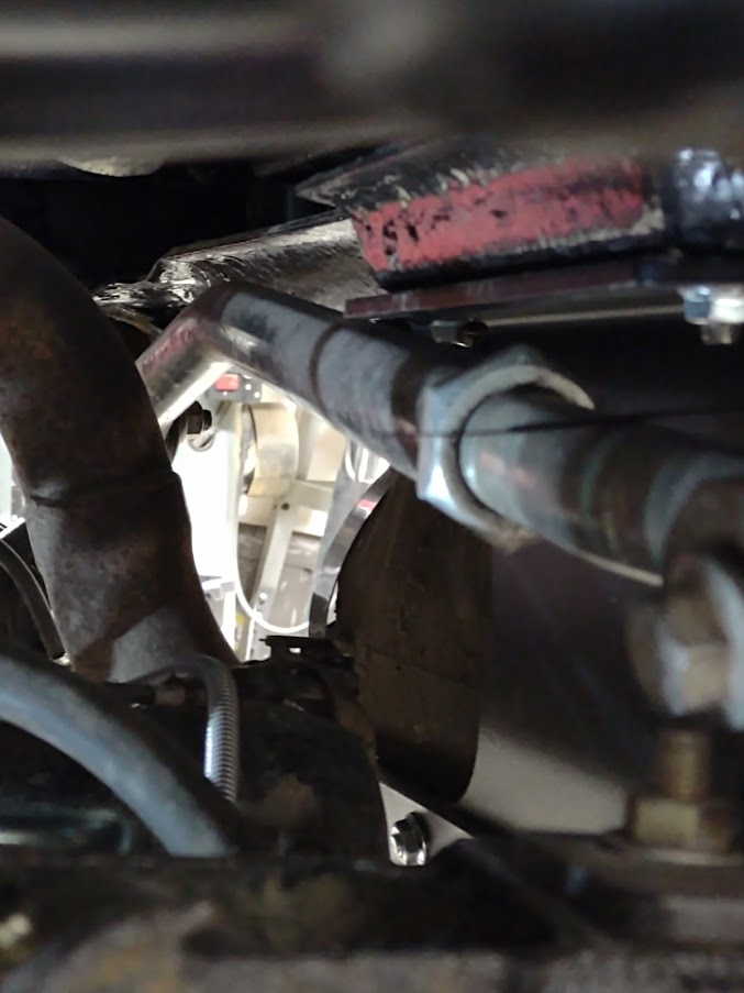

When lifting from the diff it hits the edge of the skid which I could probably trim but lifting from driver side tire (which is probably more realistic to happen off-road) it hits the bolt and nut
AngledView attachment 321892
If you turned the bolt around so that the head of the bolt was facing the skid would it it clear then? And maybe use a button head bolt?
Reactions: lBasket
I'm not exactly sure how that bolt is mounted into the crossmember. I'll try to look at it closer tomorrow, that is a good idea too. Although I think it'd probably still hit it eventually... this happens with ~3" of exposed shock shaft left on driver side so it's really in the way where the axle is right now

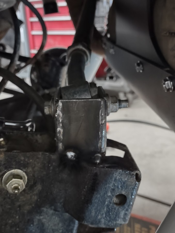

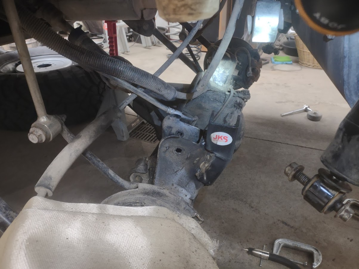

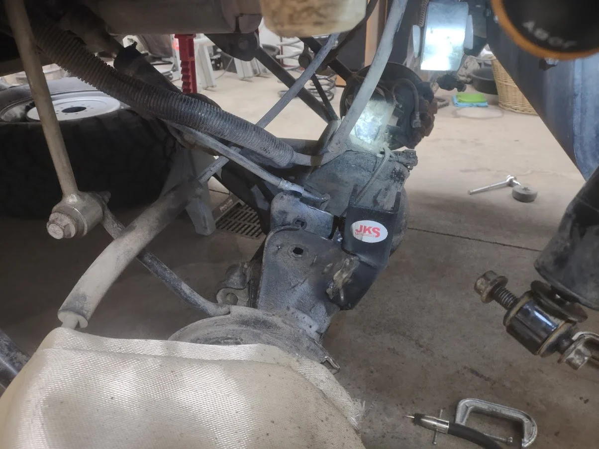

Here is what I was workin with...

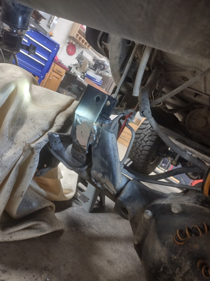

and my solution...because I didn't have a press either...
I've since had to modify this. This picture only shows the bracket tacked in. When I fully welded it, the OEM bracket where the trackbar used to mount is pretty thin and it tore. I basically had to rebuild the whole mount and I used pieces and parts of the JKS angled bracket and a Currie Reinforcement bracket that goes to the axle...
I ended up with plenty of clearance though
Wow good work! I really hope it doesn't come to that lol that is way beyond my skill and equipment level. That's the JKS track bar?

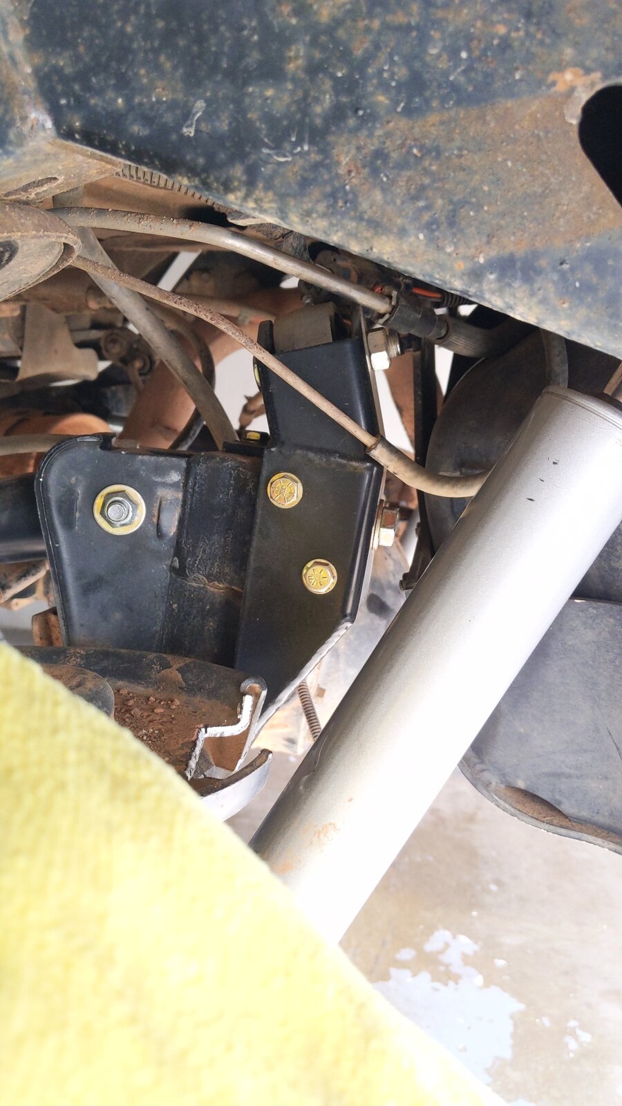

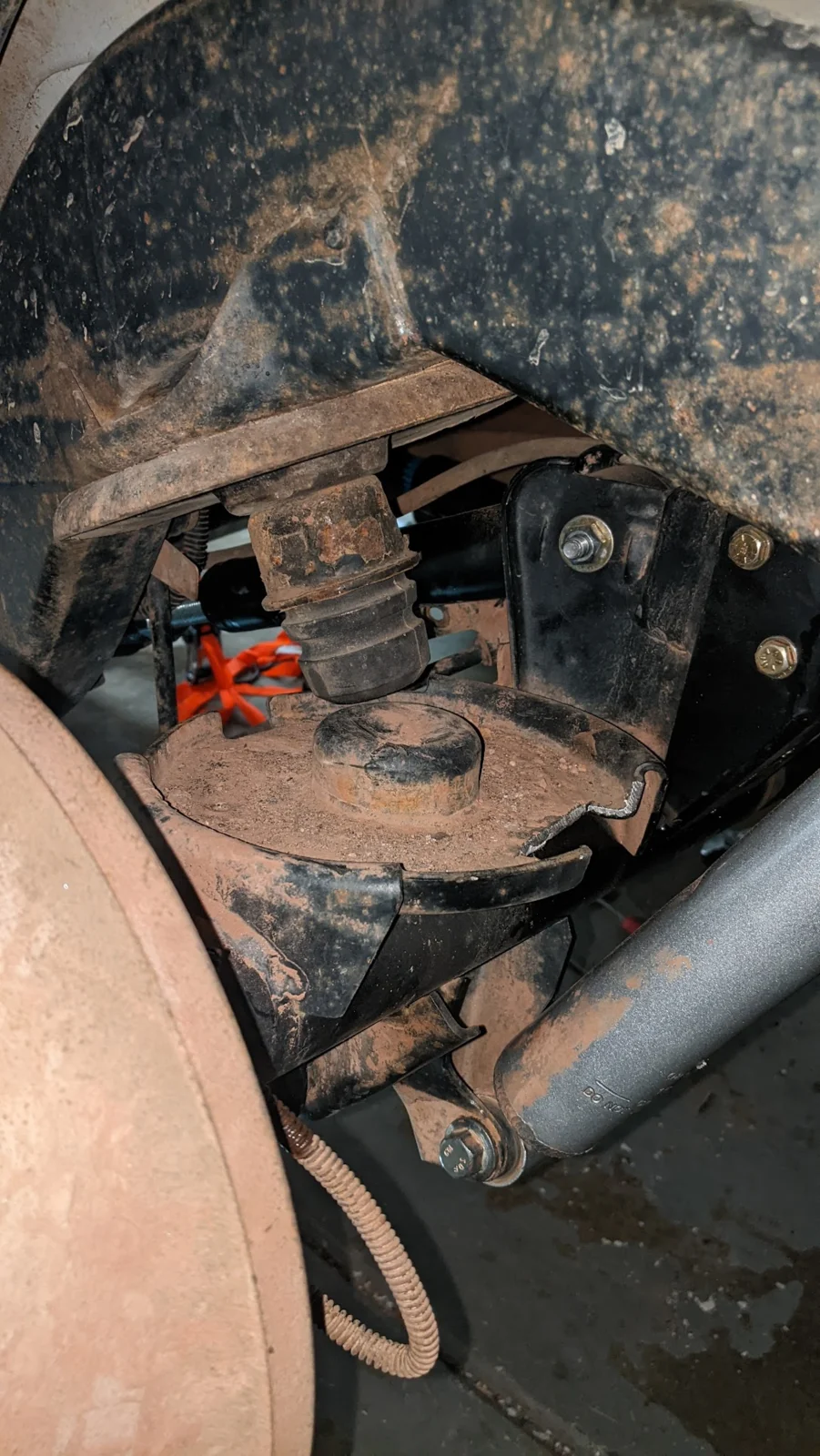

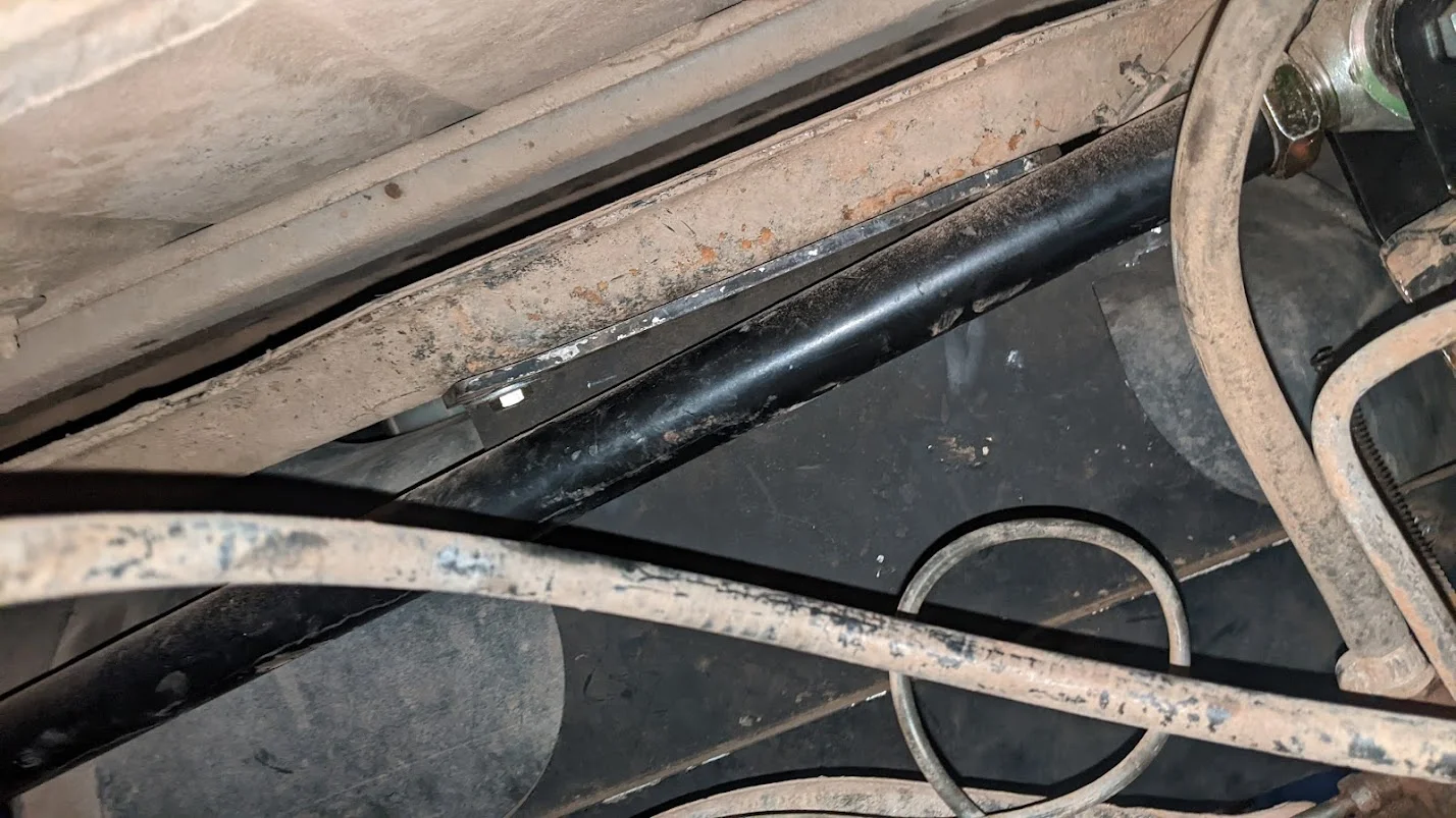

Today I pulled the axle farther forward and also flipped the bolts on the GTS crossmember mount for more clearance. Unfortunately I lost one of the carriage bolts forever inside the crossmember so I used a thin bolt, it has a similar profile to the carriage bolt and I put it where there was less interference. Thanks @jjvw and @Wildman for the tips. Team work makes the dream work!
So here's how it looks at contact now...

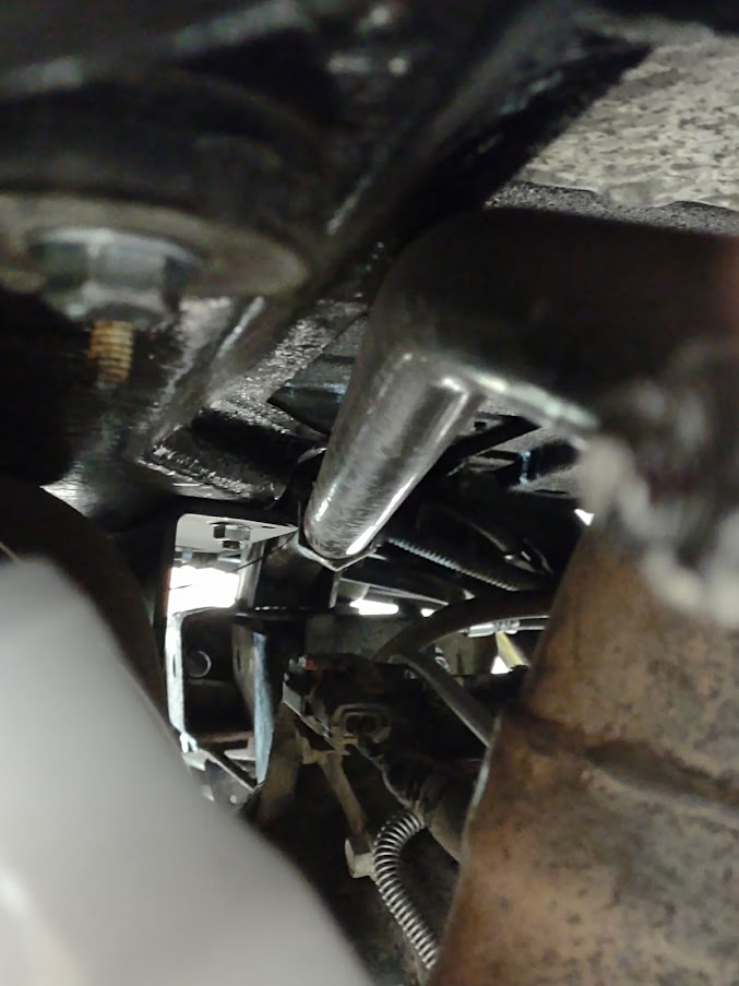

and here's where the axle is (driver's side) when it makes contact:
It's definitely a lot better. I haven't put the tire on yet to see how it all fits together but it's progress.
Some thoughts:
It almost seems like the compressed coil will be somewhere around that distance that's left, I do wonder how much of the remaining travel will even be left at that high of a stuff. Probably doesn't effect where my bumpstop will be though.
On a semi-related note, I've been wondering why I'm coming across these issues. I'm thinking it might be because I have a tummy tuck with only 2" of lift? Maybe a compressed 4" coil doesn't allow the trackbar to go that high?
I also see why outboarding is important more now, the shock really seems to be in a much worse position than the front at the stock position. It really seems like I have a lot of shock uptravel left, but as the axle goes higher it arcs forward so it doesn't really "use up" the distance as well as it does up front
