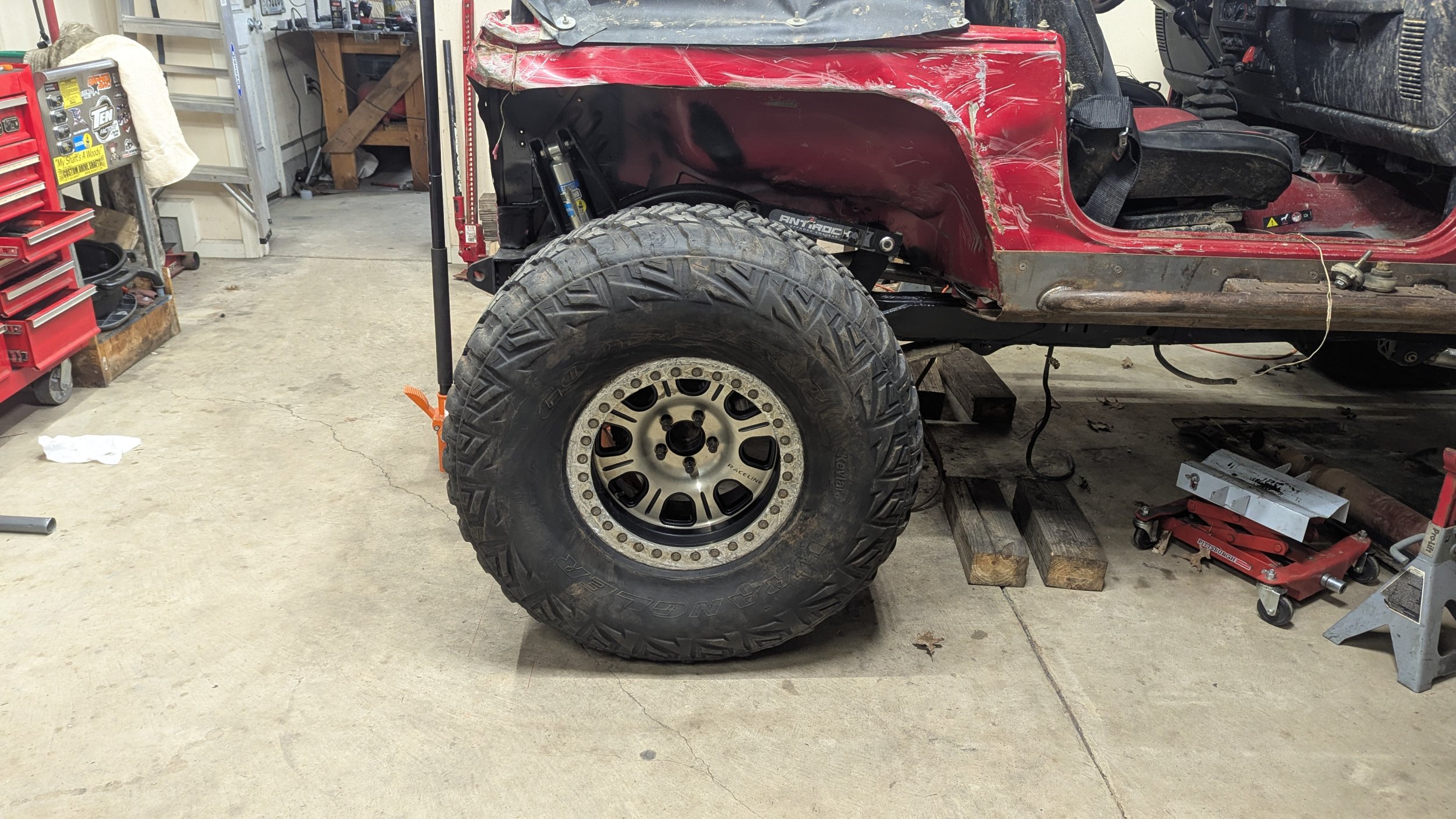

Another item is that I hate the way my jeep currently looks from the side, the rear axle needs to be pushed back to just to make it look better with the 38" tires and the fenders being cut. But like I said, I have not come to accept that sacrifice yet. Not sure if/when I will actually.

Continuing the Victor build philosophy, 🤣… I read your tradeoff and 7” rear stretch comments and wondered if a 4” rear stretch might be a happier compromise for maintaining better break over angle and getting some stretch. If memory serves me correctly I think you’re currently around 96.”
The 7" also considers the departure angle and the current physical state/condition of my jeep and my ability.
1. I want to have my tires be at or stick slightly past my rear bumper so I can drop off steps without hitting and I can get vertical without digging my rear bumper in. The 7" gets me that departure angle with the sacrifice of the break over, worth it, not sure yet.
2. Based on the current state of my jeep, axle, brackets, control arms etc... it would also be much more work and expense to go 4" in lieu of 7" and I don't have "time" or money for that extra work. Hard to explain but knowing my current talents, tools available, and funds allocated, the 7" is easier.
So it is trade offs, all about the trade off.

It make me chuckle that appearance is included in your thought process re the rear stretch :ROFLMAO:
I agree with you about the shocks. I daily mine and don't feel the need for expensive shocks. One of my rear Black Max shocks is completely blown. It probably has had no fluid for 6mos and I can't tell the difference. Still works to limit droop though. But , as I try to increase my travel I'll probably try the tuned fox reservoir shocks for fun.
Breakover angle is something I think about with a stretch as well. It is not a current issue for me at 93" but could be at my goal of 101". Nevertheless, climbing and descending stability ARE issues for the trails I like to do, so I'm going for the stretch before Sand Hollow next year.
Finally, you are correct, these types of mods are straying from the "stockish" mainstream of this group a little.
It is all about the appearance.....
