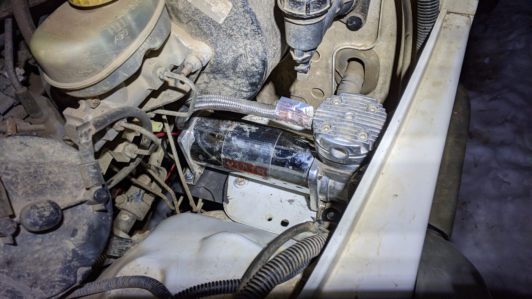

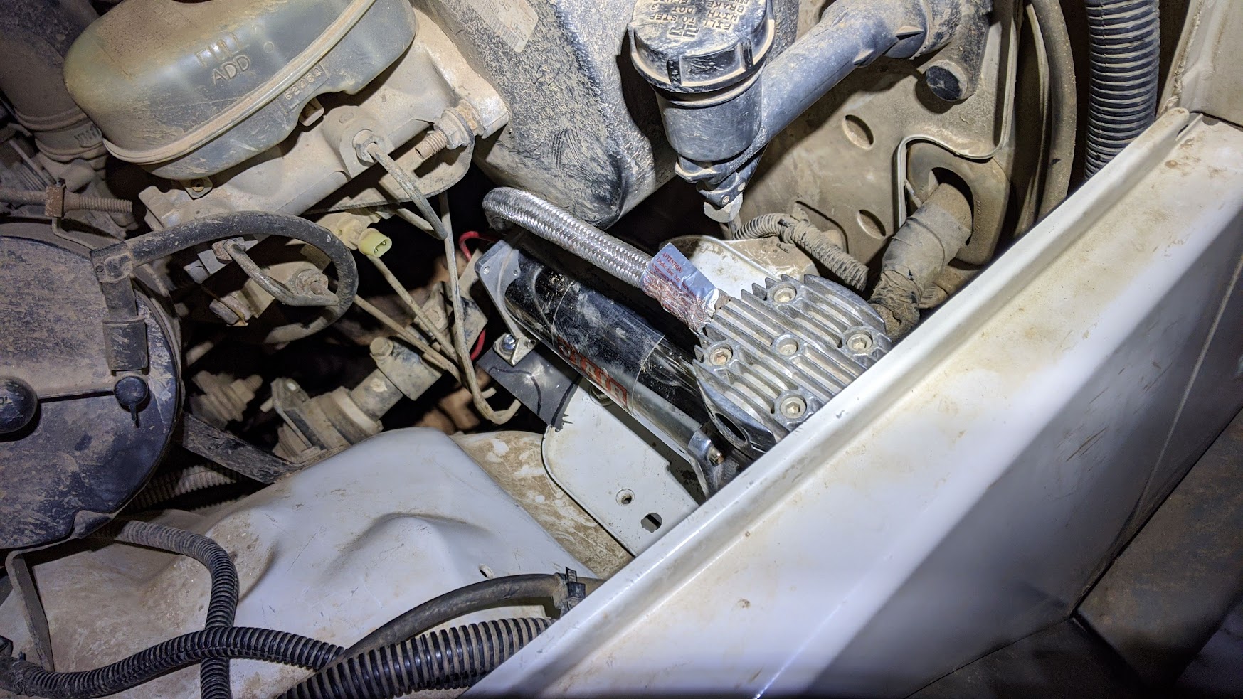

Since Mr @taylormade73 was (rightfully) mildly shaming me for all my ghetto air stuff, I decided to buy something halfway decent for once
I started working on installing my new compressor that I got from @Apparition, finally. I am putting it on the ABS tray, but it is a bit long so I am using some metal I had laying around to extend the tray to fit the compressor.
Marking where the compressor will go and where to cut the lip off the tray.
Here is the extendo-bracket. I was originally going to put it on top of the ABS tray, but I ended up putting it sandwiched between the ABS tray and it's support so that it would be more rigid.
Here it is installed:
Okay, so that’s a permanent mount and you have enough hose to reach any tire from there. Good job!
