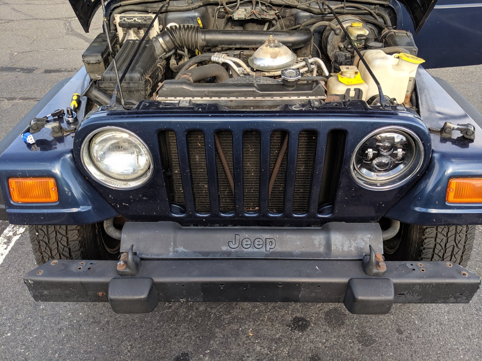

Alright so today I made small but, in my opinion, vital upgrade to Barbara. We all know that the halogen headlights are weak and don't give us enough light. So I bought —->these<—-. They are a plug in and go.

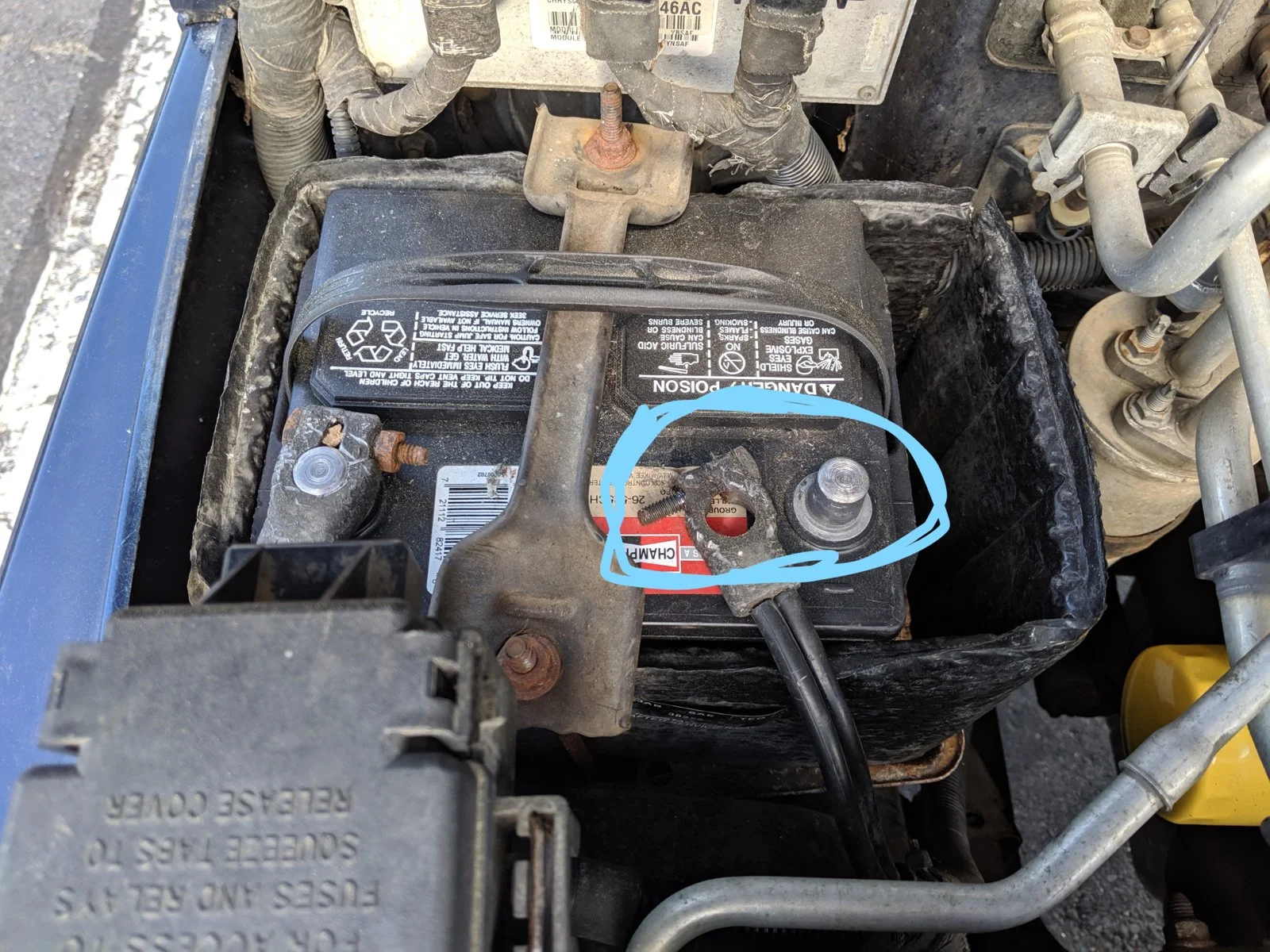

First: Make sure when you work with anything electrical remove the negative cable from the batte
ry
95250

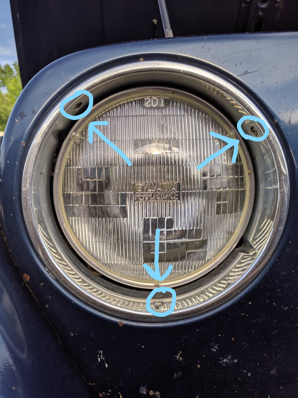

Second: Remove the three screws (they require a T-15 bit to remove) holding in the chrome trim then pull from the housing.
95246

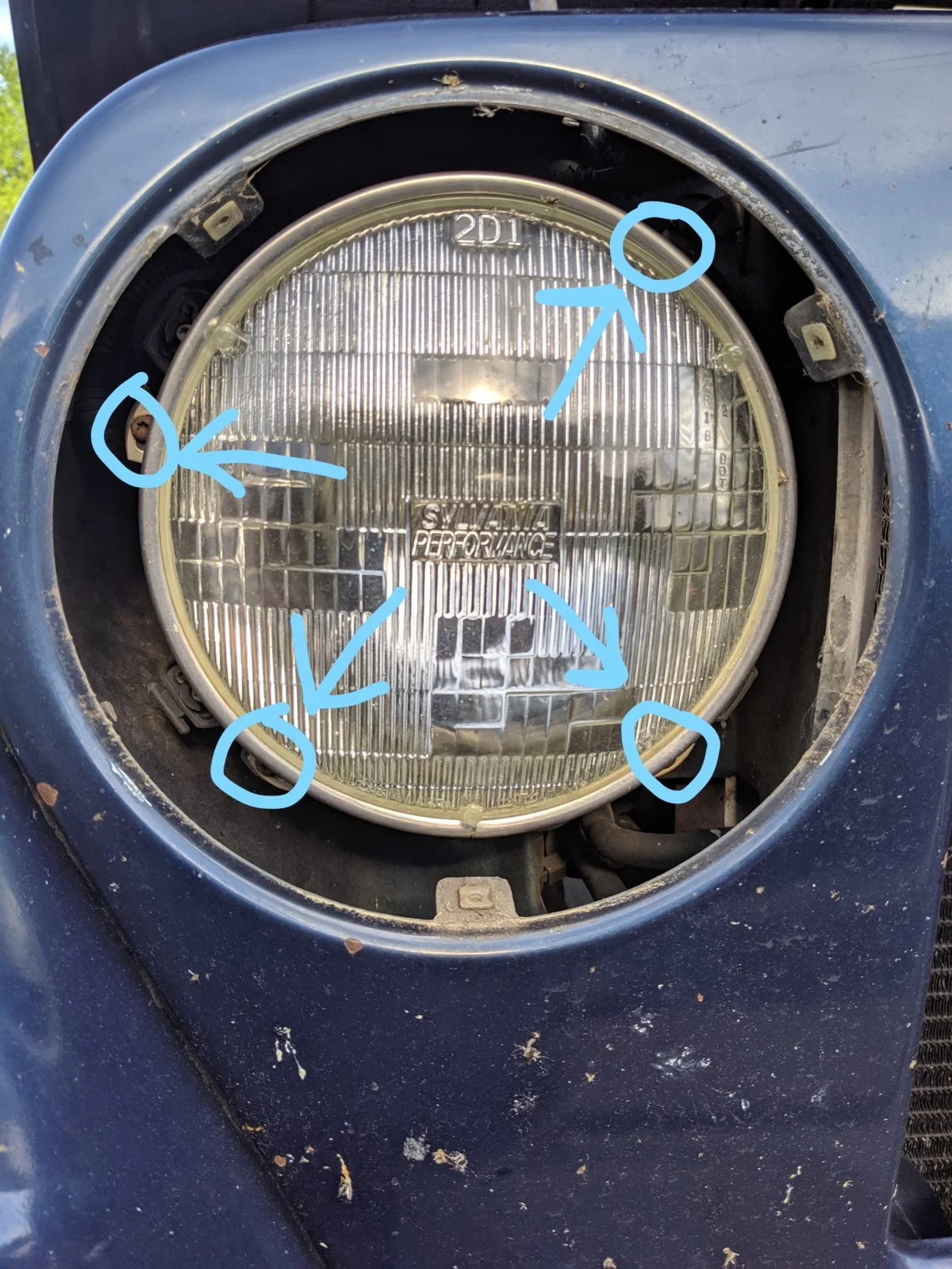

Third: Remove the four screws holding the bracket and light in. (they are the same as the ones holding in the trim)
95247

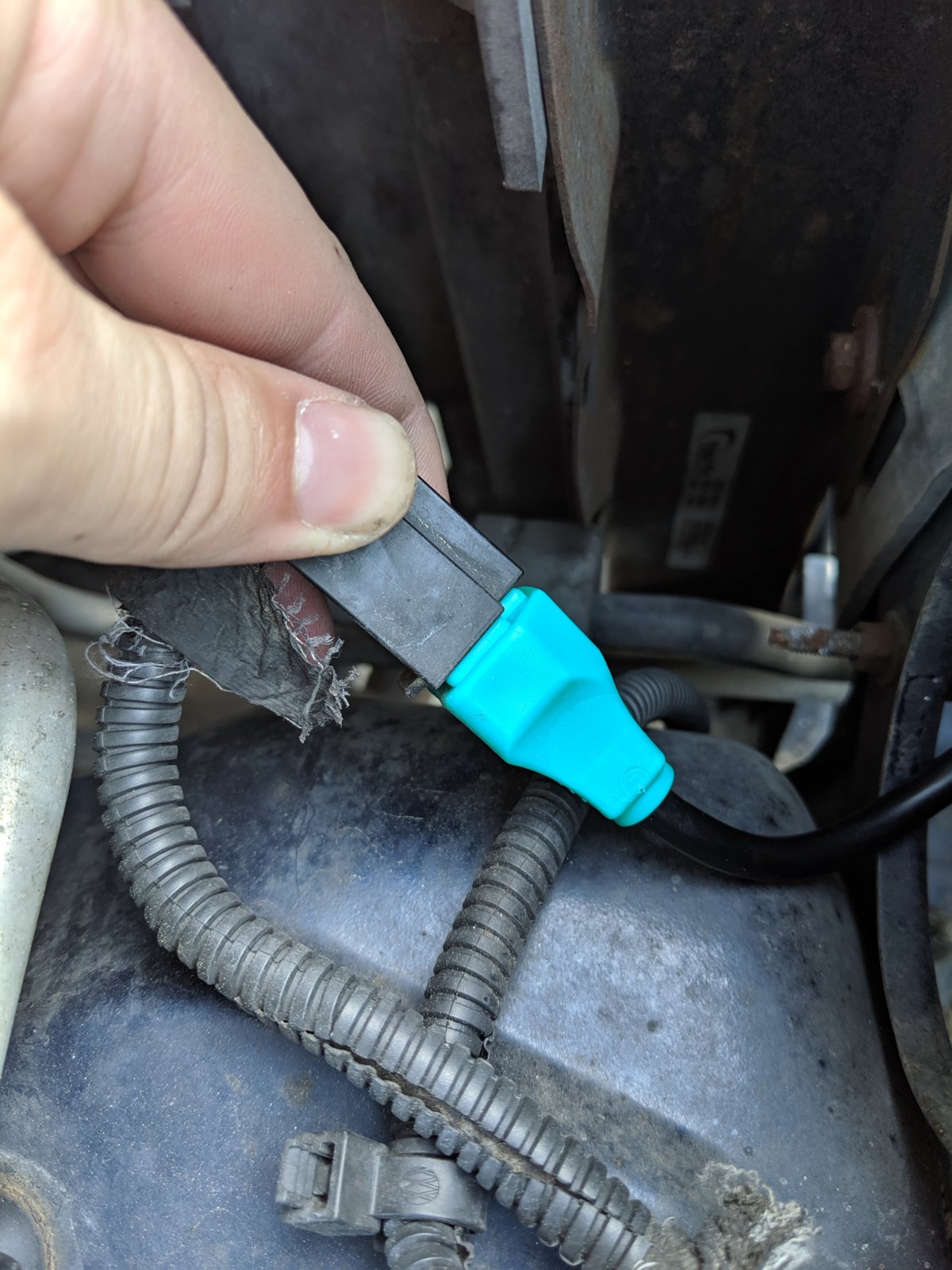

Fourth: Unplug your old light and remove. You will see with the lights I bought that they are the same connectors and just plug right in with no conversion wires.
95248
From there just do the steps in reverse order to install the new light. It should fit right in with no adjusting. When you wrap up both sides reattach your negative battery cable and you should have new working headlights.

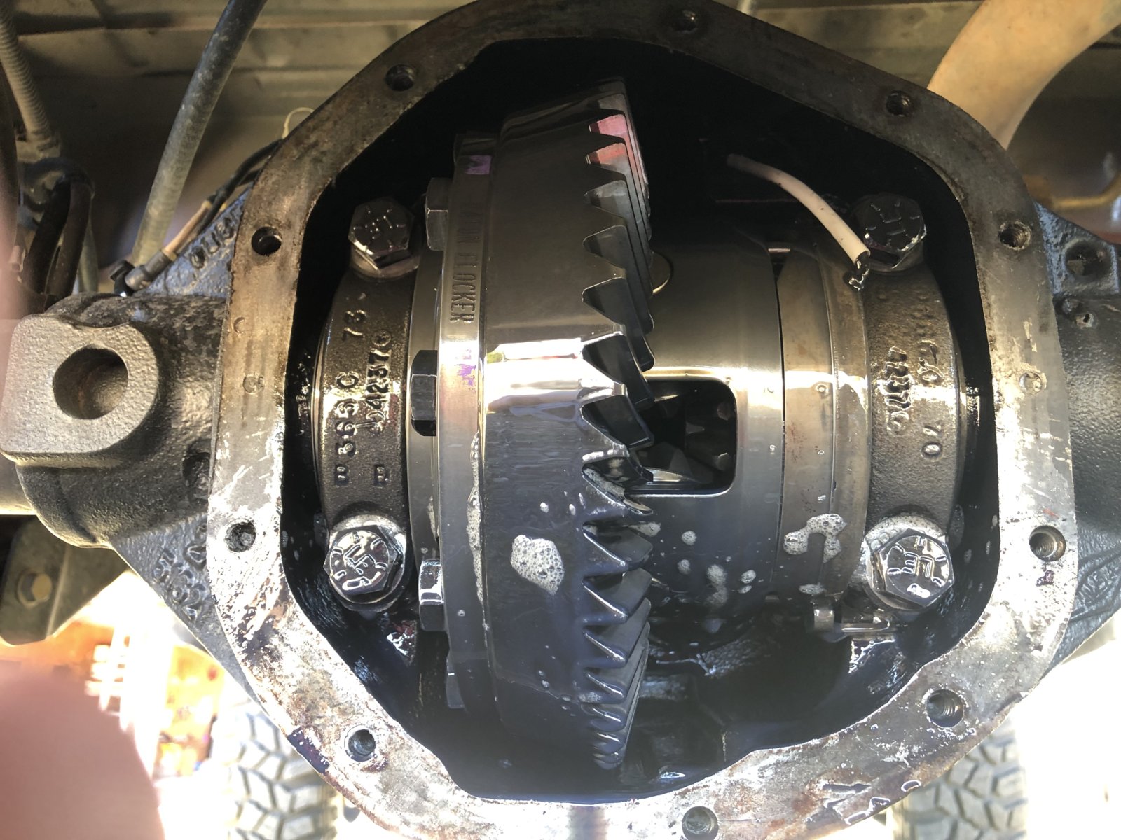

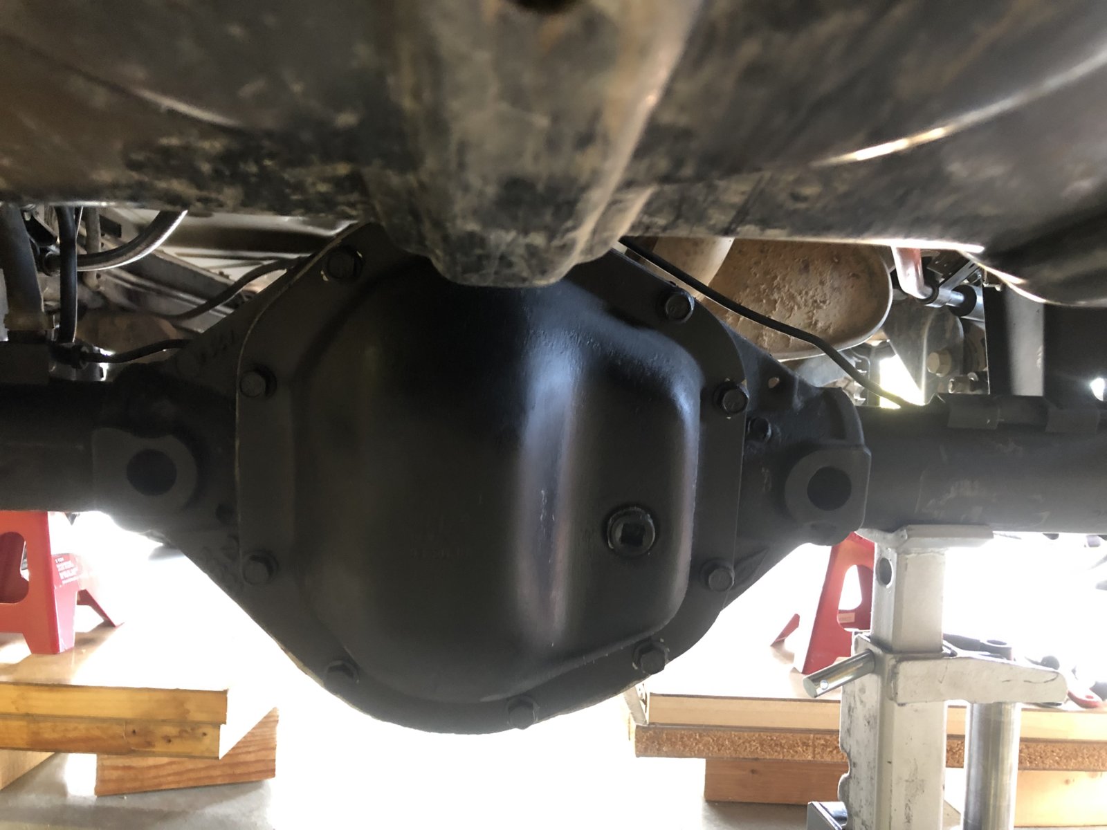

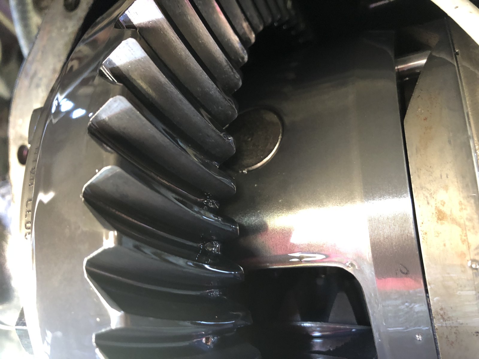

I’ve done a lot of mods and wheeled extensively with 33’s on a Dana 35. But the absolute best mod was the Dana 44 under my rig with the new gears and locker. There’s just no question. WARNING: Do not look at pictures below if you are offended by Pure Jeep Porn.
Here we go... @JMT showing off his rear end again. Shameless! ;)
Oh, I may show it to you in person. I think your finders fee is going to be me showing up at your back door and spending a day with you getting some mods on your rig! Get ready! You owe me man!
Ohhhhh she sure is pretty. How much of this did you do yourself and how much did you have professionally done?

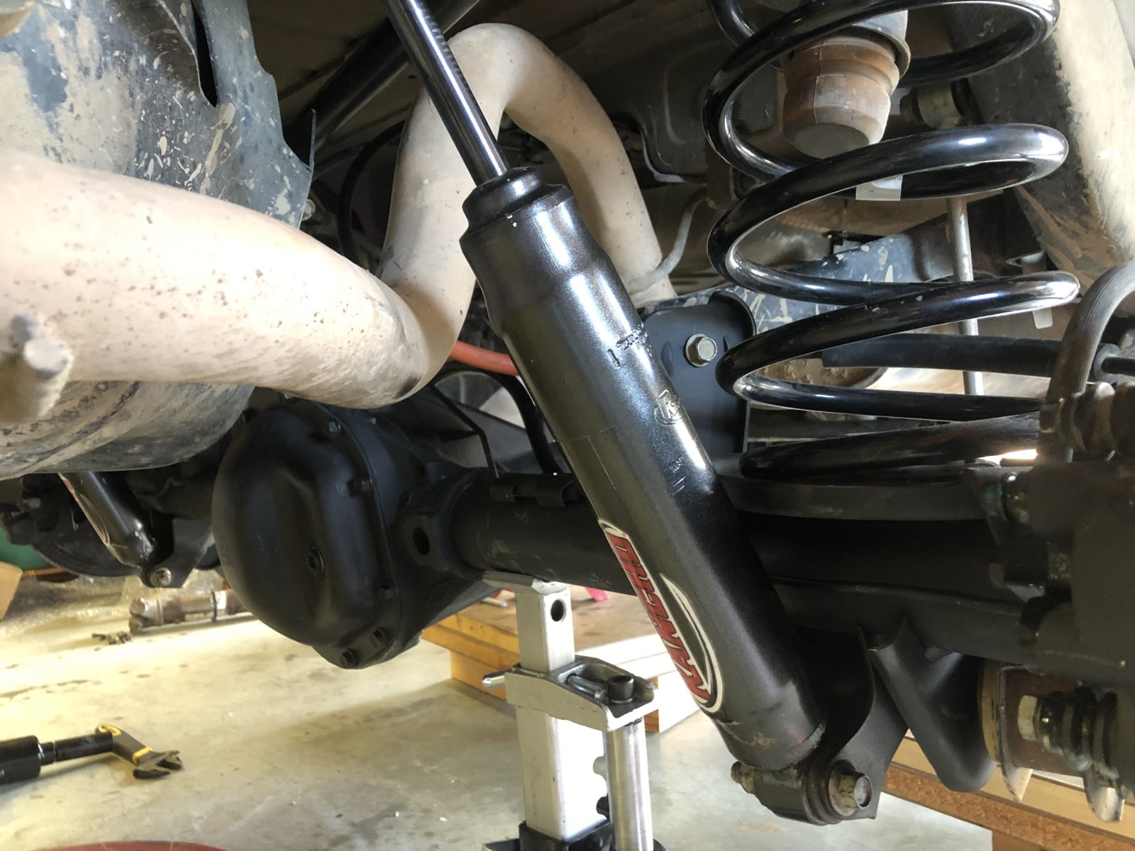

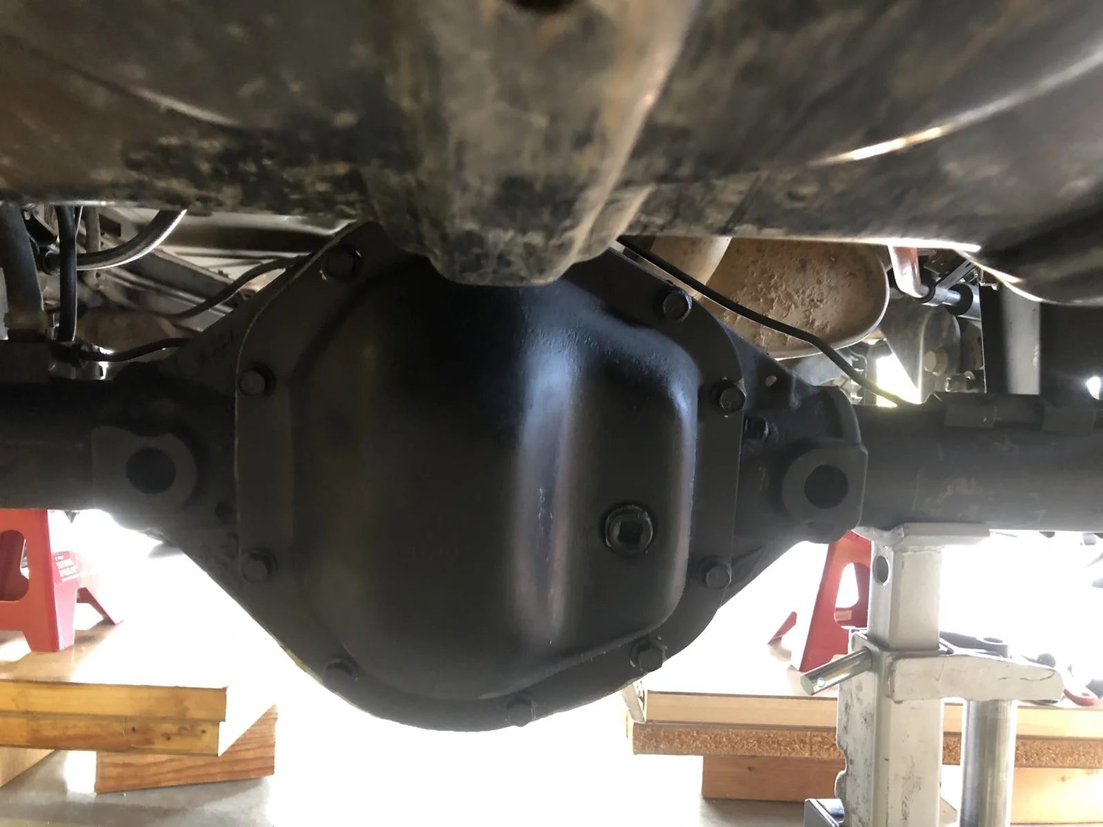

I did the axle swap in pics 1 and 2, including swapping a slightly shorter driveshaft donated by @bobthetj03. The gears and locker were installed by Just Jeeps in Austin, TX. Gears are the one thing I did not do on my rig and would not do unless I was guided by someone like @Rob5589
