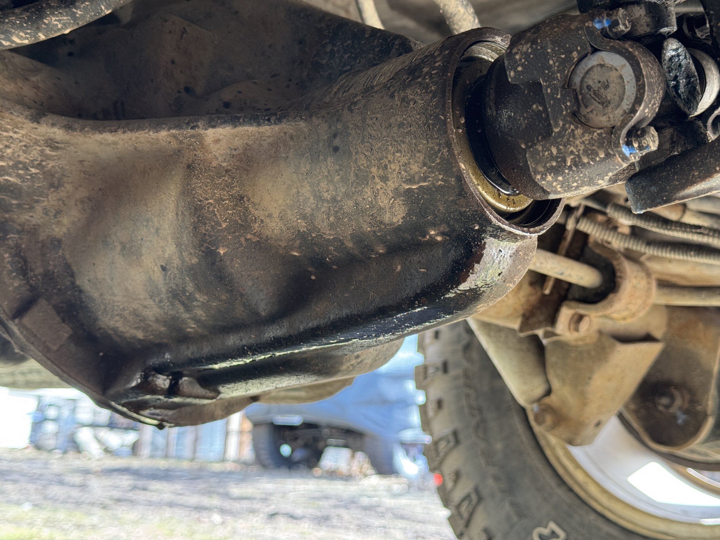

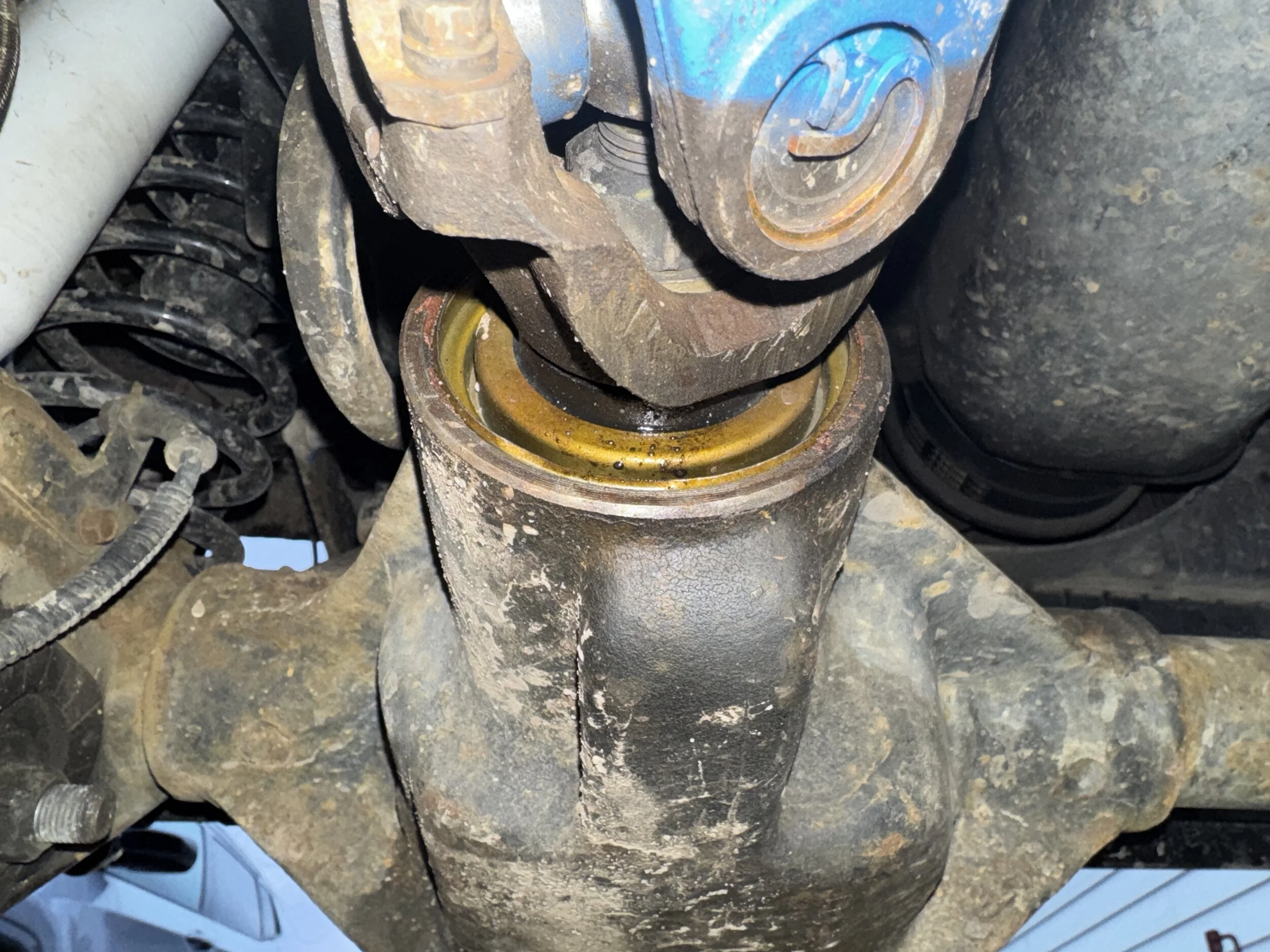

Well definitely still leaking. Less than 300 miles on the new seal. I'm thinking there is more to this than just a bad batch of seals.
Sorry, I might be a retarded, but doesn't that pinion seal look very crooked? The bottom is pushed in almost a centimeter, whereas the top looks flush with the housing face, or close to it?

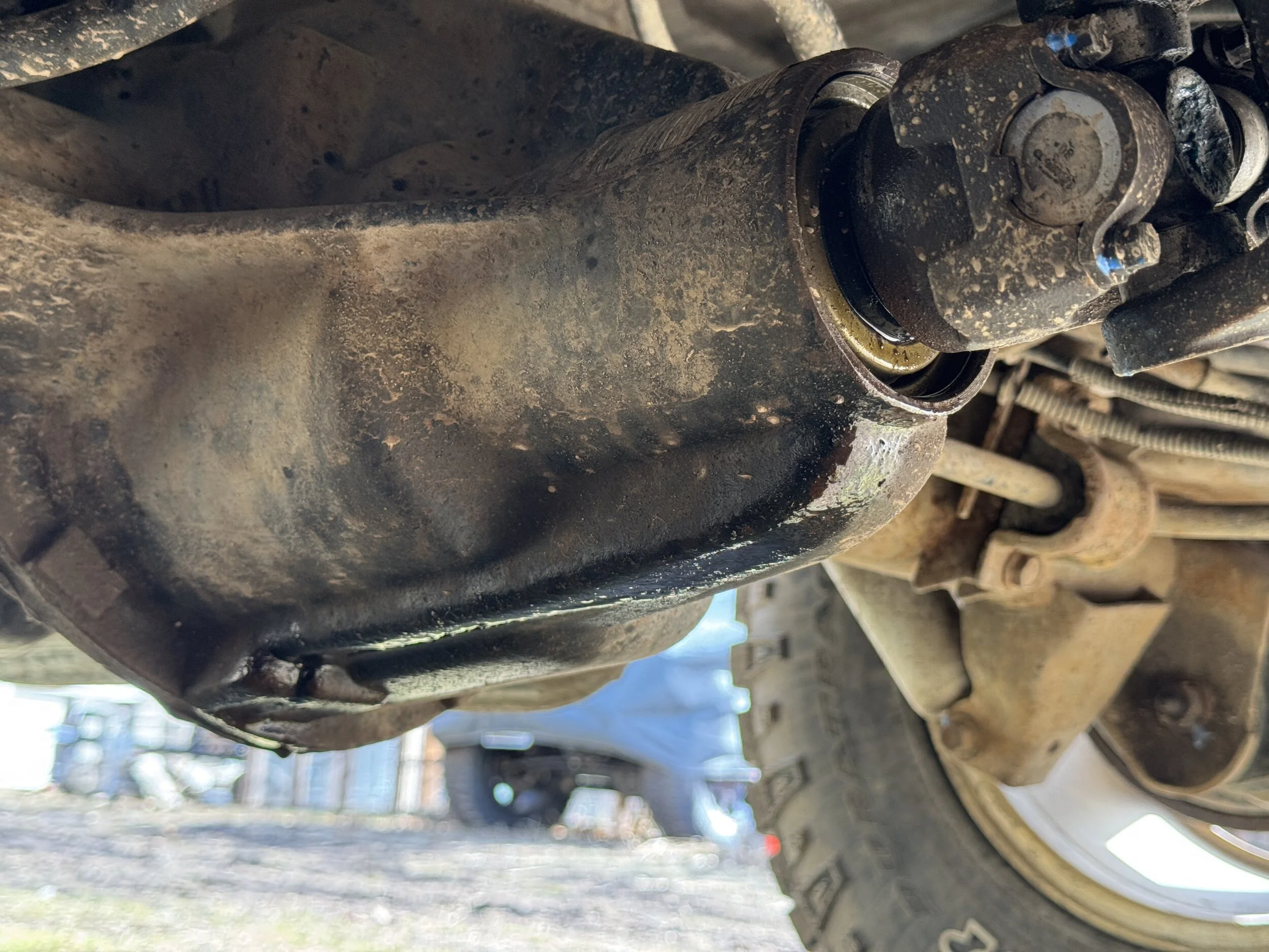

Yes it does appear so. here is a closer pic from today. But I woulnt expect such a small cant to cause such a large leak. Could be wrong though. It does make me wonder if the internal spring fell out. Although I imagine a whole bunch of other problems would exist if that were the case. Funny enough this angle (drivers side) hides the leak pretty well.
Is that an original yoke?it could be groovedat the seal surface. A new spicer one wouldn't be expensive
It is. This could be an option for sure. I'm concerned the issue is a larger problem. But I will see about getting it swapped out.

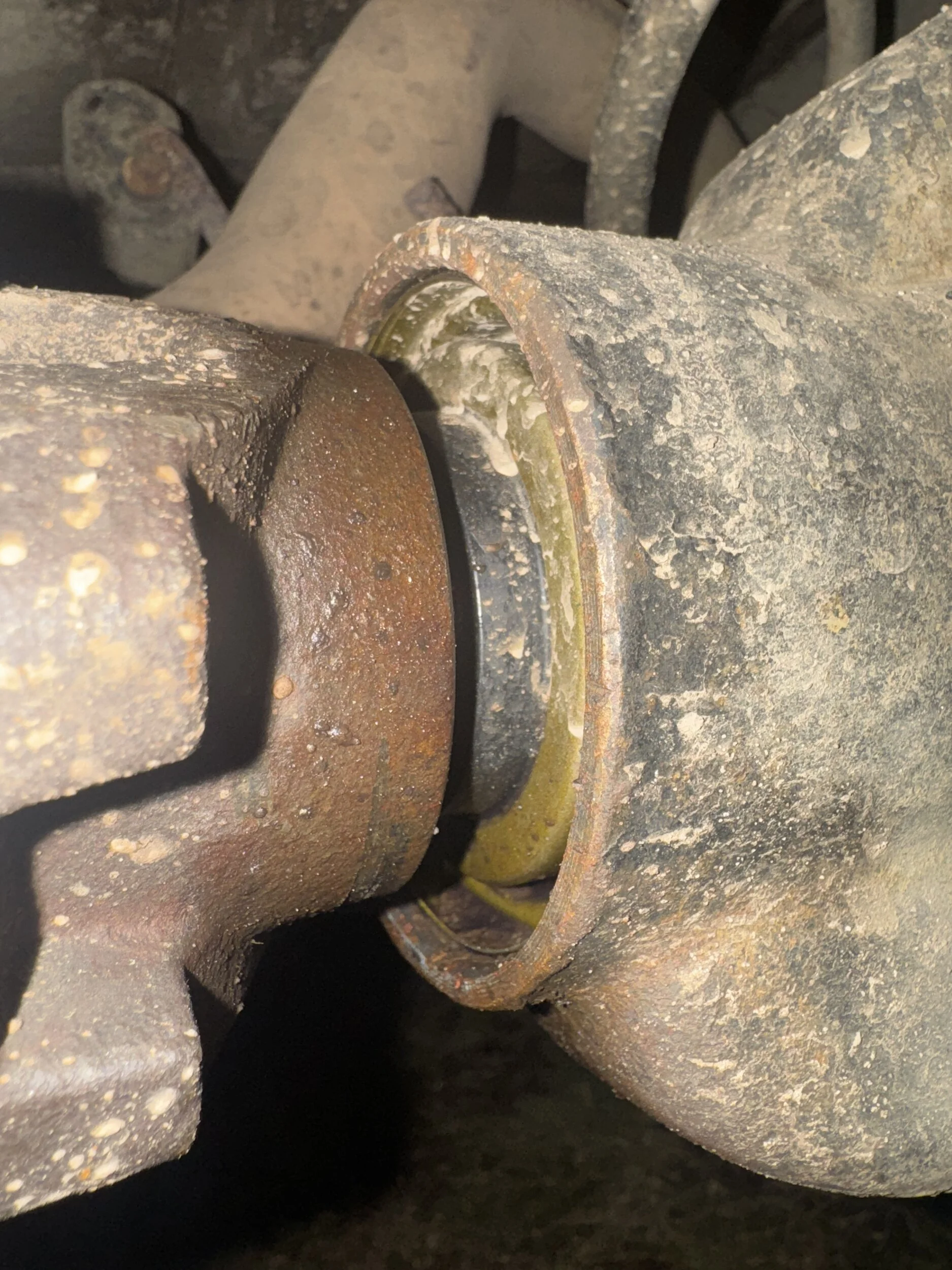

Oh, and after that little 8 miles worth of simple 4x4 over the weekend, the front is leaking too now...
