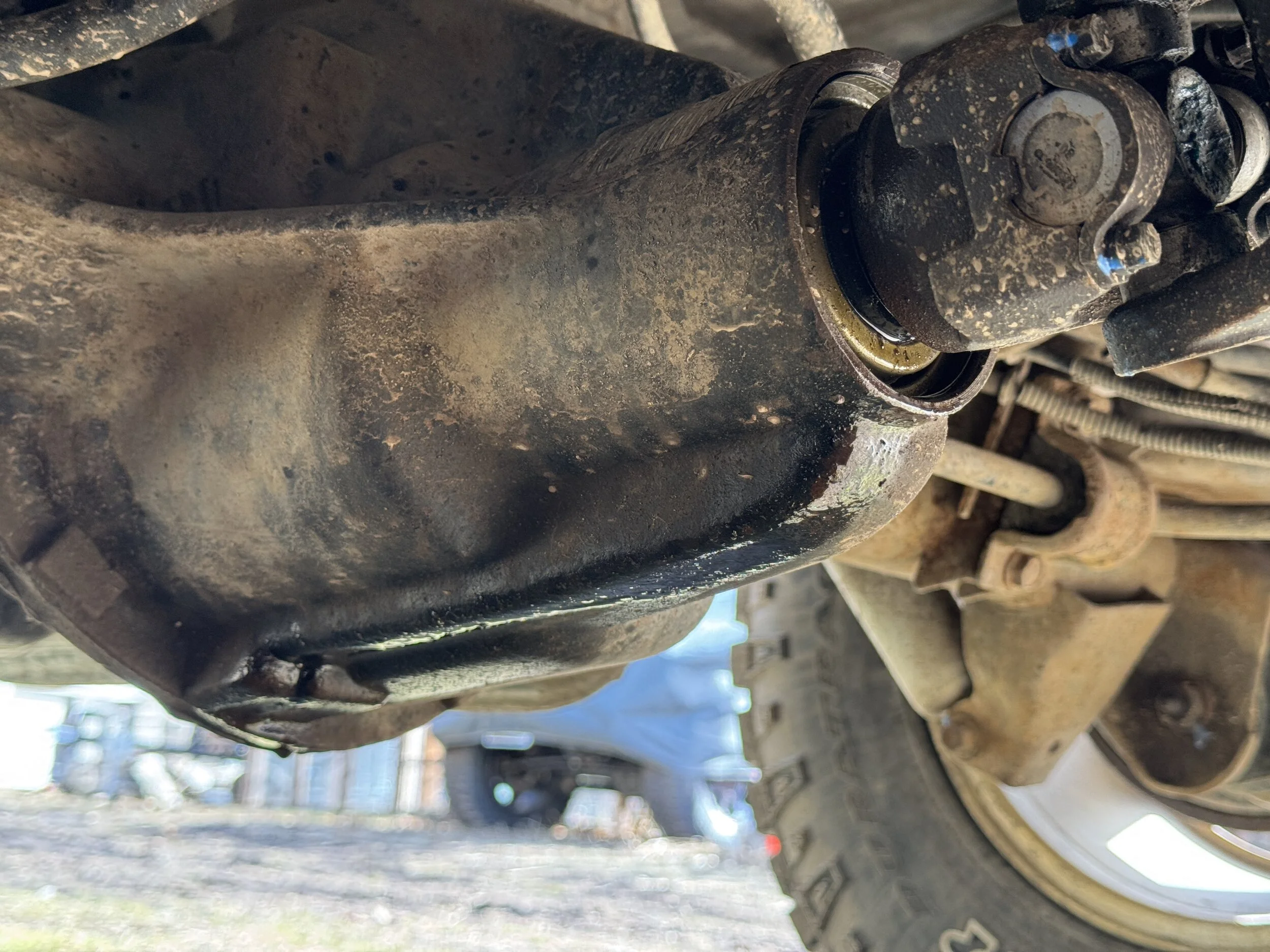

Oil comes out of the end of the axle tubes and there is a small trace of oil at a plug weld near the differential.
The axles barely sit up a bit in the housing, which is likely allowing the oil to get past the seals. I don't know what is causing the axles to load upwards...I can only guess that the housing is bent even though it doesn't look bent. It looks good to go...which is annoying.
The camber is no longer negative using offset balljoints, but the axle shafts will load the Yukon hubs just enough to burn up the brass bushing unless I keep the locking hubs removed. It's pretty odd how normal everything appears considering the symptoms.

Well definitely still leaking. Less than 300 miles on the new seal. I'm thinking there is more to this than just a bad batch of seals.
Yes it is. Yeah I was thinking the same actually, but I would have expected the shop to mention that.... It's an awful lot of fluid to be leaking though.
