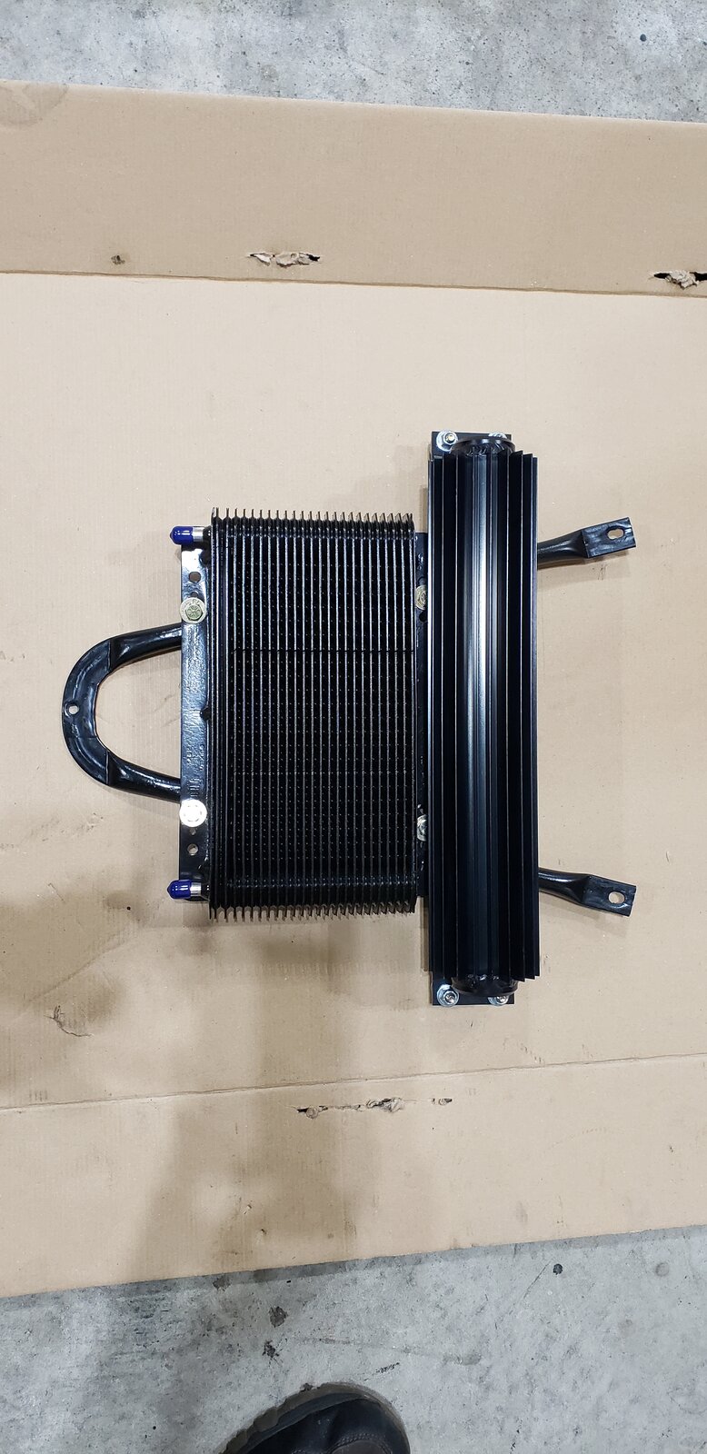

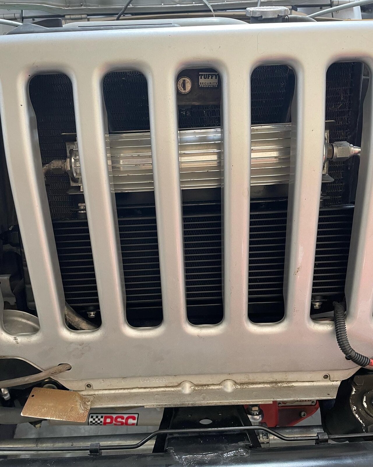

I've run the B&M cooler @MountaineerTom posted in three Jeeps now with great luck. Before I installed the cooler I had transmission temperatures consistently north of 220° when wheeling. After, the highest temperatures I've seen were around 186° on a long slow (4:1) steep hill climb. It is paired with a single pass Derale, for cooling power steering fluid.
https://www.summitracing.com/parts/bmm-70264
That looks worth a try, I do not want to get rid of Blaines cooler as my PSC hydro steering setup from him has worked flawlessly and after reading all the testing he has done getting that system dialed. I can modify the mount to accept the B&M pretty easily. Was also looking at the Setrab 14 row he mentioned but its longer and pricey but in the end I just want to keep my 42 cool. Wonder how the flow is on that B&M compared to the Setrab 14?

Going to all that trouble I can't imagine why you wouldn't replace the radiator support like the PSC design to keep the cooler close to the condenser. Seems like allot less work just cutting a piece of aluminum. I guess it is a bit more expensive than welding a few pieces to the factory bar?

I could have bought the setup he uses, but can't justify the cost difference for my area. My high temperature numbers now, with the B&M cooler, 70264, are well within an acceptable range. I've used it both off-road and on-road, commuting in traffic, and my numbers are very good. In stop and go traffic I might get up to 165°, which is acceptable compared to 200°+ I was seeing before. Is that cooler better, sure it is. Would it give me significantly better results, I can't say.

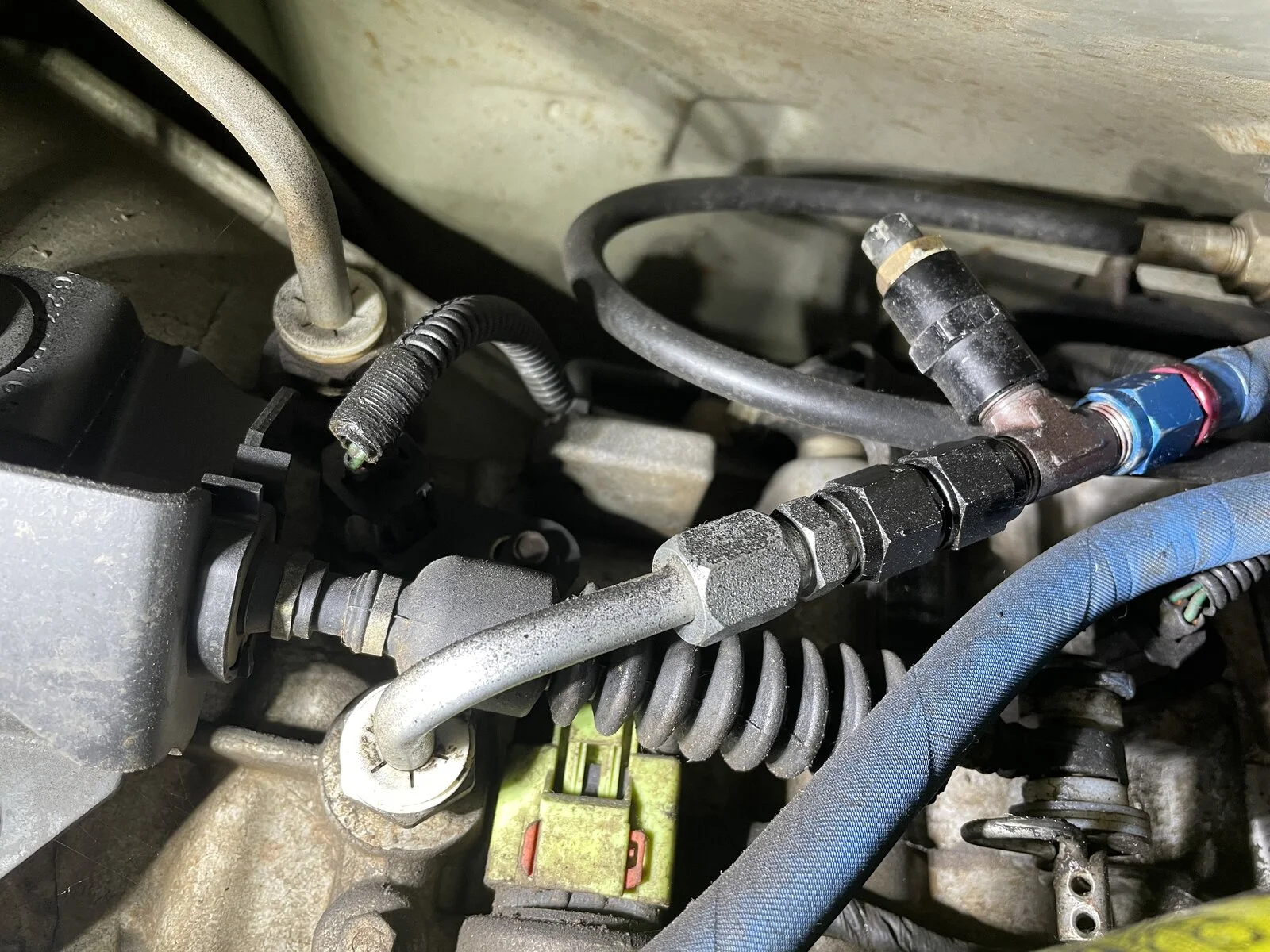

With your not having good luck with the Derale, I can only wonder if you inserted it into correct driver's side transmission coolant line from the radiator. 2002 and older it gets inserted into the passenger side coolant line.

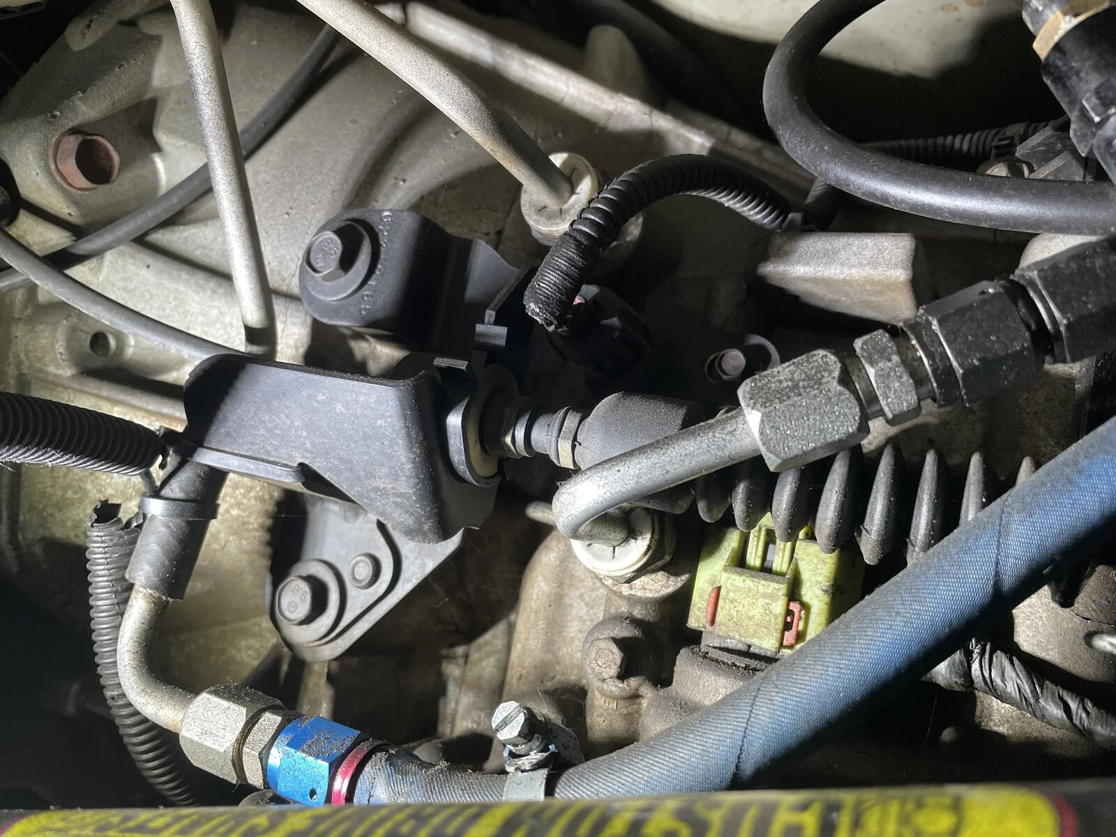

Finally had a chance to drive over to my cousins shop in Clovis and work on the jeep, got the Sertrab tranny cooler mounted below the PSC cooler, waiting for the fittings to arrive. Going to leave the Derale cooler installed since everything is already plumbed in. Jerry I looked at the return line coming from the Derale it is the one in the pic with a Temp bung, I have since welded a bung in the pan.
