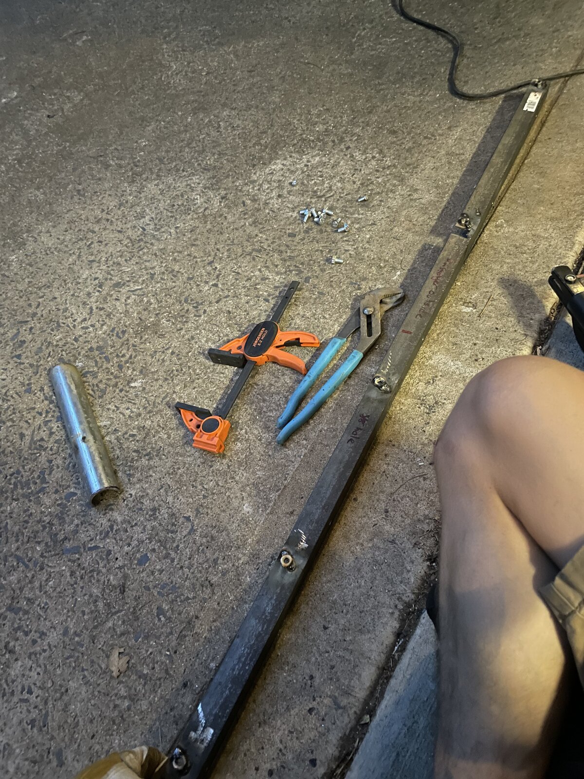

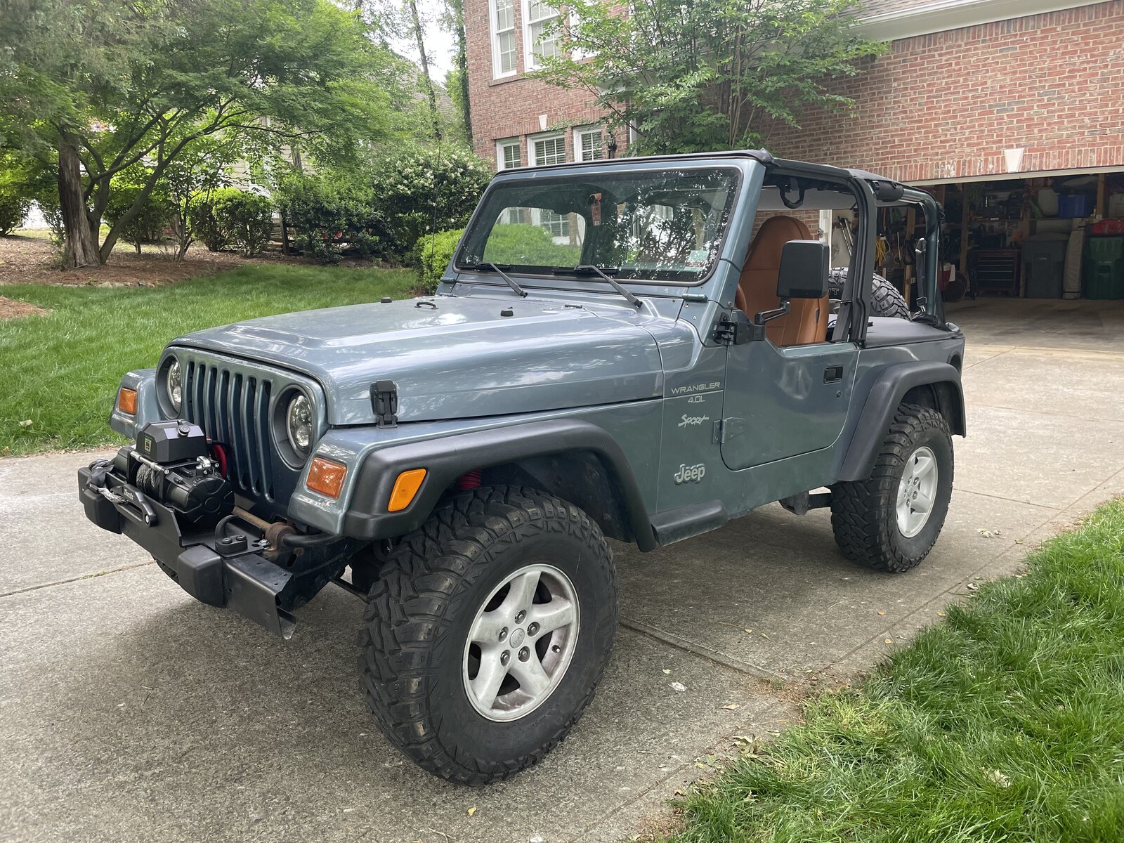

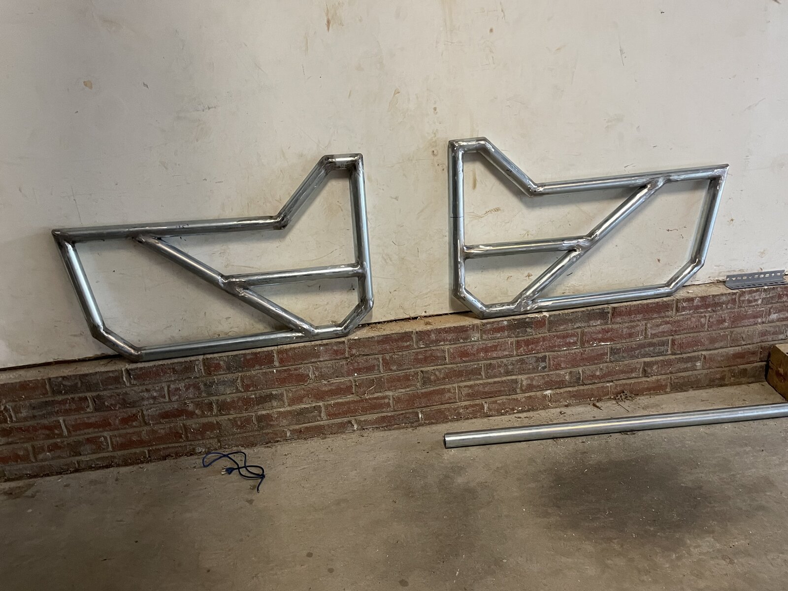

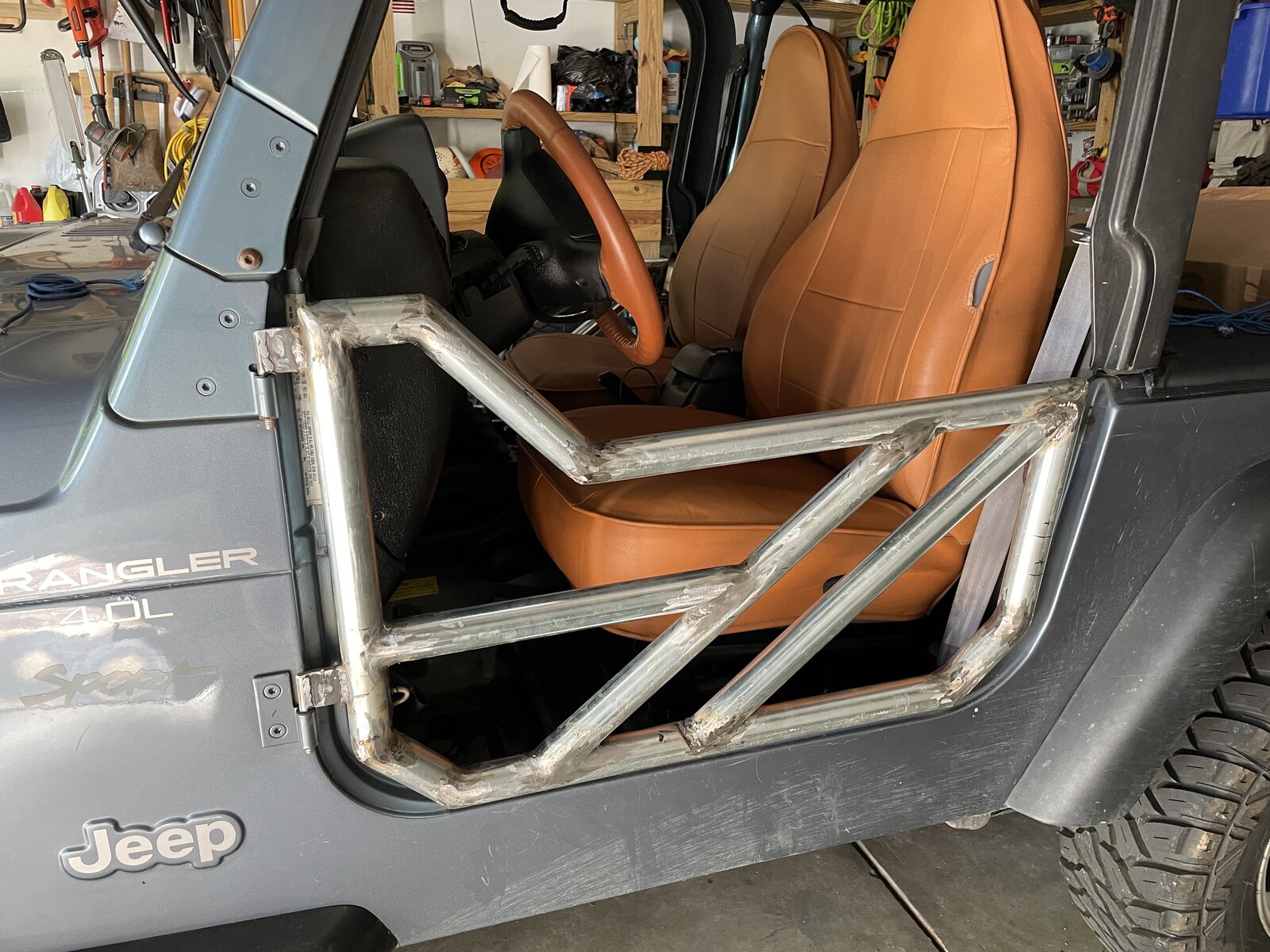

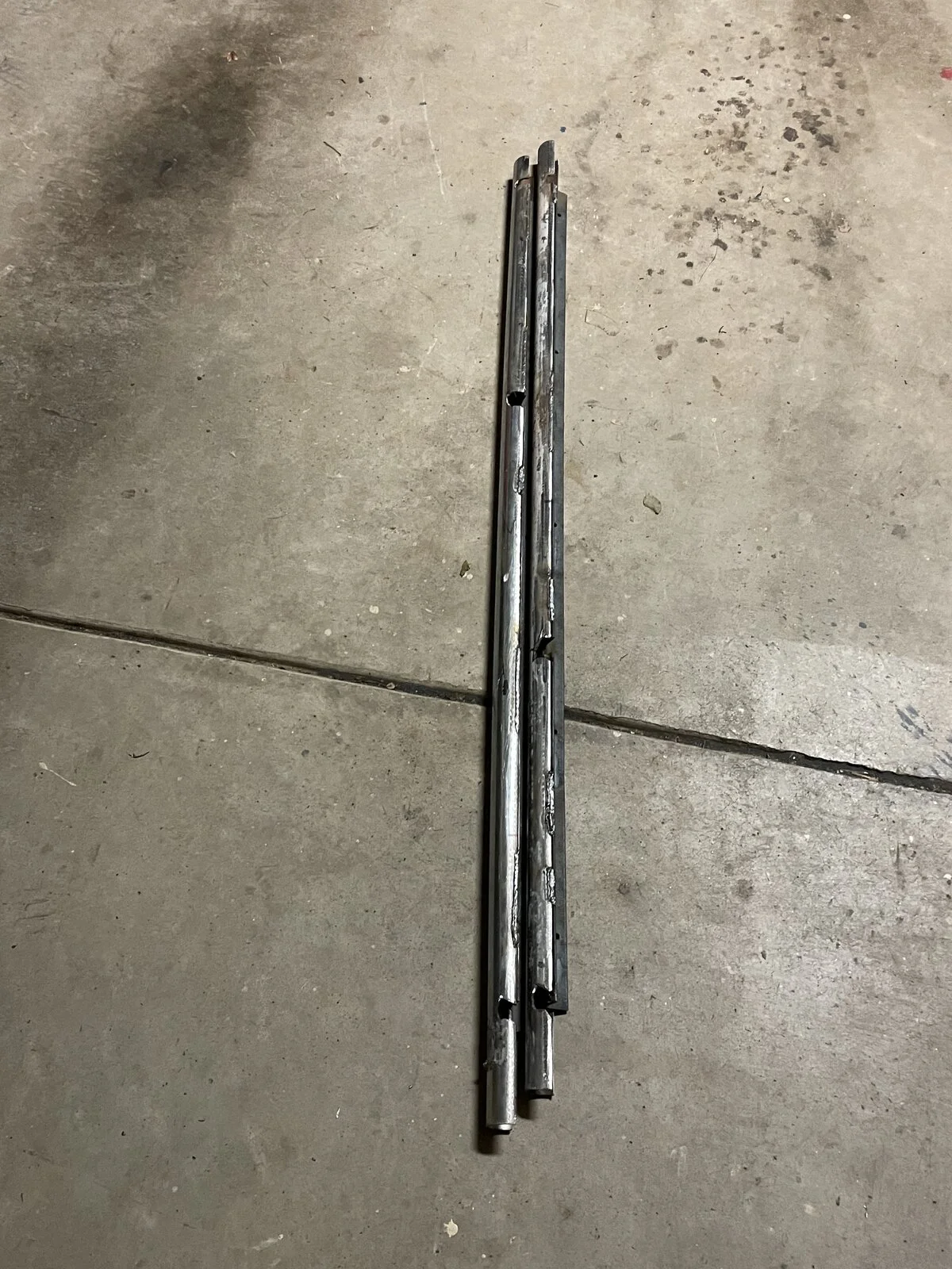

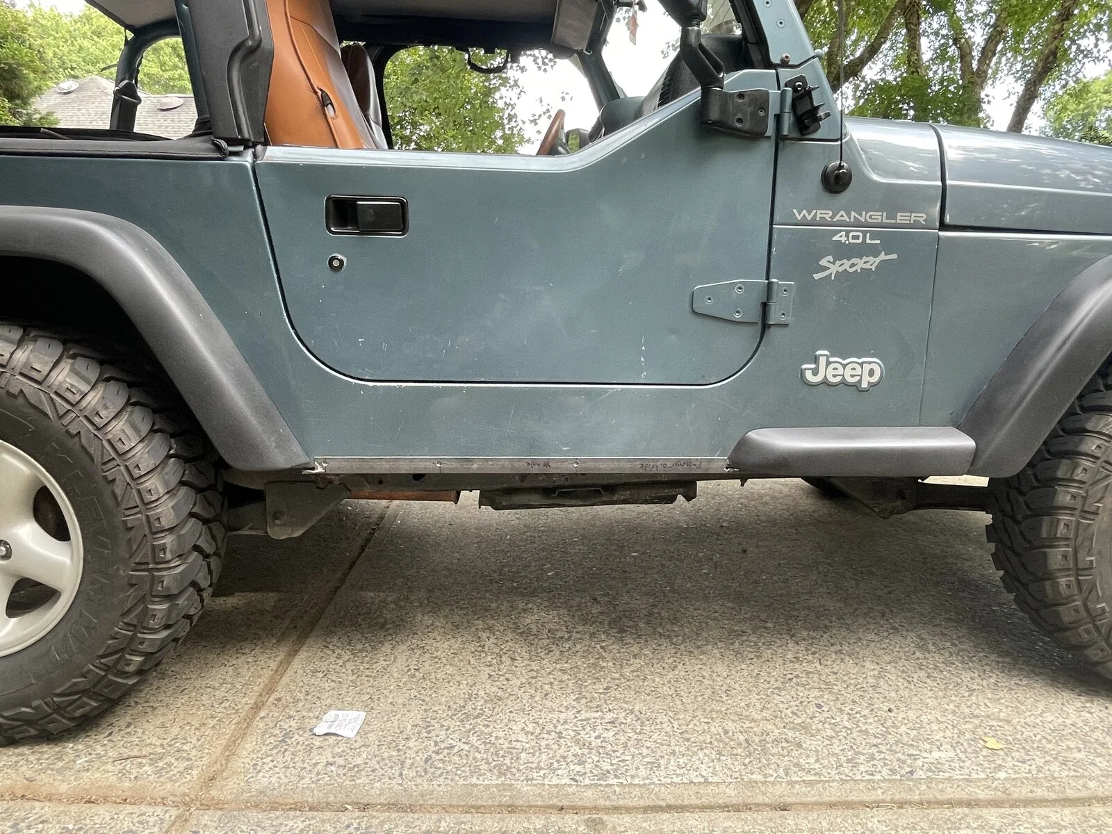

Got both doors done and welded! They look kinda wonky in the picture because of the angle, but they fit in the door area perfectly on the jeep and are practically identical. I’m super happy. I’ll do hinges/latches in a couple weeks when I get back from my spring break and then paint everything with a black bedliner I think.

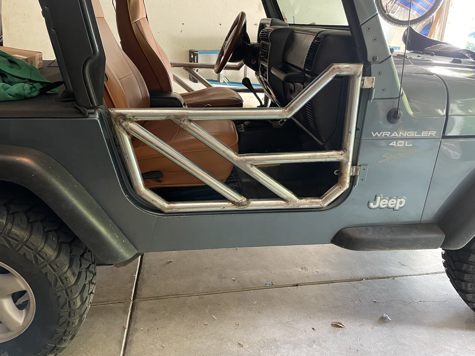

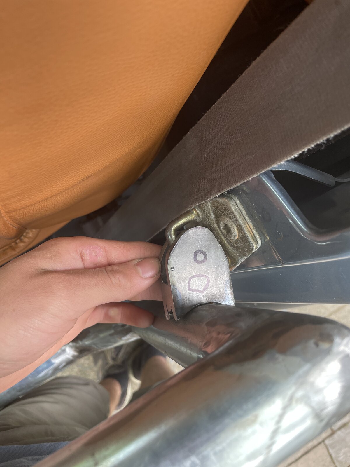

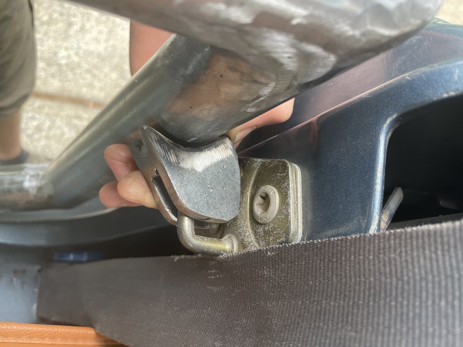

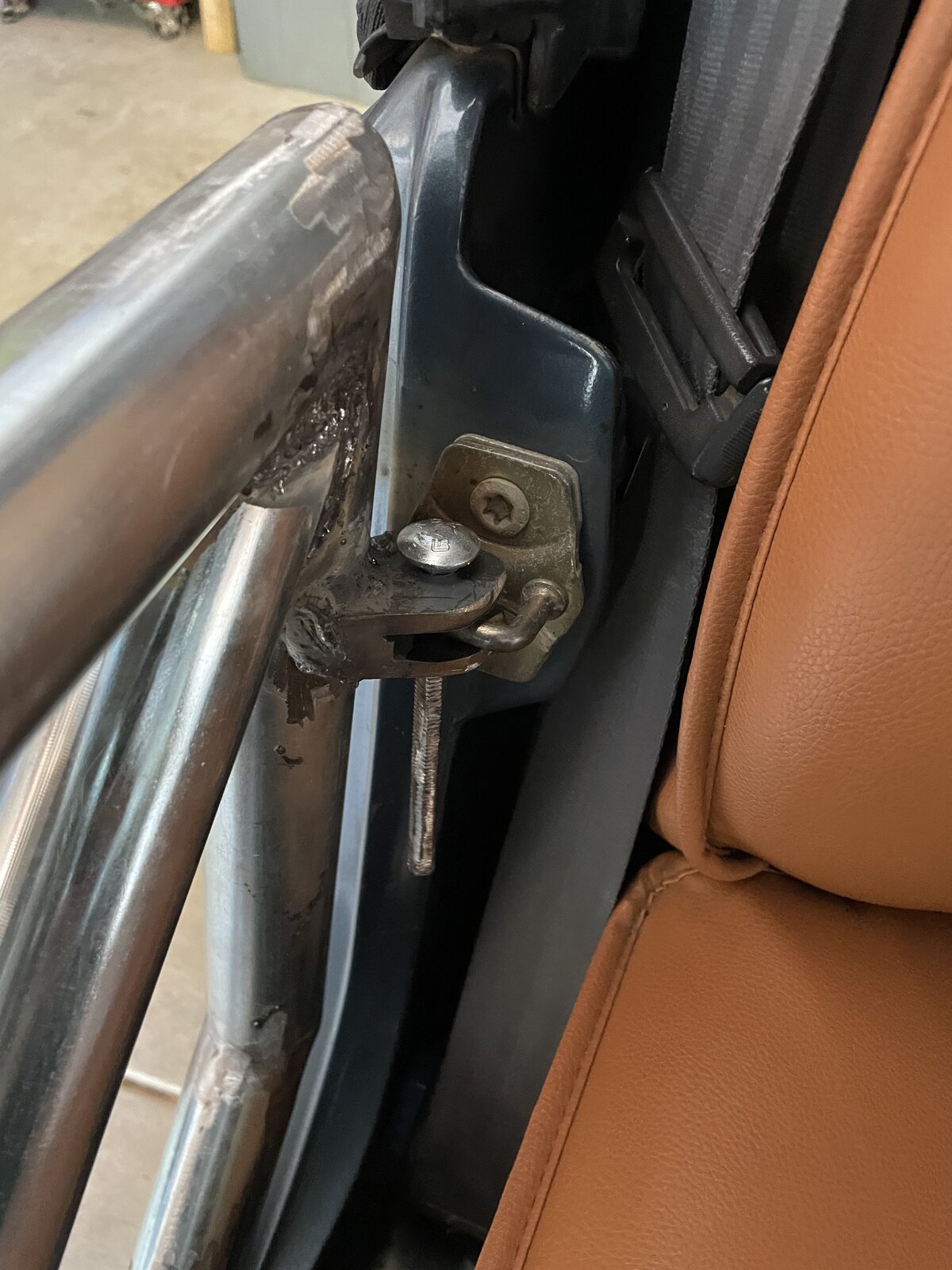

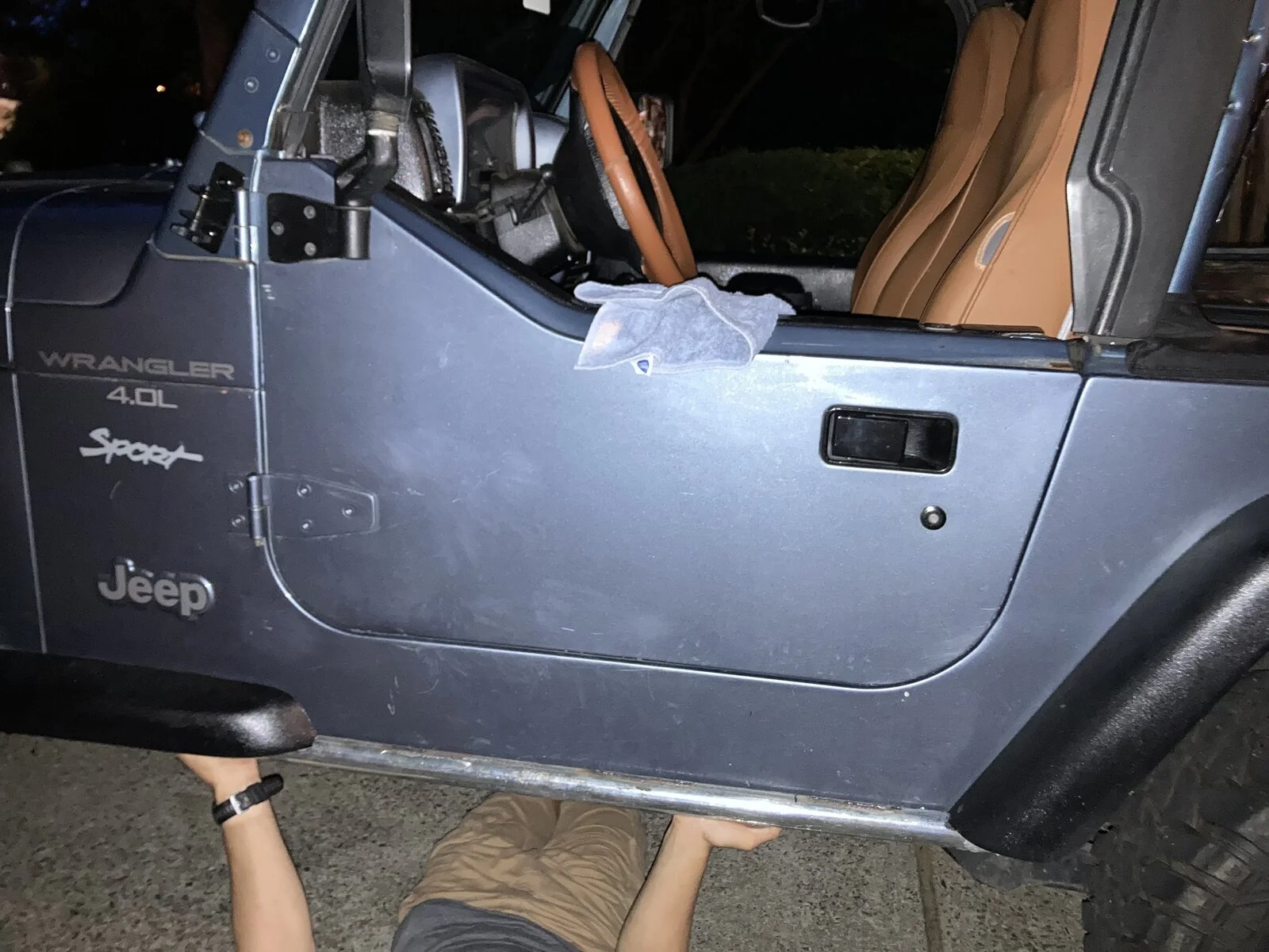

Got both doors on hinges today. Took some effort to get them lined up correctly so they swung open smoothly, but wasn’t too bad. Also got latches made for both sides, heading over to my grandfathers house in a bit to use his drill press for holes. As of right now I’m just gonna have a bolt drop through to keep it closed, but may try something spring loaded later on.
Clever idea for the latch on a budget. A bolt will work but, when you mentioned that, I thought a next step up would be something like these (you'd need to look around for the right application but I just googled 'pin with spring-loaded ball bearing' for a reference product). Weld a little handle or solid metal ring, rather than the split ring.

Just an idea.

Just an idea.
Great idea, thank you. I’ll probably try that out

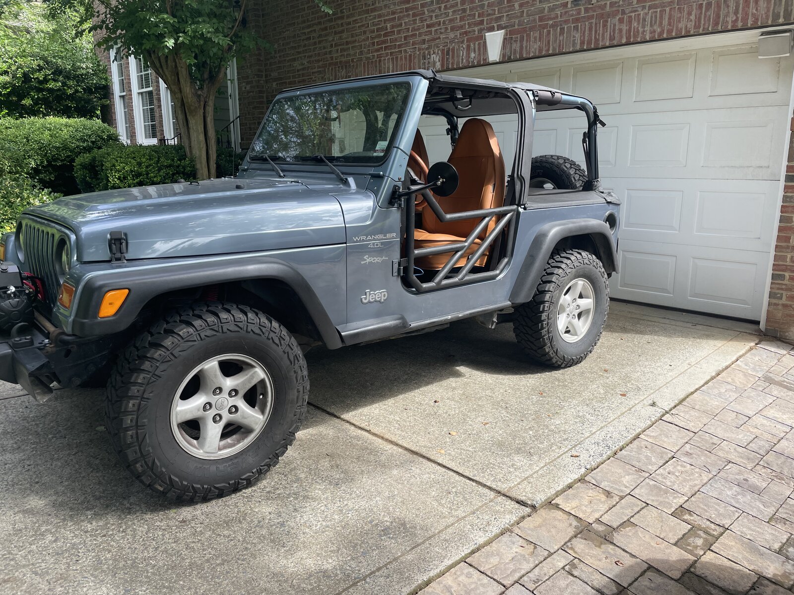

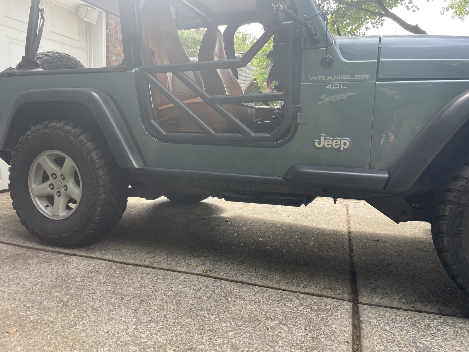

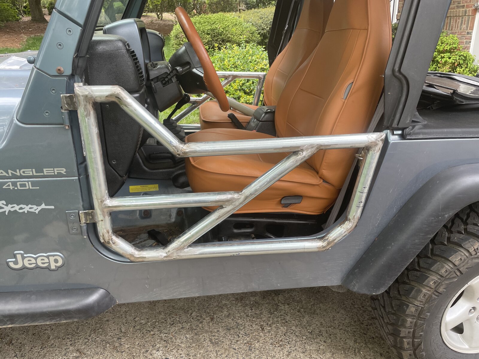

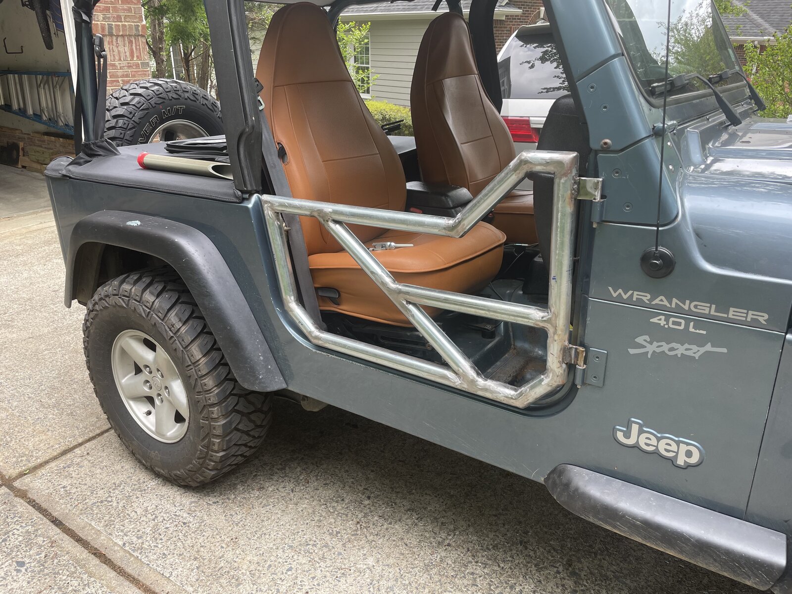

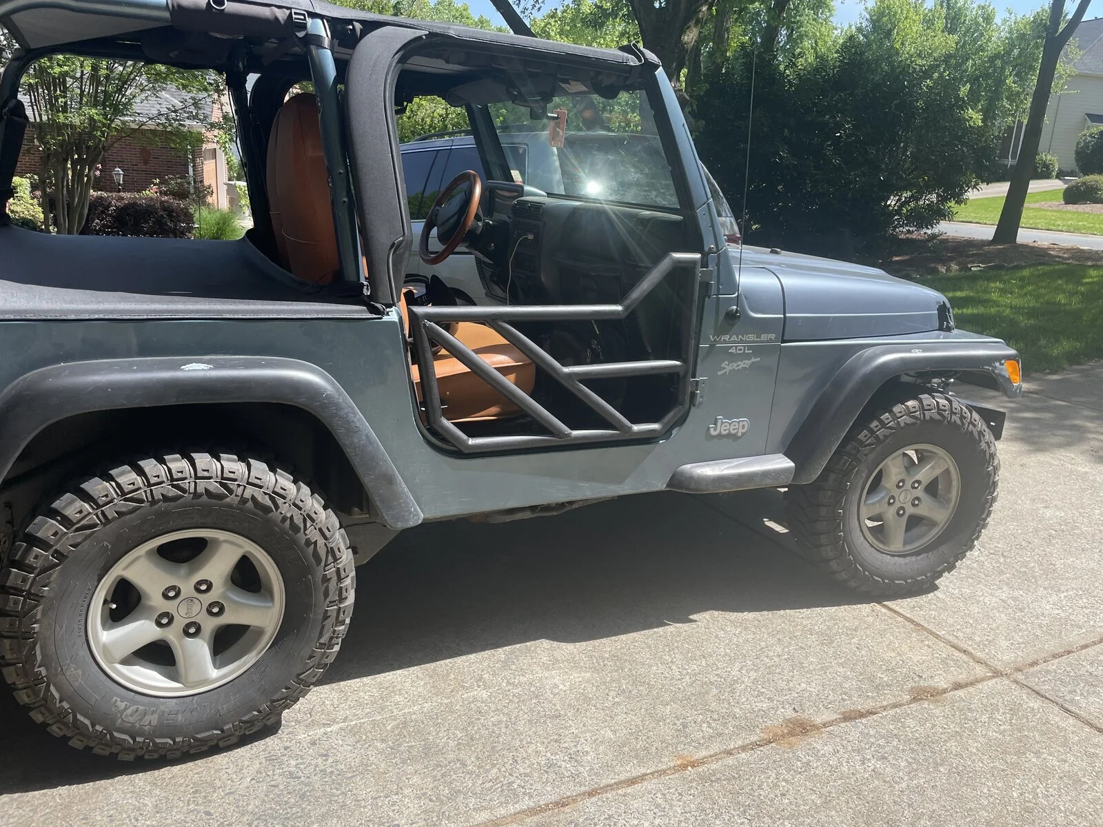

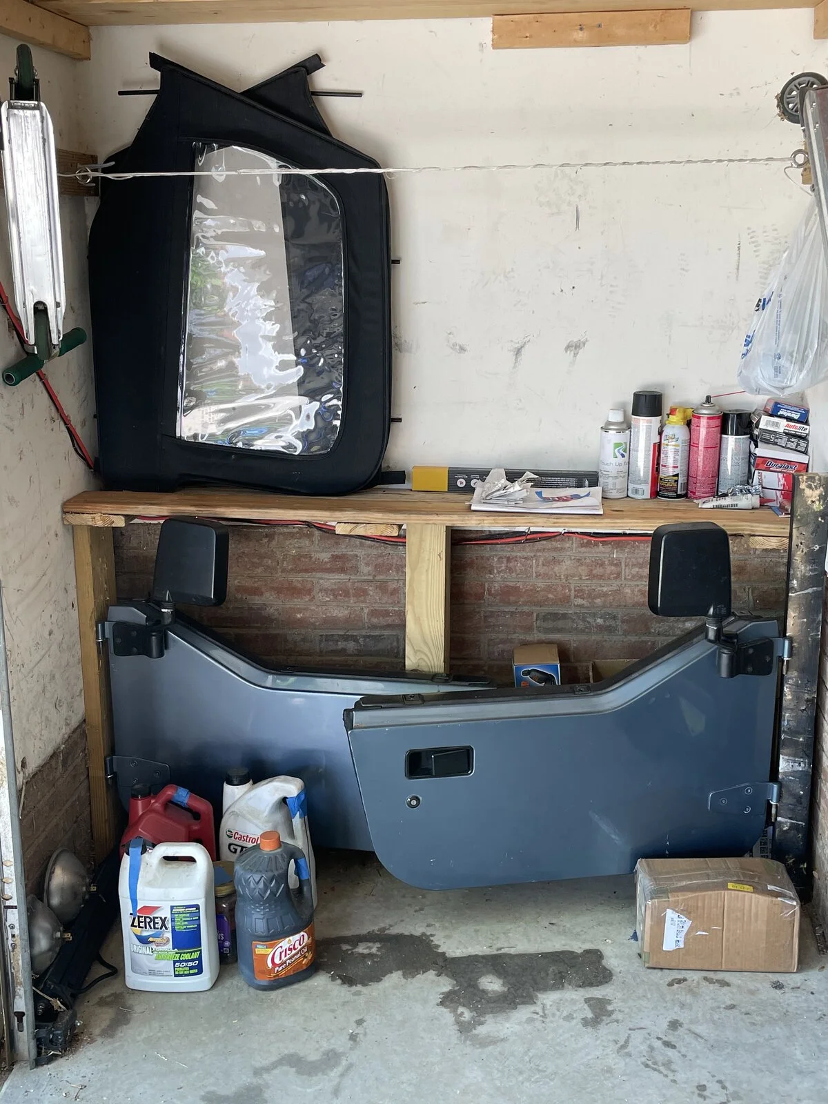

Almost finished the doors. I was convinced by my brother that they still looked empty, so we added in another bar. The “latches” work and are tight, im happy about them. Next is to buy some mirrors, and then paint everything.

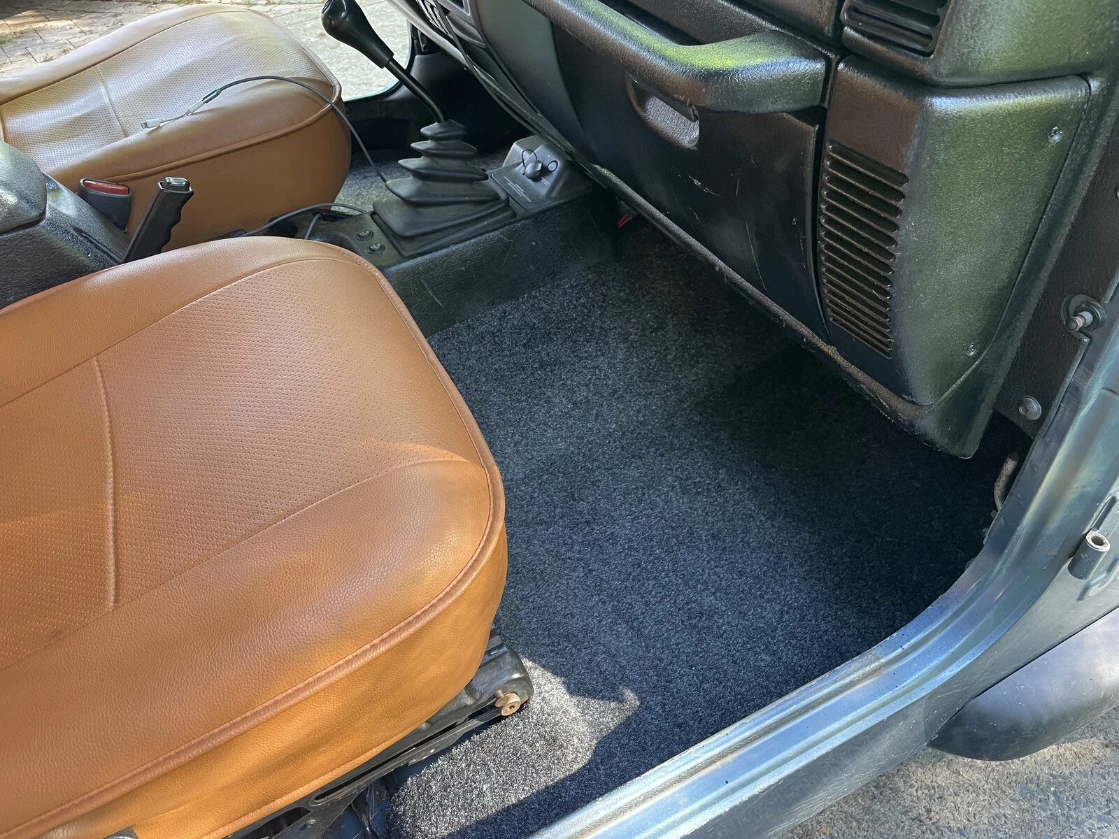

Also wasn’t planning on this, but randomly saw somone on eBay selling a bedrug kit for $100. I decided I would regret it if I didn’t buy, so that came today, and I put in the front portion of it.

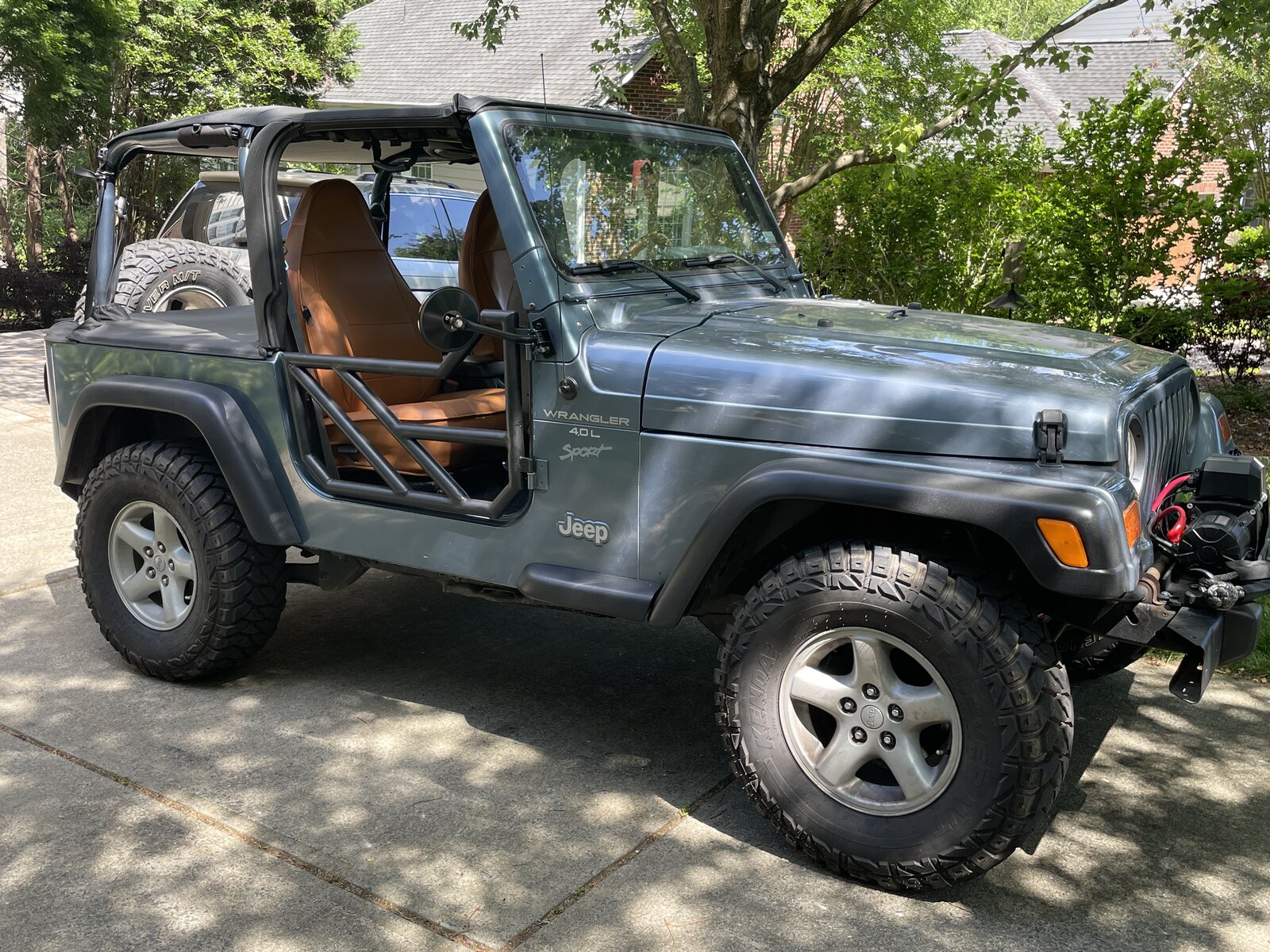

Adjusted the latches on my doors so they don’t rattle, and then painted the doors. I used the black spray-on bedliner that rustoleum sells at lowes. I’m very happy with the finish.

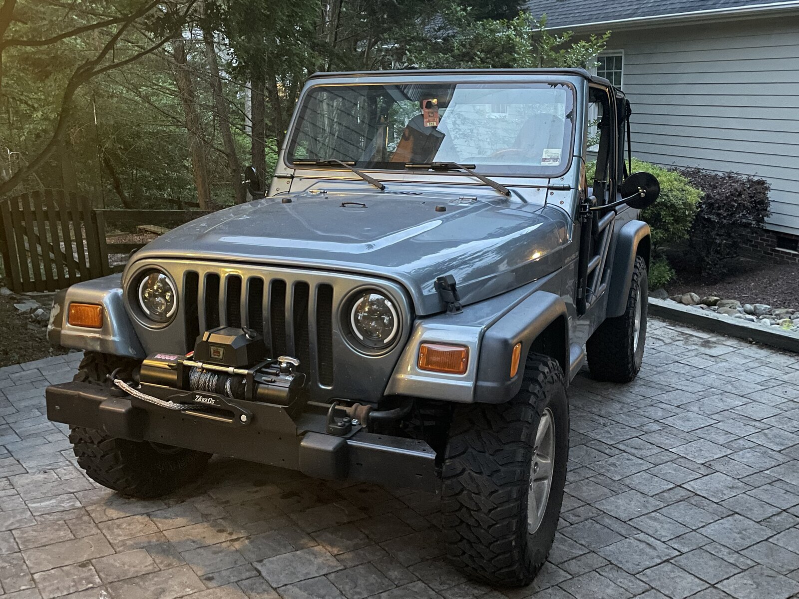

Mirrors are coming tomorrow from Amazon, I’m unsure if I want to bolt them to the windshield hinge bracket where they are meant to go, or if I want to just weld them onto the doors. I’ll figure that out though tomorrow I guess.
Had to drive about 2 hours total today to and from work, (I referee soccer games, had 6 today, 7 yesterday) Did that in my moms old minivan since it was all highway and didn’t feel like driving the tj with half doors on the highway. But when I got home, I wanted to go for a drive in the tj. Fortunately, my mirrors came a couple days ago, so I got those on and drove with the tube doors for the first time. I love them!

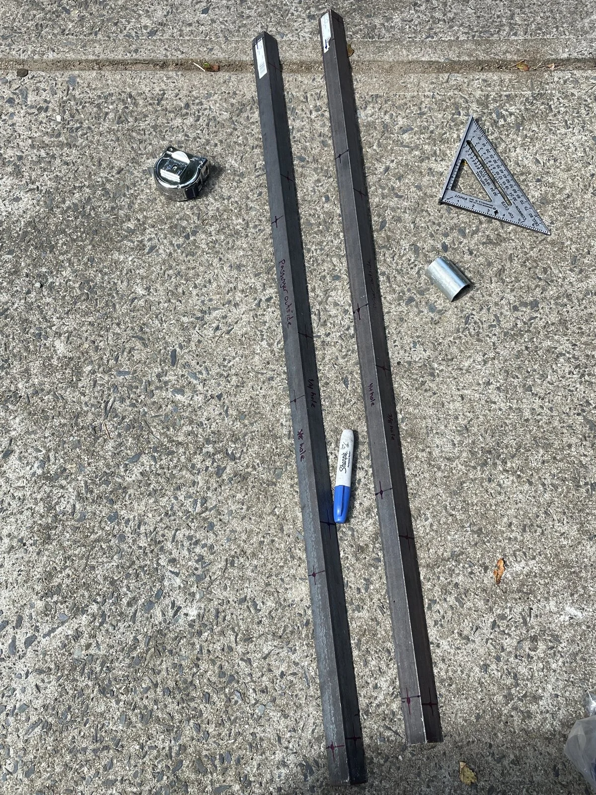

Built rock sliders today! Nothing super fancy since I don’t plan to use them for anything super fancy. Just there for protection. All I need to do is paint them and then bolt them on tomorrow. They bolt on through the side of the tub, and will also tie in underneath to the torque boxes. I know the pictures aren’t the best, I was in a bit of a rush today to try and finish them in just one day.

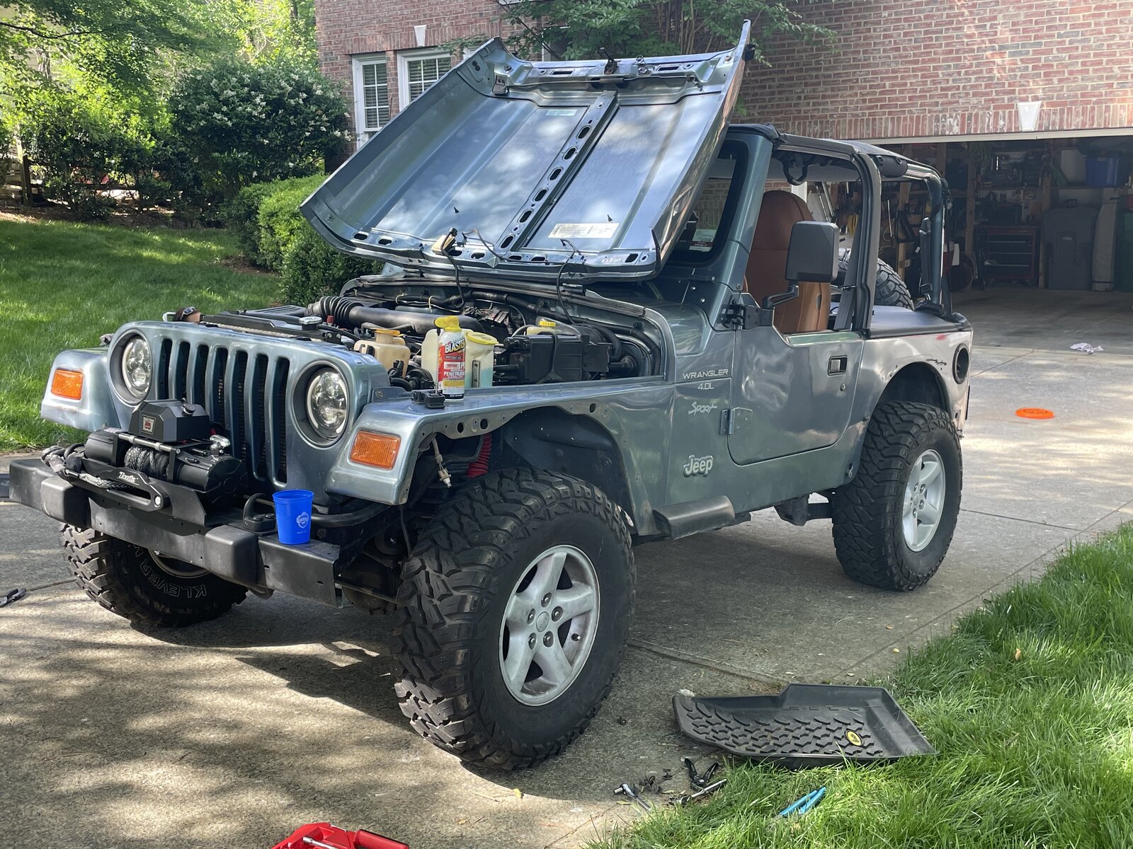

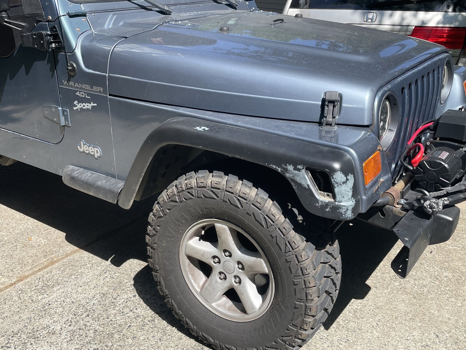

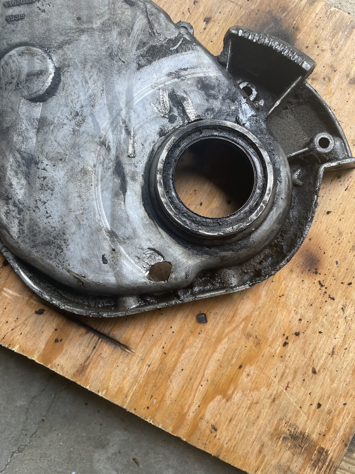

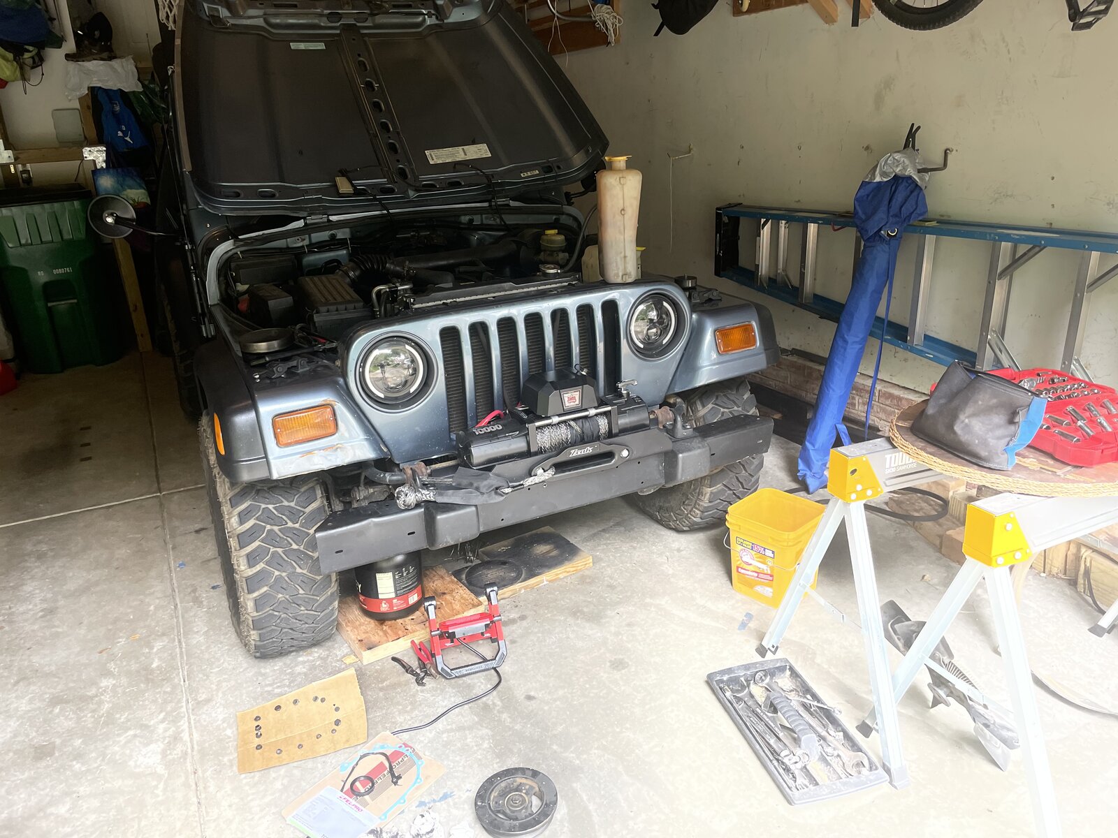

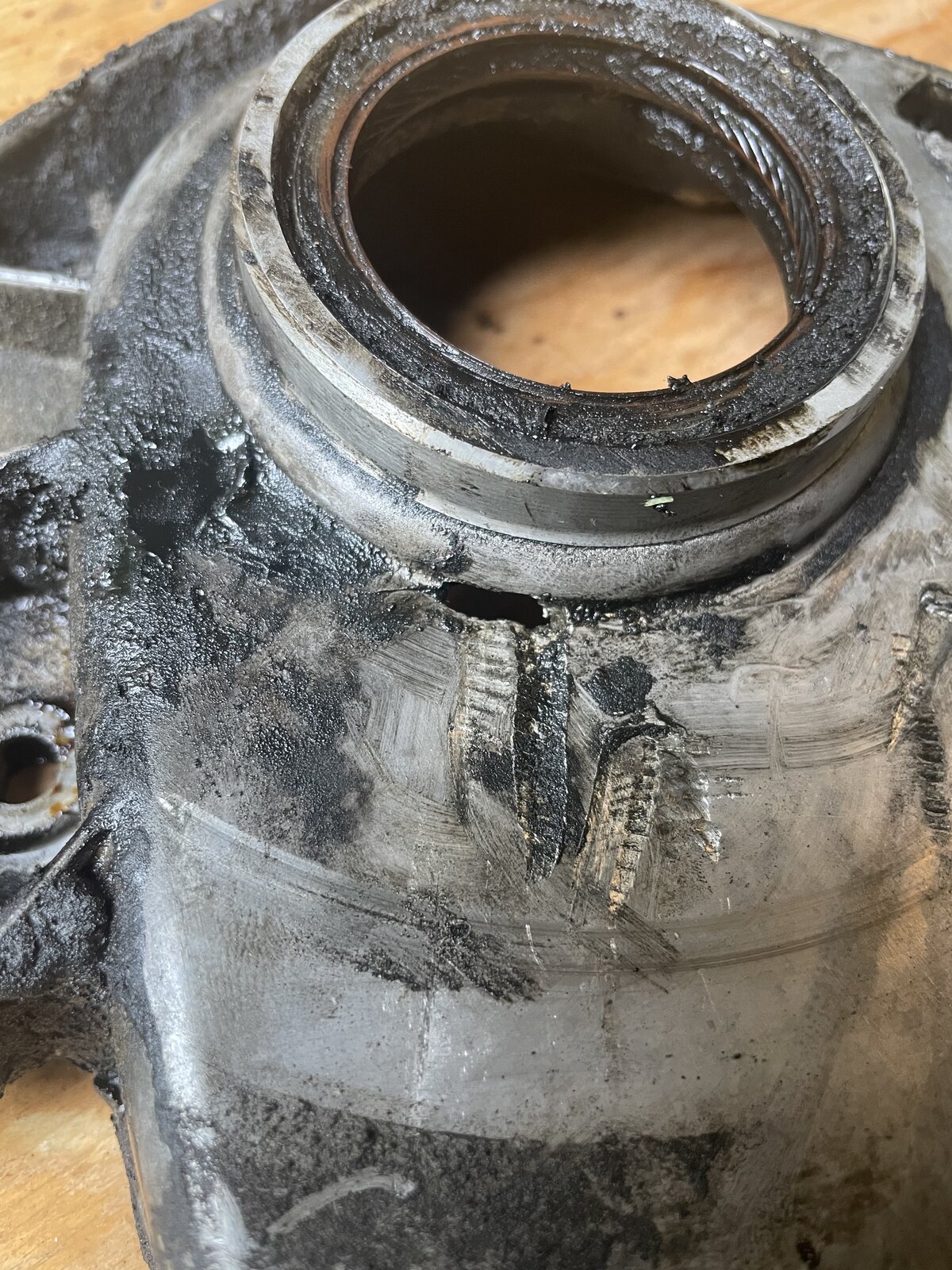

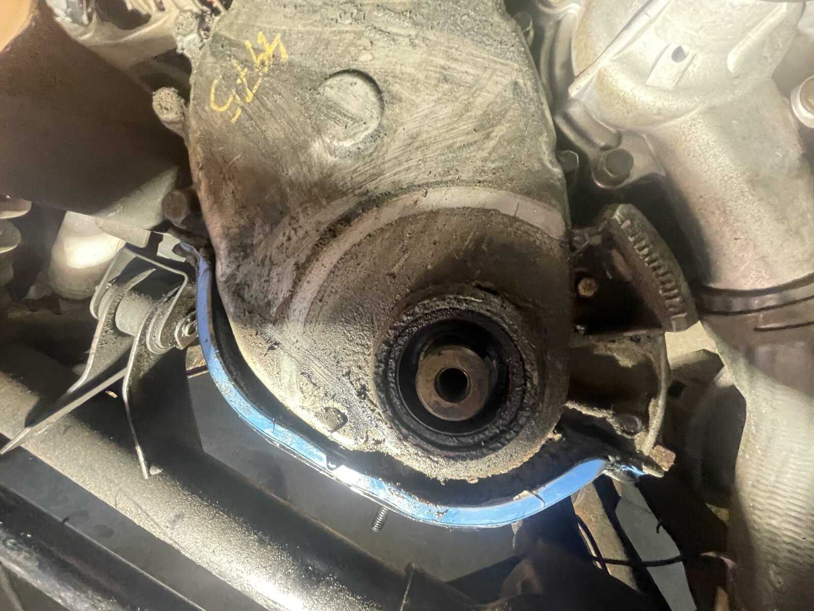

On Friday, I decided I would finally try to figure out exactly where my small oil drips from the front of the engine were coming from. It had always looked like the front of the oil pan gasket, but I was sure that I had installed it perfectly last time and didn’t feel like doing it again for such a small leak. I looked a bit closer and was pretty sure that it was actually coming from above the oil pan. Assuming it was the crankshaft seal thingy, I took apart the front of the jeep and pulled the harmonic balancer pulley off. I found this:
It looks like a previous owner had tried to get the pulley off by prying it with a screwdriver and ended up popping through the timing cover. Today, I got the cover off and found that there’s actually two holes…
While I’ve got this apart, I decided a new timing chain isn’t a bad idea. So a new to me (used oem) cover, gasket kit, and timing chain assembly are all supposed to come on Friday.
Additionally, when taking off this cover, I destroyed the oil pan gasket and just decided to buy a new one instead of doing the small replacement thingy that comes in the Felpro timing gasket kit. So I took the oil pan out today, and while I was at it, got the tailpipe of the exhaust out so I can paint it black sometime soon if I find the time.
I hate to see the jeep sit in the garage for a full week, but it’s for good.

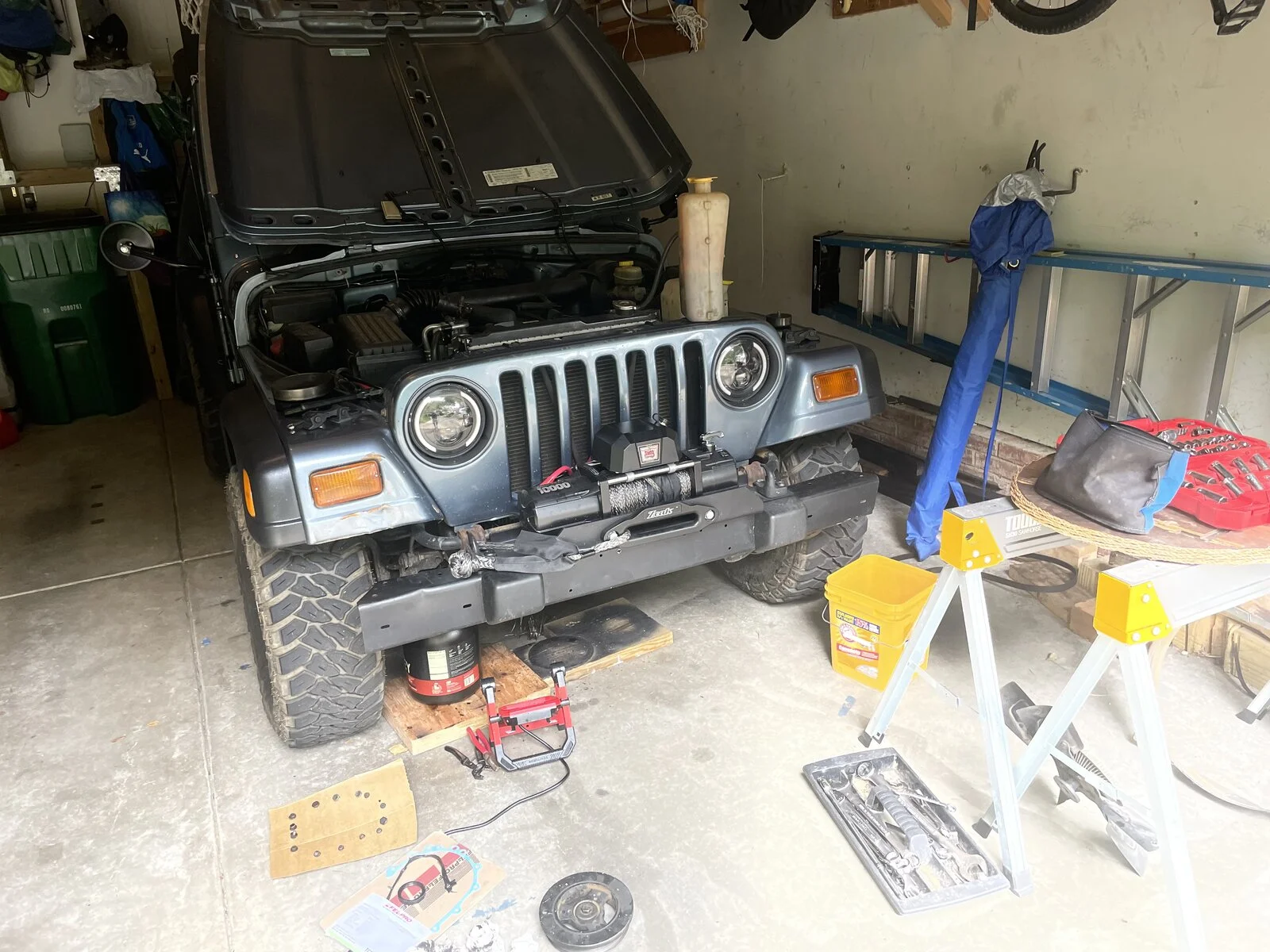

I sold my old smittybilt soft top on Friday and bought a bestop trektop nx which should come on Wednesday. I’m beyond excited about that. Also got daystar .75” spacers from a fellow forum member which I’ll get installed this week on the front end to level out a bit more what the winch weighed down. It’ll be a busy week, but fortunately I only have two half-days at school for exams, otherwise, I’m done for the year.

Good find on the cover. (y)
Do you plan on changing the chain guide while you're in there? I would, if it were me. I'm not sure, but it may come with your chain.
