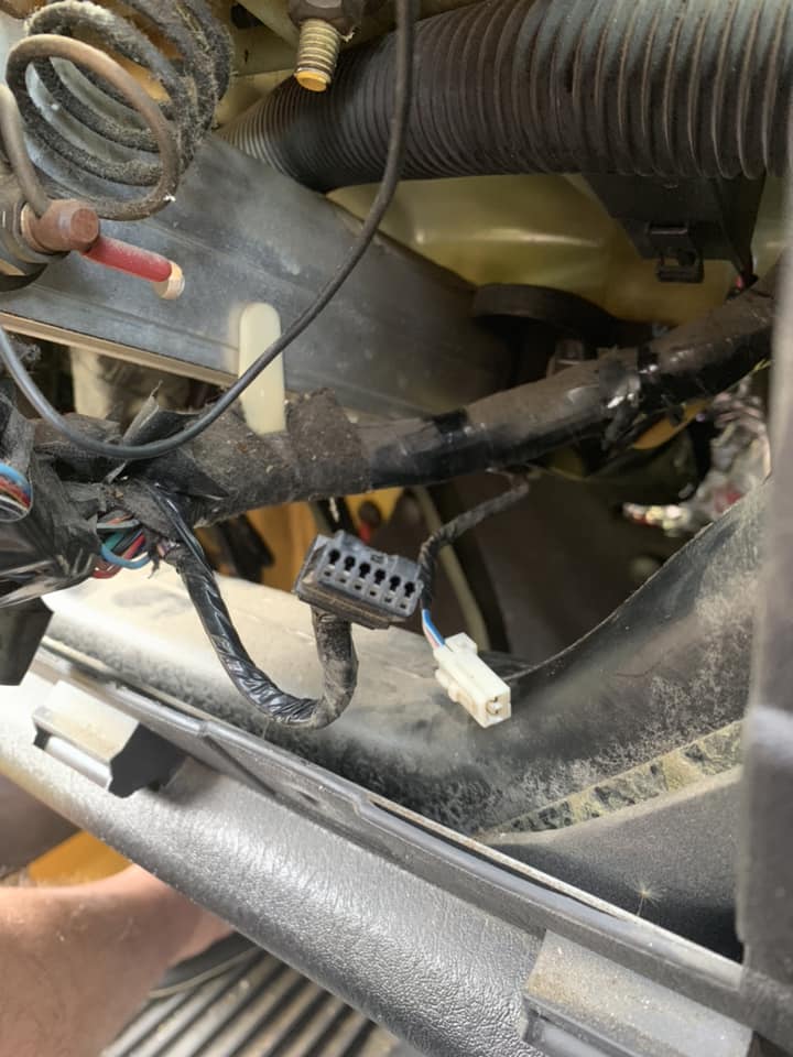

Anyone know what these wiring harness plugs near steering column go to?
atlantatjowner
Jun 25, 2018
43
Atlanta
Anyone know what these 2 plugs could be coming off the main bunch of wires near the steering column? Rear Defrost , cruise or rear wiper maybe?
black plug looks like the SKIM (Sentry Key Immobilizer Module) plug but not yet sure of the white plug
How did you make out in identifying those two plugs? I have the same scenario after taking apart dash to change heater core. I don't remember unplugging those two.
