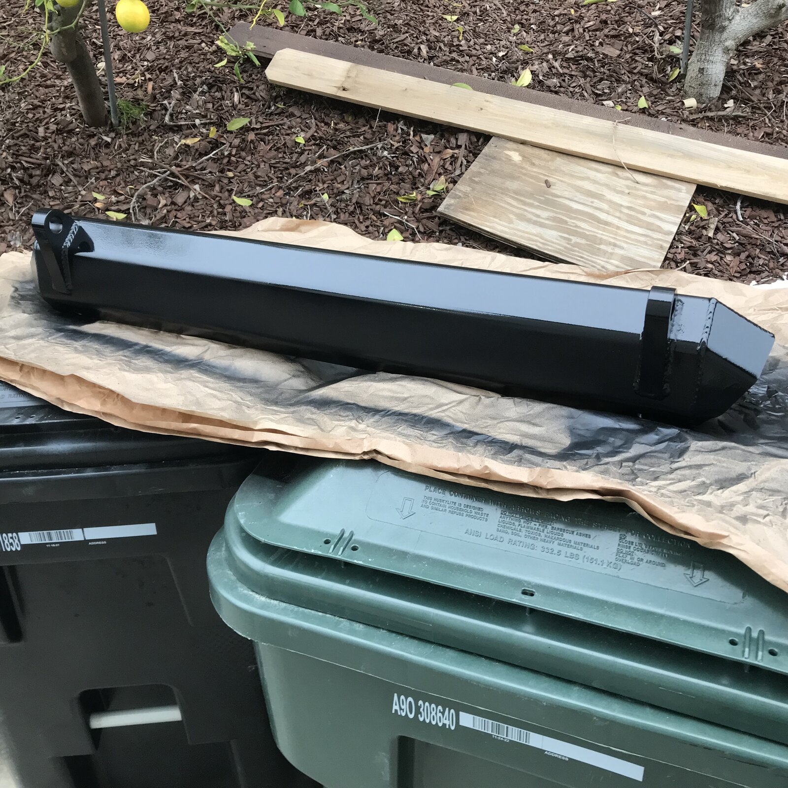

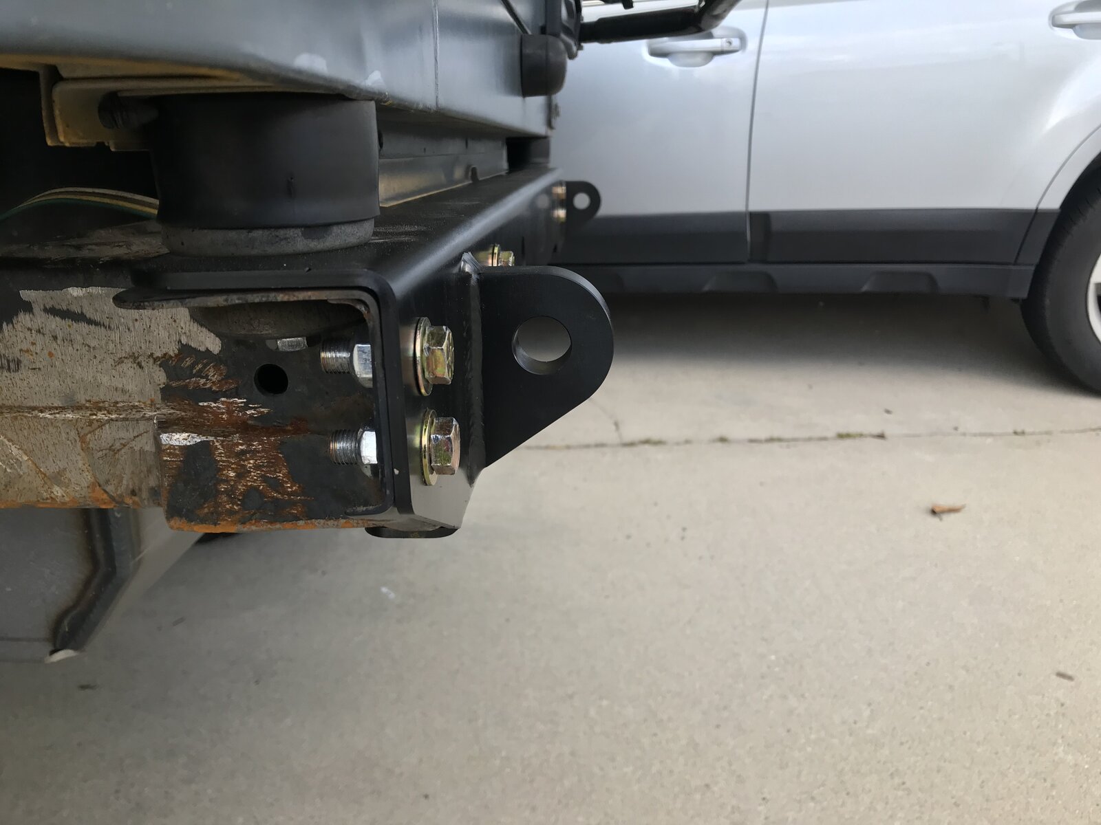

Finished installing the Genright rear bumper this afternoon. Straightforward install requiring removal of the four rear body mount bolts and drilling four holes through the crossmember. Bumper protrudes 3/8” from the crossmember, which should help with the LJ’s departure angle.

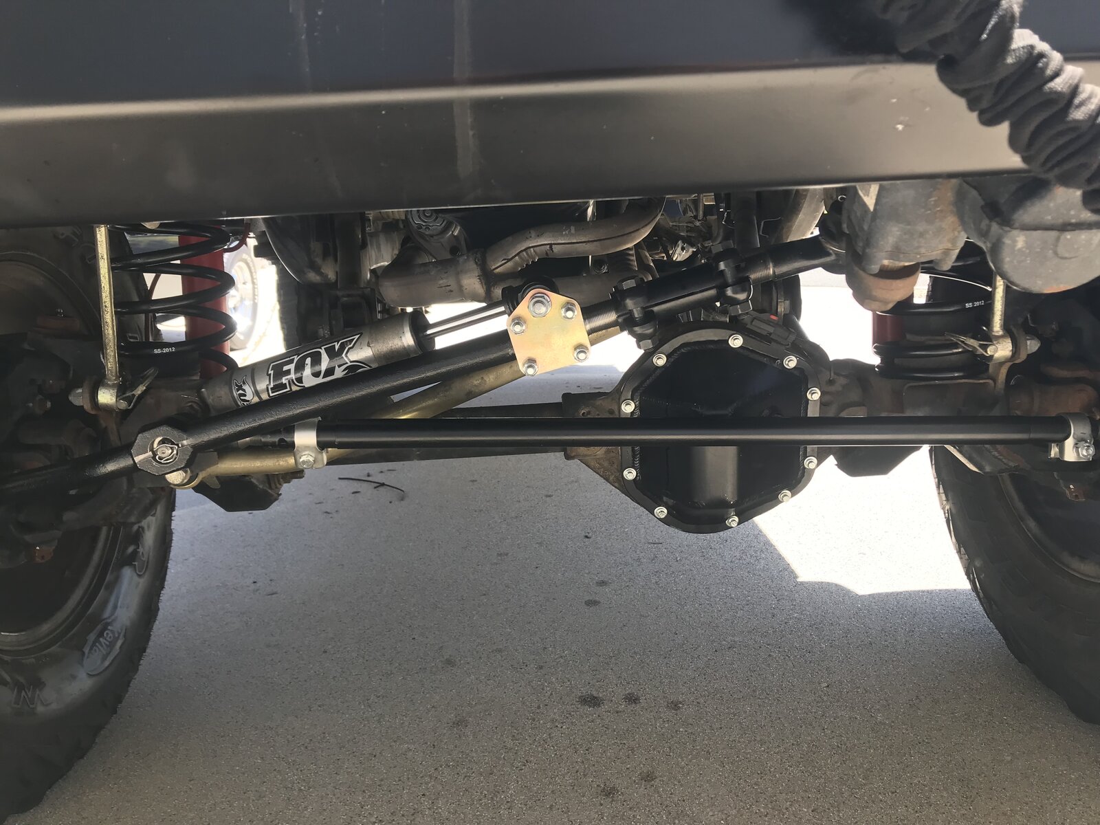

Also installed the Currie steering last night while the suspension was torn apart. Easy install and fit perfectly. Oil stains are from my 67 Firebird not the LJ. Rear main and oil pan seals are perfect with no leaks.
