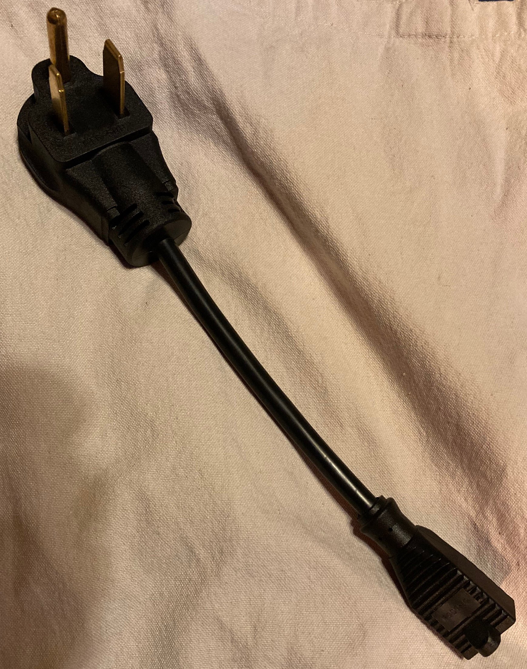

the welder has an adapter for 110 standard female to TT6-50P male plug

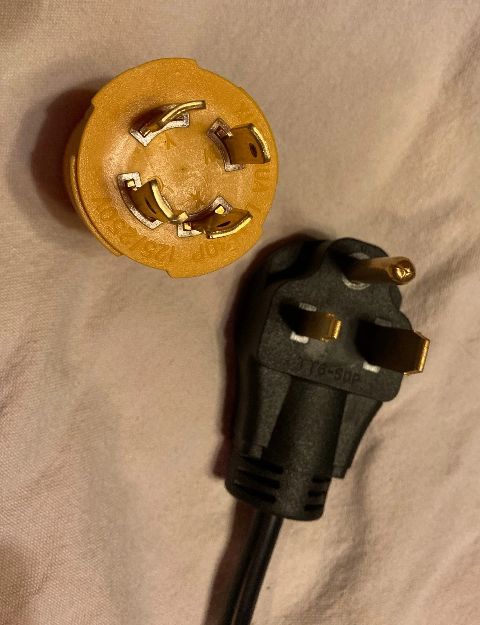

generator has an L14-30R female outlet
Here is where you may have a problem. The number after the hyphen in a NEMA plug or receptacle # is the current rating. Your welder's plug has a plug rated for 50A, but your generator has a receptacle rated for 30A (because it's a 3600W generator, which is a 30A generator). Your generator will may not be able to provide enough current to weld everything your welder is capable of welding.
Edited: will changed to may, since it depends on the actual load your welder draws, not the plug capacity.
can i just get a 110 female to L14-30R male adapter to run the new welder, or is there much more involved ???
the 3 wire vs 4 wire thing is where i'm at a loss. definitely not an electrician ...
You need an adapter to go from the twistlock to the 6-50 but it only needs the 2 hots and a ground, it doesn't need the neutral. May have to build one.
BTW there is no such thing as a "TT 6-50" per NEMA, it's either a 6-50P meaning a 3 wire 50 amp plug or a 6-50R meaning a 3 wire 50 amp receptacle. "TT" stands for "Travel Trailer" and the Chinese must have been confused when they made the plug. There is only 1 "TT" designated configuration "TT-30" and it is 3 wire 30 amps 120 volts and nothing on the planet uses it except an RV. (You have one on your generator).
edit: I see Sab already explained it

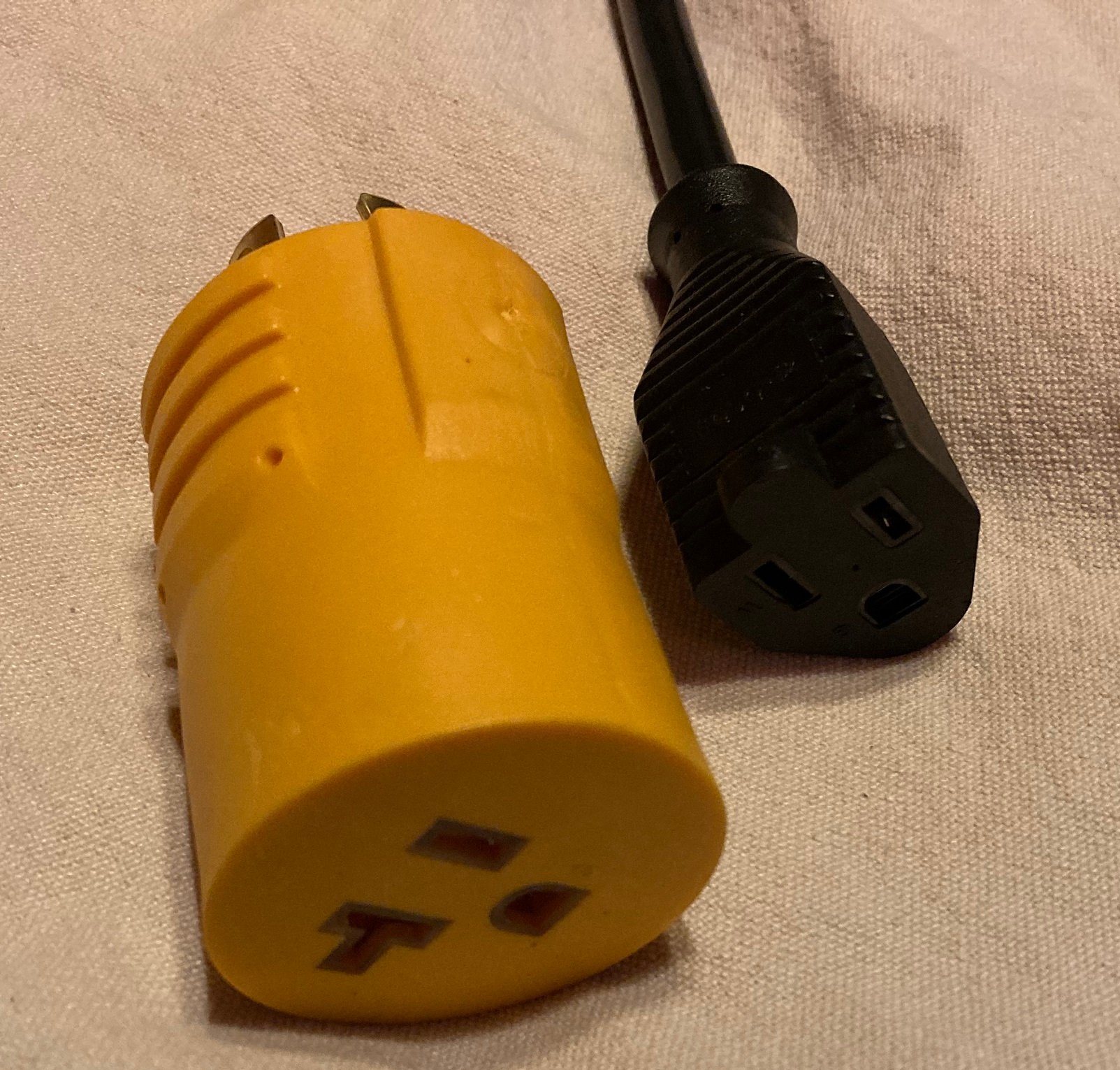

alright fantastic.
again, not deeply knowledgeable so the adapter that came with the welder is a 7" whip. the adapter i got is just a plug block.
i assume, but would like conformation that i'm all good here.
thanks
Probably best to plug each adapter in and test to see what is present at each end. The store bought adapter likely will only give you 120 volts so you won't be gaining anything. It would not be safe to sell an adapter that puts 240 volts on a 120 volt plug configuration. The whip that came with the machine is likely the same, 120V only
I guess it's possible the one that came with the machine would give you 240 if plugged into a 650R wall socket. I take it the machine came with just a 120V cord? My Miller Maxstar which I bought used only had a 120V cord but I made adapters and I cut off the 120V plug and went twist lock so there could be no "accidents" with an adapter. A continuity test on the whip would confirm what blade on the 6-50P goes to what socket on the 120V end, if it does deliver 240 then look for a twist lock to fit the generator with a 6-50R on the other end. Or make one with a twist lock male, some SO cord and a surface mount 650-R https://www.amazon.com/RVGUARD-Surface-Receptacle-Outlet-Yellow/dp/B08CDTZYL7?tag=wranglerorg-20 (I have no idea why they call it "RV Guard", there isn't an RV made that will survive plugging into a 650R.)

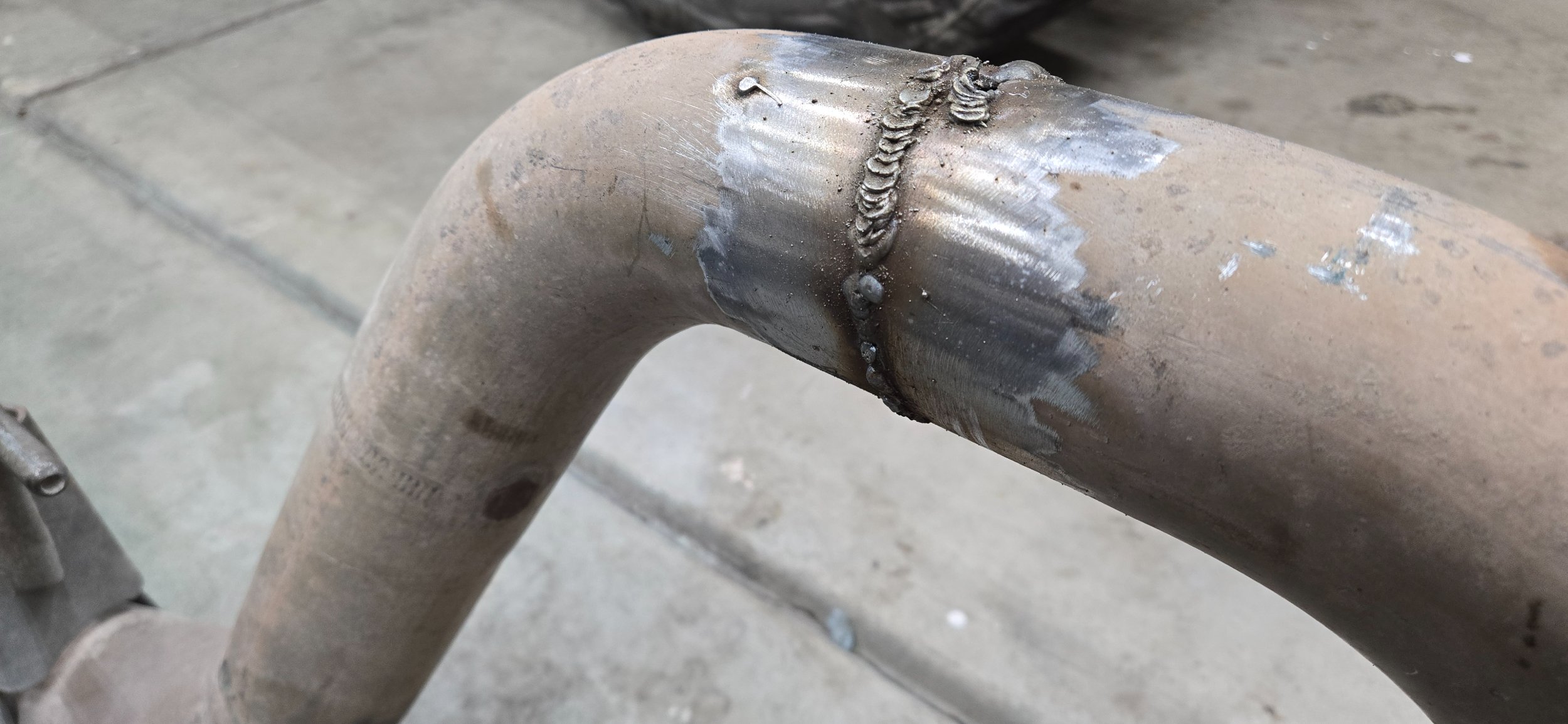

Trying to weld very thin (1/16") pipe that I am 80% sure is aluminized steel. I used a grinder to take off what I thought was enough aluminum coating. I am having weird welds. Almost like the gas is off which I'm still showing well over 100 bar in my tank. Am I still battling aluminum coating?
Constant trigger and I'm blowing thru the pipe, so these are a series of tack welds.

Couple questions:
What wire are you welding it with?
What's your gas flow CFM?
What are your machine settings?
Did you grind the inside?
Is the tubing closed off on the ends?
Do you have a fan blowing near by?
Couple questions:
.030 wire
20 cfm
17v, 1180 ipm
Filed the inside to knock down some thin cuttings that were left over from when the pipe was initially cut.
Its an exhaust pipe that I am rebuilding, so open on either end.
No fan, closed off garage.
.030 wire
20 cfm
17v, 1180 ipm
Since it's exhaust tubing, it's probably the impurities from inside the tube causing the problem. You need to grind to shiney metal on the inside & out.
