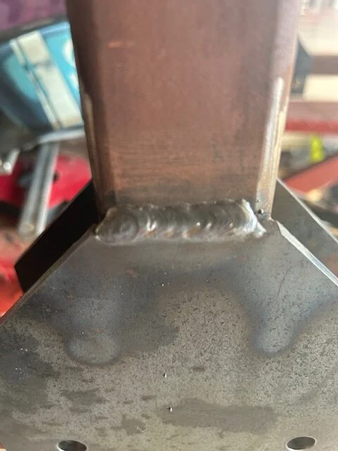

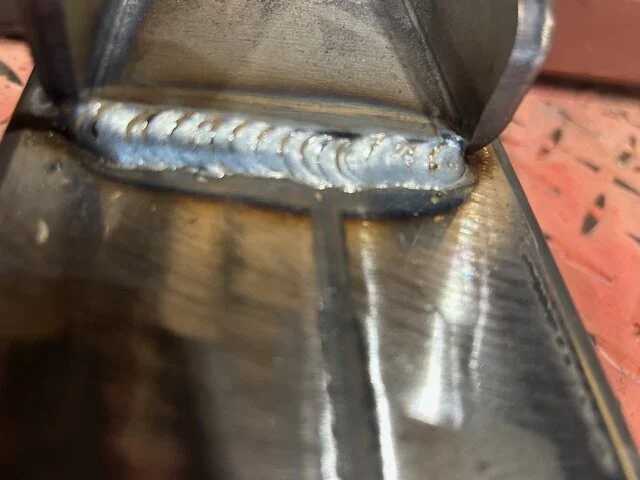

At KOH we had to tig weld a couple brackets for the first aid kit to the rear of the chassis.
Predator generator and an Everlast tig machine. I had low expectations, but it 100% didn't look like it was done it the desert with a machine I would never consider and a Chinese neighbor hater generator.
