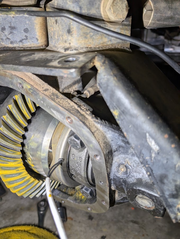

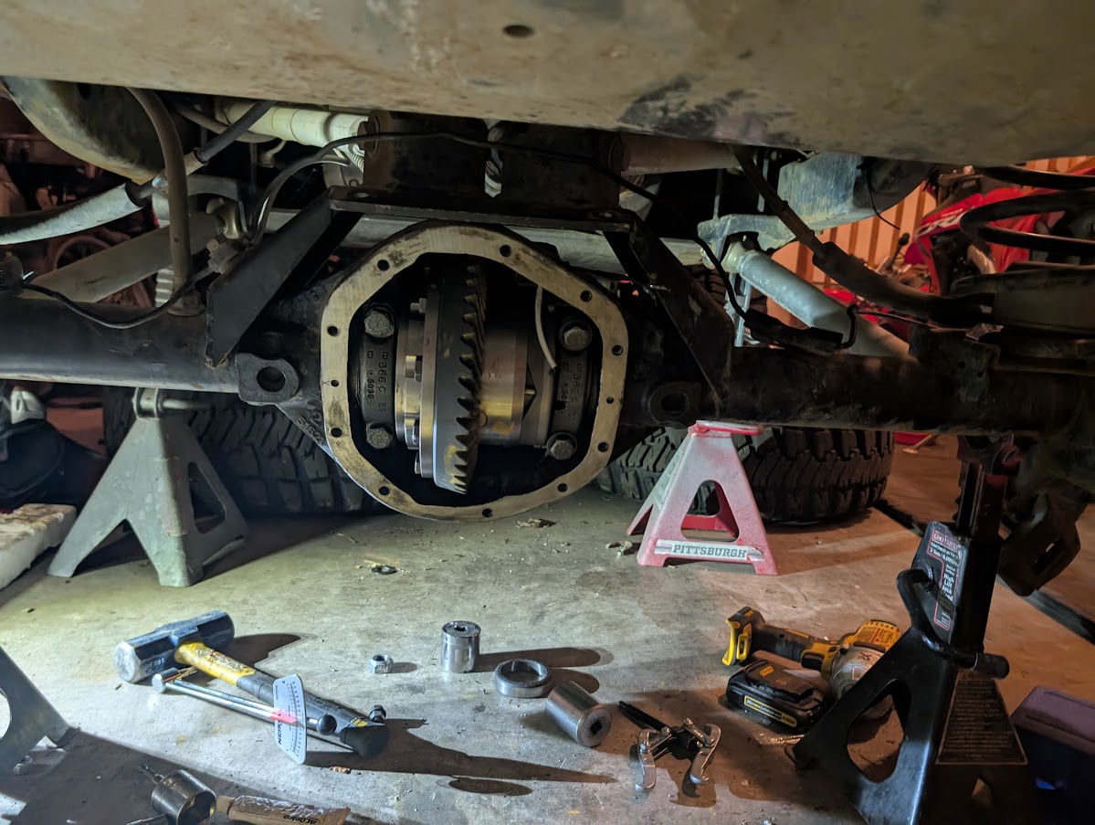

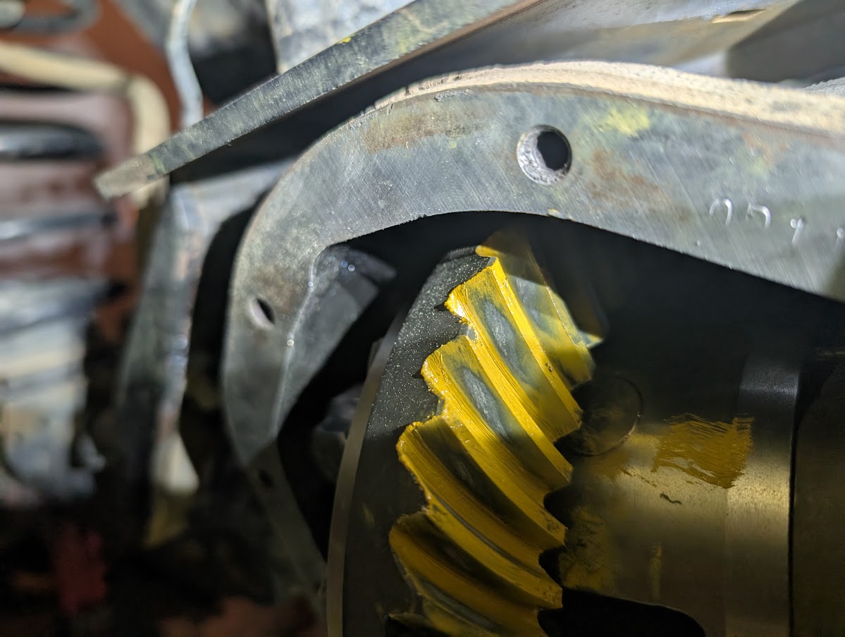

It took me a bit longer than expected, but I finally got the new 4.88 ring and pinion and Eaton ELocker installed in the Jeep. I just took it on its maiden voyage — a Father's Day adventure with @Lonewolf to the first crossing of Fordyce.
Originally, I planned to reuse the old gearset to save money. But since I had thick-cut gears for the stock Rubicon locker and ordered the Eaton ELocker for carriers sized for 3.73 and up, I had to buy a standard-cut 4.88 set. Not a huge loss, since reinstalling the old gears without noise might’ve been tricky anyway.
Overall, setting up the gears wasn’t too bad — just a lot of measuring and pulling the carrier in and out. Once everything was in and I wired up the Eaton, I was a little nervous when the locker switch didn’t do anything. I double-checked the wiring and moved to the locker end. Turned out I had too much preload, and the actuator couldn’t engage. I removed a bit of shim from each side, and on the next test, it worked flawlessly.
It also worked great on the trail once I realized I hadn't plugged it all the way in, and the connection was unhooked. :censored:
