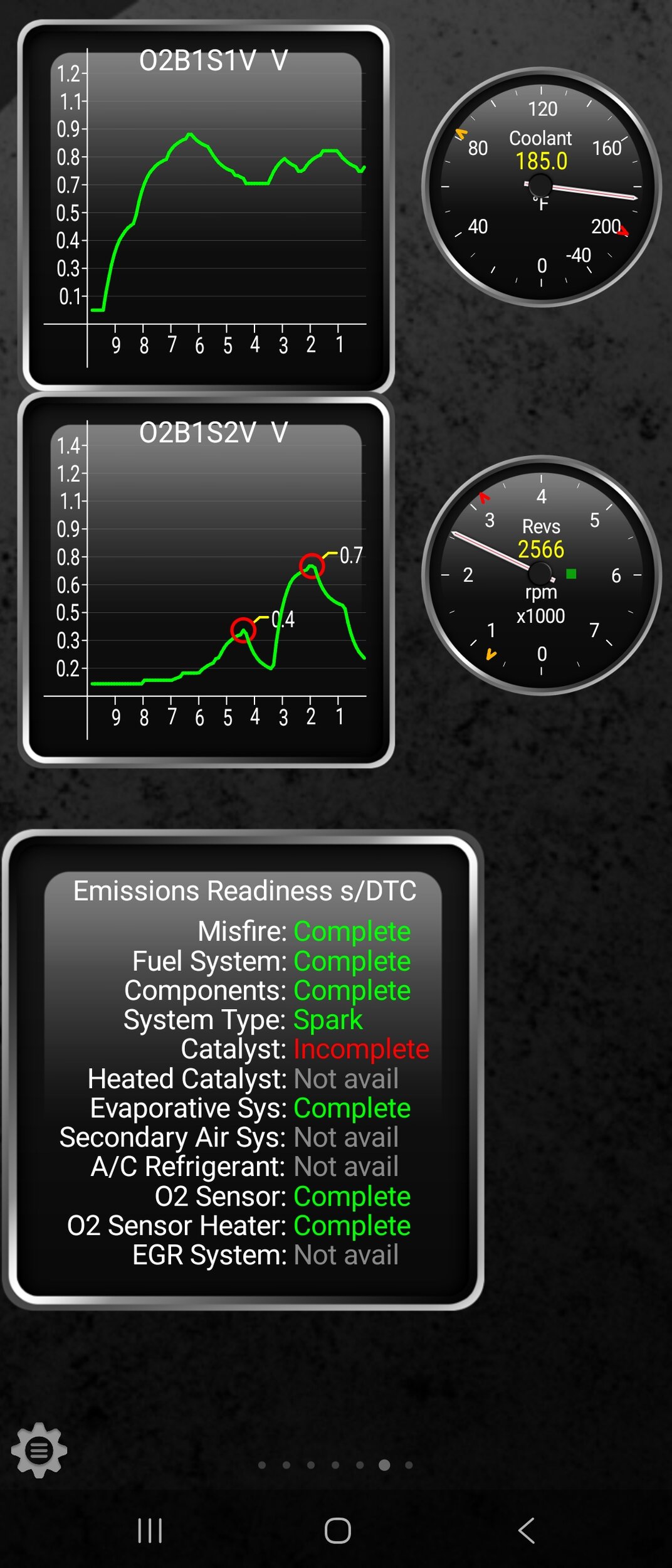

I've been sitting with the catalyst marked as incomplete for a little over 80 miles now. what is that testing for? I have two new o2 sensors on order they seem to be reading correctly but their obviously very old.

I'm not certain it's the same on the 2.5L PCM, but I know my 04 4.0L with pre-cats is still in it's warmup cycle until the coolant is hot enough to open the thermostat. It has a 195 t-stat and as I understand it runs a bit rich with advance pulled a bit to fire up the cat temps. But the target voltage is like .490 on the 2nd O2 on closed loop. The upstream at .8 is reading rich like you see at wide open throttle while the downstram is reading lean like the cat is doing it's job or there is an exhaust leak at the sensor or the flange to the exhaust downstream. Or the sensors are bad. Or you've got a bad cat, but the drop in voltage suggests not.
