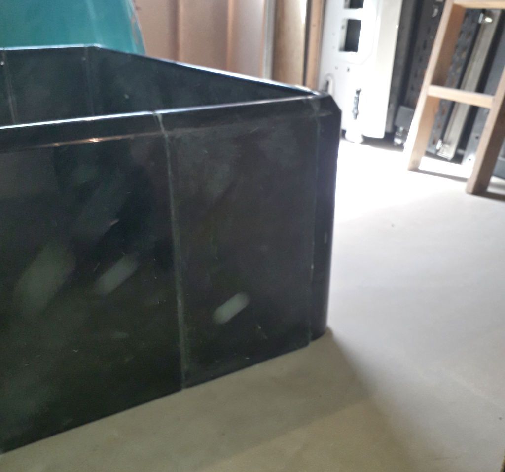

I built the teardrop shell as a proof-of-concept for the framing components; once I assembled the basic shell and proved the concept I put the parts aside and haven't done anything with them since then. They've been in a storage room in my basement for the past few years.

I might consider letting go of the prototype teardrop shell; I don't have any further plans for it and it is taking up space here

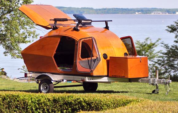

I mainly just camped in a tent growing up and have never really wanted a travel trailer till now. The issue now is that my wife’s idea of camping is courtyard Marriott at minimum. So we recently started looking at campers. We found this one that we liked made by this company Luna. I really love the design but we would only be able to tow it with are jl because of the weight.
So we started looking at other campers, that’s when I found this tear drop kit from clc boats. What makes it appealing is the fact that they designed it light enough to be towed by a Mini Cooper . This is good for me because that means I would be able to tow it with all my vehicles including my fiesta st.

One thing to remember with the kit from CLC boats is the upkeep on an all timber teardrop. If you look at RV's as a whole, the main problems are water ingress and the damage it does as a result.
Theres also nothing wrong with a wooden framed camper as long as the wood is kept either enclosed in a protective outer shell (like the Bushwaker in the message above) or if you do decide on a all timber camper you need to look after it like a wooden boat and treat it as a labour of love.
Theres a heap of teardrop manufacturers in the USA and some really nice models being produced.

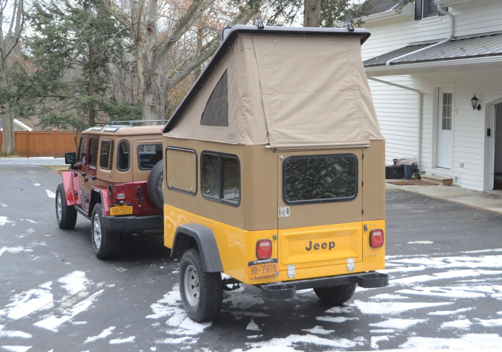

The yellow trailer is also 11.5" longer then the Dinoot Extended. I made it that long because I intended to use it as a platform for developing the lid and cabin components and I wanted it to be long enough to sleep in.
If I let that lid go I'd just have to make another one because I use the same lid and canvas with this configuration:
Everything is designed so the lid and canvas works with or without the larger cabin, it's easily to change the configuration.
I use the lid all the time hauling stuff in the trailer, in fact my daughter called me just yesterday and asked if I would help her move in two weeks so the trailer (with the larger cabin) will soon be loaded up with stuff from her apartment.

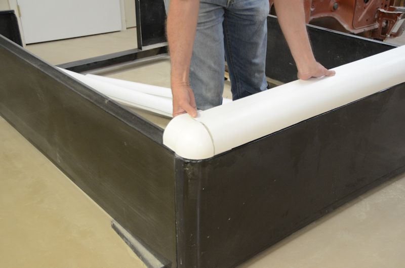

The lid is made from only two fiberglass parts - rounded corners and straight pieces with curves to match, plus plywood to fill in the middle. Dinoot did talk to me about licensing the two pieces that are used to make the lid (pictured below), but they wanted me to make some changes to the design so it didn't go any further than that initial discussion.

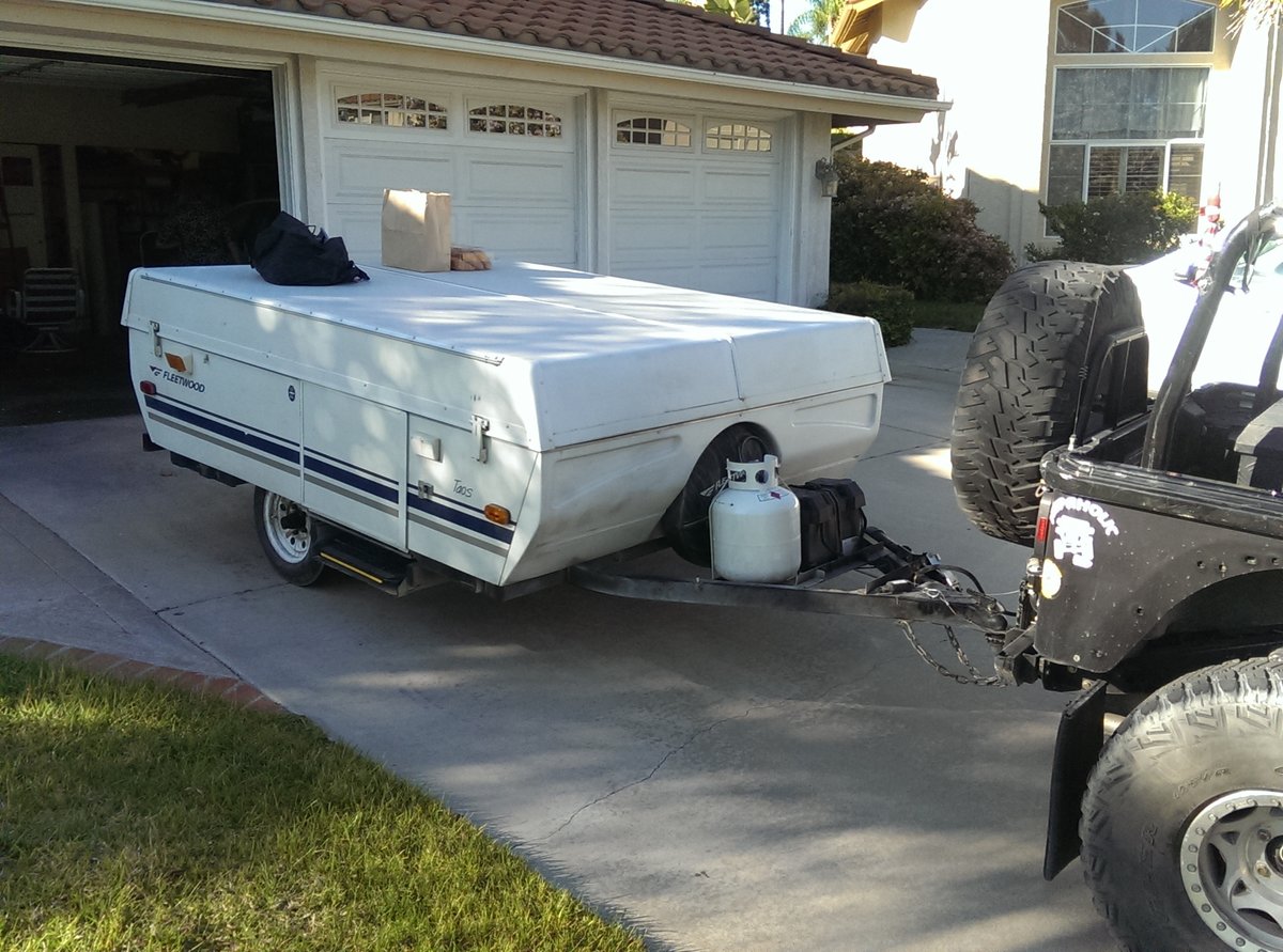

Ooohhh I like that! But I think I'm pretty well stuck with my Coleman Taos Popup as I couldn't sell it for enough to make a big enough dent in the cost of it.. It is a great tent trailer, I just hate having to crank it up/down.
This is mine (red Jeep is my previous TJ)....
View attachment 144443View attachment 144446
I made a crank adapter for my battery operated impact. It makes going up and don’t fast and easy

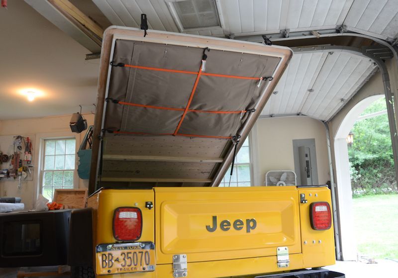

What does the underside of that lid look like on the yellow tent trailer? Did you build a wooden frame for support?
That’s a cool little trailer.
Yes, there's some wood framing inside, you can see it in this photo:
Even though the skin is only 1/4" plywood, it's very strong. Plenty strong enough for a roof top tent and two people.
Also, when the pop-up canvas is stowed it folds against the inside of the lid so the canvas doesn't interfere with any cargo that might be in the trailer.

I am surprised the fiberglass front is strong enough to support the hinges. Did you have to add extra framing in the front of the trailer?
There's a wood flange around the inside of the lid, similar to how the flange on the inside of the TJ hardtop sits on the top of the tub, this flange also sits on the tub. The flange and hinge detail can be seen in these photos below; these were taken when the lid was under construction so the outer skin isn't in place yet nor is the weatherstrip that goes on the bottom of the flange to seal the lid to the tub. The entire assembly is plenty strong.
The fiberglass parts make assembling a lid like this pretty easy, once the fiberglass sides/ends/corners are assembled together it's a straightforward job to put the flange and other framing in place.
And once finished, you can't see where the curves of the fiberglass end and the 14" plywood skin begins, and all the curves match the curves of the TJ tub very nicely.
Reactions: Ron505
BTW the hinges for the lid are "lift off" types, similar to TJ door hinges, so the lid can be removed very easily when the trailer needs to be reconfigured for a different use. For example, if I'm about to carry something that won't fit under the lid (or inside the larger cabin), I can slide the lid off and have an open trailer, or put the tonneau cover on.
