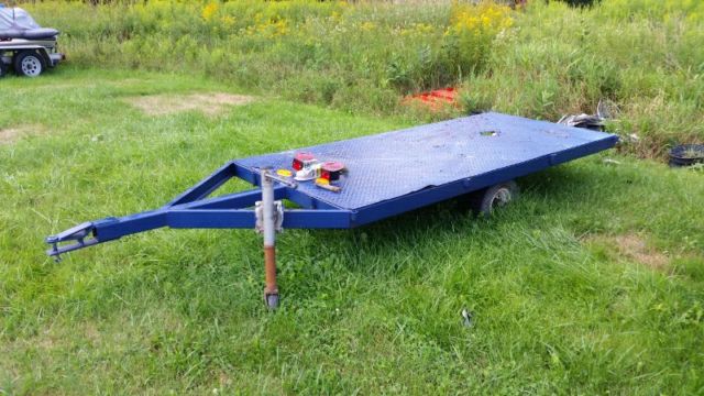

My Jeep themed fibreglass trailer (post #208) is on hold while I work on my square drop build. About 3 years ago I went to look at a trailer that was for sale. That didn't work out but while there I picked up, for next to nothing, one of the ugliest trailers I think I've ever seen. The guy selling it had just bought a farm and was getting rid of things he had no use for. Neither of us (he wasn't a farmer) had a clue as to what this "trailer" had been used for. About a year ago I did some internet searching and am now all but certain that is was once a mobile chicken coup. Basically a farmer pens off an area around a movable coup. After a while he moves the coup to a new area and reestablishes the pen so they can continue grazing. This thing was crude but it was properly welded and as square and flat as can be. For a couple of hundred bucks, and a lot less than the cost of the steel, I figured I could make something out of it.

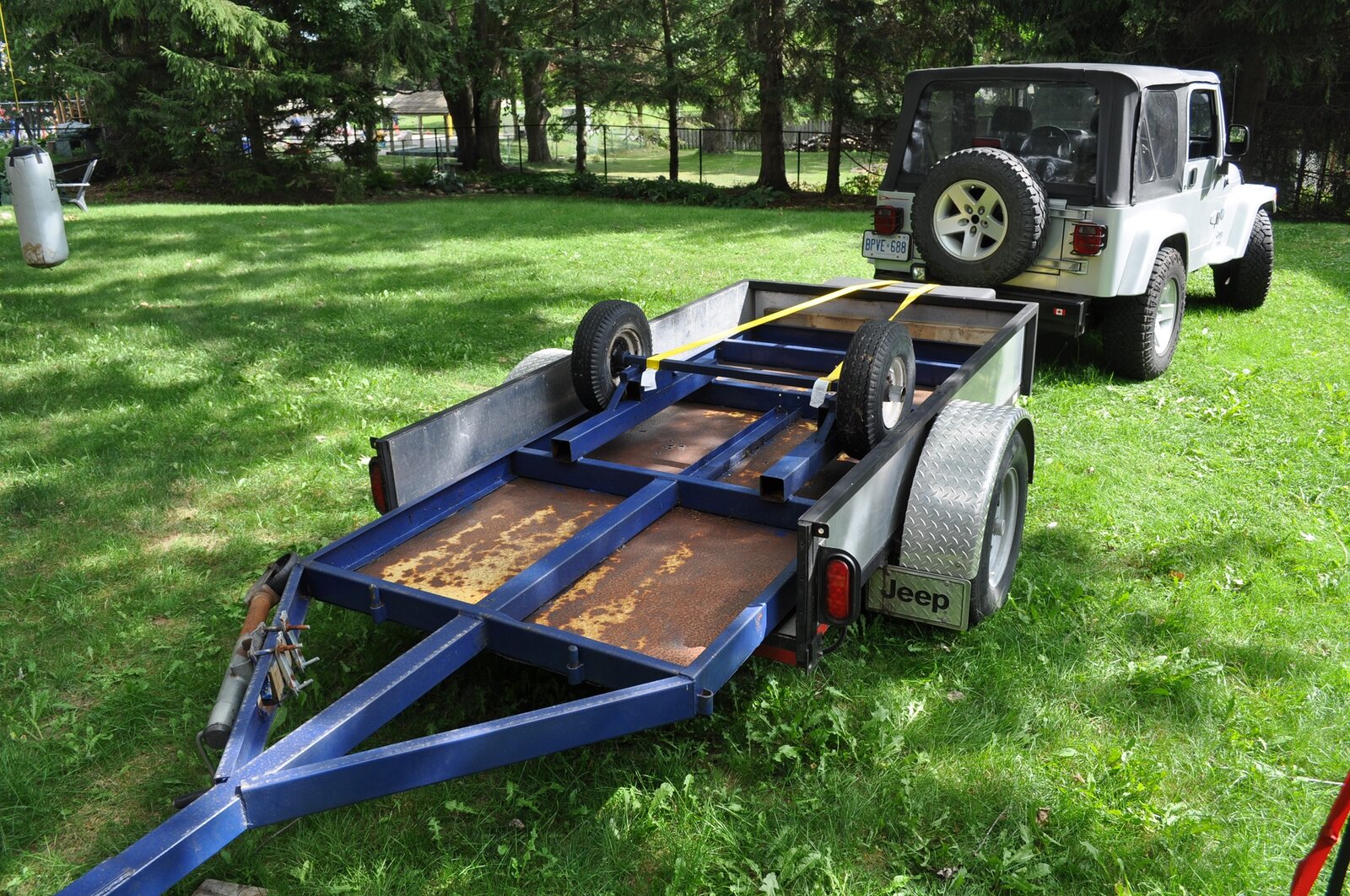

Here it is as I picked it up. I towed it home behind my TJ in a utility trailer I built about 10 yrs ago. The build pics lead up to where it stands now. They're a little hard to understand as it looks a bit like a bird cage ... which seems appropriate given its past. It will be all steel, aluminum and composites to eliminate rot. The only possible exception will be the interior walls which I will likely do in pine T&G.
Note the axle but no suspension. It was towed around a farm field and never on the road. What I cut out I'll be making into a yard trailer for my garden tractor.

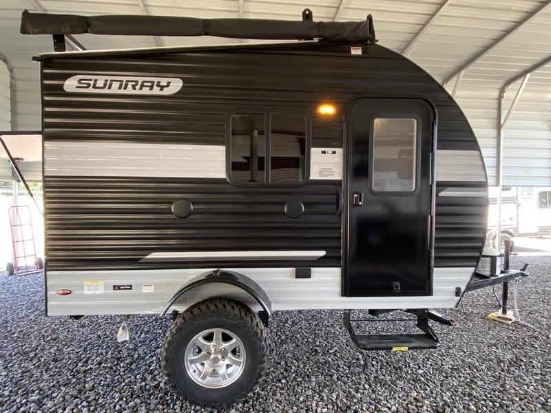

I have been looking at this, Sunray 129 Sport. It is 1840 dry, so a but close, but really checks all the boxes (big bed, air, toilet, etc.) for a reasonable price. Anyone have any experience with these? I am thinking of renting one to try it out.
https://sunsettrailers.com/wp-content/uploads/2022/03/Sunray-3.1.22.pdf?download=false
Ive heard that the build quality isn’t the best and the front window tends to leak… but if you are at least semi handy… go for it. But join the facebook groups for solutions.
