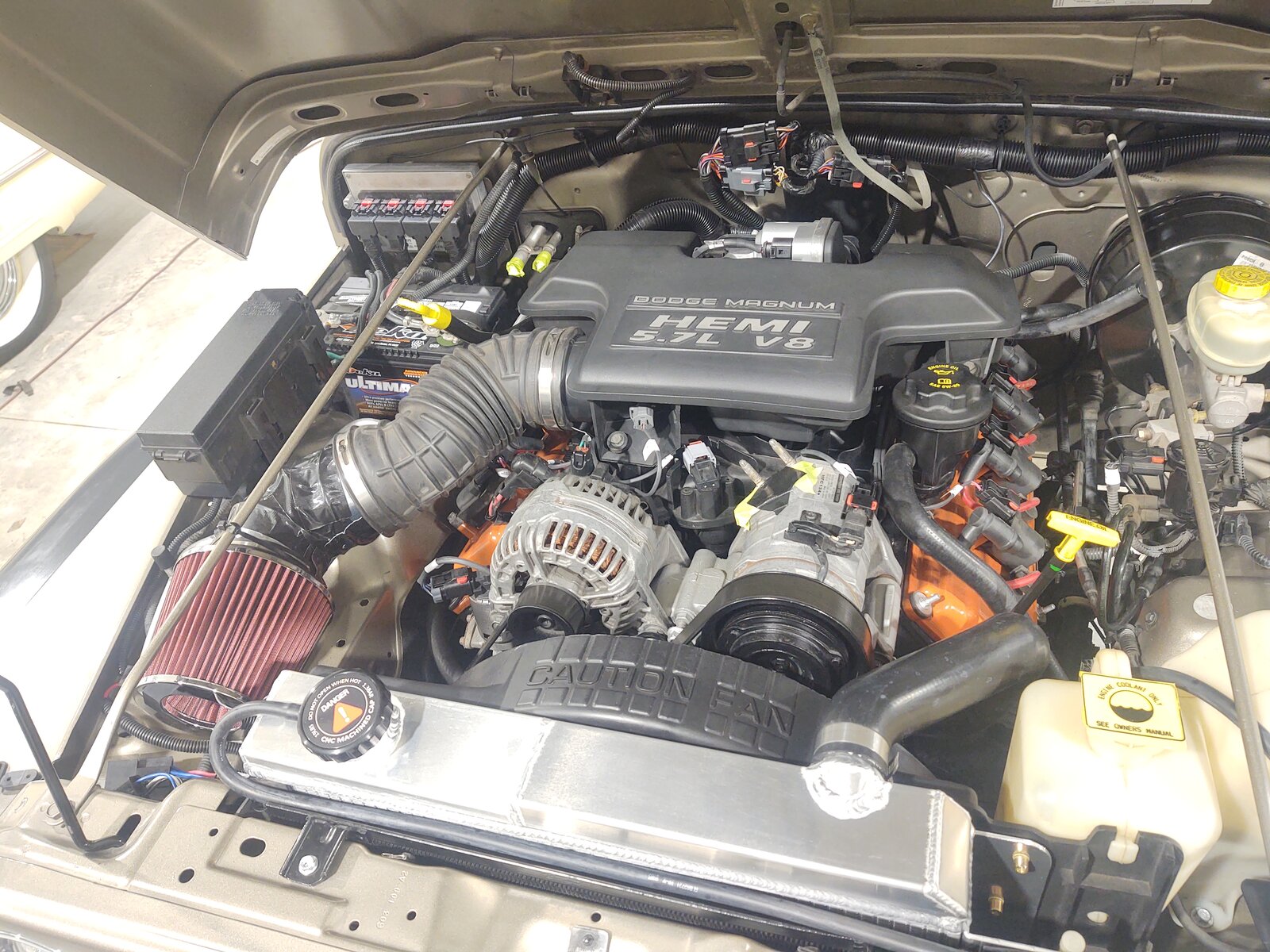

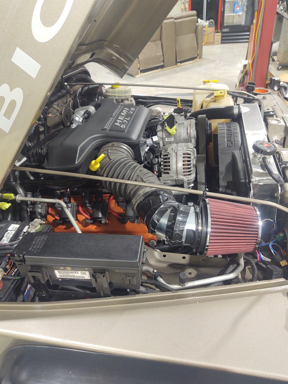

That's something I've been keeping an eye on on mine. Obviously don't have the final components yet, but the parts I have ordered will keep it in the same area. The highest IAT's I've gotten so far have been around 110-115° sitting at a light. Granted, the highest OAT has only been 63°, so I'm sure IAT will increase as the OAT increases. I am fully prepared to fab a heatsheild around the engine side of the filter if necessary. My original plan was to use the factory air box and fab a new lid for the intake hose, but the height and the core support rod was going to make that somewhat impossible. I think one thing that might be in my favor is using the factory exhaust manifolds and I also bought new factory heat sheilds and using them. The biggest reason the factory uses them is to reduce under hood temps and help keep heat in the exhaust.. Those actually might be able to be used with your guys headers if heat becomes an issue. I know you (Nashville) already have yours all dialed in now.
Anyway, just my 1cent worth..
Not the final intake parts, but will remain in this location..
I'm going to move it as far forward as possible to try and get it in front of the fan blast and get cooler air.
I think room under the hood was our biggest issue. Wanting to keep it as stock looking from the outside as possible. Hopefully no temp issues will one up but we’ll keep an eye on it. Your filter is where my AC condenser ended up.
