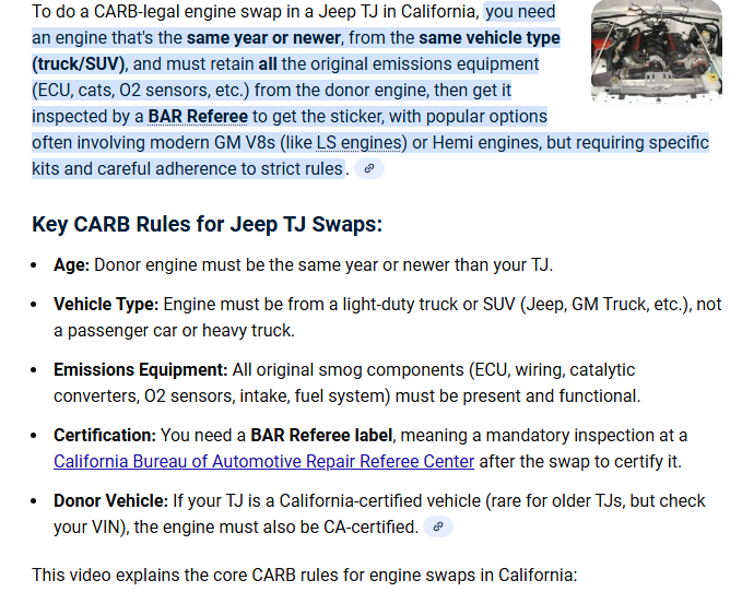

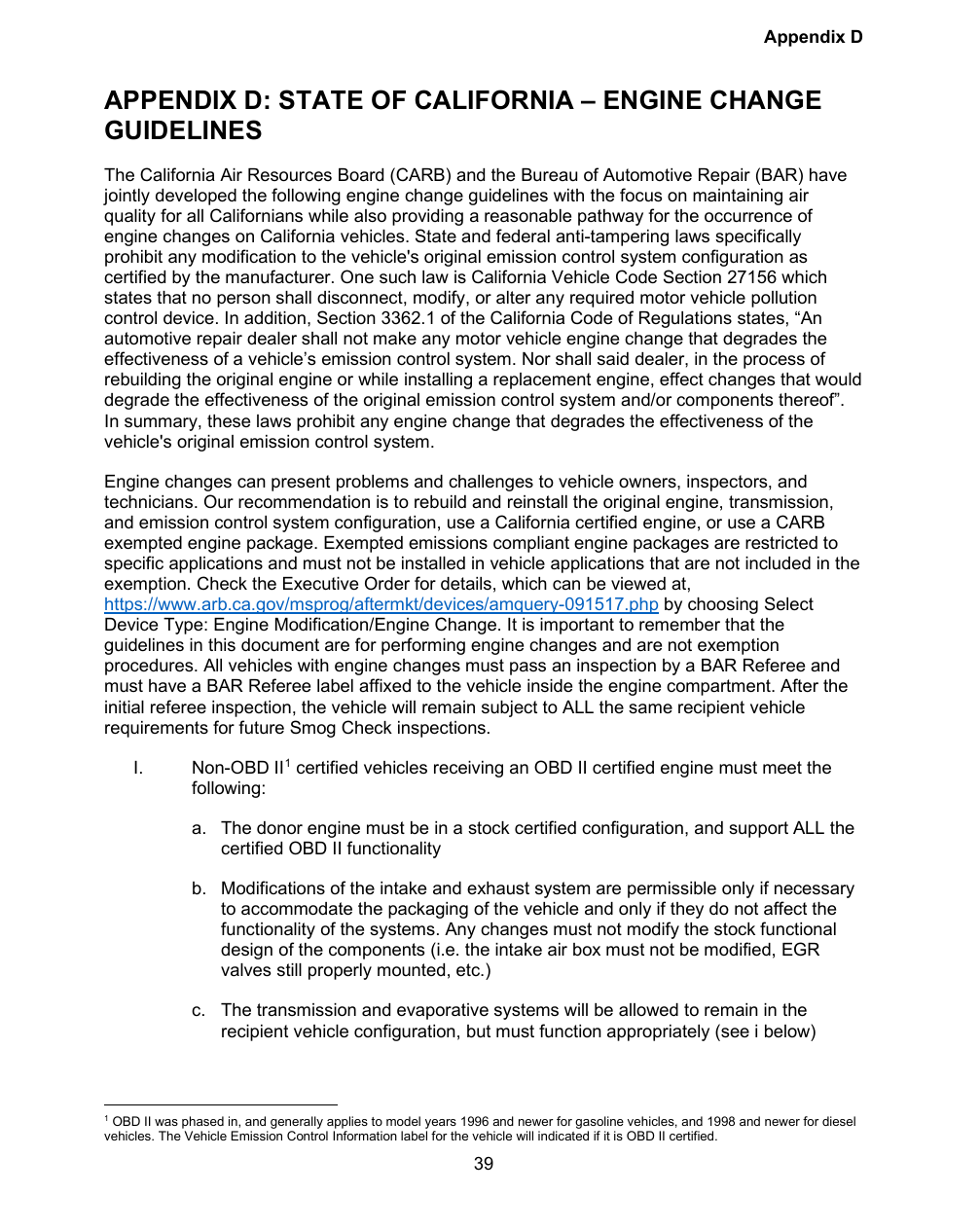

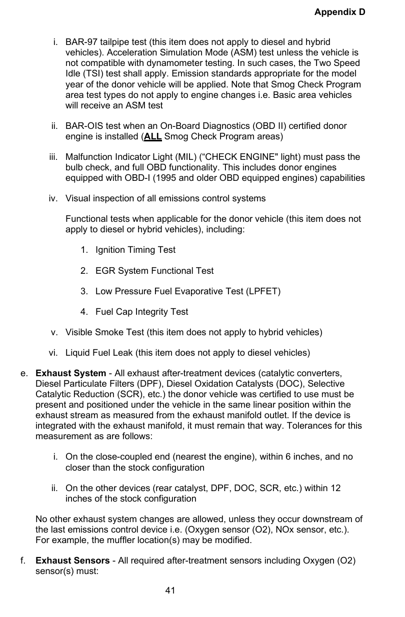

I could be wrong, but being in California I thought our laws are more restrictive on engine swaps, something about the engine having to be an available option for the vehicle it's being swapped into?
AEV sold hemi swapped TJs there back in the day. There has been a shop doing LS swaps into TJs/LJs in CA for ages too. You have to follow certain rules, but it has never been impossible.
It'd be crazy if people actually read the laws instead of just parroting what they were told to think they are.

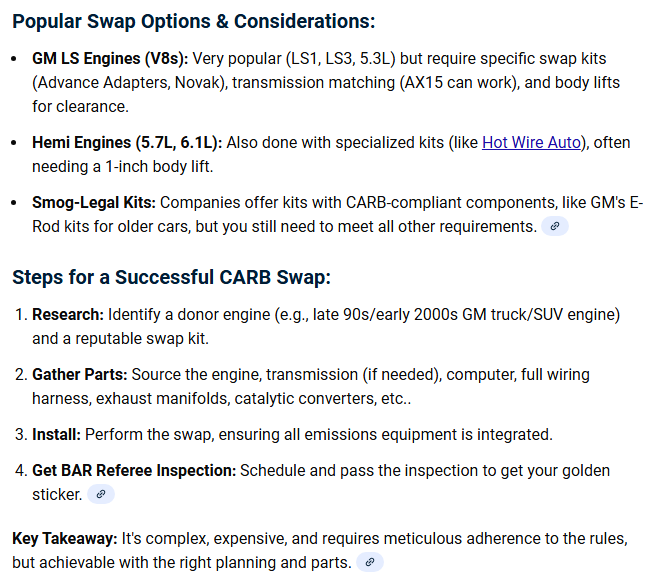

Based on this quick search it looks like you're correct. The engine must be same model year or newer as well.

It's why I said that the "ONLY" way to get an informed answer to that question was to :
1) Contact a shop that does this for a living such as JSS
2) Contact the state CARB station or whomever you have to take it to once you have the swap done.
We can all speculate and post things we find on the internet but getting it from the horses mouth would seem to me as the better way. If you're seriously interested in doing a V-8 swap then I think you'll have to but in some leg work. If it was me I'd contact a shop first and then work my way up to dealing with a state organization.

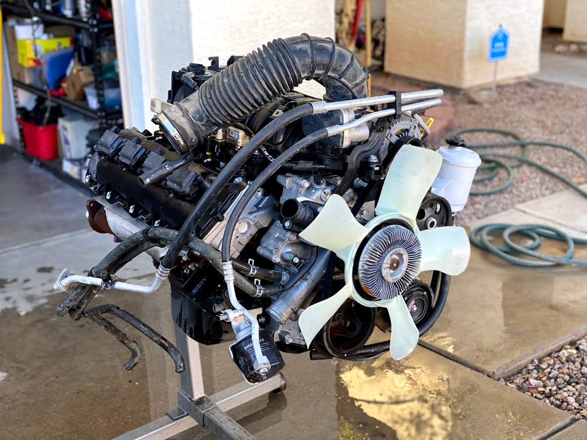

As someone who's done 3 V-8 swaps now let's put this into perspective a little bit.
My first V-8 swap I farmed out to a shop and cost me about $15 which included the engine & transmission. I already owned the Jeep it was going into which I'd bought for $11 so total price was about $26K.
I built the engine for my second V-8 swap and I was into that build for $10K lets say and then $3K for the transmission.
My Hemi swap I bought the donor rig for $3K and then spent about $8K in additional parts. But I had $20K if not more in other parts in my TJ that I put the Hemi into.
My point here being that YES a TJ with a Hemi already swapped into it that is smog legal might garner a hefty $$$$ but if you figure the asking price for the rig without the Hemi 1st then add on the cost of the Hemi & all related parts is that asking price of $50K really that much? Could you build your current rig for less?
If you're like me and already have a built rig then YES I can see wanting to build on it. But if you have a sstockish rig and these rigs with the swapped Hemi are built then figure out what that's worth too..

We'll you haven't really explained exactly what it is that you want....
Are you wanting to go
1) 5.7
2) 6.4
And then
1) 545RFE
2) 8HP70
Once you've decided on those questions then what size tire and then based on that what axles? The stock axles will be OK for up to 35" tires maybe...
Are you doing the work yourself?
If you are you'll want to go through Hotwire for the wiring harness.
