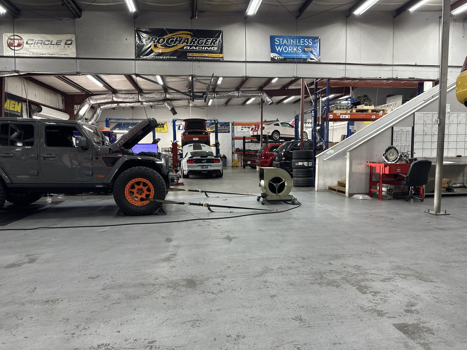

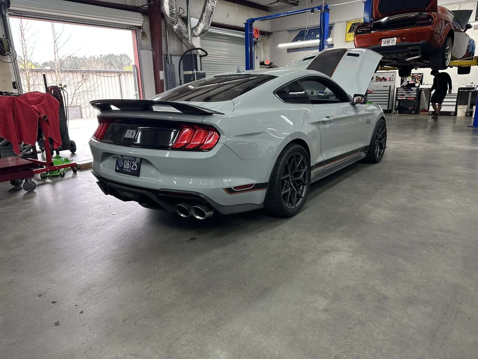

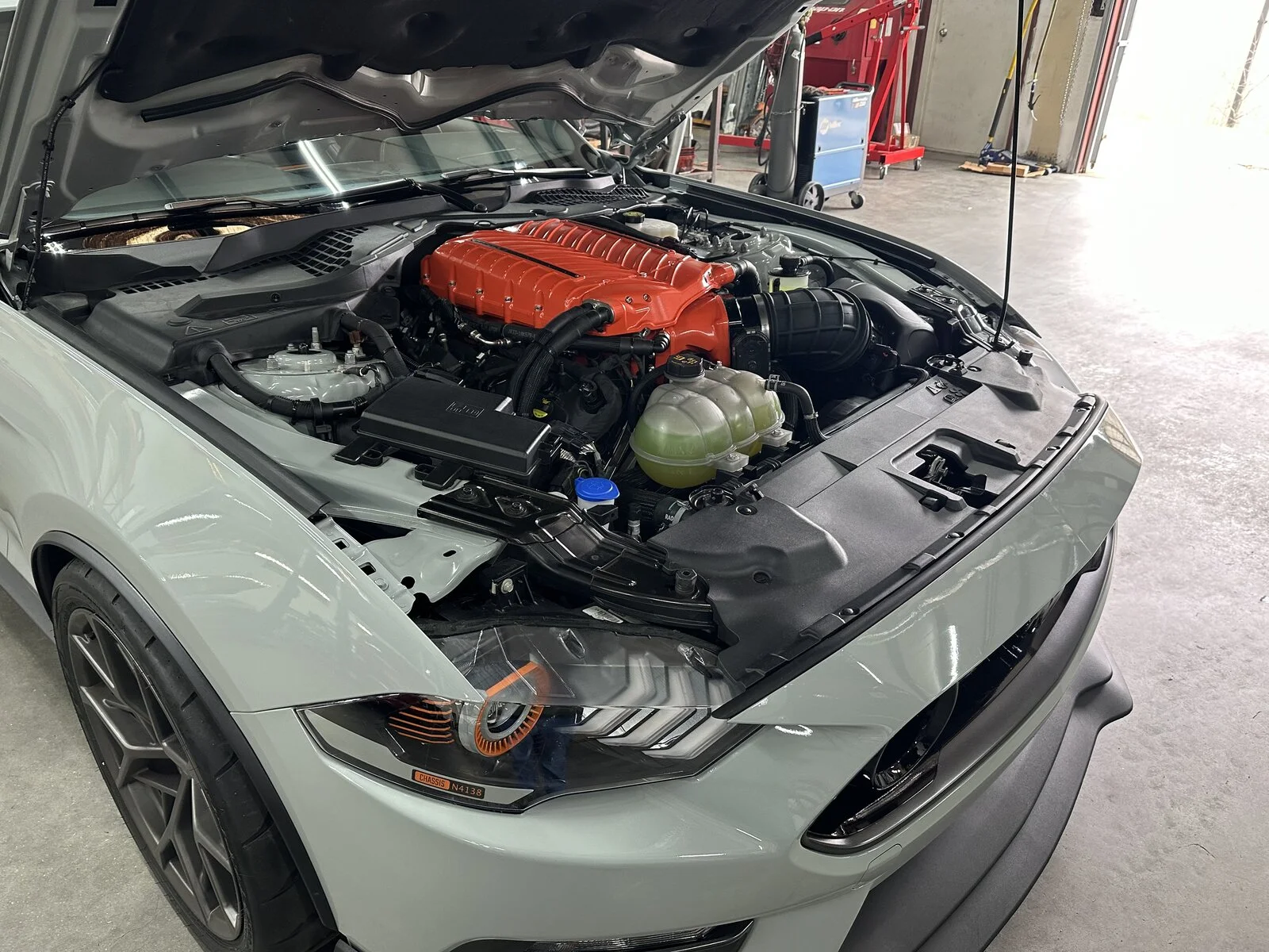

Plenty of toys and project at Injected Engineering. Top notch facility and they know their stuff. The 392 on the dyno got headers from Rocksolid Motorsports where my swap was done. The Mach 1 is a customer of ours and just got a color matched Whipple. One of the best looking and cleanest Mustangs around. The headlights are a custom set from a good buddy at THC Concepts. Hands down…best looking headlights I’ve ever seen. Ran a little behind this morning so I got bumped in line but should be next up.

356/377. Was hoping for closer to 400 but after the drive home and even in the pouring rain, I don’t care at all!!! It feels great going down the interstate at 70 turning about 2300 and still having tons of pedal left. He really didn’t have to do too much on the dyno. The tune in it was used for an automatic they had just finished up. So when you put the clutch in, the RPMs would either hold or climb really quickly. Once he changed that he didn’t have much else to do. Just make sure everything looked good across the board and it did. It does still hold for just about a second at the RPM you put the clutch in, but I don’t mind it. The AX15 will take some getting used to for sure. Caught myself more than once about to change to 6th gear. But cruising at 70 in 5th and rolling into it feels great. I’ll put a few hundred miles on everything before I start getting into it too hard. The only thing I’ll need to address sooner rather than later it the exhaust. It’s a little “drony” inside. 3.5 inch single exit with no cat. First thing I’ll try is a high flow cat but I don’t think it’ll help much if any. I’ll try a couple different mufflers and see what works best. We’ve got a Valvtronics muffler at the shop I may try just so I can flip over to open headers if I ever wanted to. But all in all it’s way better than I could have hoped for.
