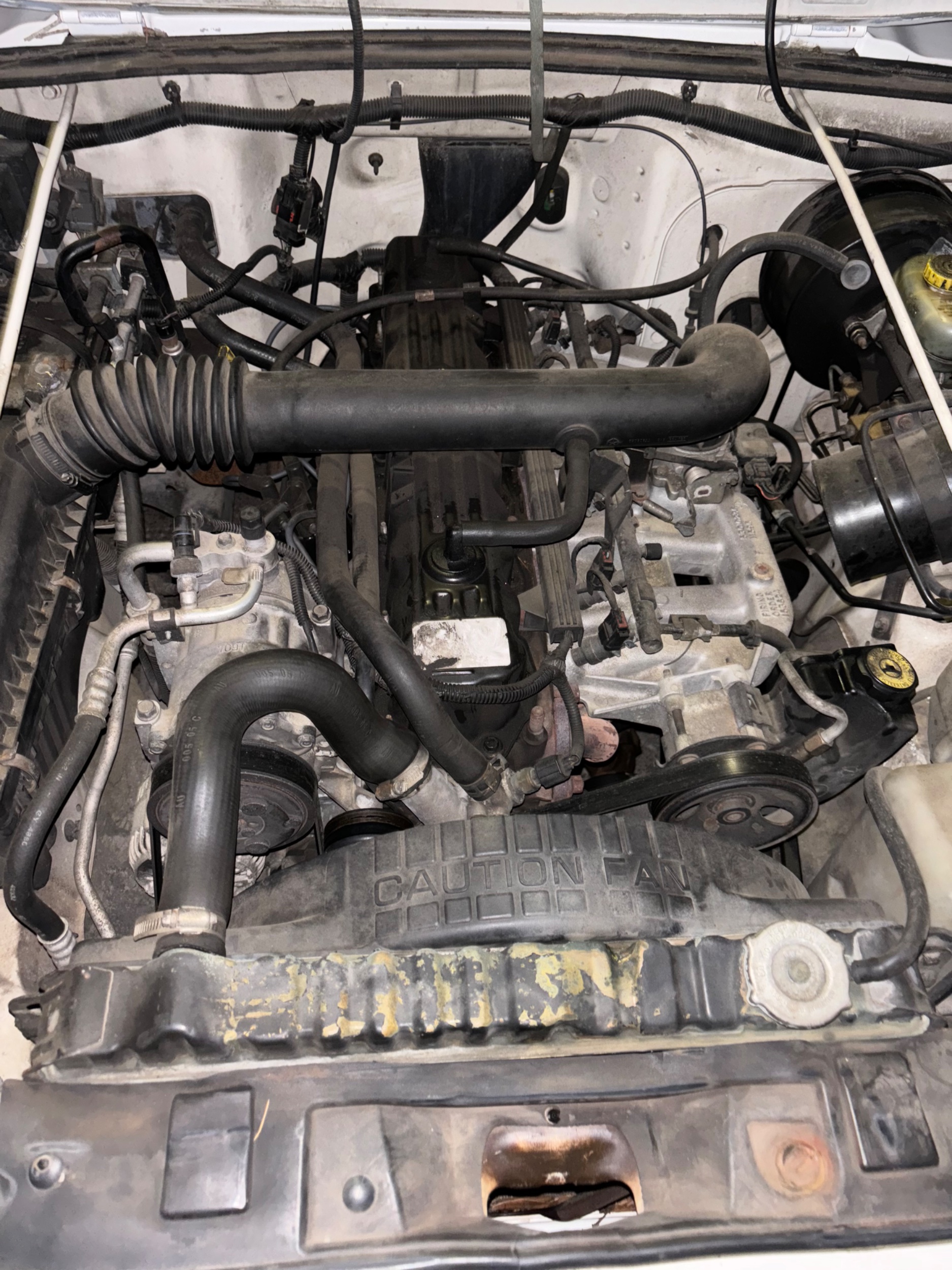

Ended up getting the 4.0 and towing the TJ back to a friends garage here in Santa Cruz, and working on it in my spare time! Currently I have the old motor out and the new one ready to go in, just waiting for a clutch alignment tool and manifold gasket to come in the mail.
Drained the oil on the old motor and found about 6 quarts of coolant to come out before any trace of oil came out, later which the oil seemed to have bits of metal inside of it so I figured that the head (and block) must be toast by that much alone.
On the new motor I did the valve cover, oil pan and rear main seal gaskets. I inspected the rod bearings and pistons and everything checks out it’s just a bit dirty under the valve cover and the oil pump pickup had a bunch of rocks/chunky stuff in the screen mesh (is this concerning?). The motors mounts bolt up perfectly and I just have to time the distributor and put everything back on once I have it lined up with the tranny!
(edit: I’m hoping to finish it by tomorrow or Wednesday so I can get turkey with my family in Southern California )

Solid work and I wouldn't worry about the chunks in the oil pump screen...get them good and cleaned out and send it.
You might want to pop a crank bearing cap off... personally I'd do the rear cap and RMS while it's out. That would give you a chance to inspect the bearings...and make note of the numbers stamped on the flip side of the bearing for future reference.

Ya this all sounds like a good idea, I’ll see to it tmrw before I line it up.
On an unrelated note I was curious on how far the pilot bearing and sleeve should stick out. The new engine didn’t have either and in my old engine the assembly sits about a quarter of an inch inside. After hammering both the sleeve and bearing in for a good 15-20 minutes with a socket I’ve only got it to sit just about flush… is this ok for clearance and won’t mess anything up?

The install ended up going well, after this thread I had some problems with a no start issue that I posted in a different thread that ended up being a wiring issue. The engine ended up being out of a 89 and not a 99 but I’ve had the jeep running for about 10k miles now since late December. No complaints outside of losing a little bit of power.
