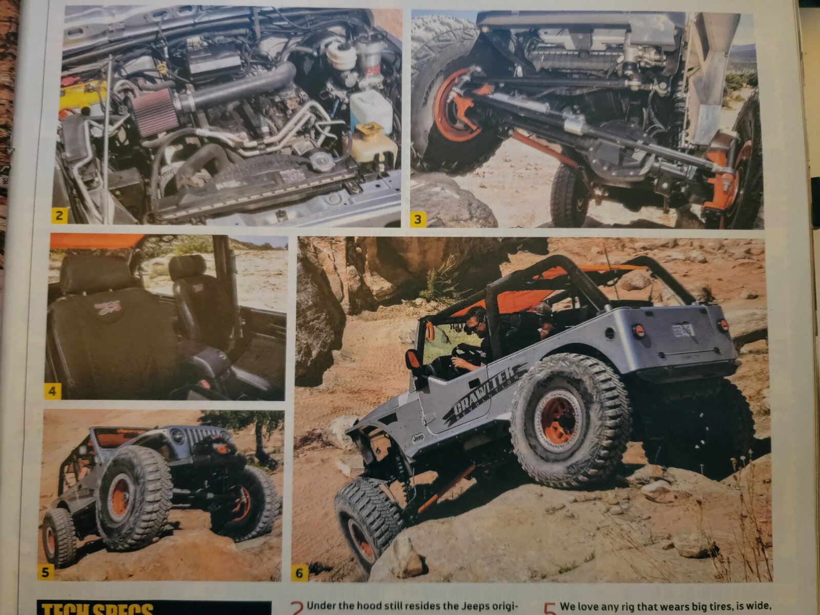

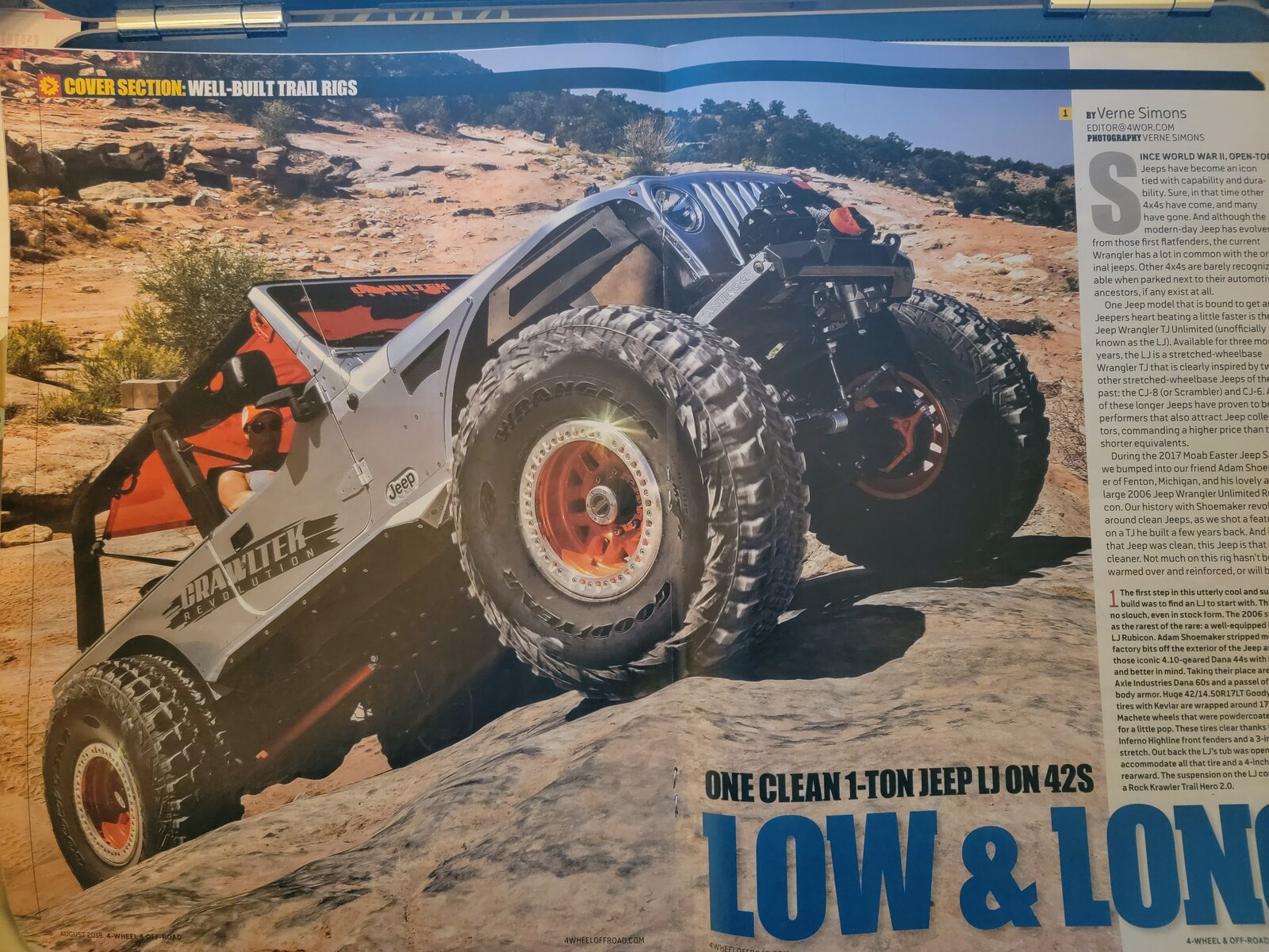

I like keeping it to a low center of gravity. This is one of my favorite builds. This is from a Petersen's 4Weel and Off-road magazine.
Reactions: D's Jeep Wrld
