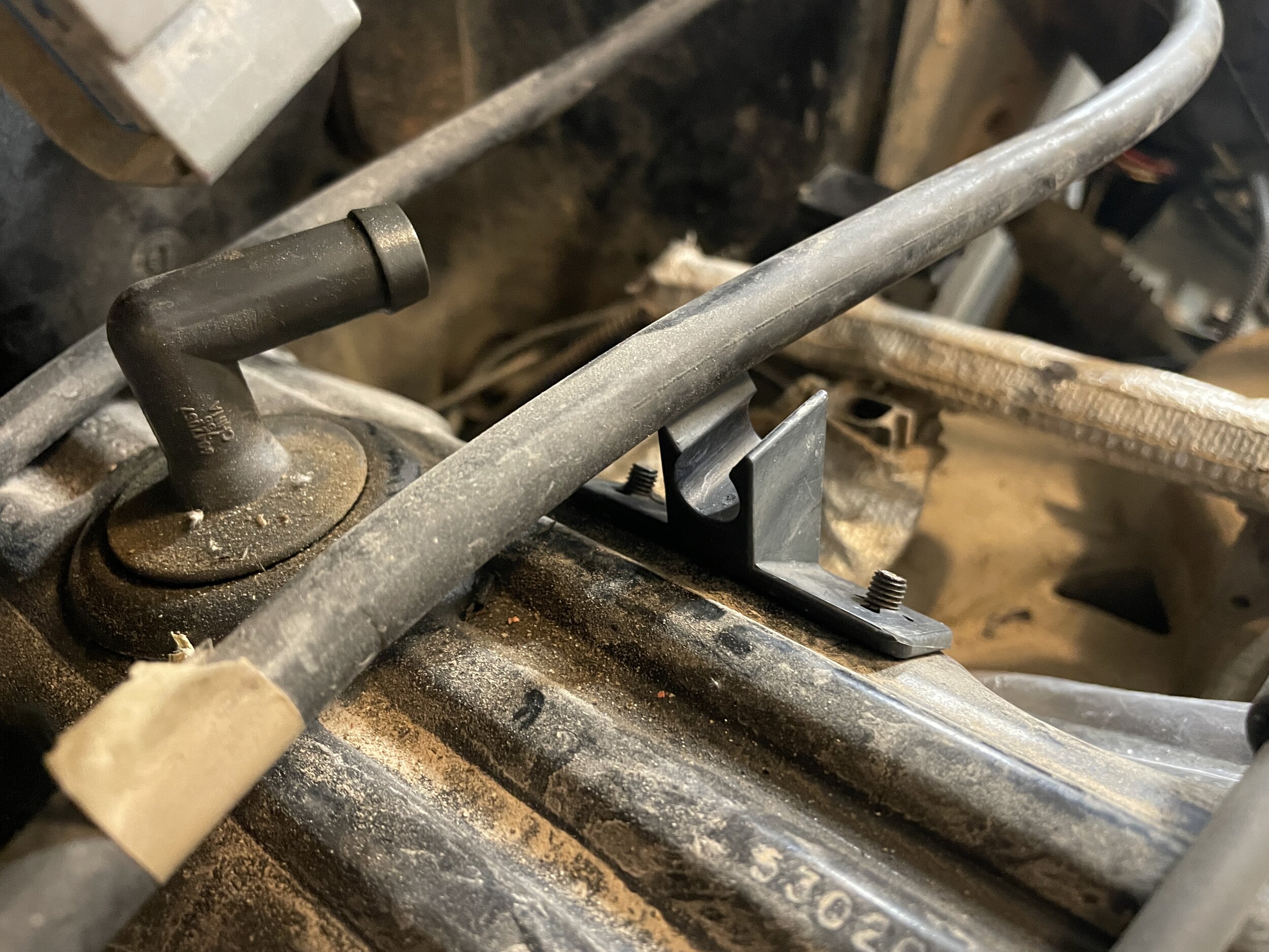

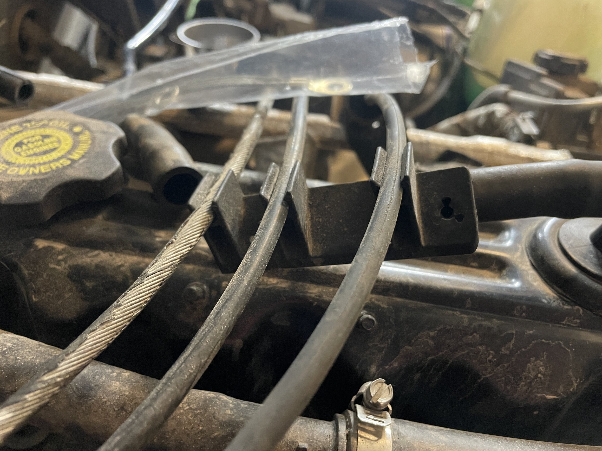

Does the transmission downshift?
If not, get under the driver side, look up under the belly pad at the trans shift cable, some times it comes out of the brace and will affect downshifting.
You may also need to calibrate the cable at the throttle, and lastly, these cable braces on the valve cover also help downshifts by keeping the cable taught.
View attachment 616811View attachment 616812
He has the 42RLE. All shifting is controlled by the PCM.
