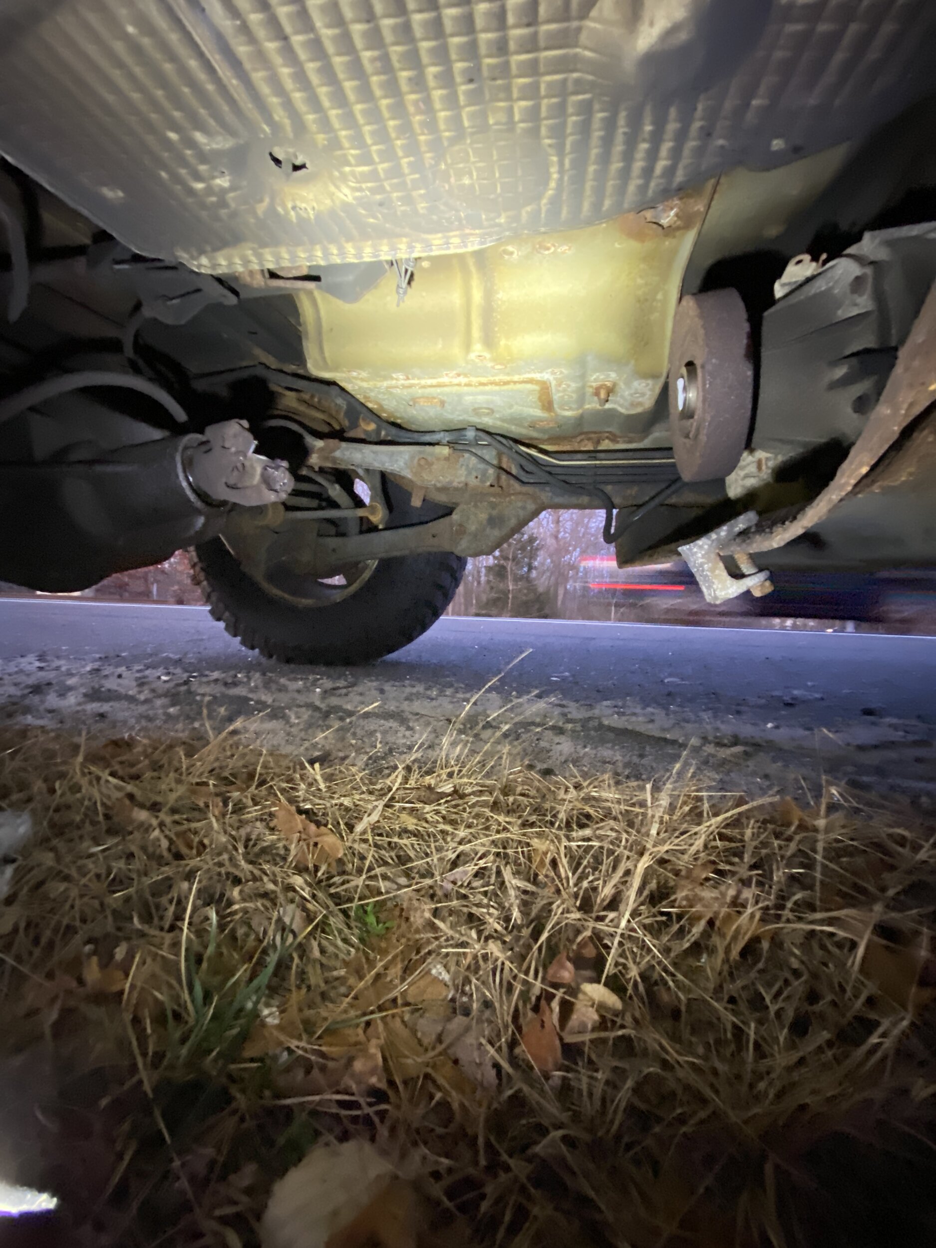

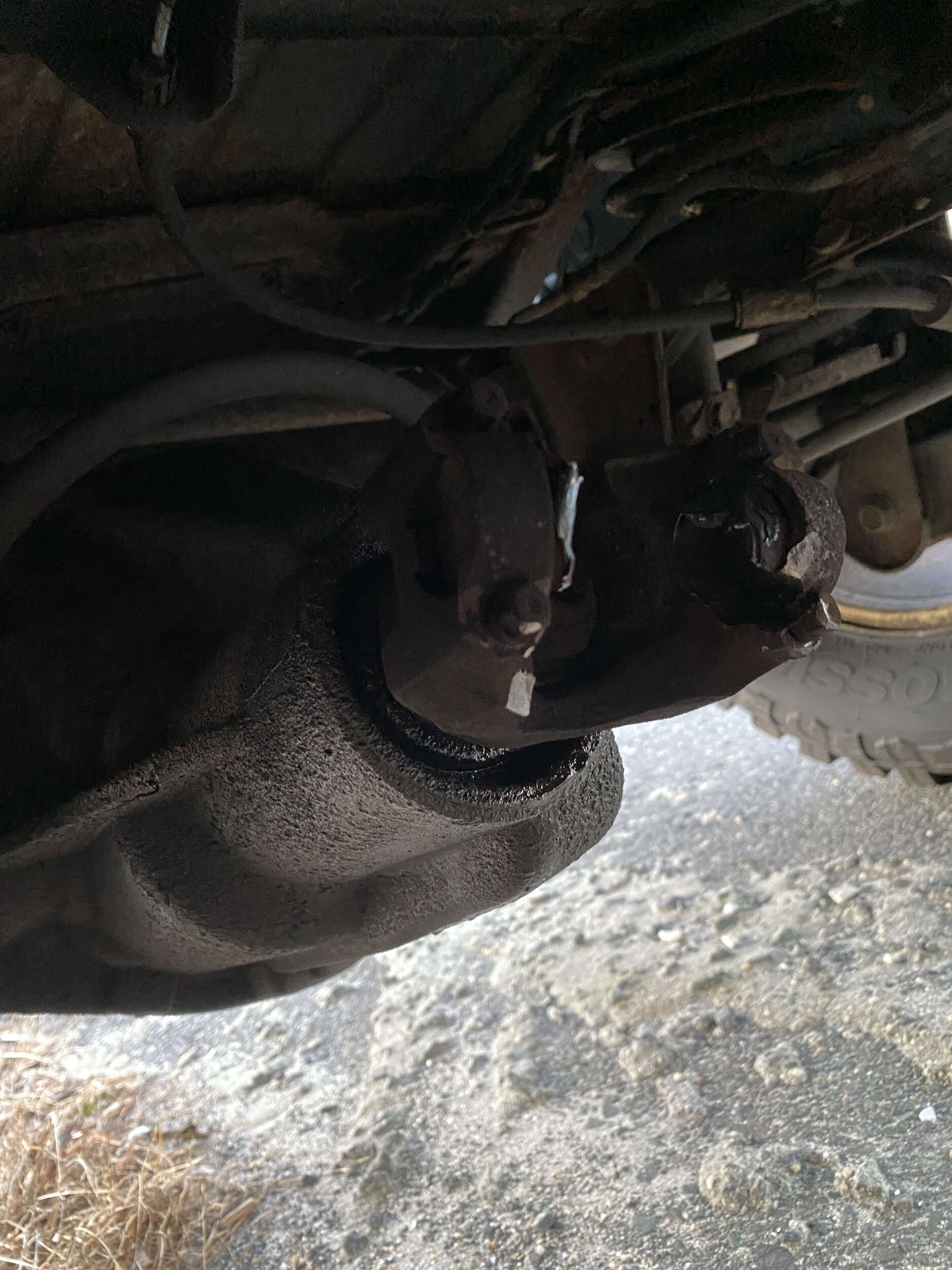

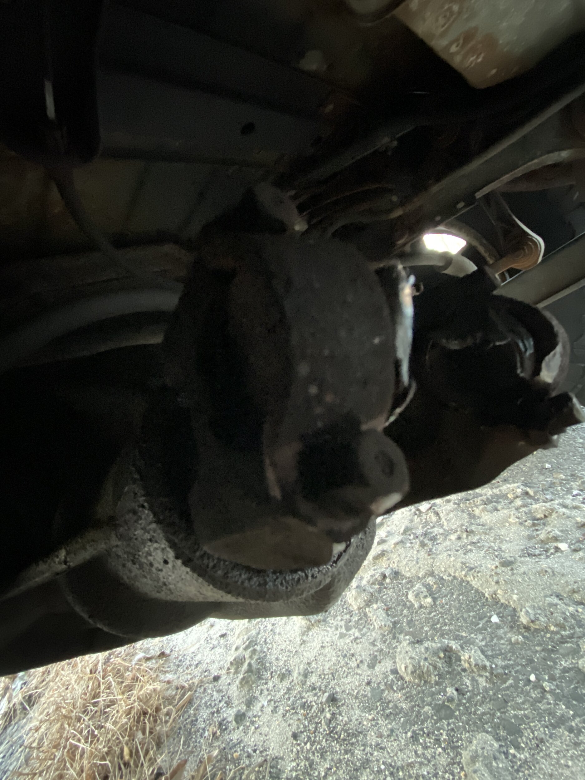

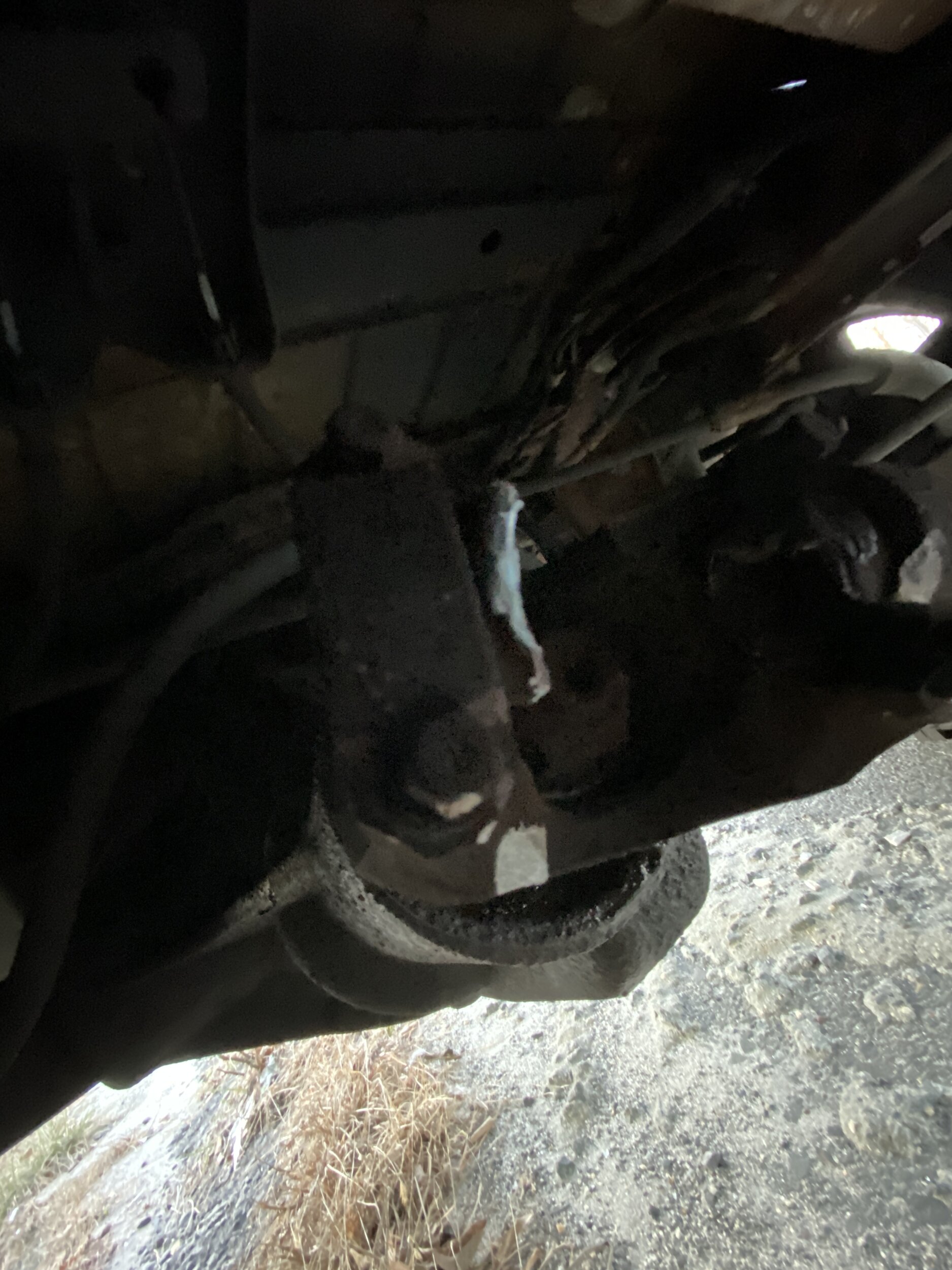

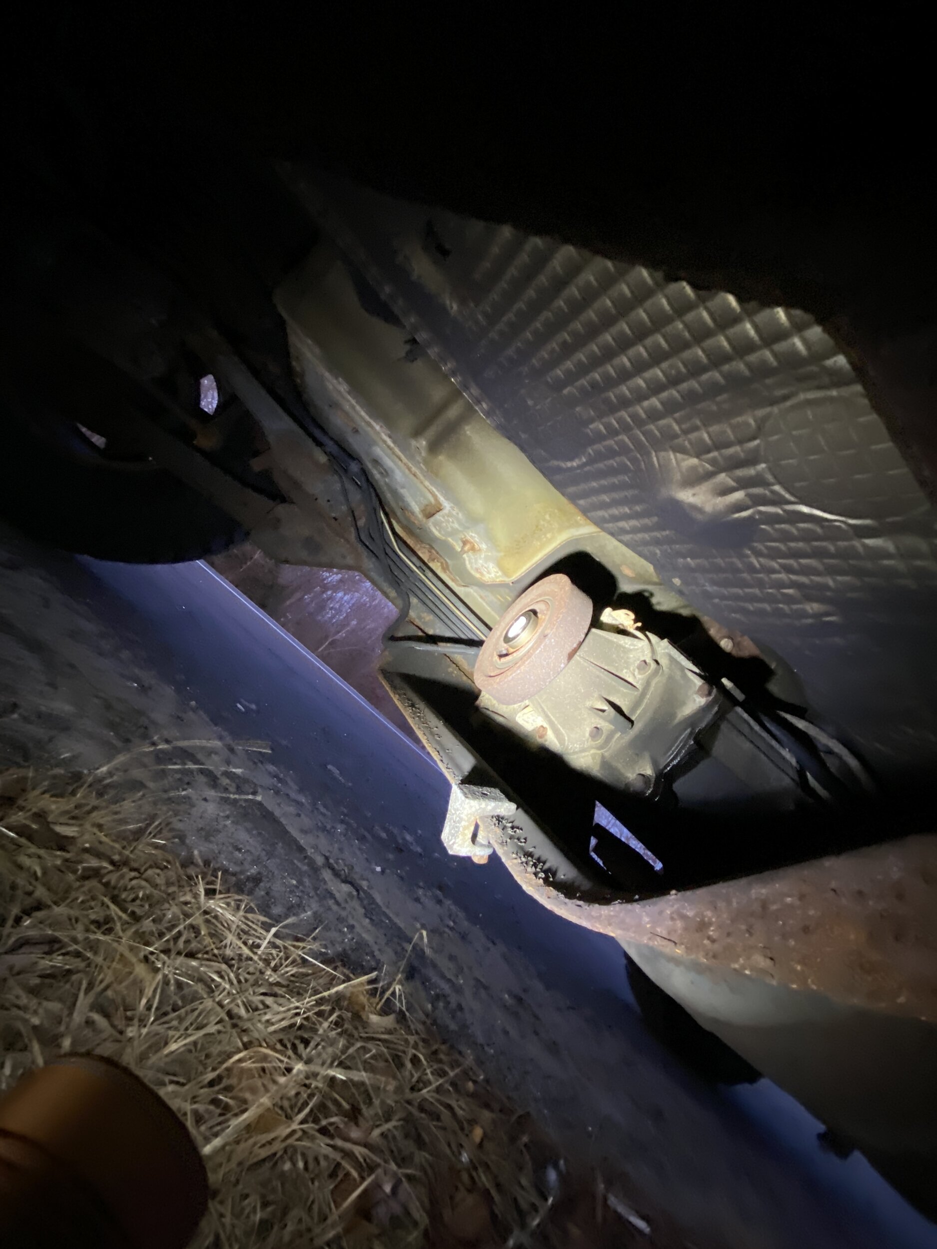

Hey all. Could use a little help here. This morning, on the way to work, the rear propeller shaft decided it no longer wanted to associated with the rear differential and the transfer case. I heard a loud bang and lost my gears. I was able to coast to the shoulder and investigate. Turns out that the “rear propeller shaft” was completely missing. My apologies if this is not the correct term. It is the shaft between the transfer case and rear differential (as I mentioned above). So, I put the beast into 4WD and was able to use it as a front wheel drive vehicle for the final trek of my journey to work…successfully.
So I have the Jeep parked in a safe location where I can leave overnight for however long I need to. Also have other vehicle options for driving. Time is not necessarily of the essence, but obviously want to get it back on the road.
Question 1: is it safe to drive the jeep in 4WD back and forth for a few days, or would this cause too much wear and tear, and possibly damage other components?
Question 2: is this a diy job or something that would have to be done professionally? It appears to be a bolt-on component. The differential side looks easy enough to replace at the u-joint, but I’m not as confident on the transfer case side. Can someone point me in the right direction as far as parts needed and a run down of the process of replacing it?

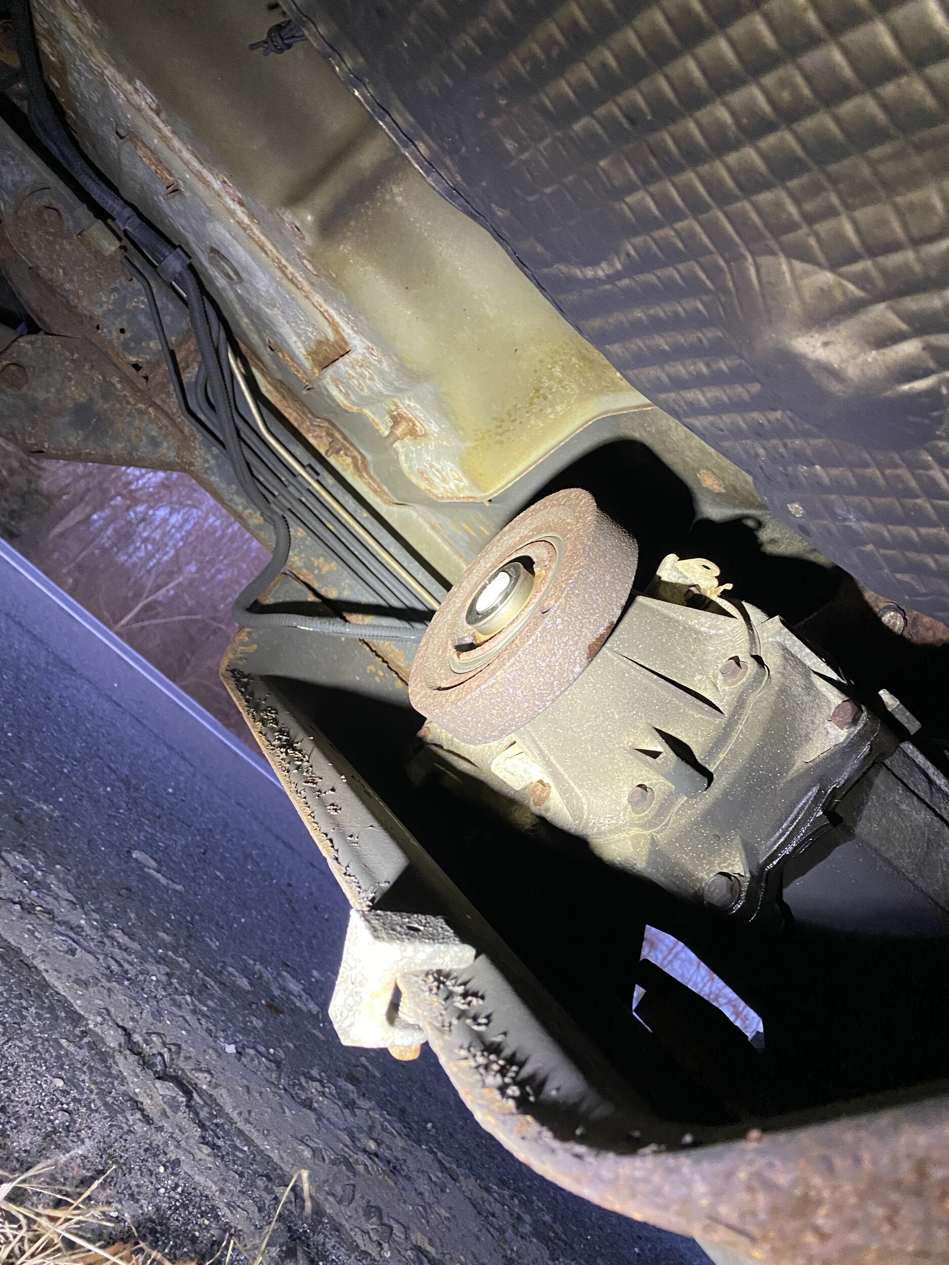

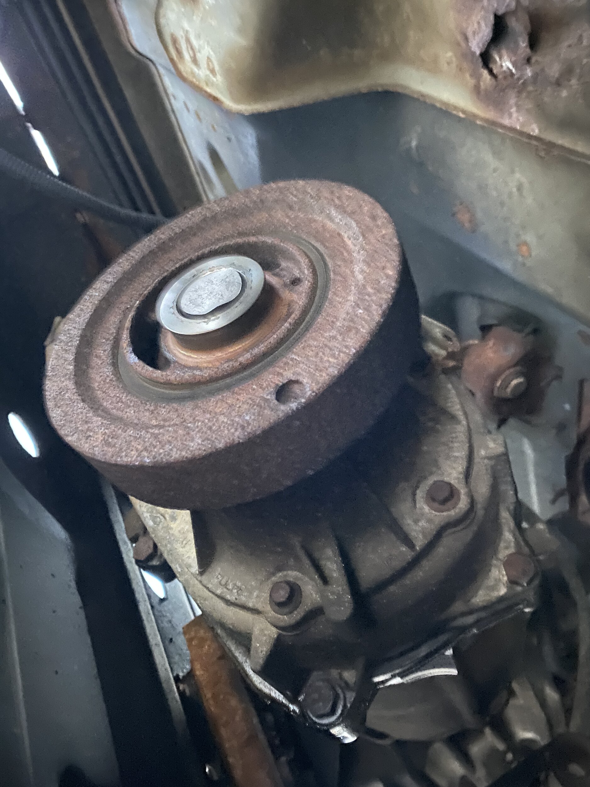

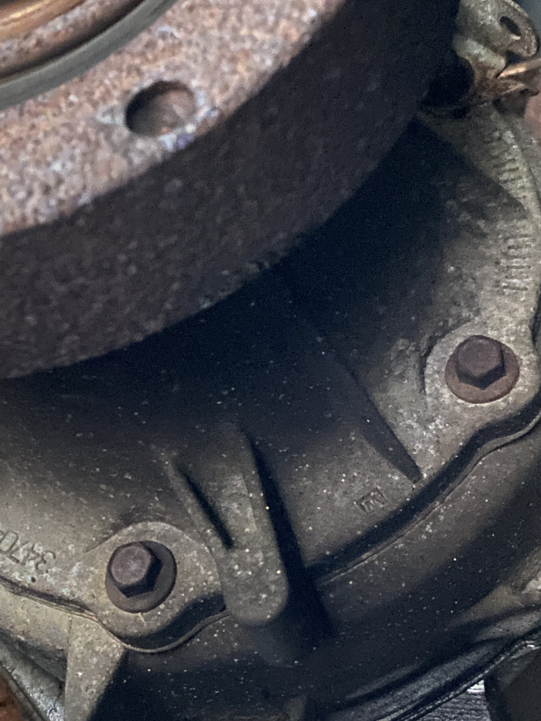

Question 3: it looks like the shaft completely snapped at the plate (removable plate?) on the transfer case. Is this going to be an issue or is this part of what would come with a new shaft?
Thanks everybody. I’m just trying to brainstorm and plan this out. I’ve replaced/worked on many parts of the Jeep (and vehicles in general), but not this. Thanks for any advice.

Both of you are right. We call it a drive shaft, the factory calls it a propeller shaft. His is not an easy replacement since he needs a new output shaft in the t-case since the part with the splines seems to have left the chat along with the driveshaft. And he'll need to pull that damper off and reinstall it on the new output shaft.

After doing some research and talking to my brother-in-law (former professional mechanic), the plan is to replace the drive shaft and the rear diff yoke. From the few videos that I have watched, it appeared that the output shaft should just slide out of the transfer case (albeit with force im sure). I could certainly be wrong with that understanding.
I recognize that it’s not as cut and dry as unbolting the shaft from a couple of ujoints. But from some of the replacement product pictures that I have seen, the drive shaft kit appears to include the shaft part that slides into the transfer case. It is sorta hard to tell exactly though. And also, having not removed the drive shaft, and not having the old one, it’s hard to compare to the potential replacement ones.
Actually scratch that. You are correct about the output shaft on the transfer case being broken off.
U joint failure.
Now is the time to check the front driveshaft U joints because if the double cardan joint at the tcase end fails it will destroy your tcase as it vacates the Jeep.
So assuming that I can buy replacement parts for the output shaft on the transfer case, what would be the process of installing the new output shaft? I think replacing the driveshaft is fairly bolt-on, and same with the new yoke for the rear diff. Just getting stuck on the transfer case part? Is this something that a guy can successfully do in his driveway? Opening up the transfer case isn’t my concern…it’s successfully putting it all back together (correctly).
Depends on the guy wrenching, I guess. You have to remove the tailhousing, and the transfer case rear cover, and remove half of the guts. That tailshaft is long, goes almost to the front of the TC. Look up some of the SYE installation threads, they'll show you what is involved.

At the very least you need the transfercase output shaft,bolts and straps for the rear yoke and a driveshaft.hopefully the rear yoke isn't damaged. I would check the yoke for forward/backward,side/side play.

With those miles, I'd snag a lower mileage 231 and swap that in with a new driveshaft. Then test it on jackstands to see if there is any wobble at the pinion yoke. Faster, easier, and better than adding parts to that 231. That said, if you want to throw parts at it, I can round up a 231 shaft for the cost of shipping.
