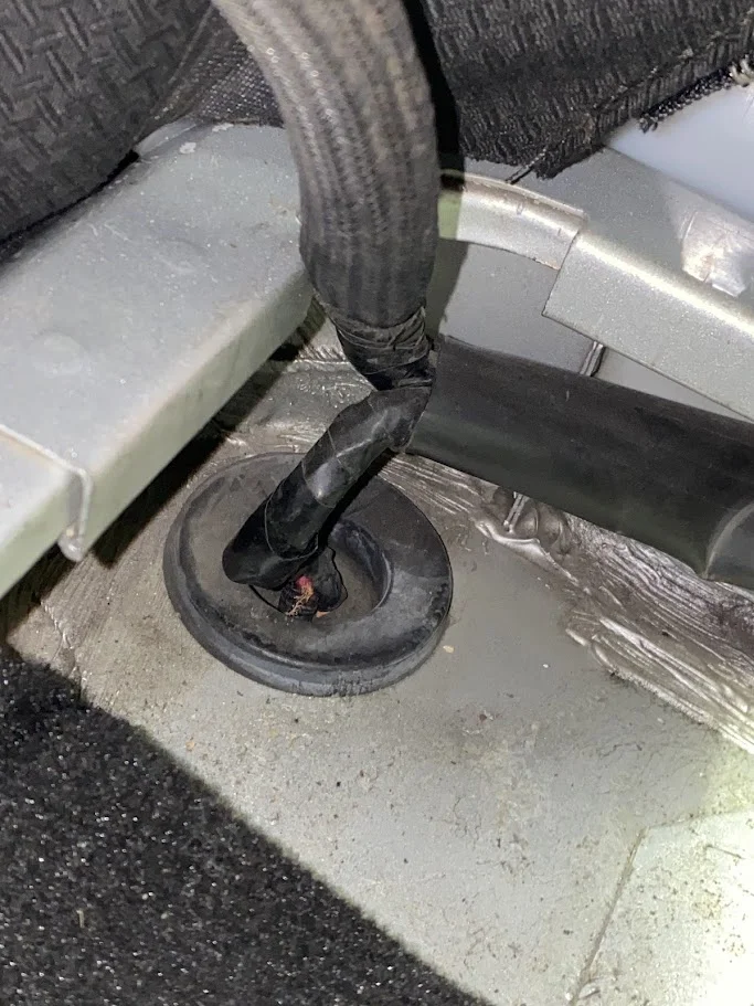

I picked up my 1st Jeep about a month ago.2003 Hard Top 4.0 5spd. it has the rear wiper and defrost switches, but for the life of me i cannot find the harness to plug into the top.? any help would be greatly appreciated!
If it hasn't been removed, the harness is located on the driver side tub. It should be tucked up inside near the side windows.
That is where i assumed it would be. Mine only has a wire bundle that travels under the side windows and then goes down through a grommet at the back corner of the tub. I assume those are the for the taillights.

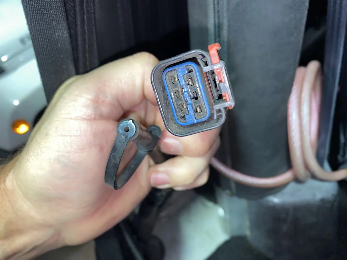

This is what you are looking for.
The hardtop harness includes a 6-pin connector and a washer hose.
They come out of the rear light harness right before it goes through the grommet.
This is the factory harness on our 2003.
