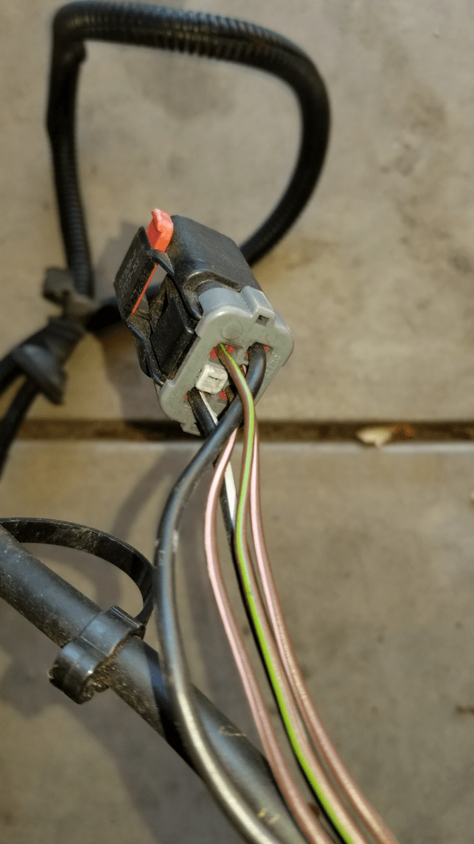

  • Diligently disassemble the harness focusing on the hardtop wires. You will want to have the service manual and this diagram but this diagram might be enough to do the job. You will need to pick some wires out of their connectors and having a few Terminal Removal Tools is necessary. You will need to do some splicing so soldering will be needed as well.
  • Skipping details of which wires you need as I am assuming the diagram shows this.
  • Things you might run into when pulling the harness apart:

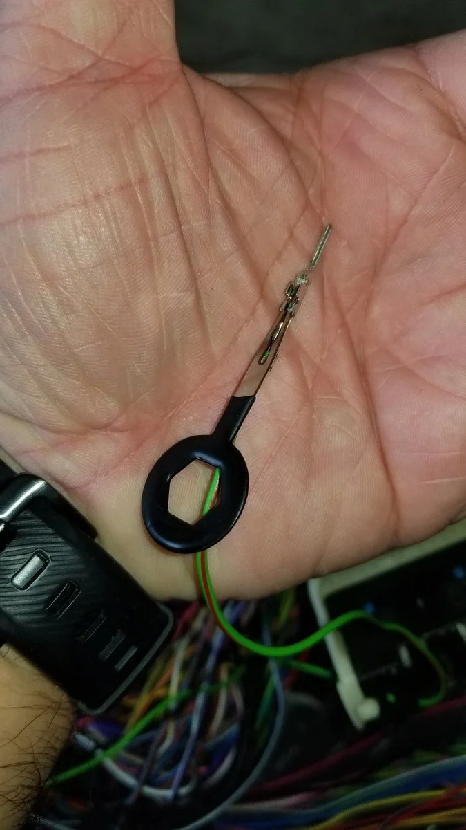

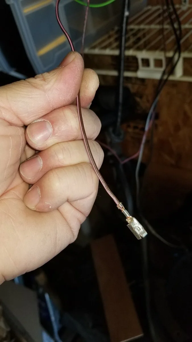

    • Pulling wire terminals out of connectors with the Terminal Removal Tool is pretty easy.
      • push the tool into the backside of the connector grabbing the wire terminal with the prongs, pinch the wire and tool with thumb and forefinger and pull everything out.

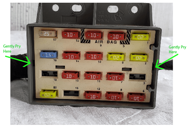

    • Pulling the terminals out of the fuse block is different. You need to remove the face plate off of the front of the fuse block with a tiny flat head screwdriver. Gently pry from the left and right midway there is a slot and it will pop off. Here you can see wiring and how the terminals are seated. From the rear, use the same micro-sized flat head screwdriver to gently pry the plastic retaining tab up. the tabs are above each wire. Move the tab up and this frees the wire to be pulled out of the back of the block. Try not to mangle it like I did the first time. I was using pliers and force...none of that is needed once I took the face plate off and saw how it all worked.
    • Edit: when putting the face plate back on you don't need to remove all the fuses, but it does get slightly tricky as they want to shift on you and get in the way of it lining up. You will need to use your micro screwdriver to push some of them back straight so the plate lines up. It will happen just takes some time.

    • You will need to cut a few wires as they will need soldered back in to your harness. Mainly orange wires for switch light illumination and cutting splices for grounds.
  • Once you have all of the wires and terminals you need from the donor harness you will want to put this together more professionally and protect the wires. I recommend wrapping the wires with Split Loom Wire Sleeve Tubing and tape the ends with Wiring Harness Cloth Tape to prevent it from sliding and coming off. You can also use a vinyl non-adhesive tape like the factory harnesses use. I did this by installing and custom cutting the tubing as I went. Since this tubing is a nylon mesh once cut you will need to melt it a bit to prevent fraying. 1/4" tubing will hold quite a bit of wires as it can expand.

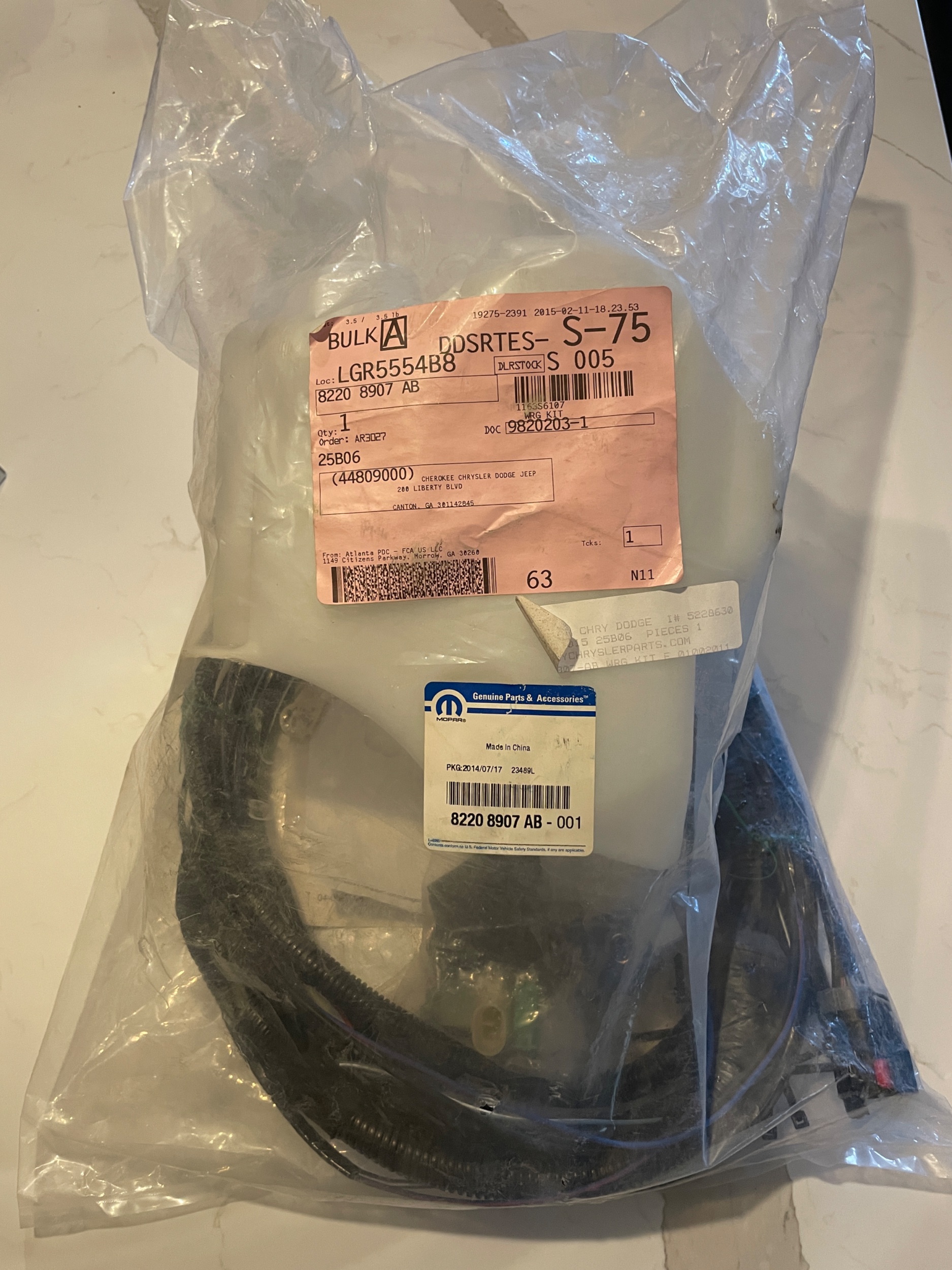

As many have read, I was one of those who took on this project 2yrs ago by sourcing the tub wiring harness, switches, washer bottle and pump from multiple sources. I spent the better half of a couple of days to install it and make it identical to factory as possible. The amount time spent doing it and fun I had along way reminded me of how much cheaper and simpler it was in 2001 when I bought the factory mopar kit for my 97. Since mopar stopped making it years ago for both the 97-02 and 03-06 I figured the odds of ever locating a kit would be impossible. But to my surprise I found one for sale still in the factory bag, receipt and instructions.
Soooo....what are your plans for the kit, since you've already completed the wiring project?
Reactions: chili_pepper
I’ll see who is going to attempt the project next, pull it out of the Bag, lay everything and take a ton of photos to ease the wiring pain. IDK what the heck I’m gonna do with it, guess just sit on it and let it collect dust like every other Jeep part I have collected over the years. Just a hobby locating OEM vintage parts.
