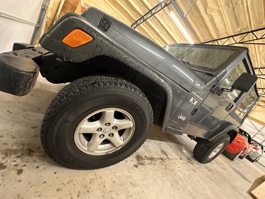

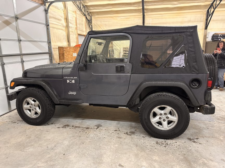

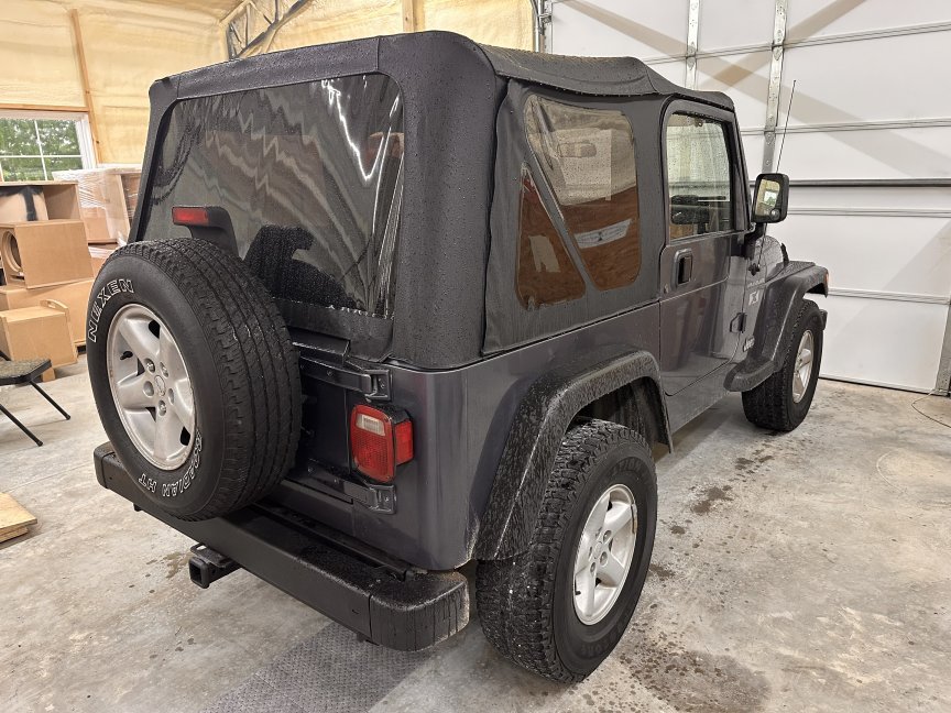

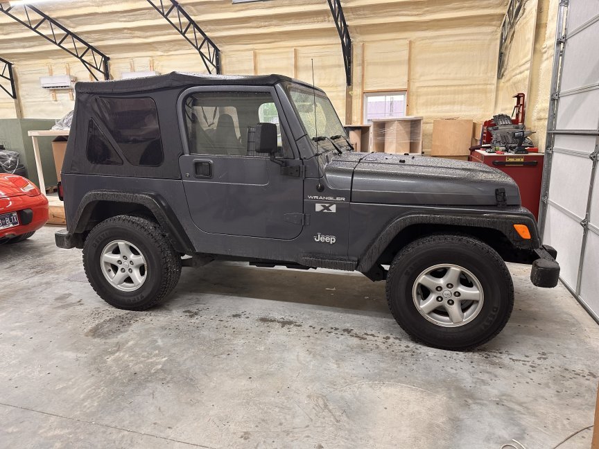

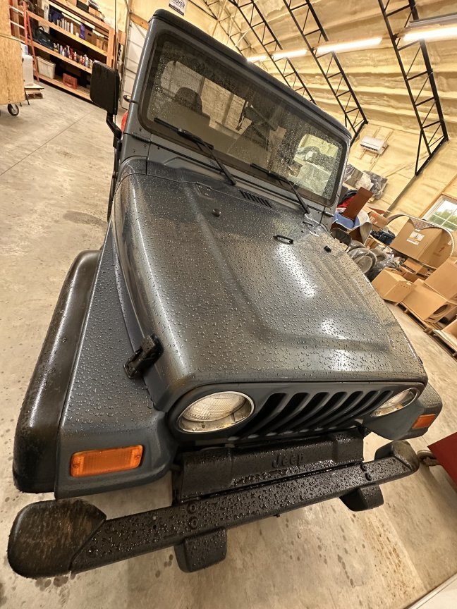

You know, I don't have anyone to blame but myself. I did just run down to Douglasville, GA to buy my Jeep without checking Carfax - at night - without even test driving it.
And just to be clear, I'm fine with what I bought. No regrets. I love this little thing, even though I've only put 50 miles on it so far.
But man, the person that sold me this is a real scumbag liar. I just can't believe how bad some people are. I would never do that to another human being.
He said it was a one-owner Jeep from Florida. Had a full story all made up about how the old guy got sick and died, and the vehicle went to his daughter and she didn't know what to do with it, and he, out of the kindness in his heart, and at the urging of his wife who had befriended the young girl who now owned the Jeep, decided to buy it from her to help her out with her bills and funeral expenses for her father. What a crock.
I was doing a thorough underbody inspection the other night with my mechanic, and we noticed there were no factory frame holes for the OEM-style side steps that I ordered. That's when the light bulb went off. Hang on a second, look at this. This was a repaired frame with plates of steel running down both sides of each frame rail and then painted with undercoating. It's a really good job, welded at every intersection where the body mounts are, cut neatly to fit, actually kind of hard to see it even up close. But clean as can be. There is no place that we could find on the frame or the body that you could poke a screwdriver into. In fact, no corrosion of any kind can be seen or felt. It is all solid and undercoated. There's barely even any surface rust anywhere.
I checked Carfax yesterday and sure enough, it's a Northern vehicle, PA and NJ with eight owners and one accident. The seller was listed as the last owner and he had been trying to sell it at auction for two years unsuccessfully. Too high a reserve I'm sure.
Like I said, no regrets. If anything I am more enamored and attached to it knowing this history. It runs great and doesn't need too much work to bring the maintenance right up to date. With the help of nice people here on this forum I've ordered the parts for it and my mechanic is excited about getting it in great shape. It's nice and clean inside and has a new top. While I don't think I got a screaming great deal on it, I didn't do too badly either at $8K.
It's my story now.
