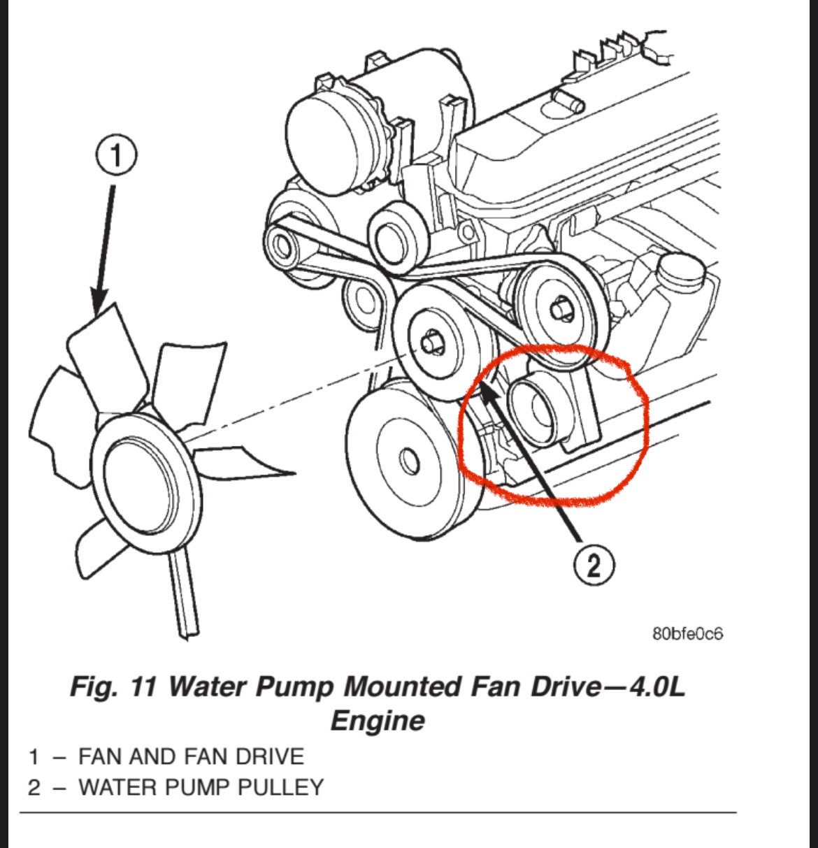

Drove into work today maybe 1.5 miles from home. Parked and sat idle while I sent a few messages. No CEL, or dash lights at all. Shut off my jeep got out to grab my bag and noticed smoke coming from the engine. Walked around front and saw radiator fluid draining out pretty rapidly. Having a hard time understanding where it is actually coming from. Maybe someone can take a look at these videos and help me understand. Thanks
Probably the weep hole in the water pump.
-Mac
-Mac
The only issue I see , by no means saying you are wrong , is that the leak is so far away from the water pump. It’s almost like it is coming out the crankshaft pulley (bottom right) which makes absolutely zero sense.
The pulley in referring is the one circled in this photo. It’s almost as if its leaking out of the bottom of that park on to the hoses that connect to the metal pipes running toward to the back.
The only way you will know is to do a thorough inspection with a bright light once the engine cools.
Inspect the drivers side of the block; the problem could be a leaking freeze plug...
