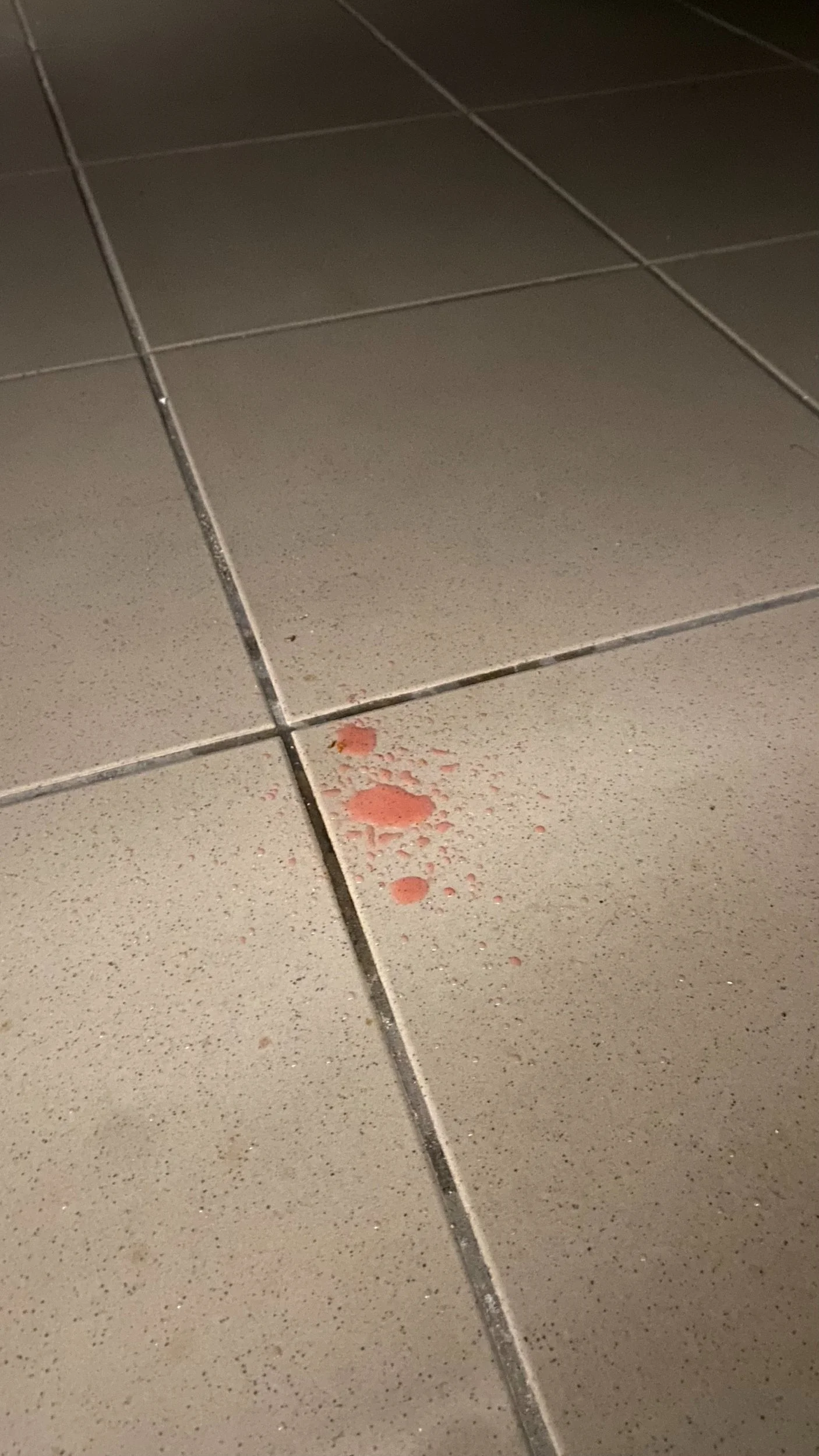

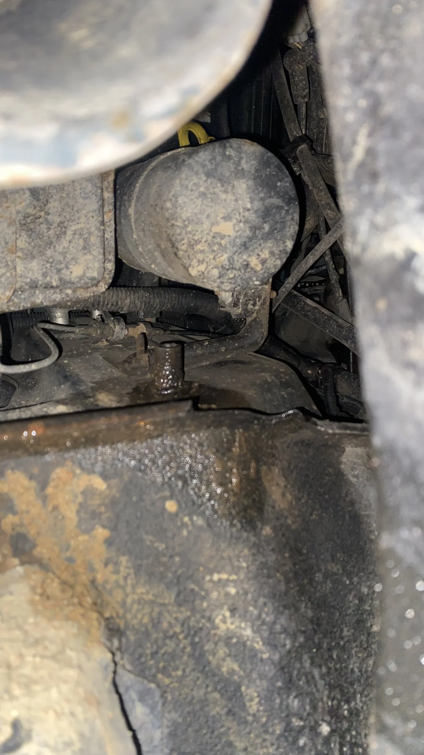

I found a couple drops of coolant under my Jeep today, and wanted to check where it's coming from. After opening the hood I saw that there's literally no coolant left in the reservoir.
I took a picture from under the car, it seems I found where the coolant was dripping from. Could you please help what exactly is this?

As mentioned above, it's normal for water to drip from there whenever the compressor runs.
Could also be leaking anti-freeze from there if the heater core is bad, otherwise you're losing it somewhere else.
Reactions: John Cooper

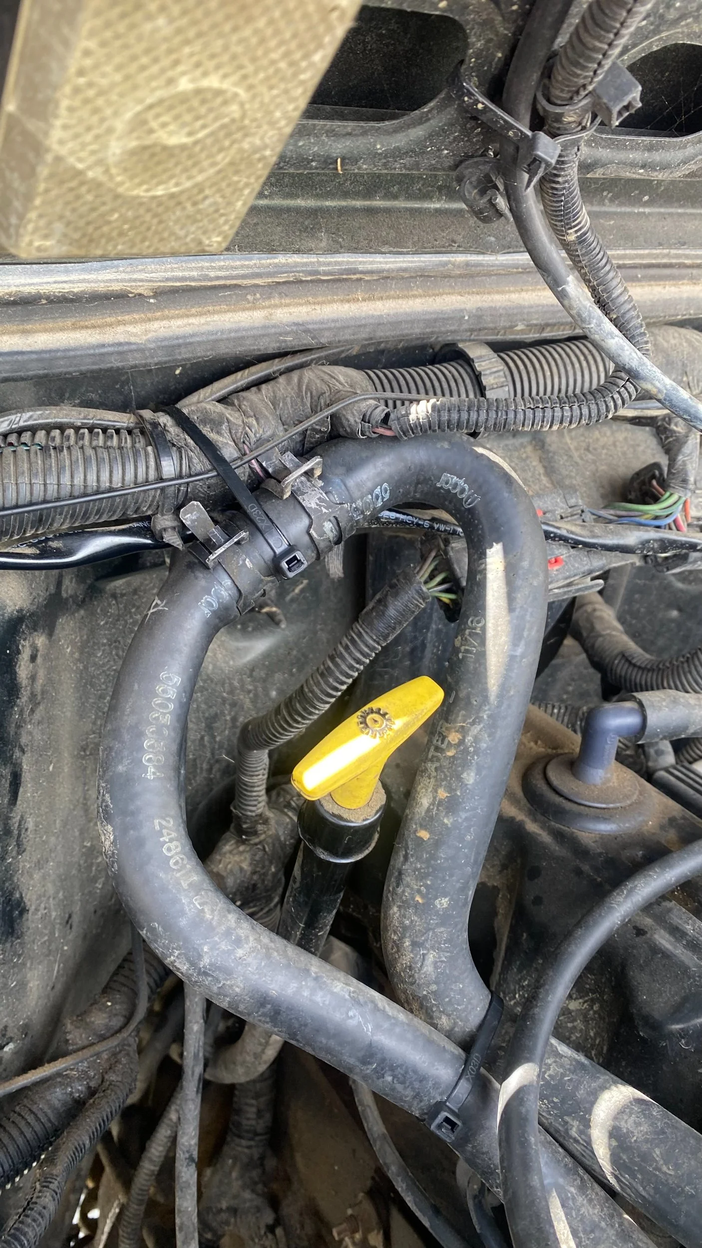

All good comments above. Verify if its is AC condensate vs coolant. If it’s definitely coolant, it’s time for a heater core. If you are good with mechanical stuff, it’s not a hard job. Don’t let people scare you. But if you lack tools and mechanical skills, nothing wrong with that but it’s probably not the project to start learning on.
The fact that you found your coolant to be low makes me lean to the probability it’s a leaking heater core. If you are certain it’s leaking coolant from where you showed in the pic, it’s definitely a heater core.
