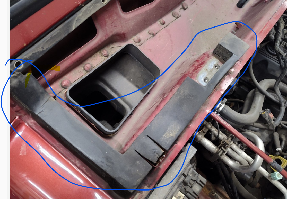

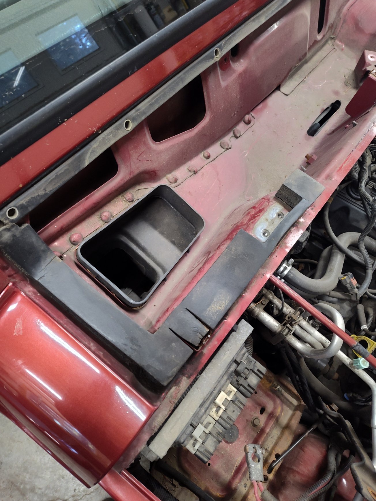

This is the Cowl panel seal around the outside air intake on my 99. Not sure it relates to the later models.
https://store.mopar.com/oem-parts/mopar-evaporator-housing-tube-56000724ab
Pretty sure that's it.
Which part are you saying it’s bad?

Just showing the factory seal since they can go missing via previous owners...

Is there a part number for the part @TJ4Jim your pointing at?

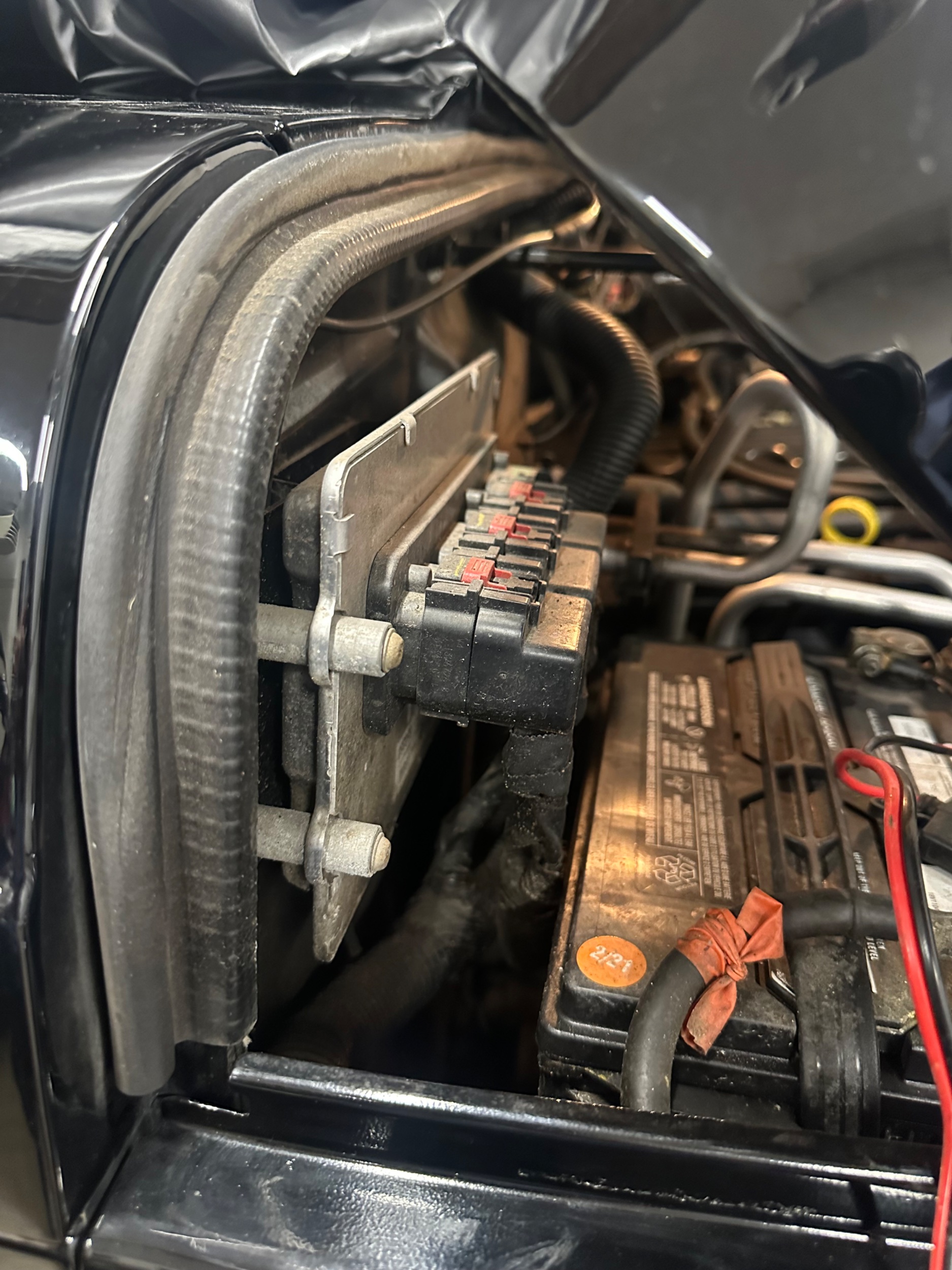

Here is a couple of photos, my cowl - hood sea actually goes all the way to the fender, so it’s not the short seal issue I read about.
Also a phot of the heater core lines foam area, foam looks good and solid.
I did order a 90deg elbow for the ac drain, but doubt that’s it.

Yep, it was missing on my son's Jeep.
This foam does not exist on an '05, suspect it was a poor attempt by Chrysler to keep water out of the fresh air intake on earlier models.
Rather interesting non-factory plug welds in that photo... :unsure:

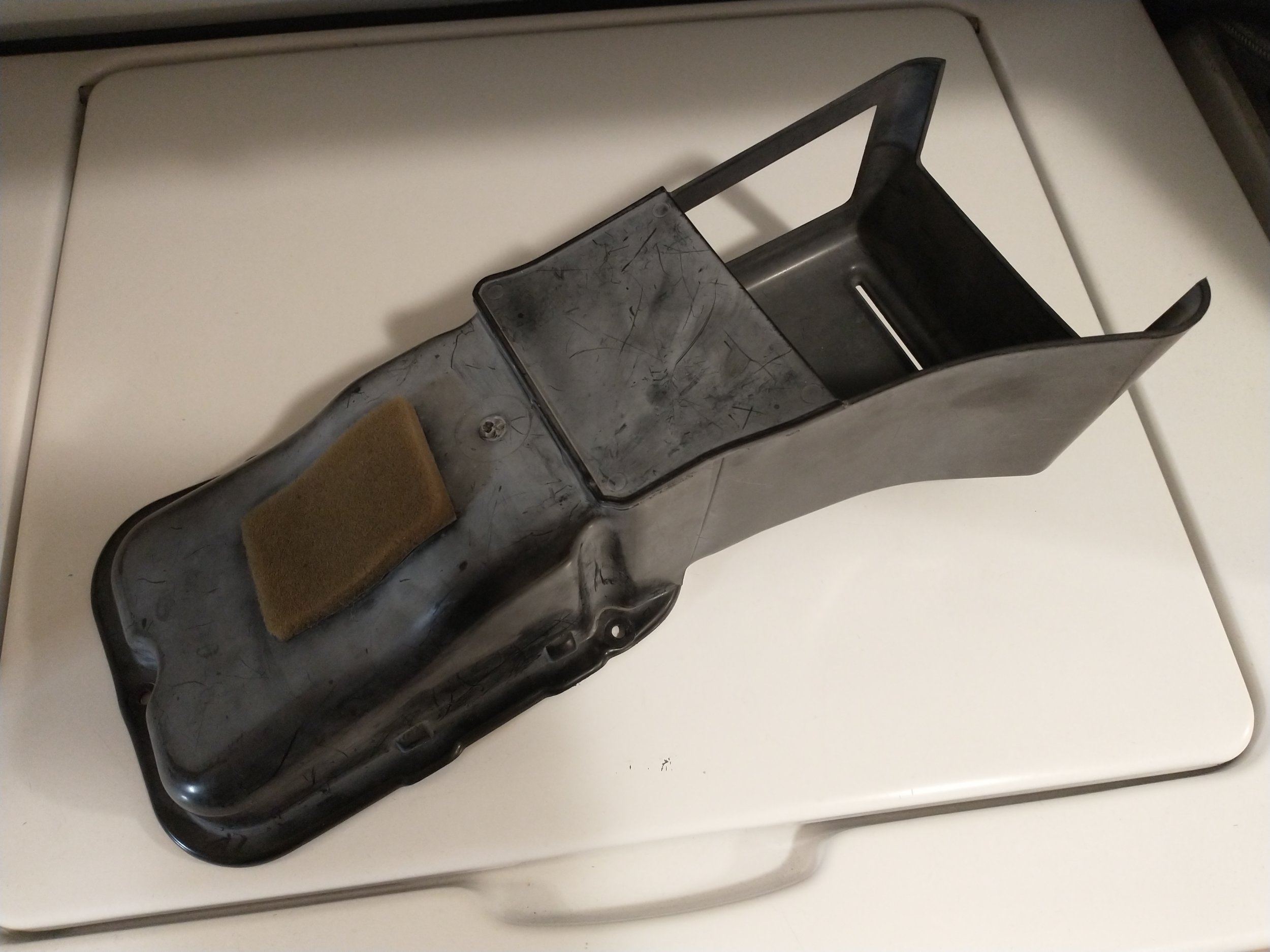

This is what was installed on some later models to keep water out of the HVAC airbox. Have you removed your cowl panel yet?
No idea, you'd have to check the parts lists in the resource section for his model year. I wouldn't bother with it though, it didn't do the job.
When you say later years you mean 05-06? That photo looks like a good solution a bit beefier than TJ4Jims thing
