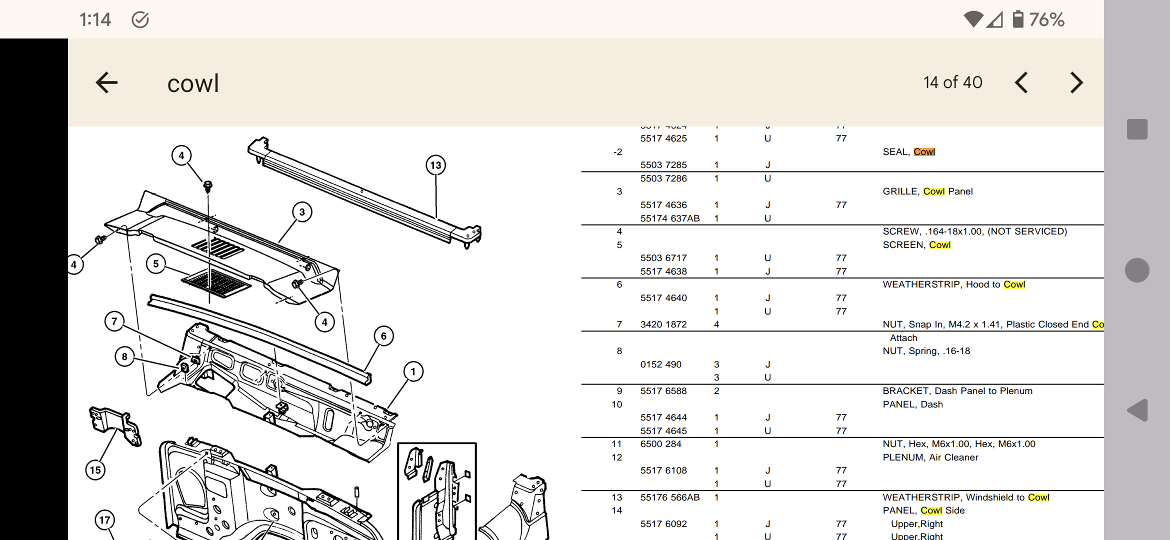

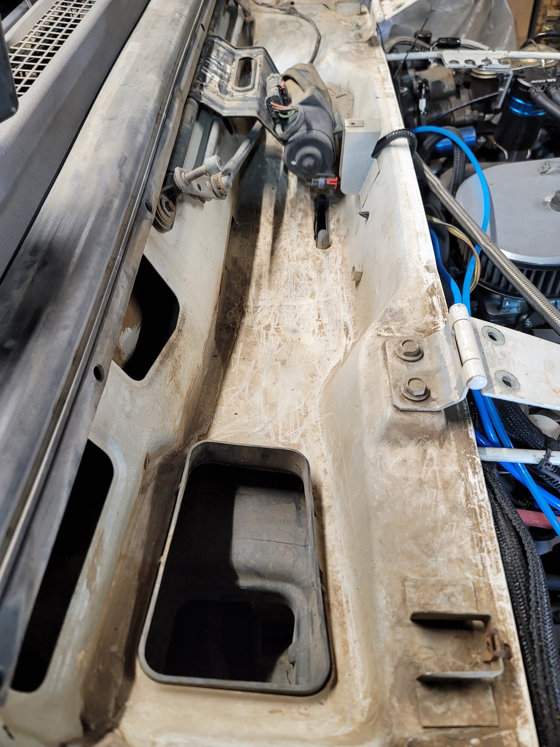

Is there supposed to be a seal or gasket here? It seems like there should be. I'll explain below but wanted to get my question up front. I added a "wall" around the cabin intake to prevent water from getting in there, but it looks like water is able to go straight into that intake. It seems like it may be the "hood to cowl" weatherstrip (item 6), but maybe I'm looking at it wrong. Is this what goes there?
https://www.ebay.com/itm/3614341899...pid=5337789113&customid=&toolid=10001&mkevt=1

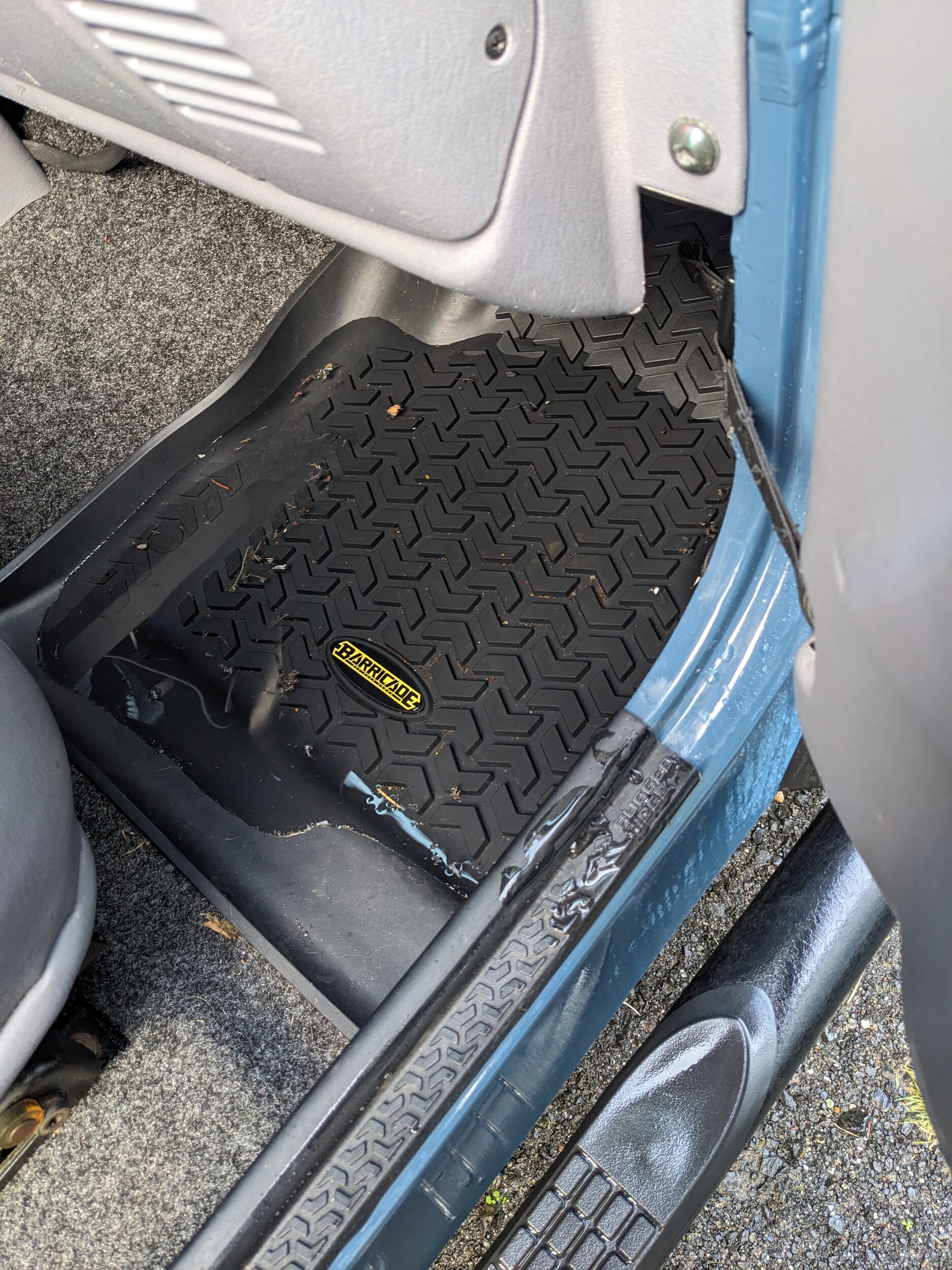

So, I woke up feeling crummy and decided to take the day off work. After laying on the couch for a couple hours, I decided to ride to town with my wife and son, and he wanted to take the Jeep. I went out to get his car seat installed and start it to warm up. I was quickly greeted by this amazing sight in the passenger floorboard.

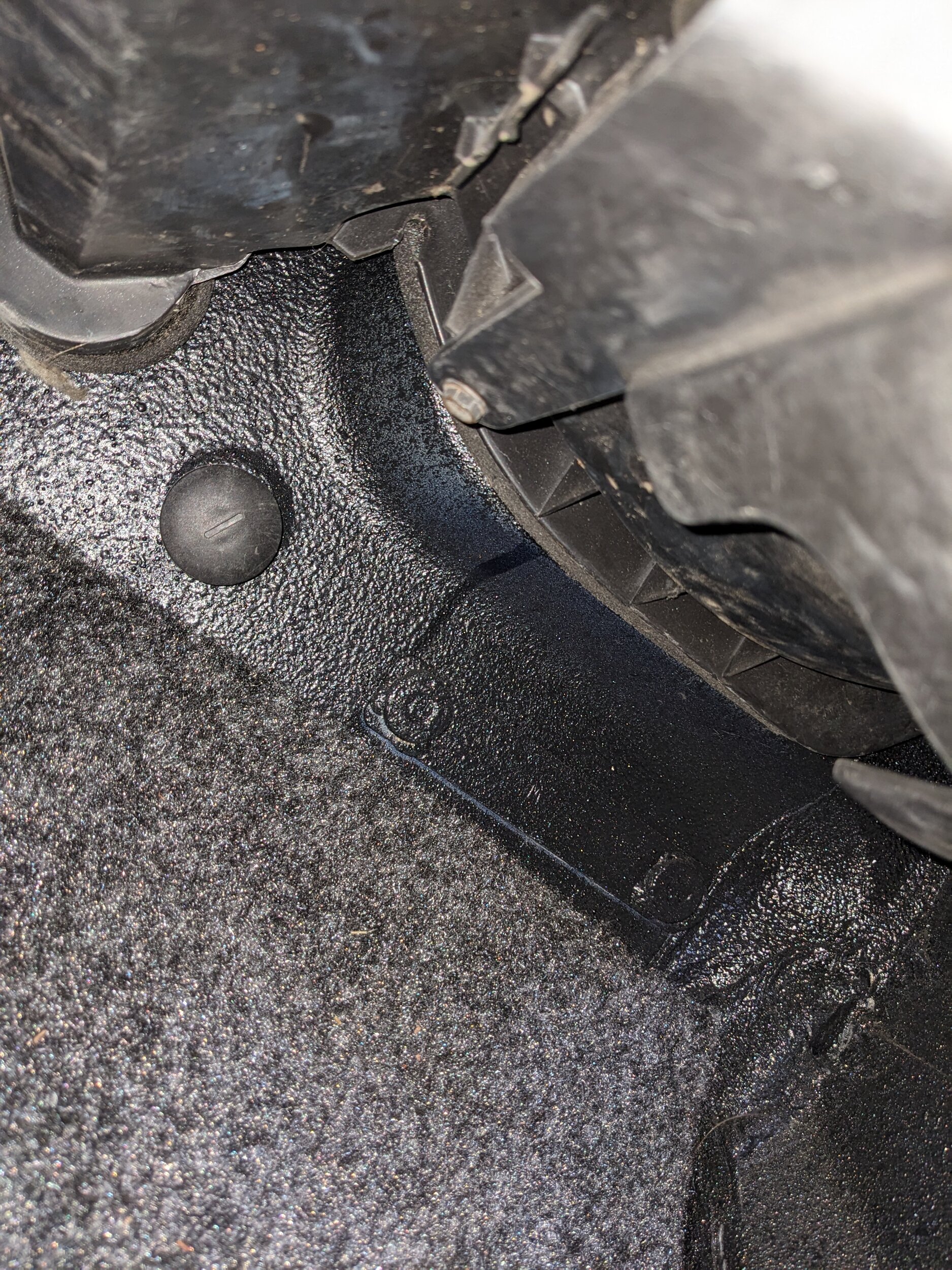

Looking underneath, I could see that the water appeared to be coming from the firewall where the blower housing mounts.

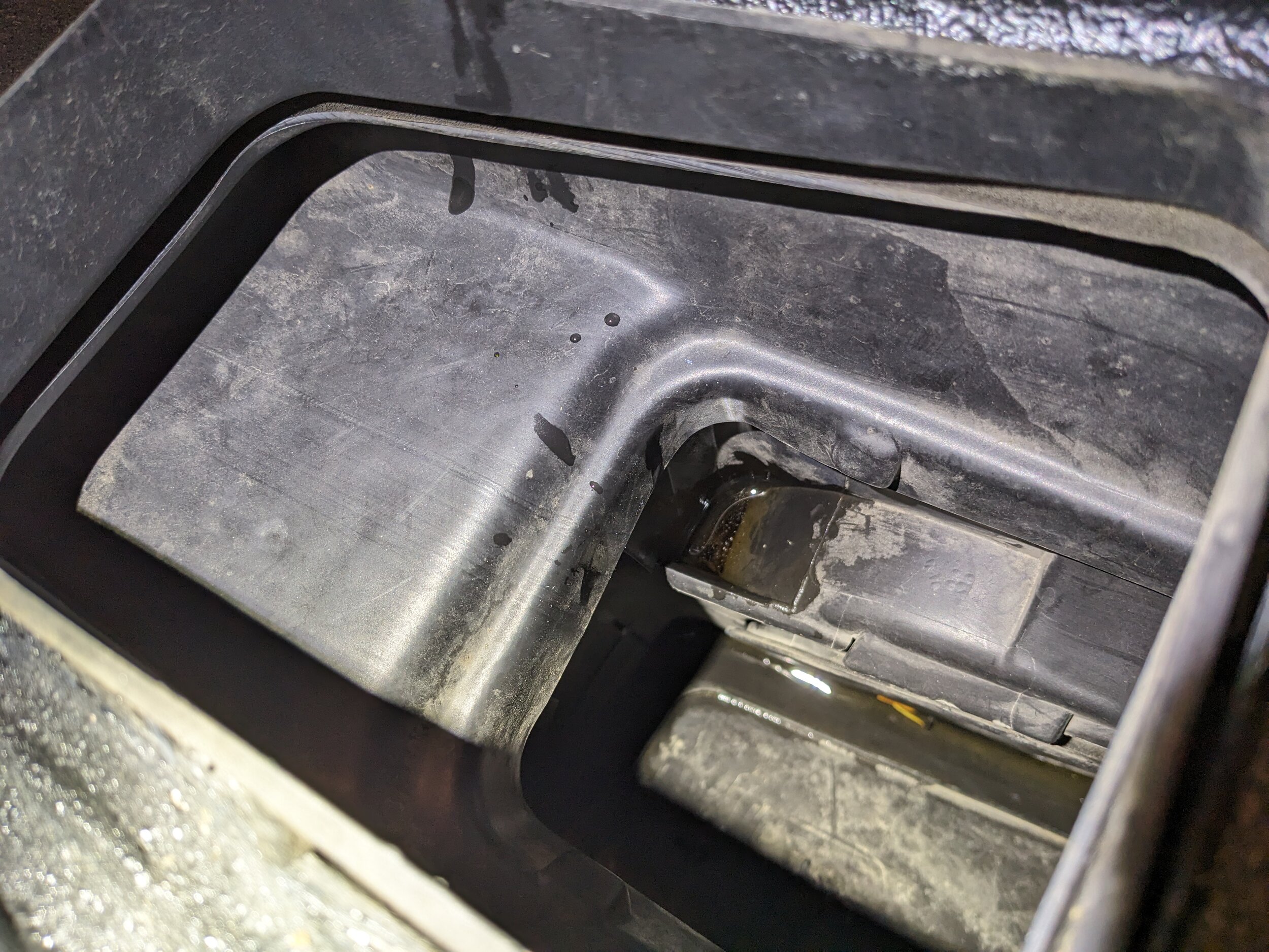

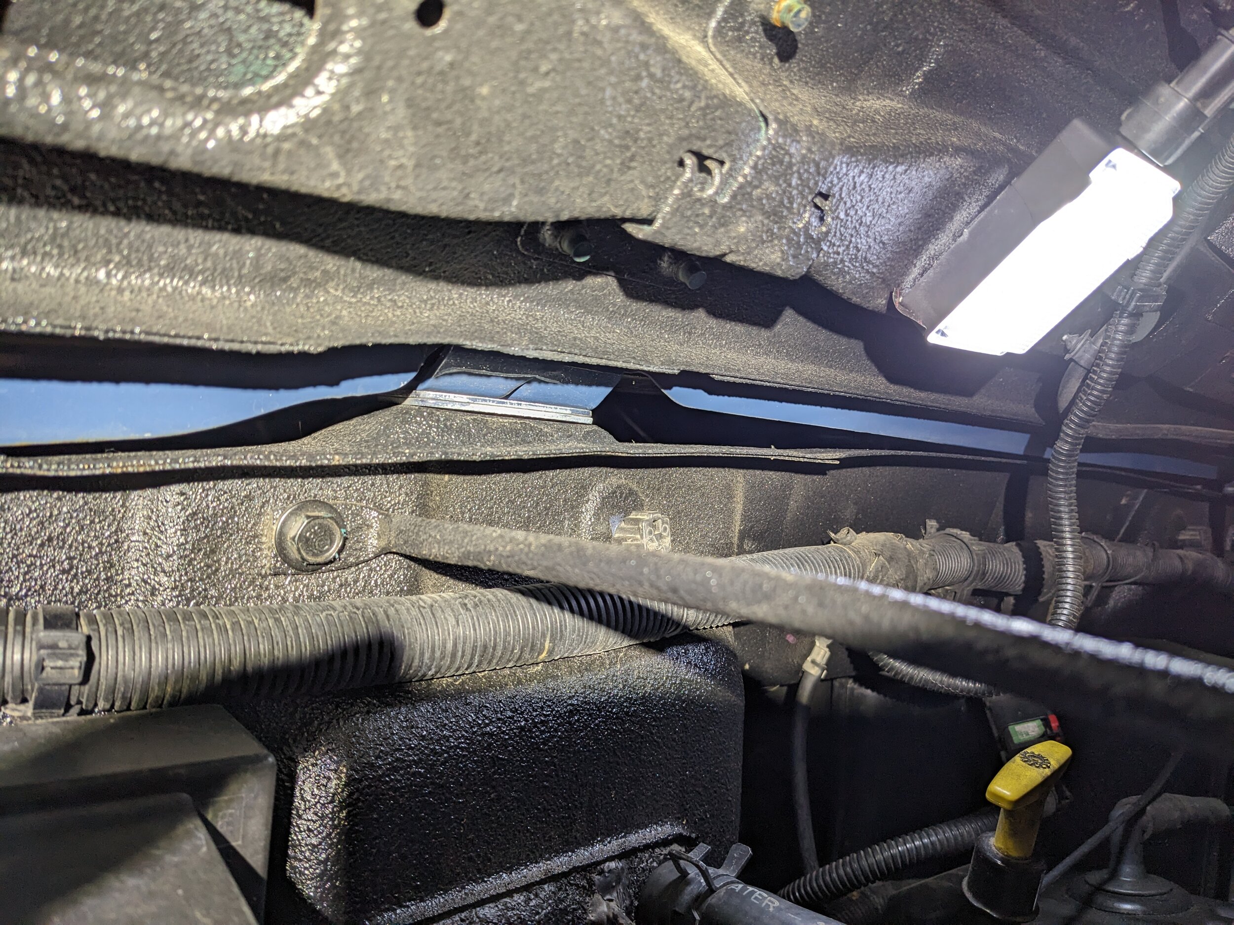

Up to this point, we've been having some very heavy rains. Occasionally, there will be a very small amount of water that makes it way through and drips onto the rubber mat. It's been so little and only with heavy rain, so I wasn't concerned. This, however, is on a whole new level. I verified that my cowl drain was clear, add a wall/edge around the cabin intake with a heavy outdoor tape to raise that lip, and added a layer of tape over an old foam weatherstrip that looked to be part of the problem. With that last part, I was able to wrap a thick layer of the tape over the seam that should keep water from hitting it and then just run off. There was a little water under the mat too on the carpet so I've got everything back together with the Jeep in the garage with a fan to dry out.
What does the HVAC drain look like on the outside of the firewall?
Sure looks like the rubber weatherstrip is missing which #6 in the above drawing. I'd go look at mine to verify it but my son borrowed my Jeep last week.
Ok, that's what I'm thinking. Maybe someone will be able to chime in with a picture. Going to try looking around and avoid the $15 shipping on eBay!
Reactions: Jerry Bransford
The 97 model as far as I know didn't come with a cover over the HVAC box. You can get the cover from a 98 or newer and it fits. There are 3 screw holes you can use to secure it or just use the cowl cover to hold it in place.
I bought mine off Ebay.
Then put your cowl cover back on.

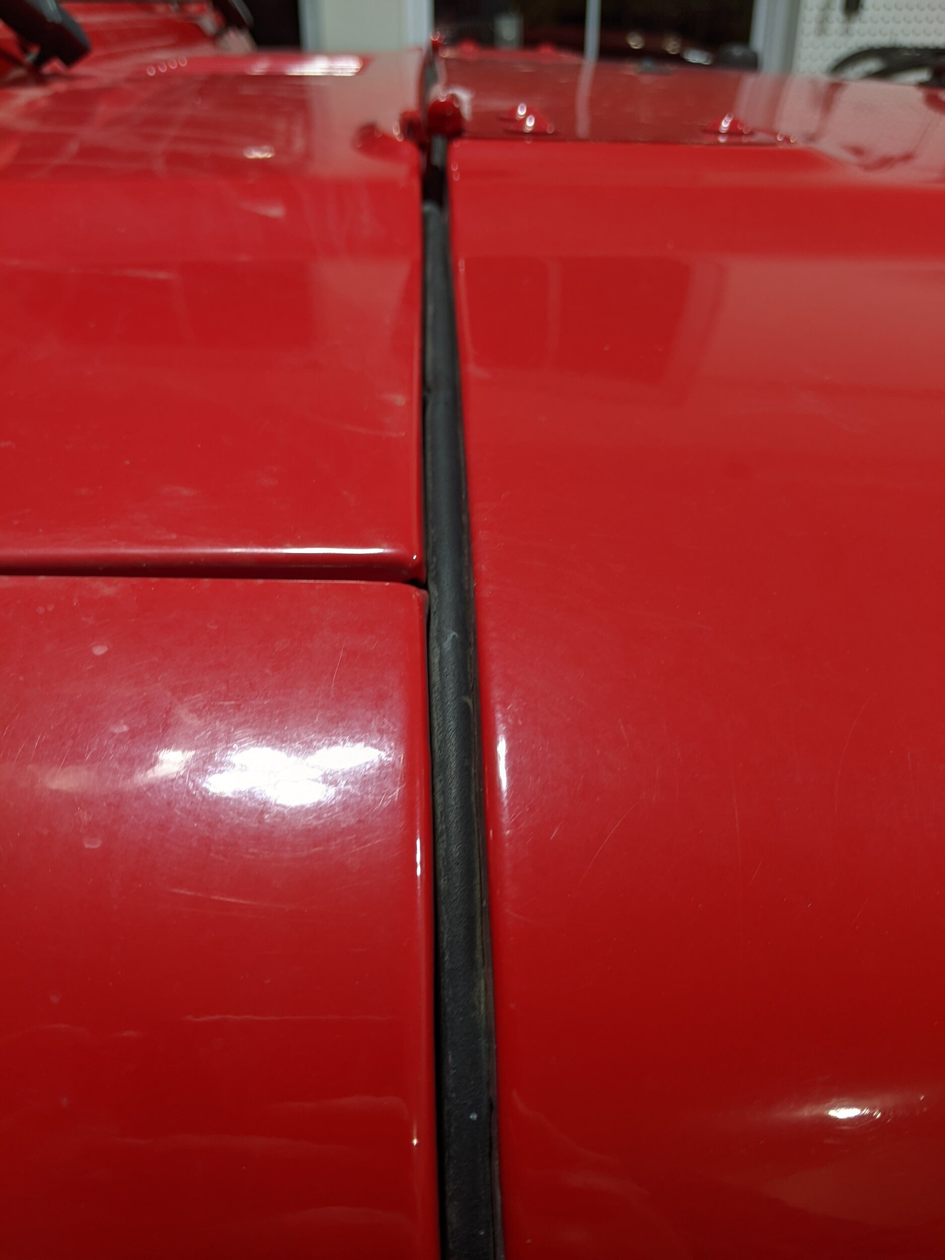

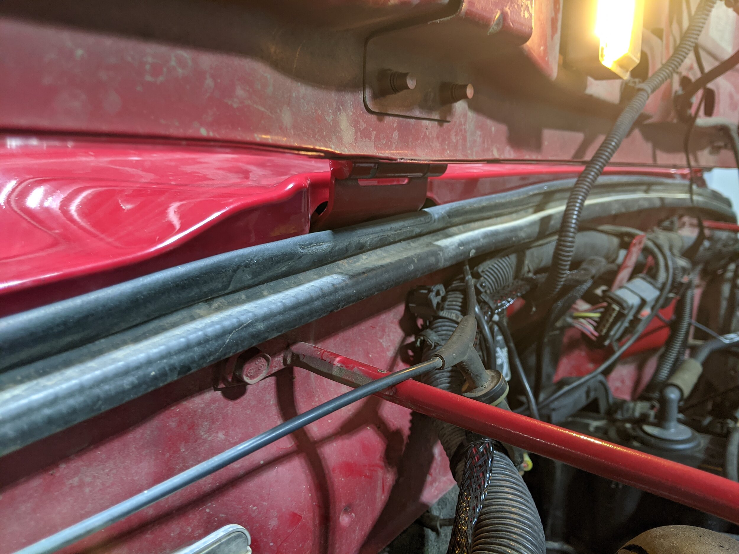

Here's some photos from my 06, which looks basically the same as my 99 did, which I would expect is not too much unlike your 97.
With hood closed:
Reactions: bbaldwin237
Reactions: freedom_in_4low
Thank you! That's definitely the weatherstrip that's missing and that looks like it would seal up exactly where it needs it. Maybe I'll order the weatherstrip and a 98+ cowl like @Wildman showed.
My 97 doesn't have that weatherstrip either. It's been a long time since I've had it parked outside in the weather but I don't remember my floorboard getting wet. I wonder when they changed and that weatherstrip became standard?

I hadn't had any issues up to this point. I had even checked on it after some heavy rain last week. But a couple days ago we had a torrential downpour with wind and I think it was just the perfect conditions to get in there. Or with all of the rain we had it had flooded the cowl? There was water down inside the intake.
