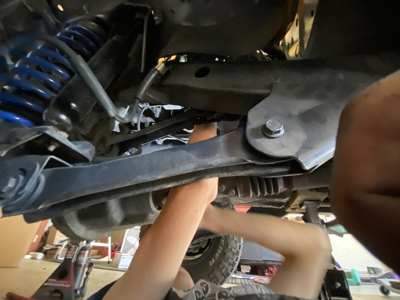

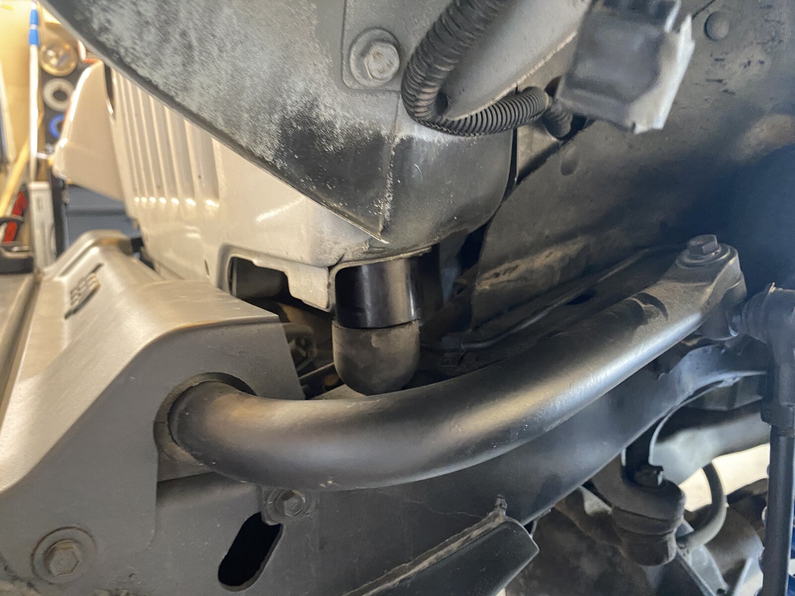

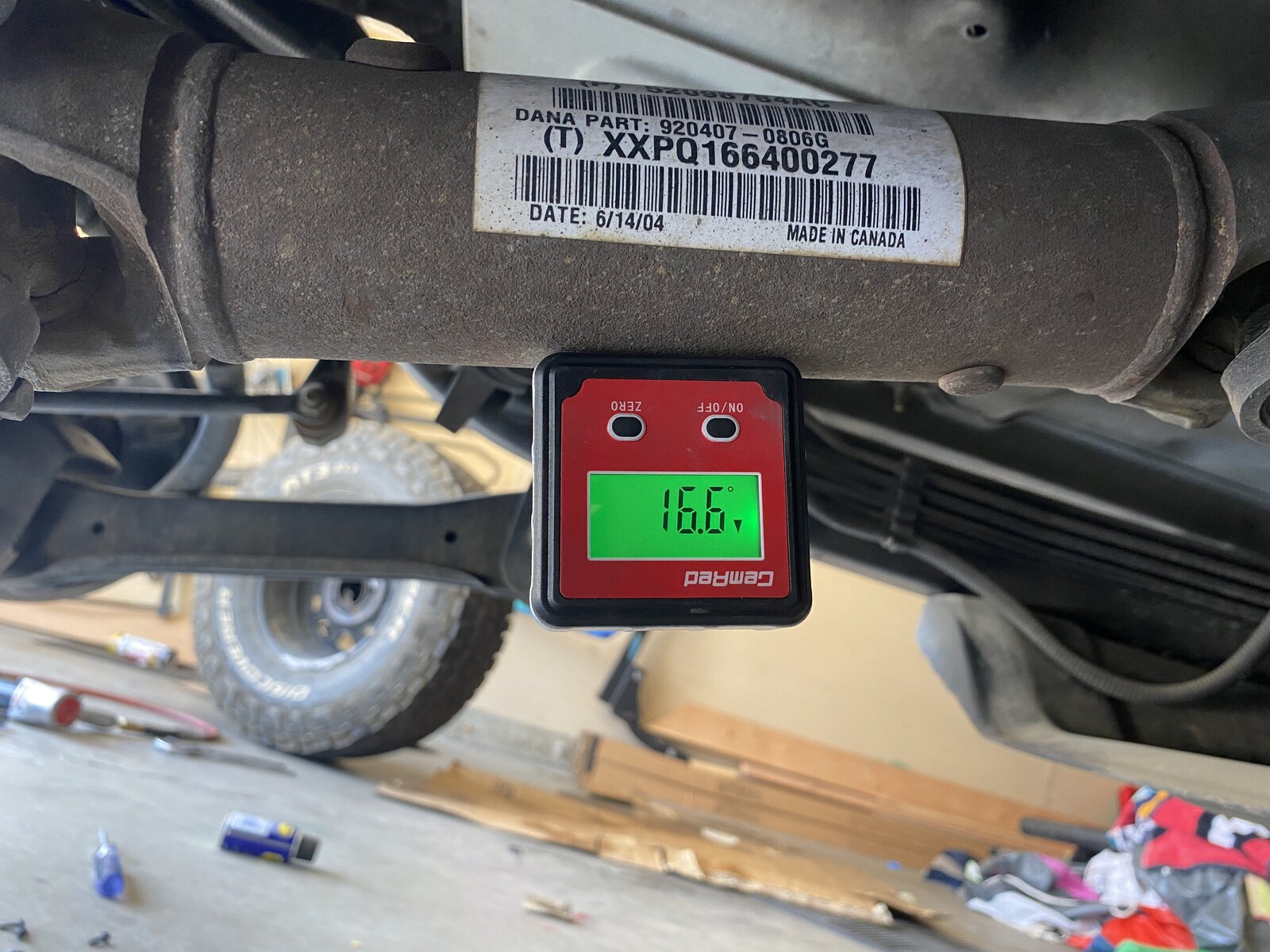

We did the MML first just to be against the grain. It doesn’t really matter anyway. The MM was a bit of a pain, the BL was fast. Thanks to those who provided the pucks. Super nice! All we had to do was go get some hardware from Ace. I told them about the gas filler tube needing lengthening, and I started on it. After 30 minutes I turned it over to them and left. After 20 minutes I went back to check on their progress. ZERO. I told them we could button things up, put the gas cap on and go for a test drive. Before the DS was 18.9* and it shuddered as you stopped on the gas. Now it’s 16.6* and smooth as glass. Big smiles all around when they stomped on the gas and felt it!

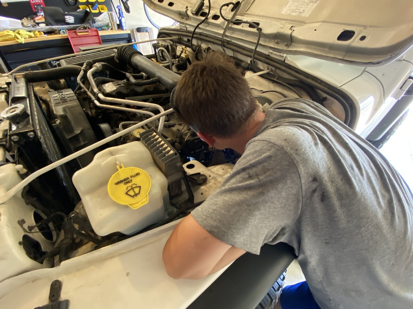

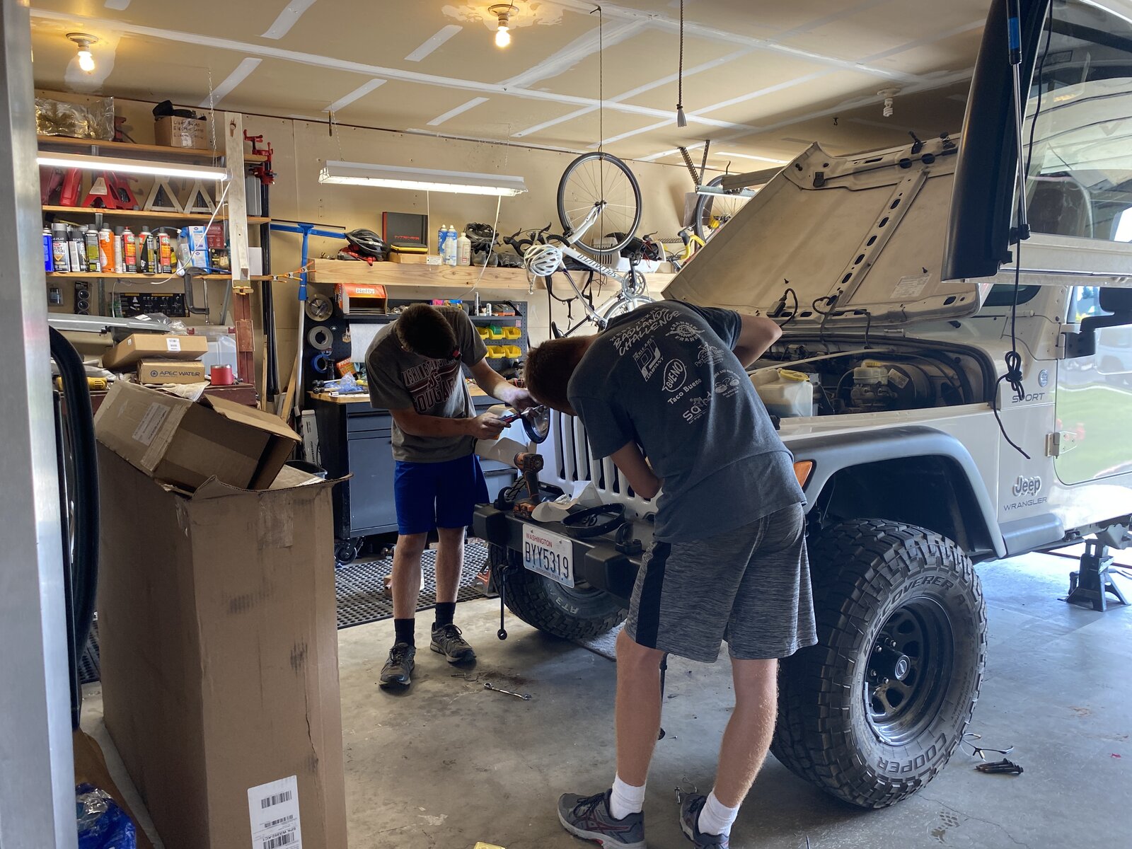

Day 129: Garage time. I did not enjoy working with the twins today. I told them to watch the Rokmen BL and MML videos. Supposedly they did, but they didn’t know shit. They’re messy in the garage. They were arguing with each other. I had to problem solve a few areas. It was annoying. I was like, “Get your shit together or we’re going to spend all day doing a 3 hr job.

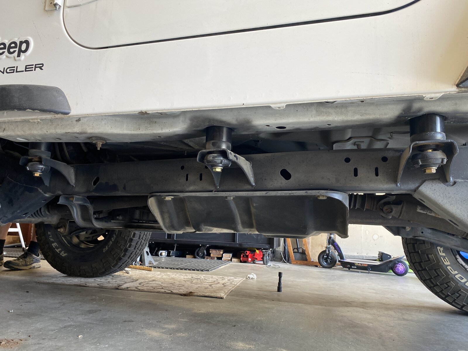

Having just done my MML I confess I found the point where I undid the mounts with the engine just supported by the jack on the oil pan pretty daunting. I was doing it during odd bits of spare time, but it took me about four days, and I still have one bolt I can't tighten :oops:

They were more annoying than anything.
“Where’s the 15mm?”
Using hand tools when I have drills and stuff. Ratchet…ratchet…ratchet. 🙄
“Where’s the 18mm?”
“Why are you using that tool?”
“5/8” is the same as 16mm dad.” “No it’s not dude. Close but not the same.” 🙄🙄🙄
Oh yeah, here’s the new stance with the 2 3/4” OME + 1.25” BL and 32’s. We could remove 1” of bump, but we’re going to take it out first, after we do the GTS tuck. Plus, we still have to add the Savvy TCase Cable shifter so they can actually use 4H/4L.
