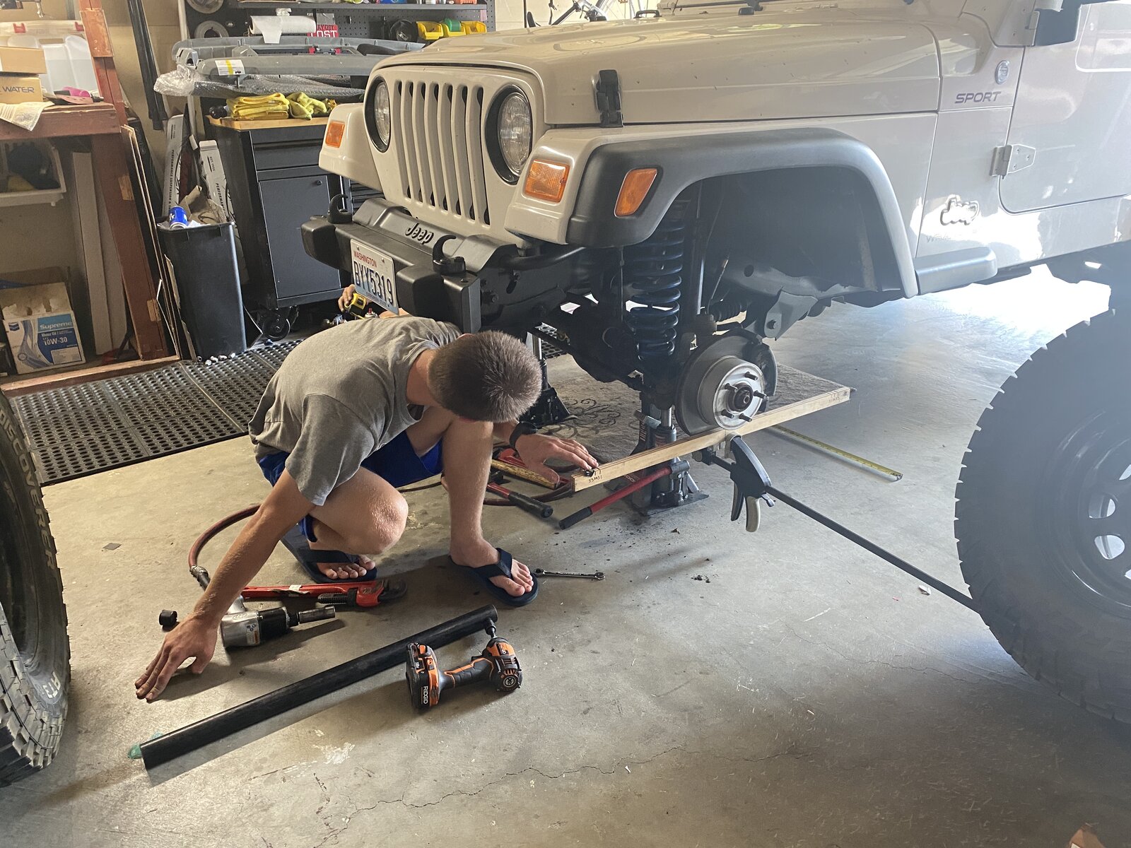

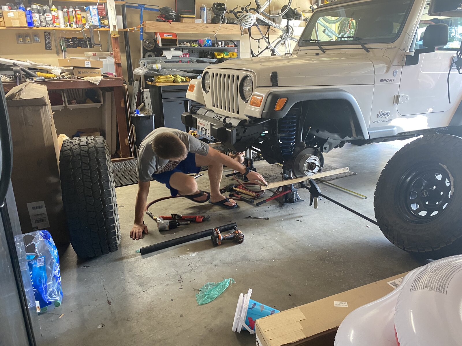

They still needed to align it after the lift, so this was their first alignment by themselves. I did help a little. They were 3/4' toe in. I explained that the stock TJ tie rod is a thin walled hollow tube. They had seen these fold easy on the trail in the past, but were still surprised. I told them I would probably move my ZJ over to theirs. They said, "What are you going to?" I said, "Currie CurrectiLync." They said, "yeah, yeah, you're getting to upgrade." I said, "Yeah, you're getting an upgrade too, so shut up!" They just laughed. 🤣

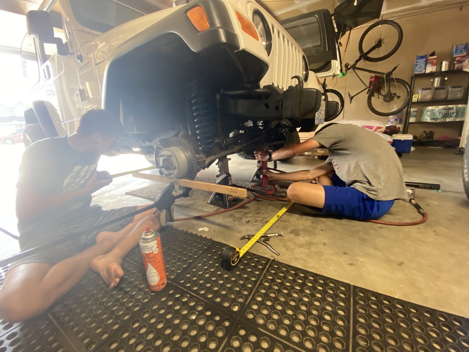

Day 129: Garage time. I did not enjoy working with the twins today. I told them to watch the Rokmen BL and MML videos. Supposedly they did, but they didn’t know shit. They’re messy in the garage. They were arguing with each other. I had to problem solve a few areas. It was annoying. I was like, “Get your shit together or we’re going to spend all day doing a 3 hr job.
