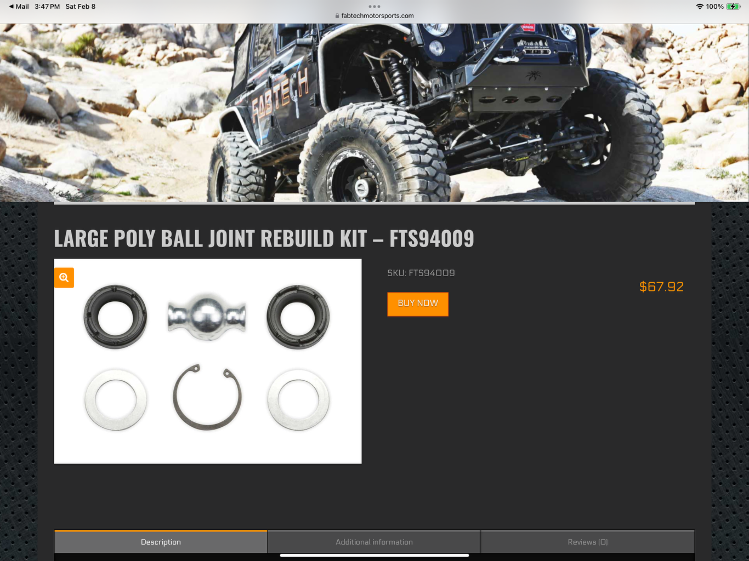

Long Arm Poly bushing ball joint kit x 4 ( just for rear, front later) $68.00ea = $272 plus tax shipping

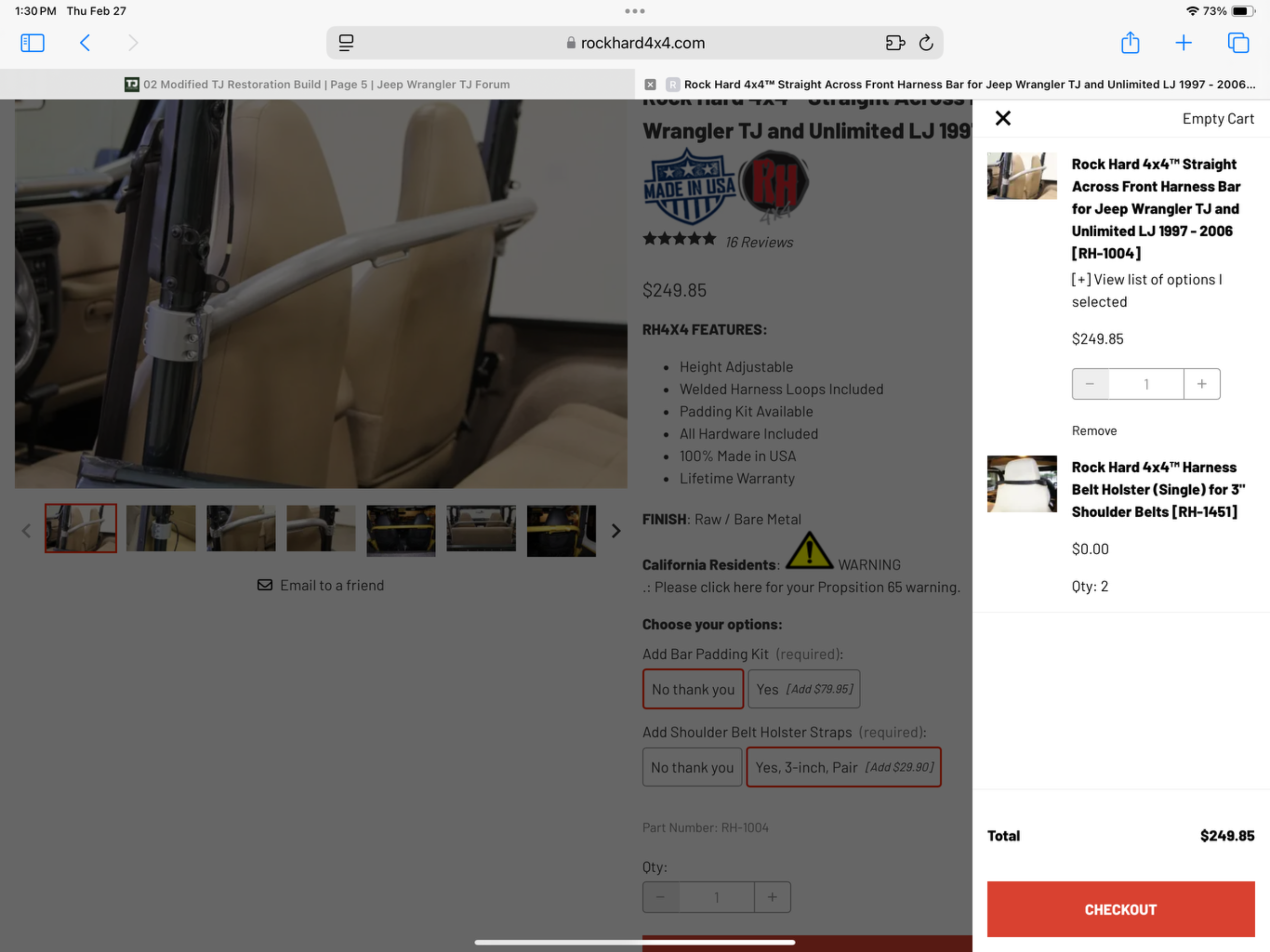

Rock Hard harness bar with straps $250.00

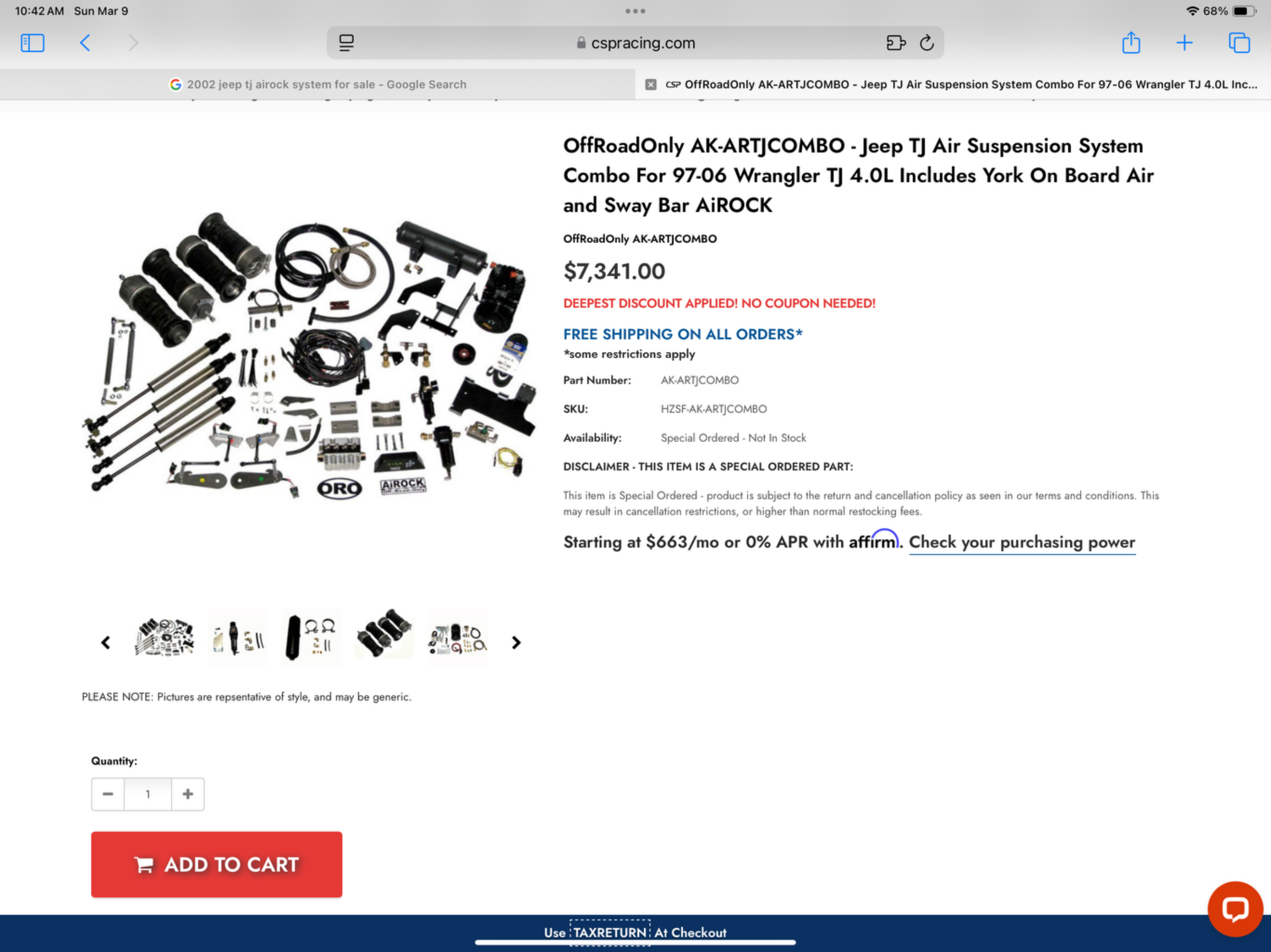

AiROCK ? $1300.00 plus big bucks? + $30.00 for AiROCK T-shirt
$XX30.00
$XX30.00
AiRock when I bought it in $2005 or 2006 was close to $5K for everything if I remember correctly. That $1300 is only the shocks. I have 12" travel Fox shocks with remote reservoir & LSC so they were a little more than that.

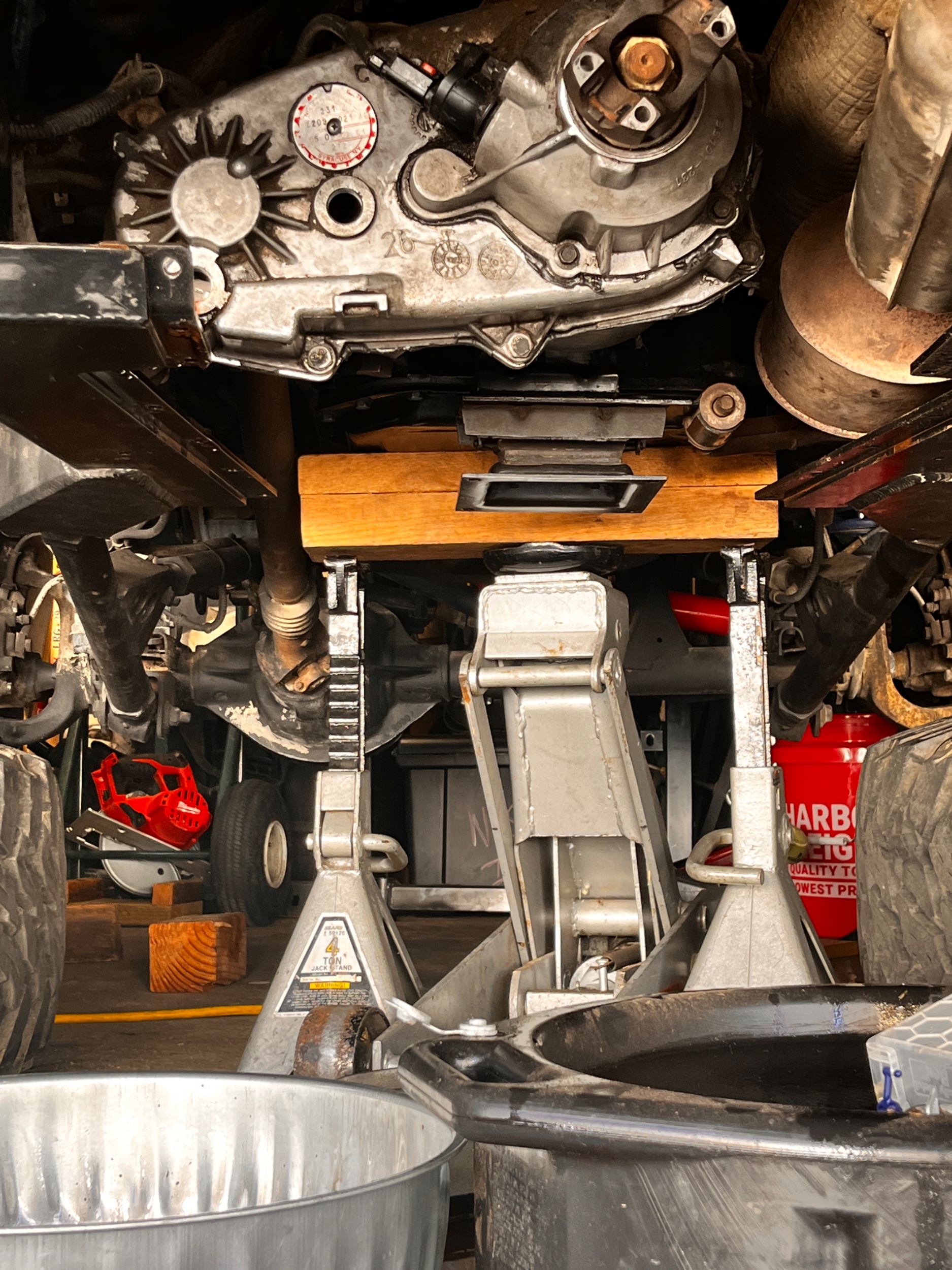

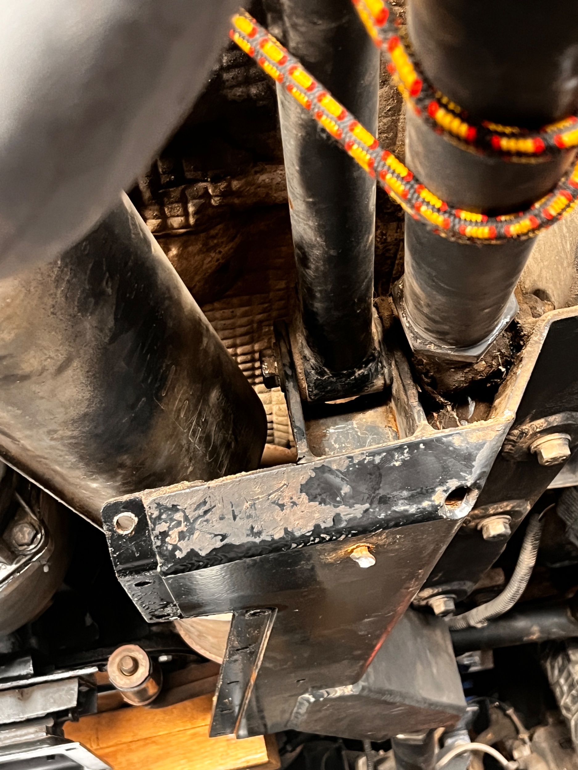

Well….made some progress today, I stopped at exhaust drop step to get at passenger side long-arm upper bolt. T-case drained, nothing alarming, no metal fines evident. I used my bicycle headset tool to remove ball bushings, don’t seem to bad. Shocks look rough but seem to be functioning fine? Tranny mount feels squishy. Not sure when to drop t-case, Running out of bench space. All good 😎

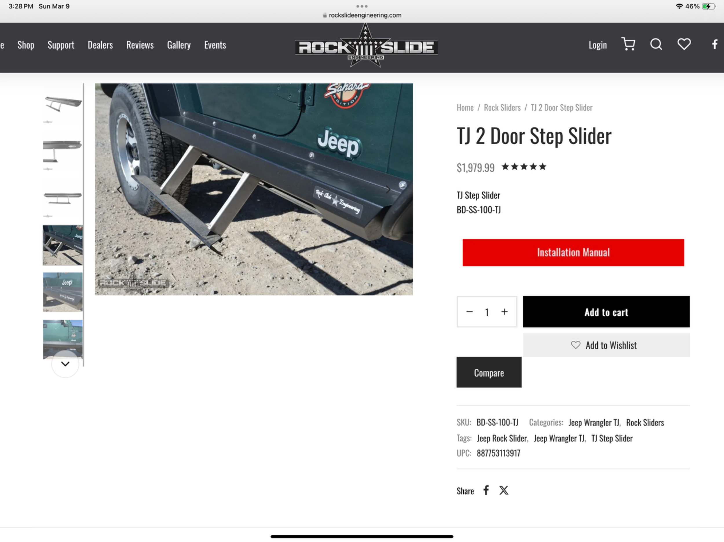

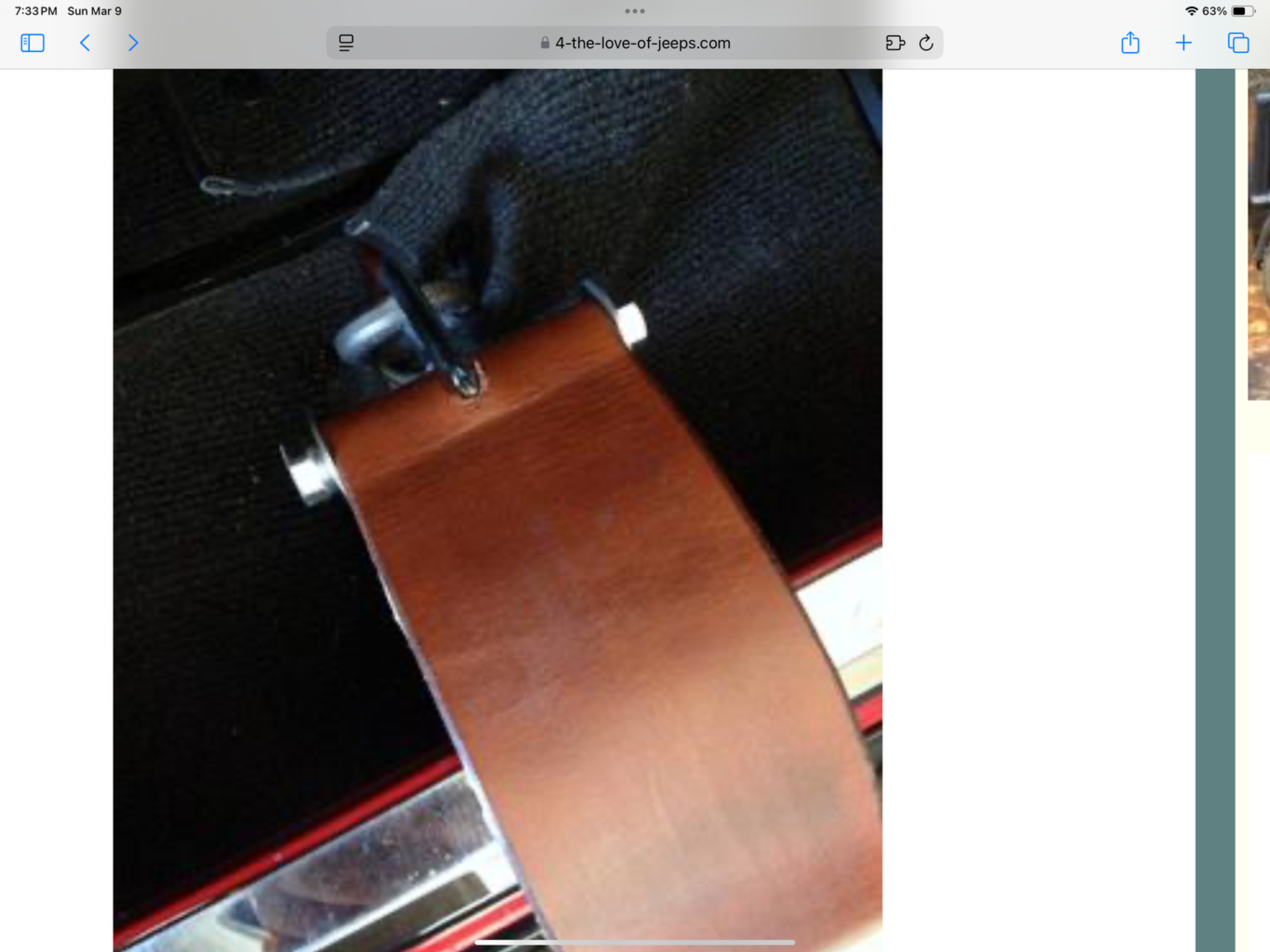

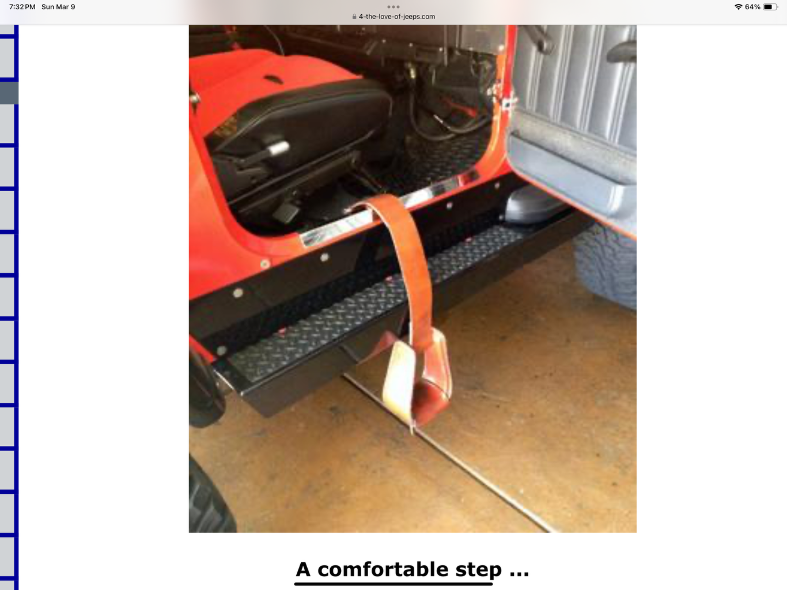

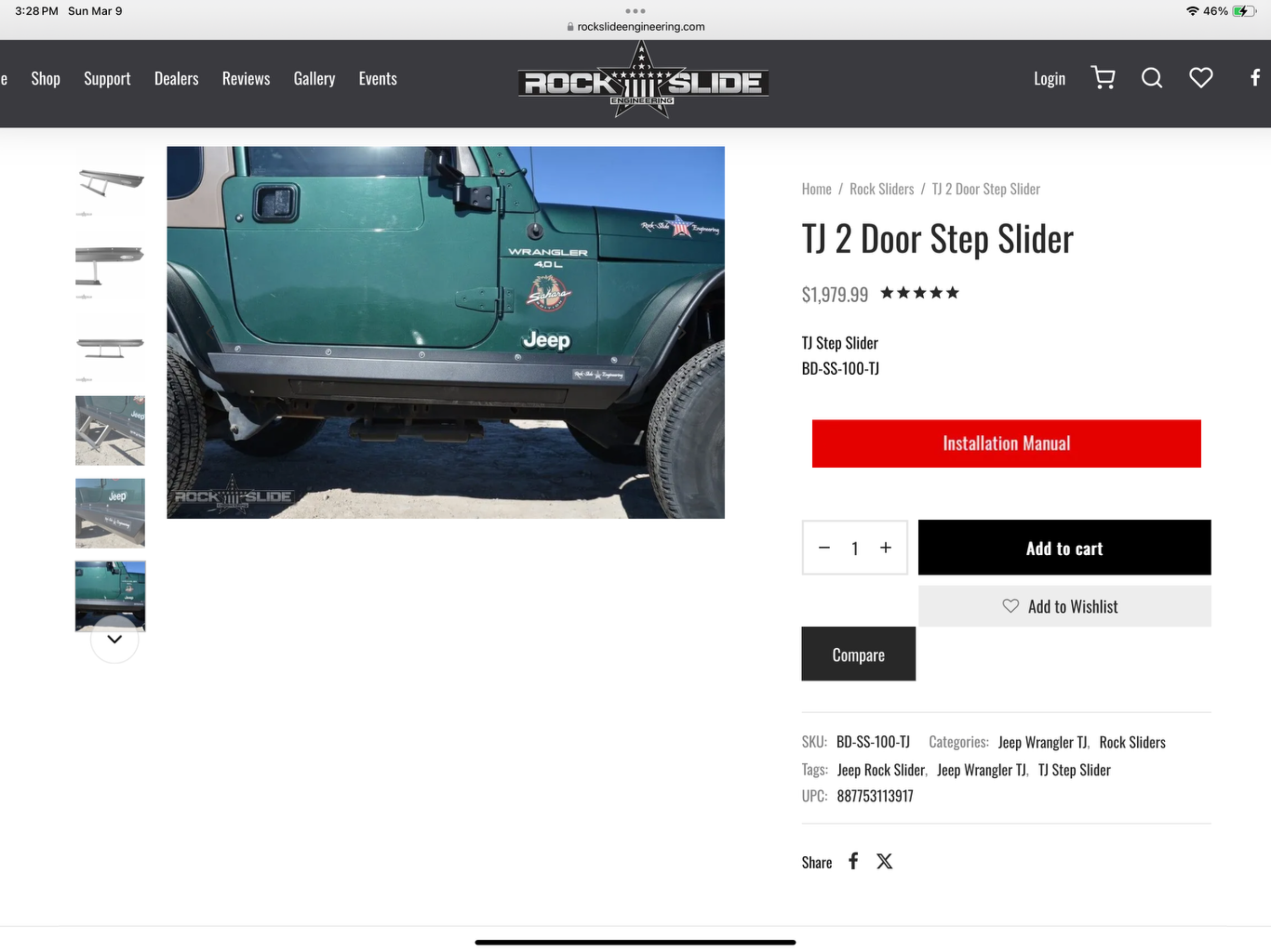

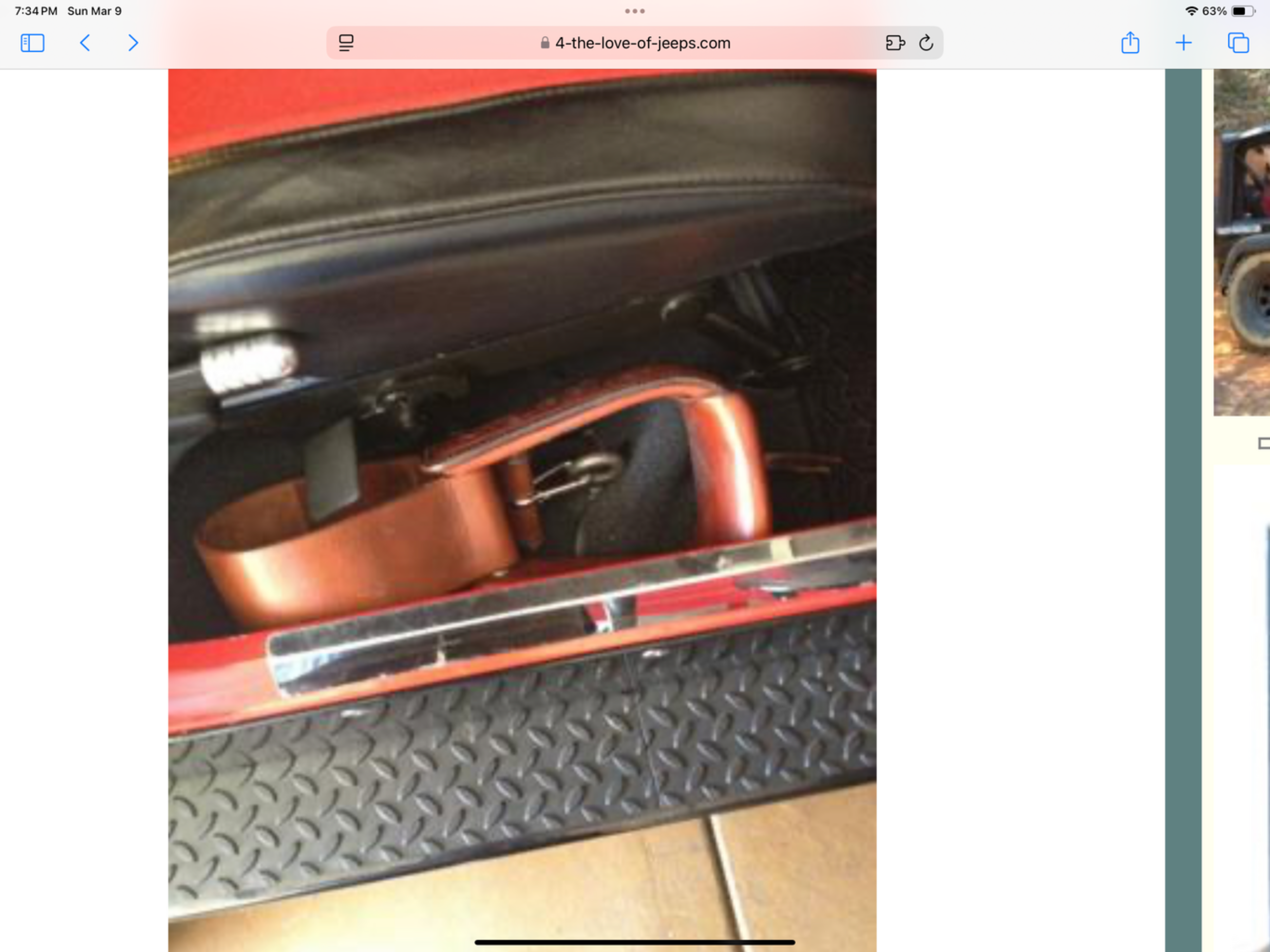

I don't have that other half to bug me about my toys.. Could be why I'm broke all the time. Get it fixed and take her for a few drives and she'll change her mind.
I am not sure how rock resistant these are, but more enticing and a little easier for her and me getting in. She will not get in it…yet.
Reactions: Wildman
My wife was an avid horseback rider when she was younger, I have been trying to encourage her back into it
Clever and also affordable

Back to agenda for tomorrow hopefully. I don’t see why it would be necessary to remove t-case out at this point to repair rear seal?
Reactions: lBasket
I don't see why you would NEED to either. When I did my SYE I left it installed (you take the back half of the case off). Some people like to fully remove it to make it easier but you don't have to so it's probably the same here
