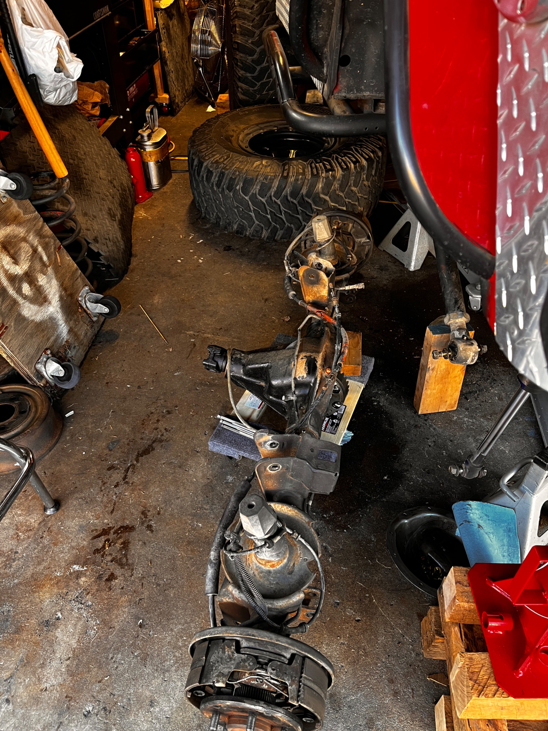

View attachment 597916View attachment 597917
He wants it stripped of weight, pull axles and brake assemblies off tomorrow. As well as the driver long arm, to evaluate what need to be replaced and get parts on order. Then shocks, drop skid, drop exhaust, and remove the other side long arm, A-frame truss. My other buddy gave a tyranny jack today. Get-er-done! That is a factory Super Dana 35, I don’t believe any after market 30spl axle kits have abs speed wheels on them.

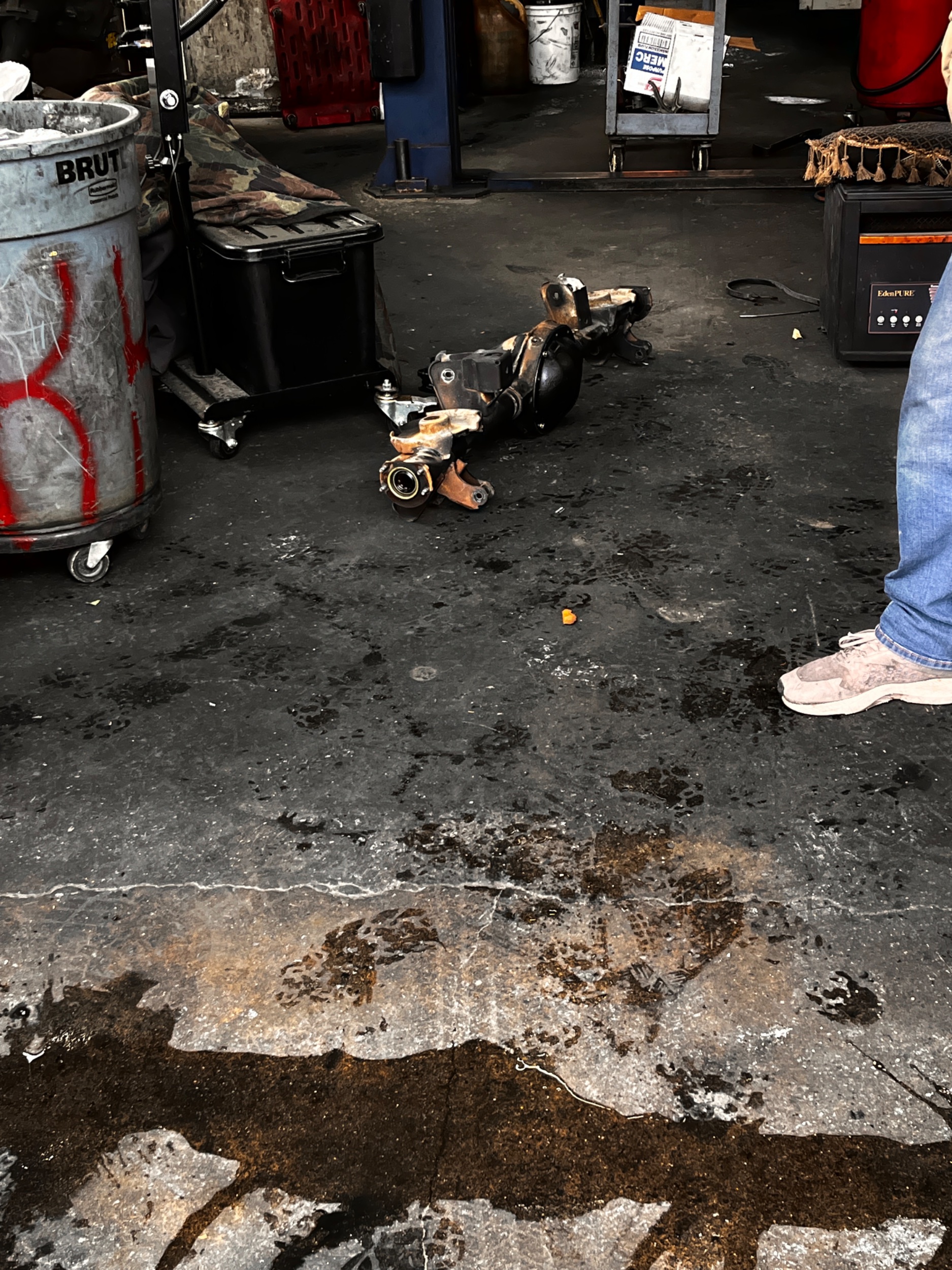

He is getting axle housing dipped and put on a jig to check before proceeding with diff fix. 👍
I missed removing axle seals and bearings. All good

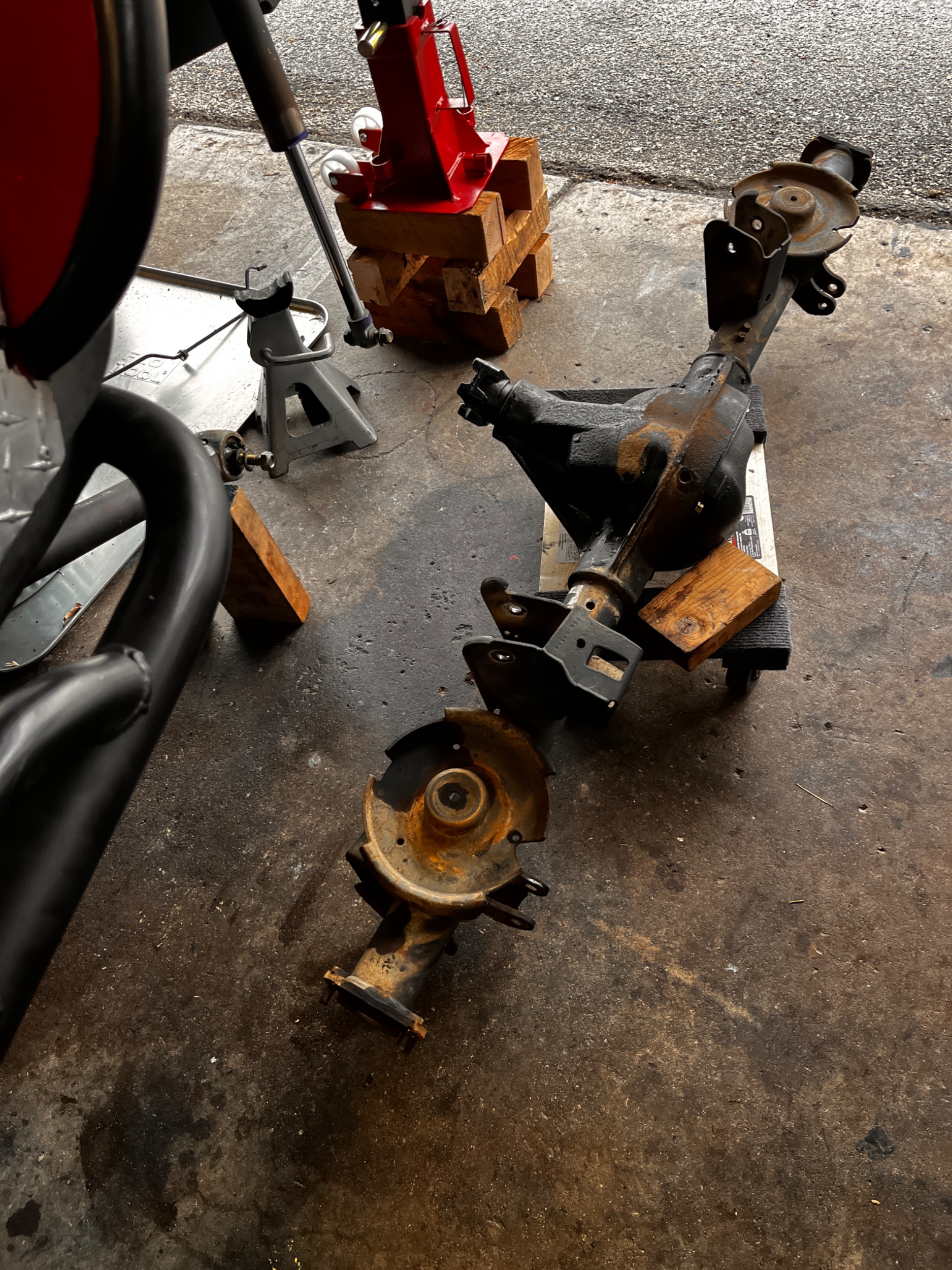

FABTECH parts on order, all should be at my door this Saturday, got the axle at shop today.
View attachment 598491View attachment 598492

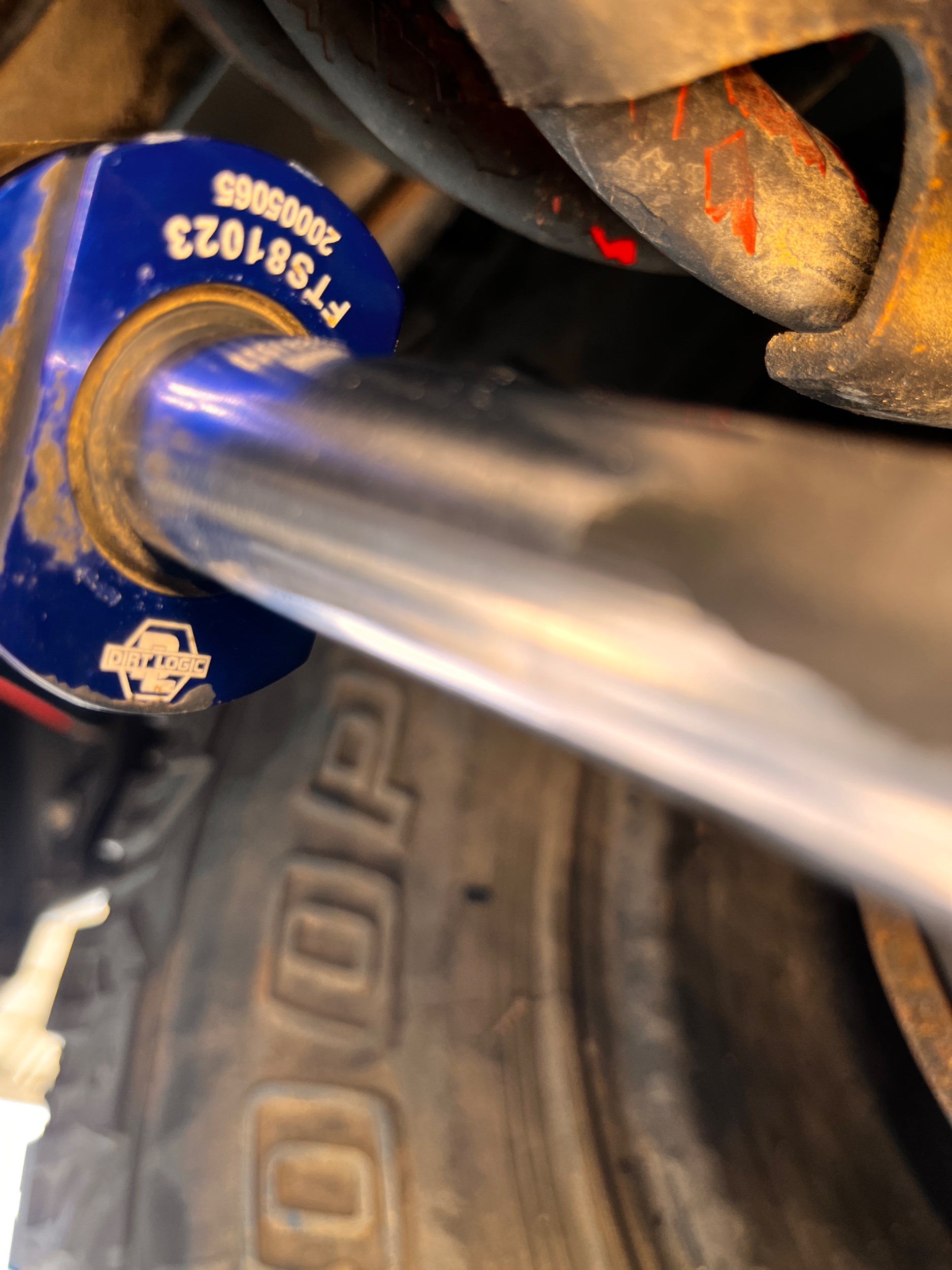

That’s the number for the FABTECH rear shock, rebuild kit is available, which is o-ring seals. Have not removed yet, still just hanging. How do I know if they require any work when I get them off ? Tube pretty rusty, shaft appears clean. I have not done a search yet for a replacement 6” inch rear shock. Anyone know a source? FABTECH offers no service or replacement.
Do you have the tools to rebuild the shocks? A way to charge them once they are back together? Being in CA I'd imagine there has to be a shop that could do it within a reasonable distance.
Here's some kits for the Dirt Logic shocks.
https://www.shockseals.com/collecti...TCQvfwpgj-NxafrNbT8Ujrz3v2ltq99gV2lPMHSdotgVU
https://www.schmidtyracing.com/off-road-seal-kits-s/1864.htm
Fabtech will also service them.
https://fabtechmotorsports.com/supp...X5B3vdFKiM85zLDZAT8TU2QrFqyB0pm6NFXWMjqsg2Tgx
I forgot about KING shocks. I will go with them, heard good things about them.

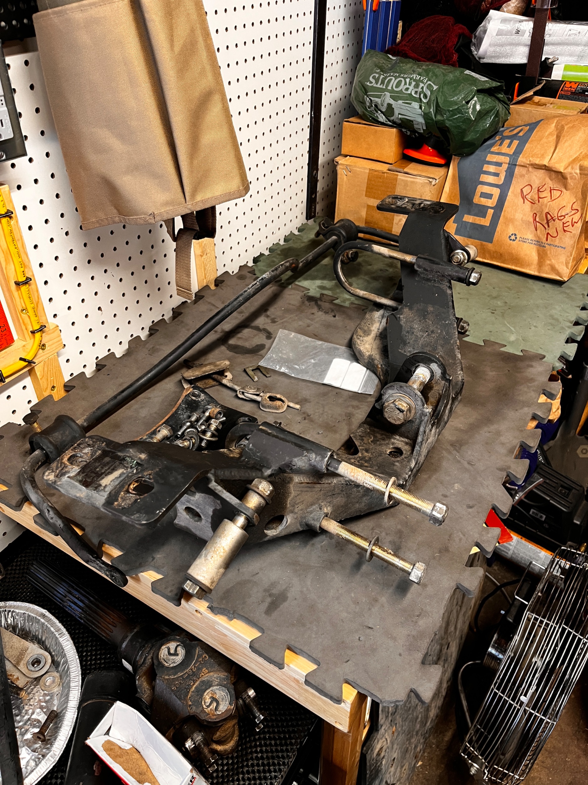

Your rear spring have to bend forward a little bit due to where the upper perches are located. By moving them directly above your rear axle you get better articulation & alignment..
The purpose of relocating the rear upper spring seats is to make the bump stops line up again after raising the pinion.
It is a good idea, bolt in relocation is interesting with shorter springs, but relocating what I have is better? Ride height lower?
If you read most didn't have a lower ride height. None of these kits are bolt in. They all require you to weld the brackets on. Relocating what you have is cheaper and if there isn't anything wrong with your perches there isn't a reason to get a kit. I was just mentioning that there were kits because you'd said you had some rust and those perches can rust out first.
I saw this in the beginning of the thread you sent me, came with lift kit I guess, thats what I meant by just moving existing and weld much stronger.
