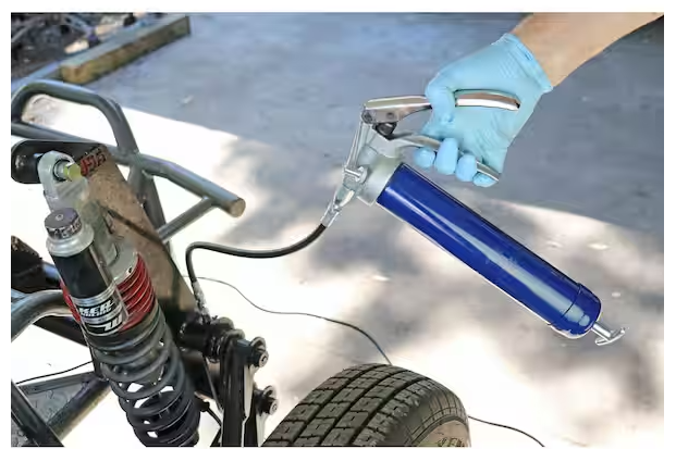

6. Grease gun selection and tips: Personally I've never like the "lock-on" style fittings. They are bulky and clumsy when a fitting is in a tight location. I like to use a manual PISTOL style gun that way one hand can pump and the other can keep the tip on the zerk fitting. The manual guns with a lever are a PITA and unhandy. I'm not a fan of electric grease guns either for several reasons. So if you don't have one this is what I'd recommend. View attachment 630445
