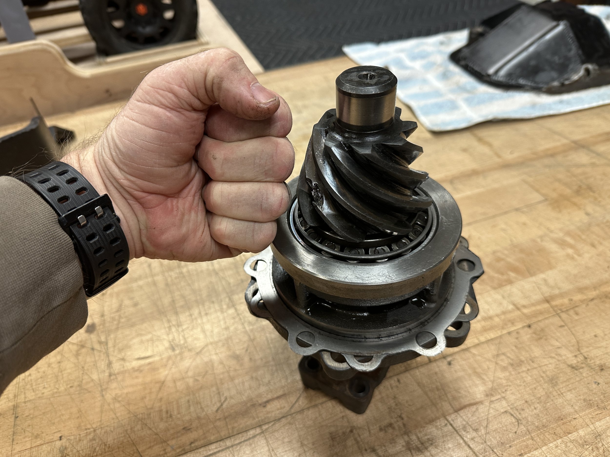

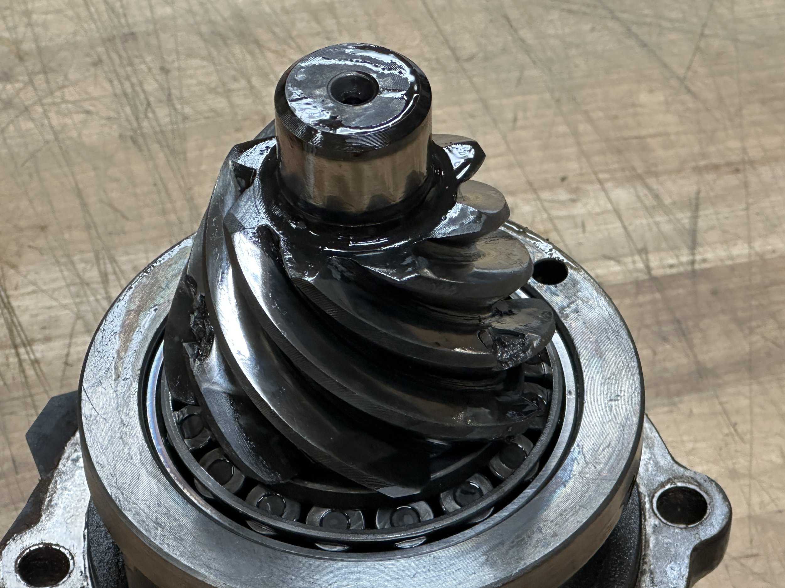

The pinion teeth by design are stronger than the ring gear teeth. If this is a debris failure, then there should be corresponding damage on the ring gear teeth.
No damage at all to the ring gear for that failure. Anxious to see what this one looks like when I get around to pulling it apart.
