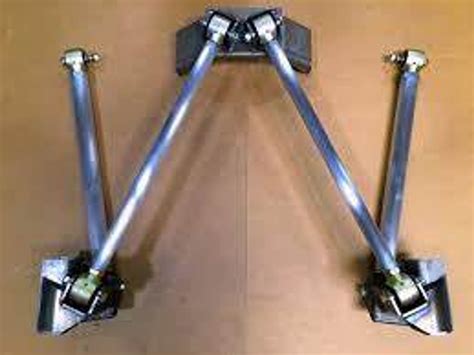

This is a trangulated 4 link (the rear Savvy mid-arm in this case):

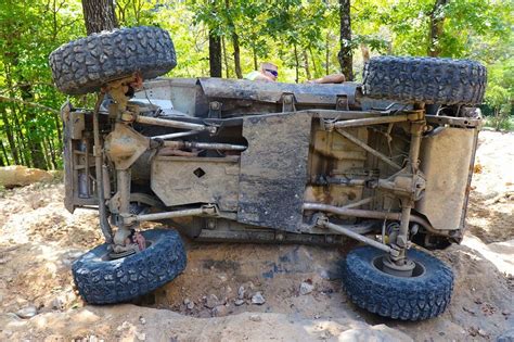

Here is an example in the wild:
The set up improves the geometry of a lifted suspension, if designed well. That can do things like reduce wheel hop when climbing. And because of the triangular structure, side to side axle motion is controlled without the use of a track bar.
These set ups can be expensive and a lot of work to install so probably not what you are looking for now, but you asked so there you go.
