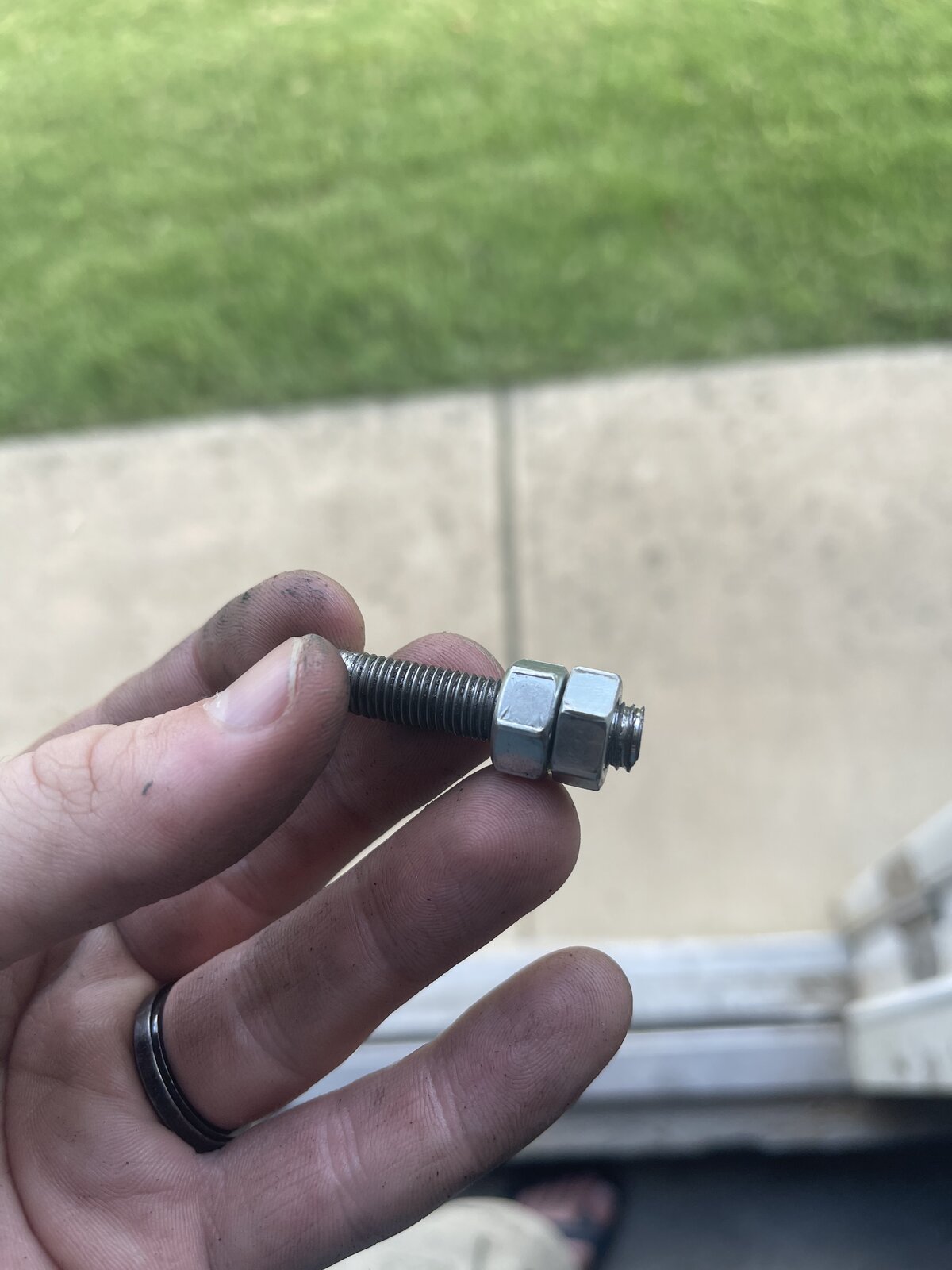

Just got absolutely wrekt by the install kit on the swayloc.
Took me about 30 minutes to get this stupid little stud out after installing on driver side.
I was fighting the stud real hard to even get a nut on it, so I’m thinking something wasn’t right out of the box.
The supplied hardware wouldn’t go on without an absolute fight. I should have known better

Looks like there was not enough threads engaged. I think I had to use a longer bolt to pull it in to where I could get the stud threaded. You may of needed to run a tap in to clean up the threads also.
Reactions: Illiquid
Yep. I used an entirely different stud the rest of install and it went 100x better. For whatever reason, the one included in the box wasn’t quite right

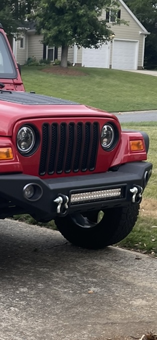

I’ve always hated the front bumper on my LJ, but it was on a low list of priorities to fix.
I had to remove it to install the Swayloc and decided to replace it then.
So have a motobuilt stubby front bumper on the way and a guy buying my current bumper this afternoon!
This is new one I went with (based on recommendations from this forum) https://motobilt.com/products/jeep-yj-tj-stubby-front-bumper-bare-steel

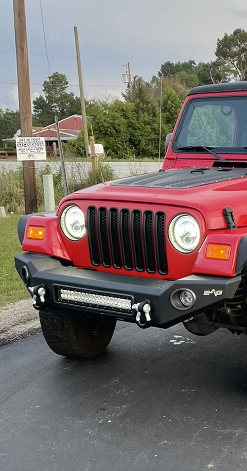

Attached is the current bumper. It’s fine, but huge.
There’s a chance I need more width to pass NC inspection. Luckily I got inspected last month. If so, I’ll pick up a stock bumper to swap on by next year
I think you’ll like the new bumper. I have the same one. I did have to grind a bit to get it to clear the bushings for my anti rock, so make sure to test fit before you paint.
Wow, that current bumper is HUGE. Good choice on the new MotoBilt!

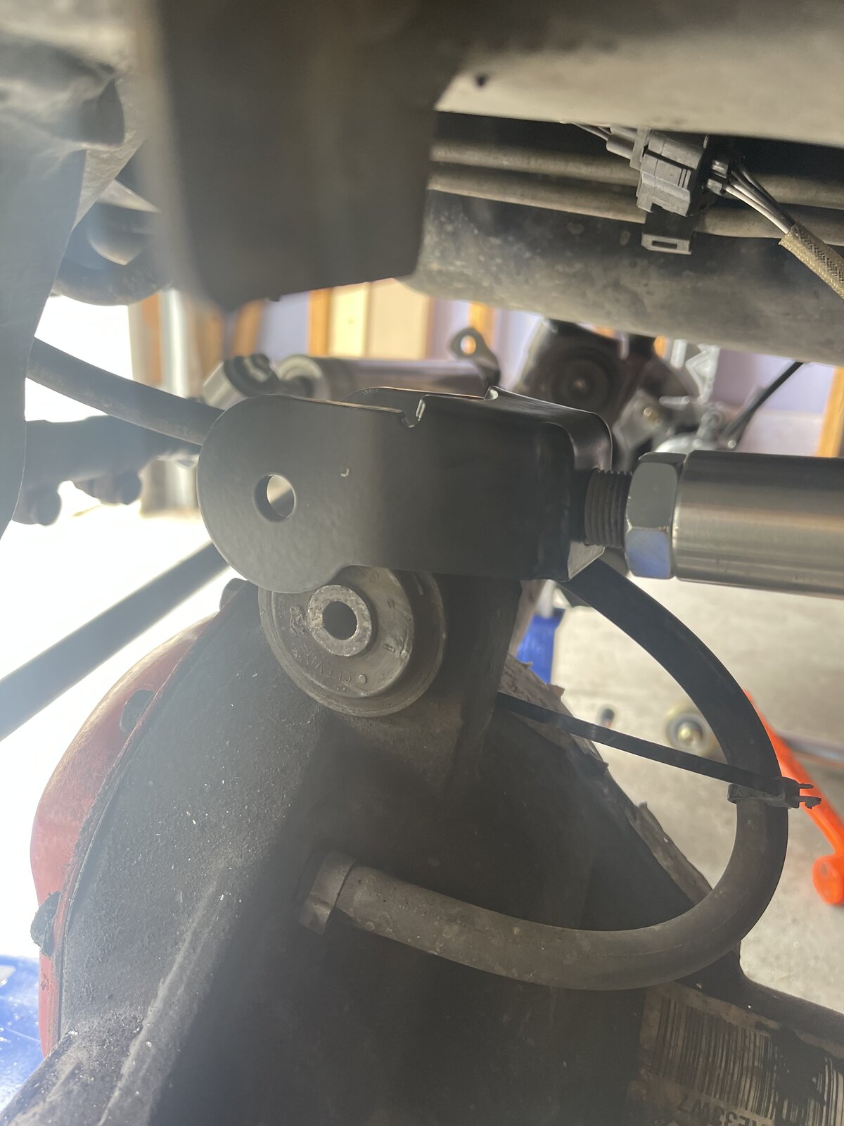

so I’m making fine progress. The only thing I can’t figure out is why this upper front control arm doesn’t fit.
I’ve tried it on both sides and it won’t go on. The other control arm fits fine on both sides so I’m guessing the tolerances are just off on this one?
the black metal end of the arm will not go on either axle side mount. As in it won’t slip over the bushing. I haven’t reamed the bushings yet, just doing test fits

You can take a little off the clevite bushing with a grinder or just get a long bolt with two nuts to spread the joint housing a little. I don't remember it not fitting on mine, but I put them on a few years ago so it's possible.
