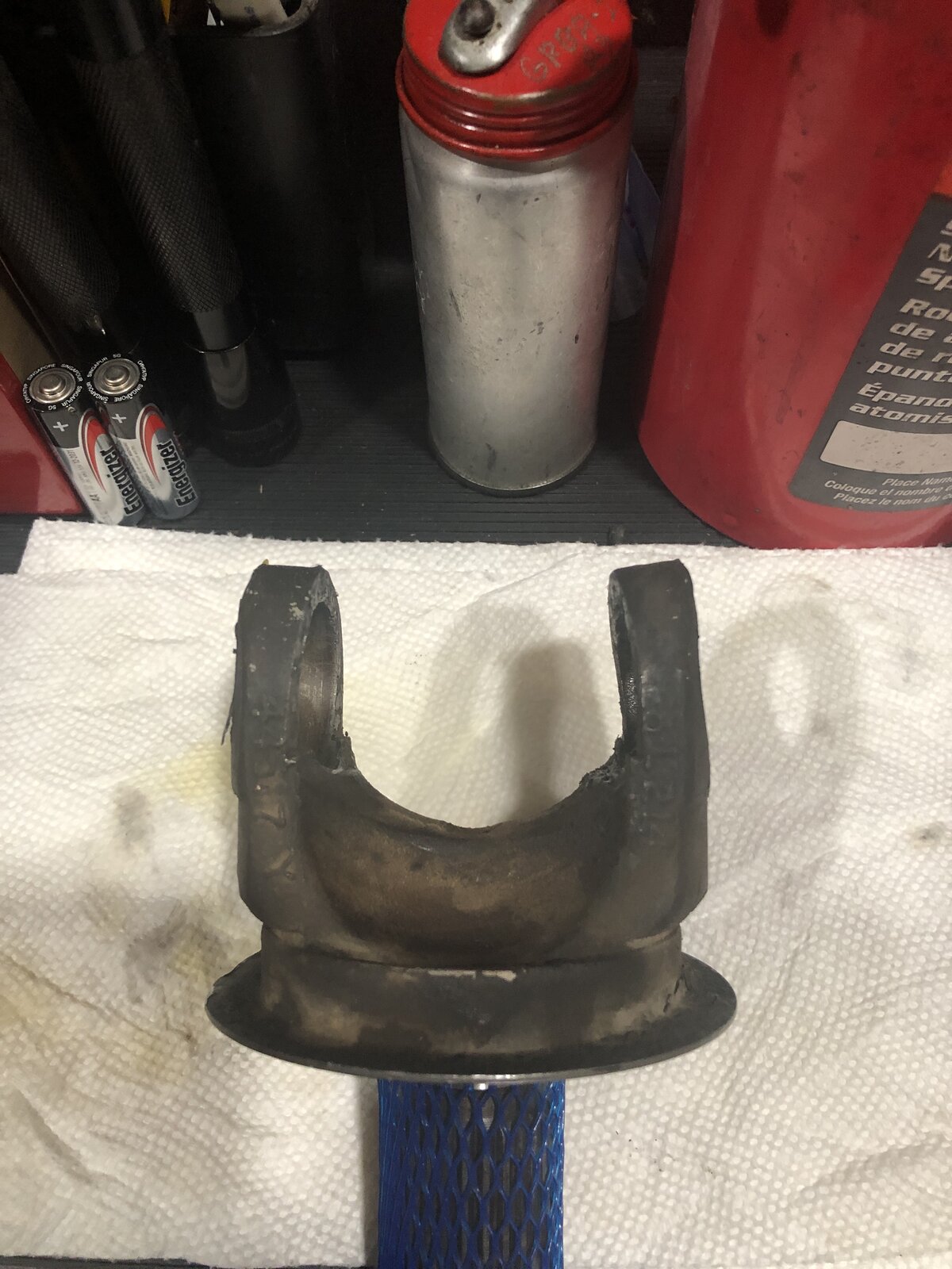

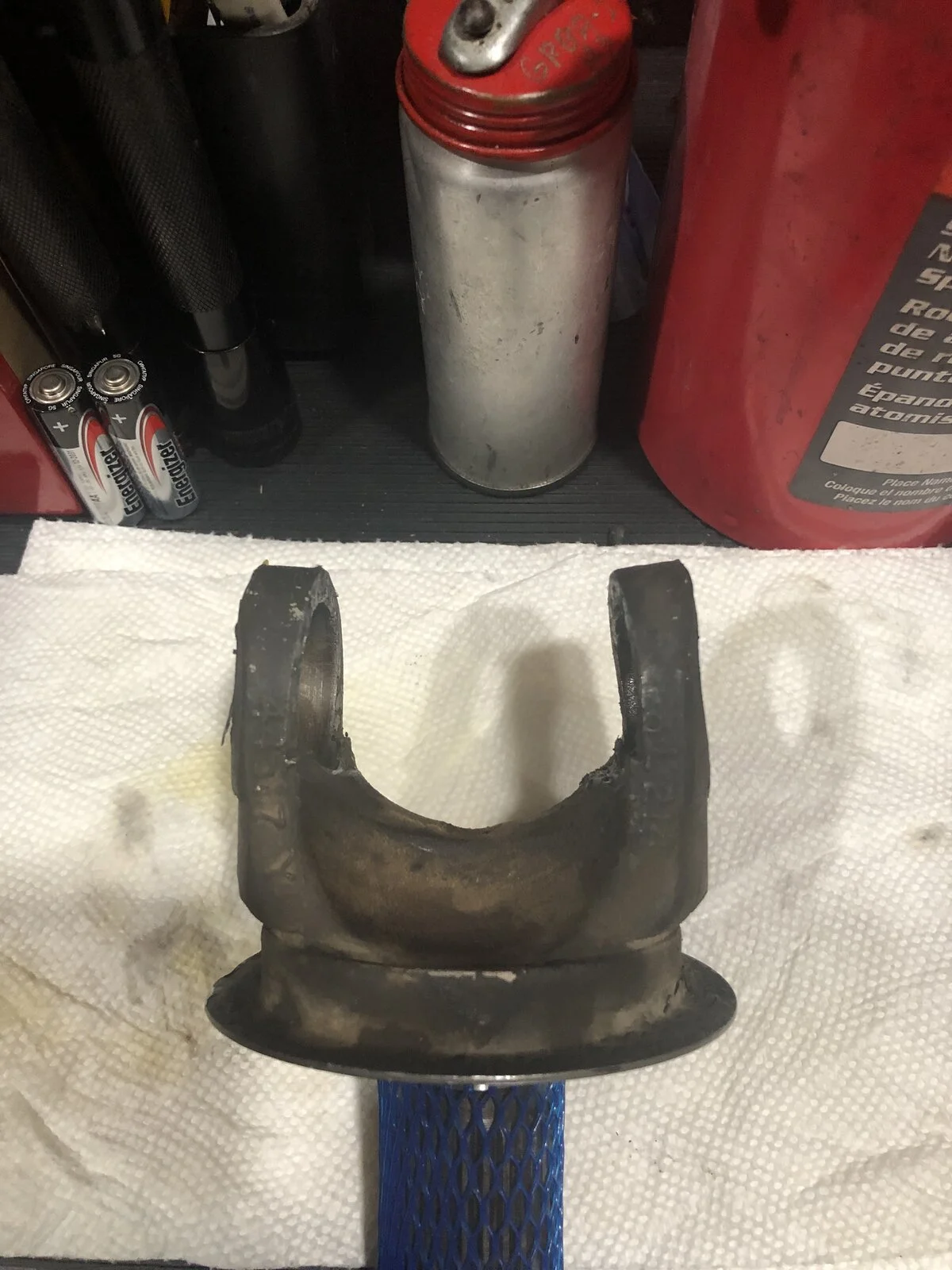

My 04 had a shake like a out of balance tire that would show up at 50 mph. I chased this for about a year doing things like swapping wheels and tires with other jeeps, replacing front wheel bearings and checking the front and rear axles. While checking the ball joints for the 25th time I noticed a clip missing from a U joint on the stub shaft. When I started cleaning things up I found it had an internal snap ring holding the cup in the yoke of the stub shaft. ???????? I found one of the ears of the yoke was bent inward, (the reason for the smaller thickness clip) and probably caused by improper use of a press while changing u joints. I replaced the stub shaft and the u joint and the shake is gone.
