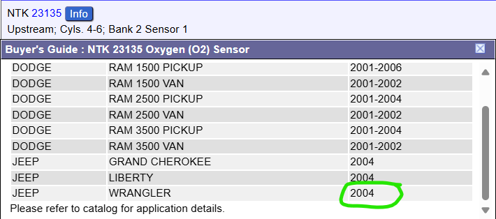

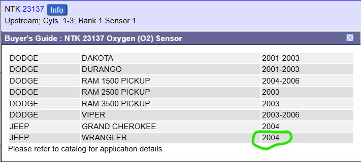

If the harnesses are both 03-04, they are interchangeable except for 1 or 2 O2 sensor connectors.
They are showing more to be 04 only but we only had to change one connector by depinning it and swapping it over.
