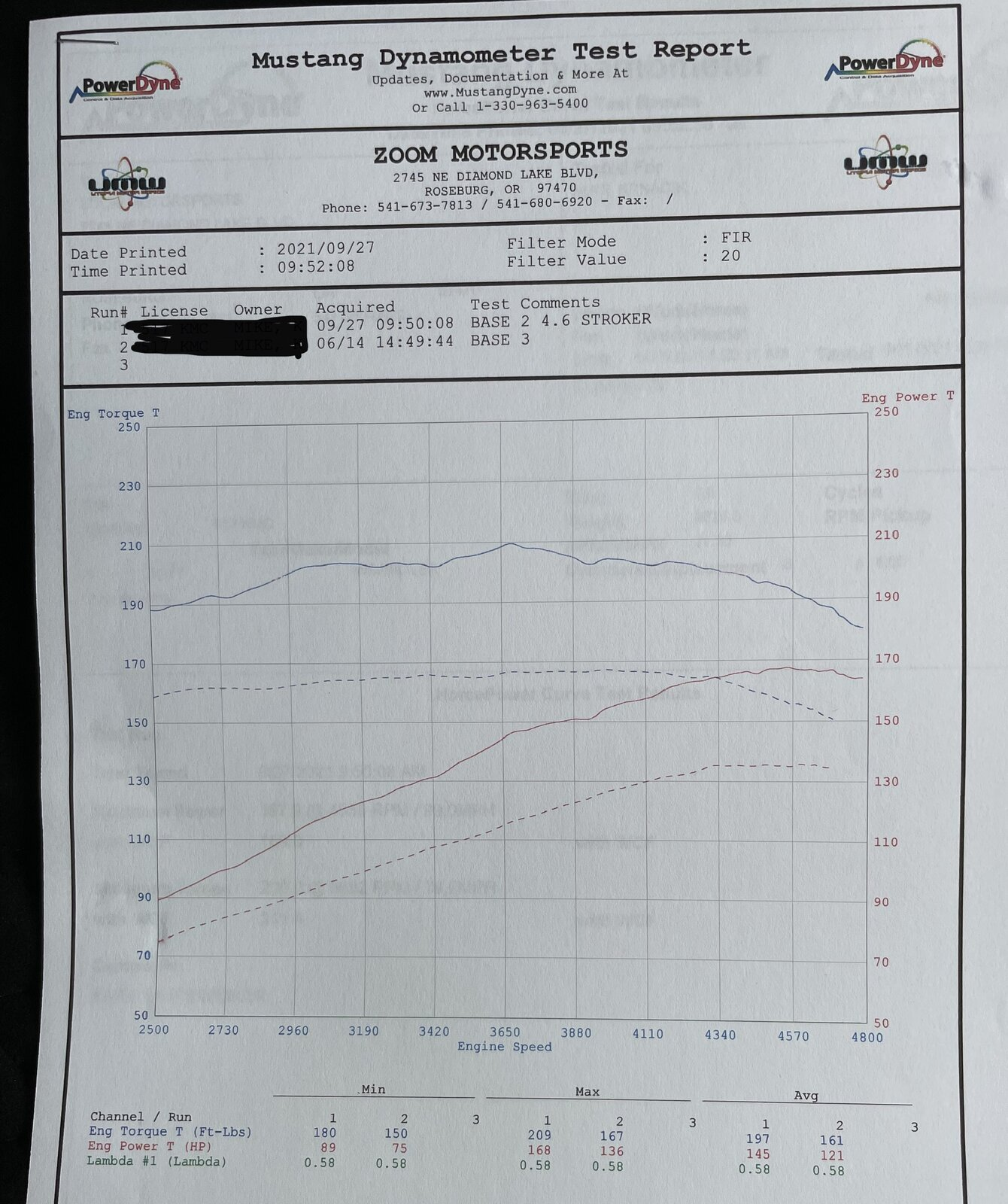

Who on here is the go-to for discussing a stroker build?
So, I've been in communication with Russ after I relayed piston deck height and he confirmed the compression ratio is too low for a naturally aspirated stroker. He also mentioned that with an aluminum head, one should try to shoot for .5 to 1 point higher.

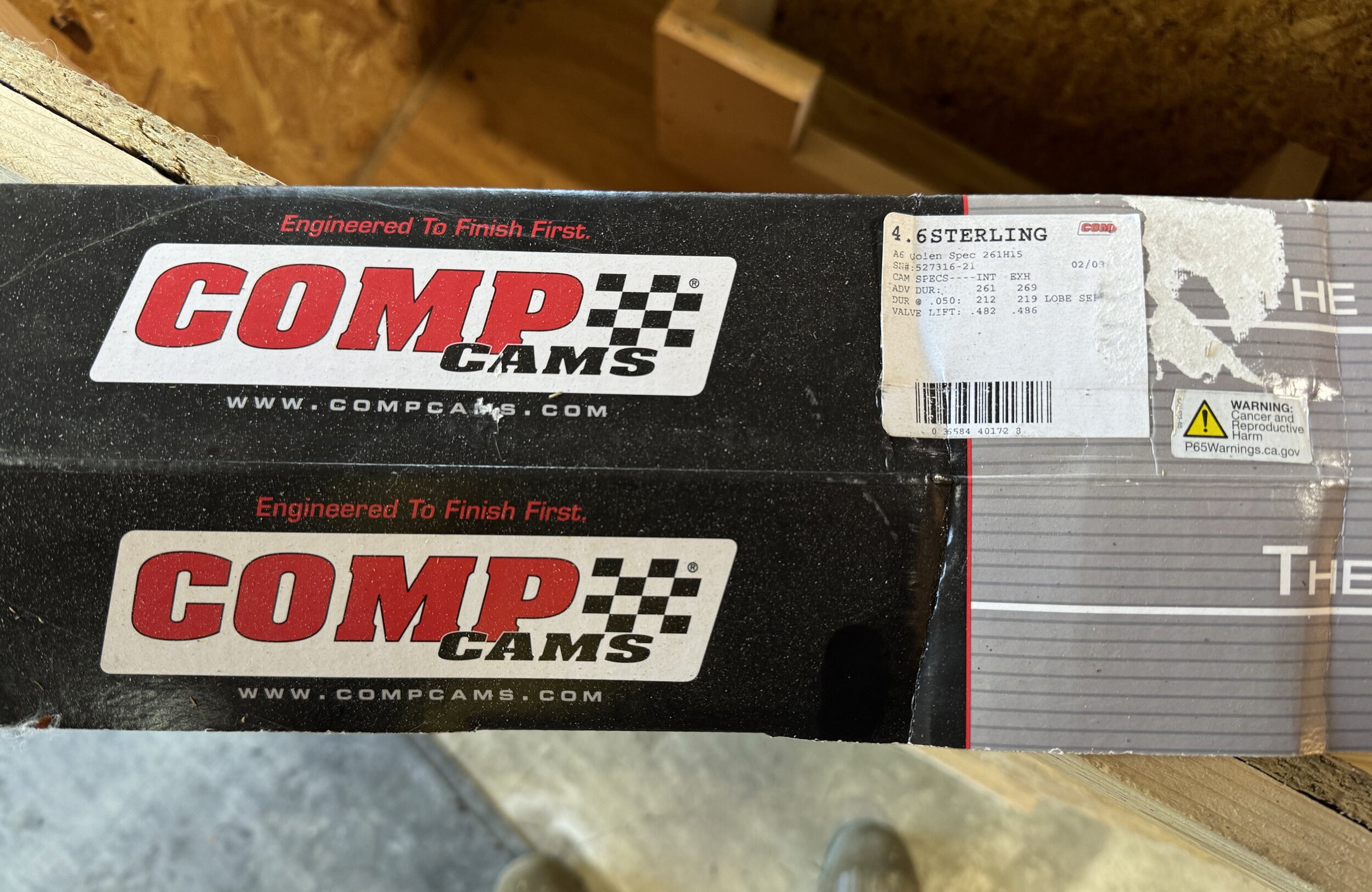

Instead of machining the block, I'm considering (and discussed with Russ) keeping the pistons, on average, .023" below, running the ICON 10.8cc piston, and using a cometic .027" thick head gasket. He also suggested using a comp cams Xtreme 160-301-5 camshaft which pairs very well with the edelbrock head. Furthermore, Russ showed me his Edelbrock ported and LS valve swap flow numbers, which was impressive and questionable.. Why would Edelbrock leave that much room for improvement.
Combined, Icon 10.8cc pistons, Comp Cam, re-worked Edelbrock head, the motor should see a 10.75:1 SCR and a 9:1 DCR.

It's important to have a big enough cam to bleed off cylinder pressure with high compression.low rpm load brings on the rattle. Preignition is no bueno!
