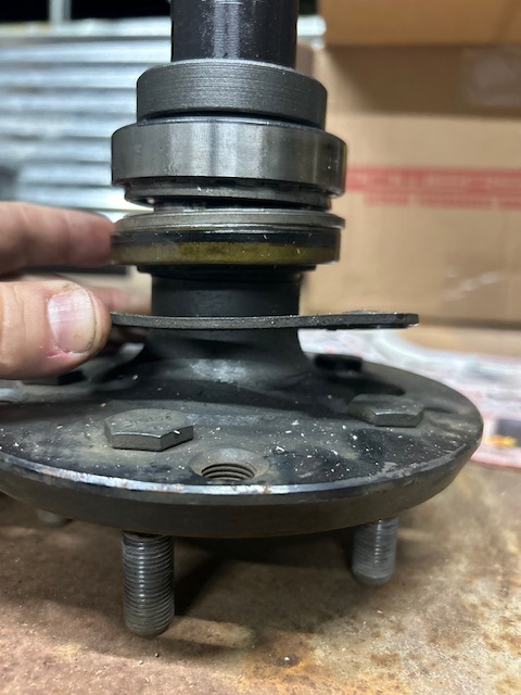

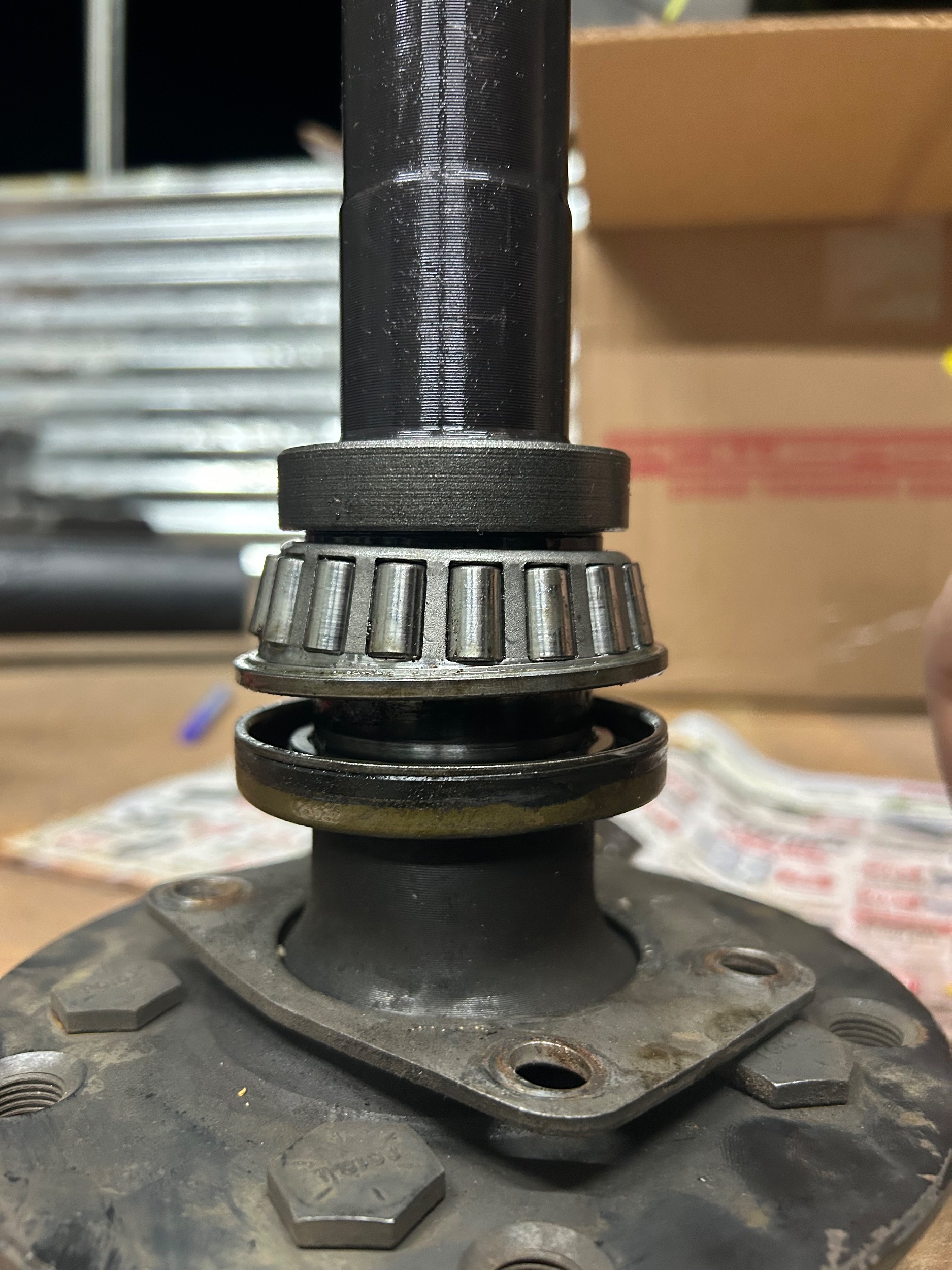

When I built my rear axle,( Wagoneer 44) I installed new bearings when installing the new shafts. That lasted for about three years and earlier this summer I found the driver side had in and out play. I pulled the shaft and found that the bearing was bad I replaced It and did another trip to Rubicon and a few other trails and decided I probably needed to replace the other side and the brakes as well. When I pulled the passenger side. The bearing was completely blown out with a ton of play and the driver side was for lack of a better term. Was bent and misshaped.
Any idea what could’ve caused this before I throw it all back together I’m going to replace the flange bolts along with the a new axle retainer plate
The bearings I pulled out of the rear JK44 I just built looked the same (also Timken)...
I'm using the regular retainer plate for the waggy axle. I did not replace it when I did the bearing change. I think I pressed it flat and put it back together. I can't find any other issues with anything, so my plan is to use new retaining bolts , I ordered a 3/16 retainer plate and new bearing and seals unless you guys can come up with something else that may need to be looked at?

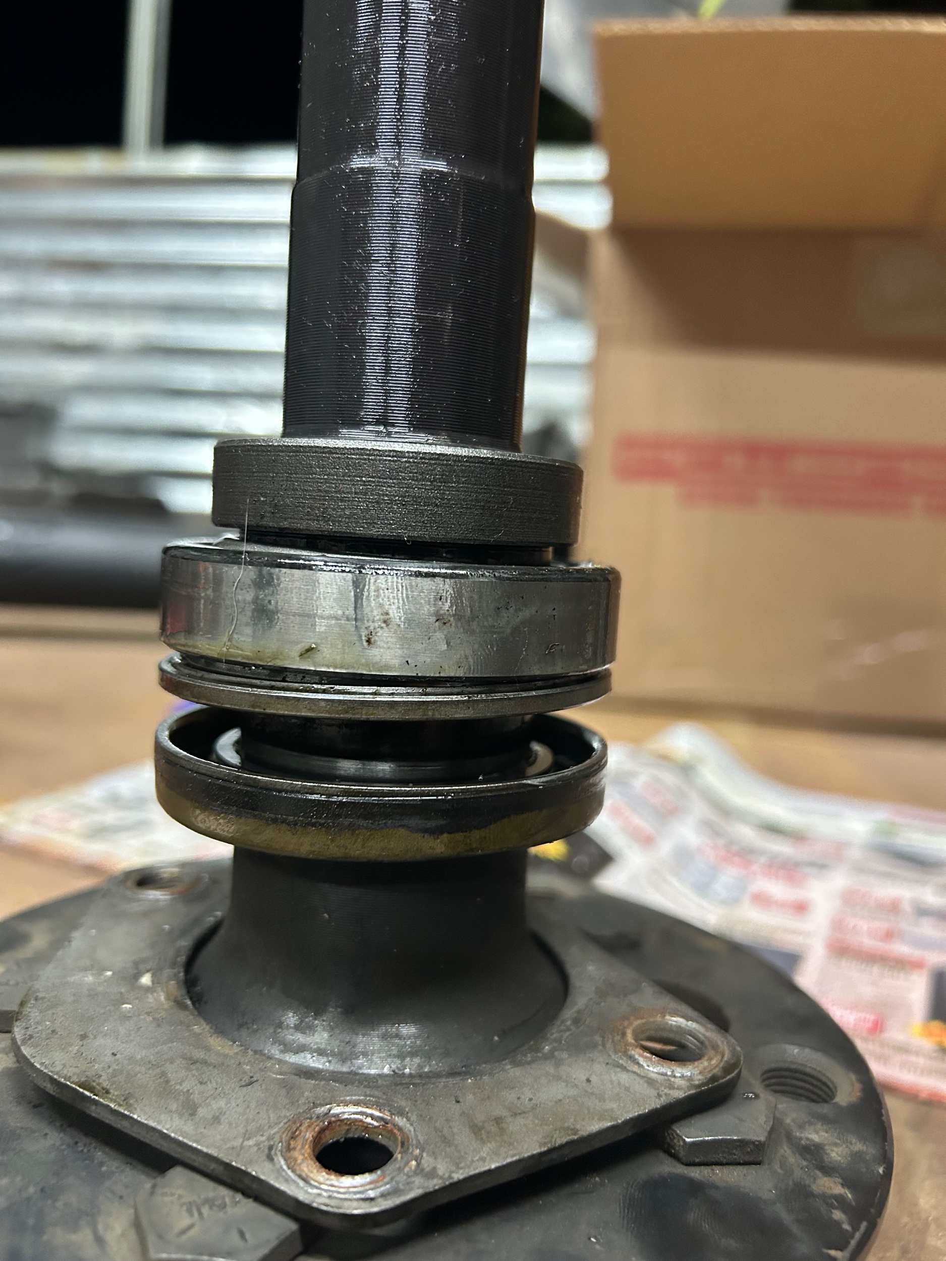

I don't know what the blown up bearing looked like, but the one above has no obvious issues related to how it was assembled. They are obviously aftermarket axle shafts so I'd ponder if something is amiss there. Barring anything obvious, install it back in the housing and see if there is still end play. I've seen a few oddball situations where the race had to be shimmed out to stop the play.

There was no leak , I heard a rotational noise while backing into the garage so I jacked everything up and the only thing I found was the movement in the axle shaft ends. I honestly didnt measure it but there was movement and I was under the impression that there wasnt suppossed to be any at all. When i pulled the shaft I thought the bearing was bad as there was a ton of movement in it and the the lower ring was seperated from the bearing. Is that normanl on the bearings? Maybe the slight bit of play is a normal occurance?
The bow in the retainer points to it having the appropriate amount of preload on the bearing. That top ring being loose is nothing. The shoulder registers it back into the thin edge of the race when it is installed in the housing end. I'd get it back into the housing and get a more accurate idea of how much end play it has. I never see zero after some miles, but more than a 32nd or so would be concerning.
