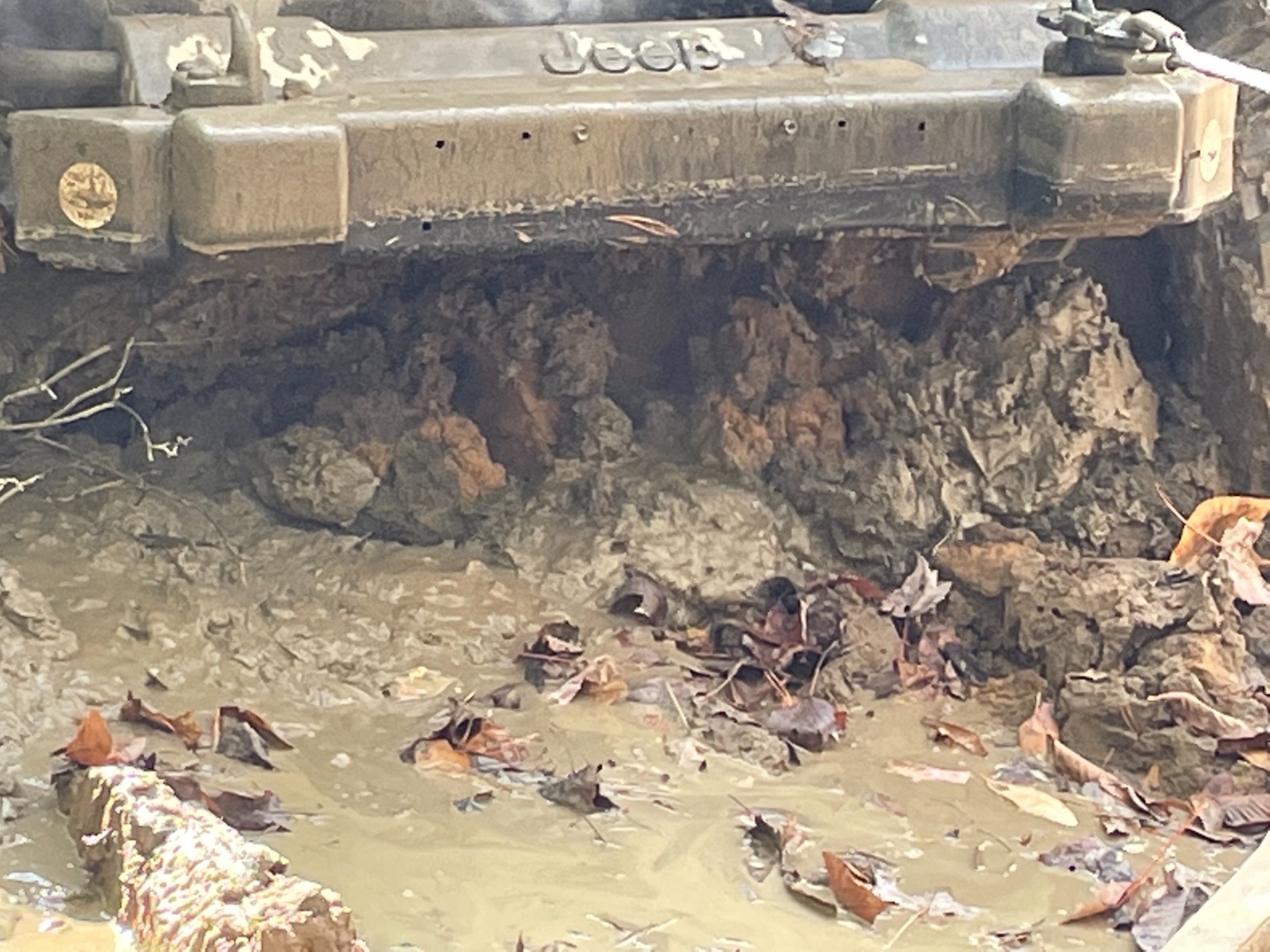

You dig the rear end into mud at all? Had an issue with a soft pedal after mud that caked my rear drum completely freezing it.
Uh ... Yeah lol

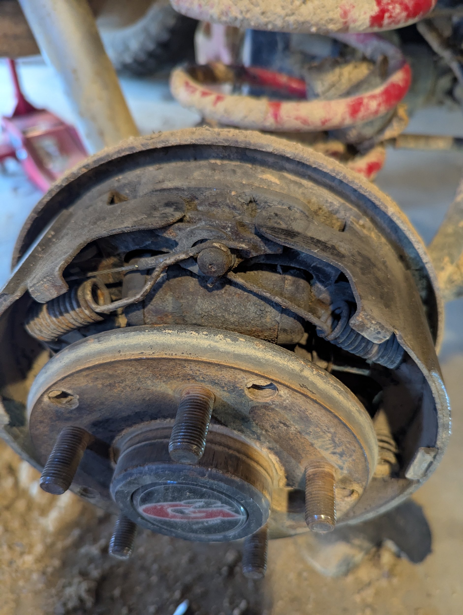

Well, I pulled off the drums again, I'm not sure what the PO meant by rebuilt but I'm pretty sure they're full of shit:
There's no way the shoes could have worn over 50% in the last 2k miles. Gonna get a rebuild kit and go from there, unless anyone else has any ideas.

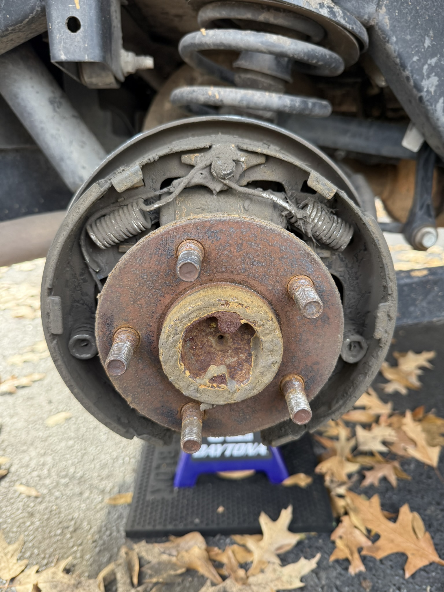

This was my passenger side it was totally frozen. It was honestly just easier to replace it all instead of trying to troubleshoot. Also adjusting them tight made the pedal feel great, engages right away.
