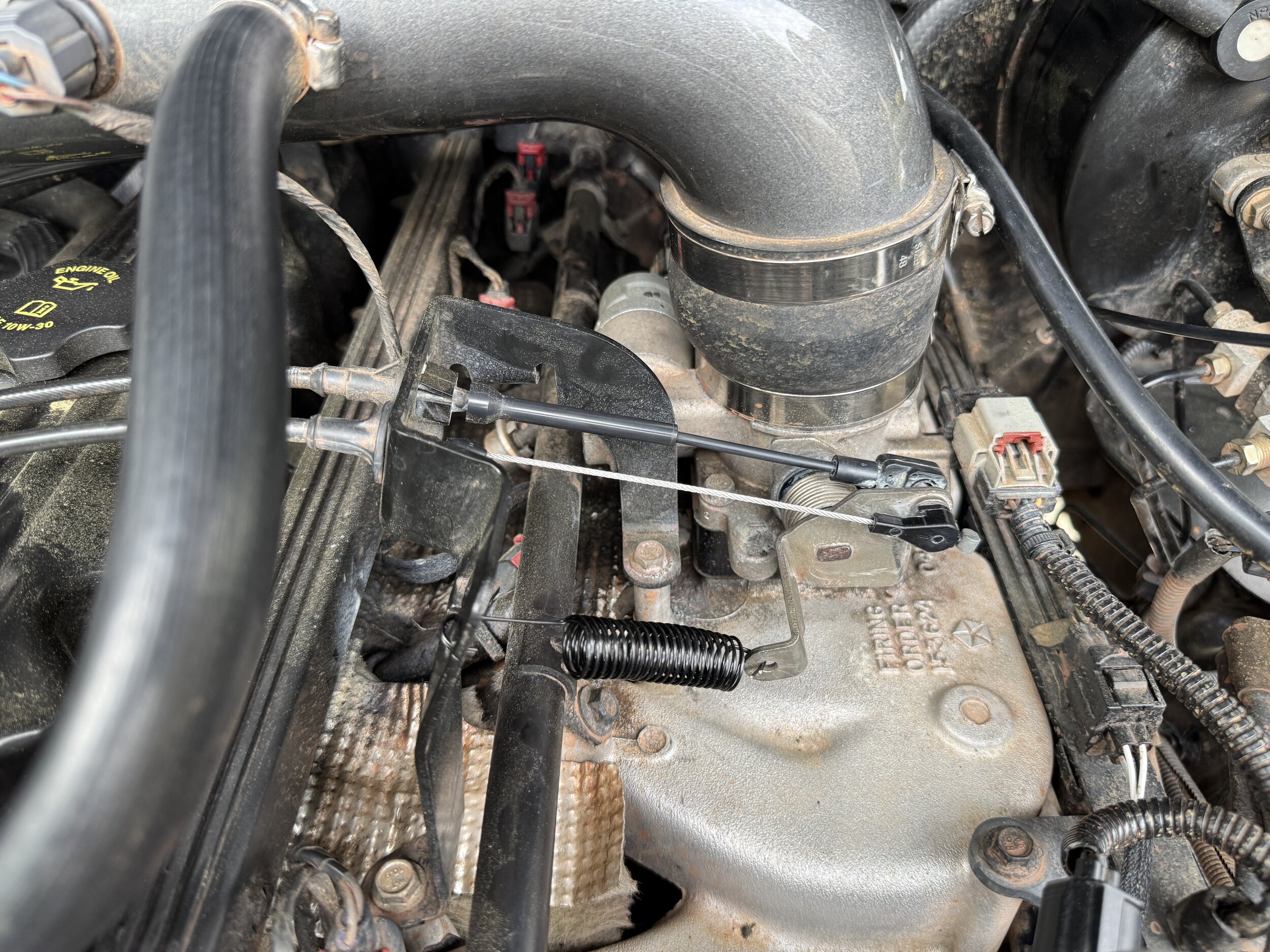

Manually lifting the pedal and reducing the engine RPM indicates the throttle is not closing fully by itself. Check the throttle return spring first to ensure it’s there and connected to the proper points. If that’s OK, check the operation of the throttle body to see if it’s binding, then check the cable itself for smooth movement.
I went to the local auto parts store and grabbed a pack of generic throttle return springs. I attached one, as seen on the ‘04 and prior TJs. The TJ is running like a champ, no RPM surges. I suspect the organic TB return spring is tired…it has 172,000 miles on it.
Thanks for the assists,
Rich
