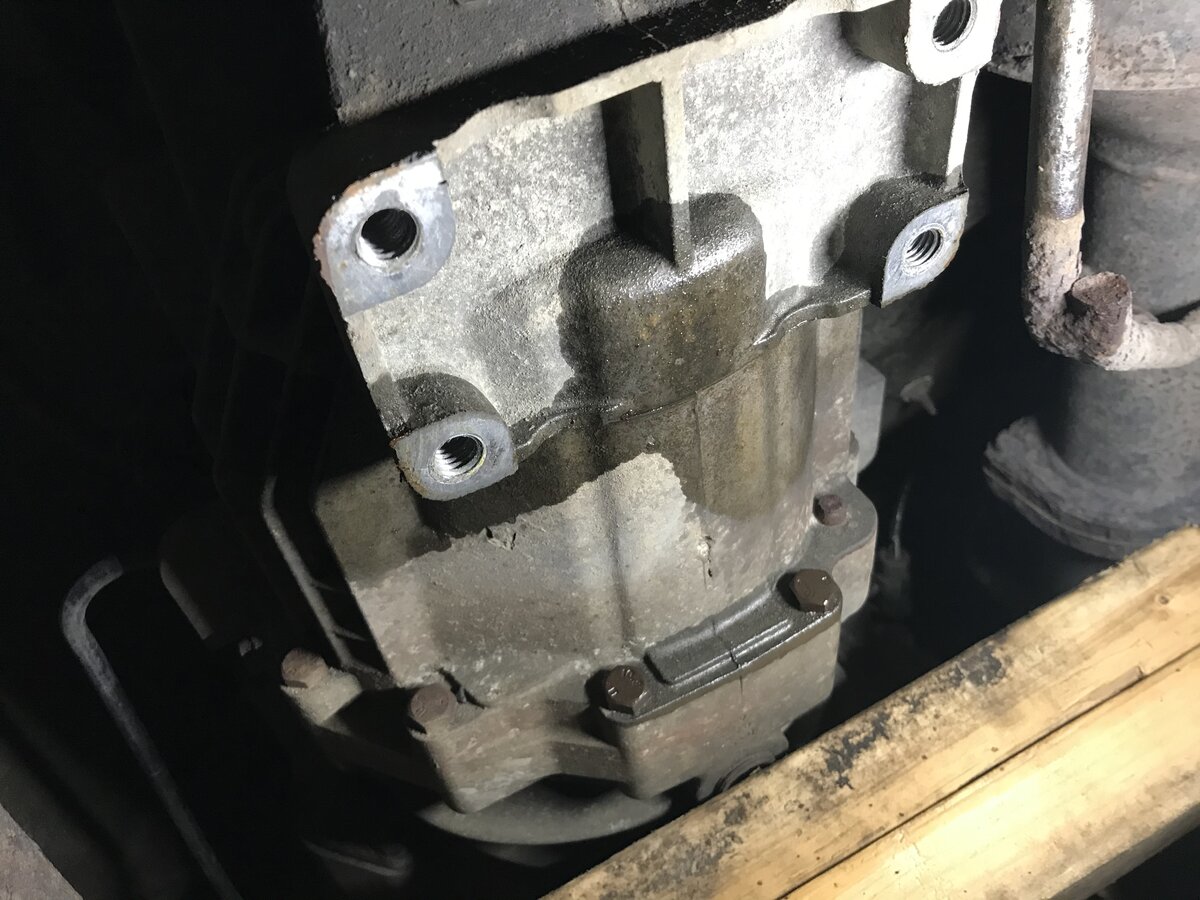

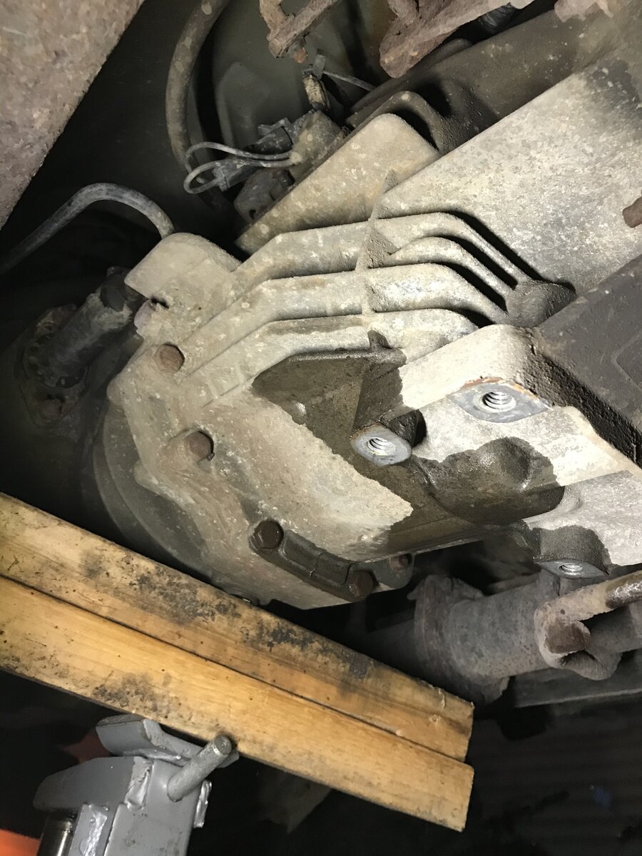

I’m back again for help.. changed the fluid in my transfer case yesterday and noticed my skid plate had a very thick oil on it that spread outwards from my transmission mount studs..
It doesn’t look like the tranny splits there though, so I thought I’d turn to you guys for help..
It’s an ‘00 tj manual, 4.0.
-shakeyjake
The pictures are a little deceiving...
I would check the filler plug, and the reverse light switch...
For the leak to be the vent... your transmission would need to be over full.
Are you having any problems with the hydraulic clutch slave cylinder?
