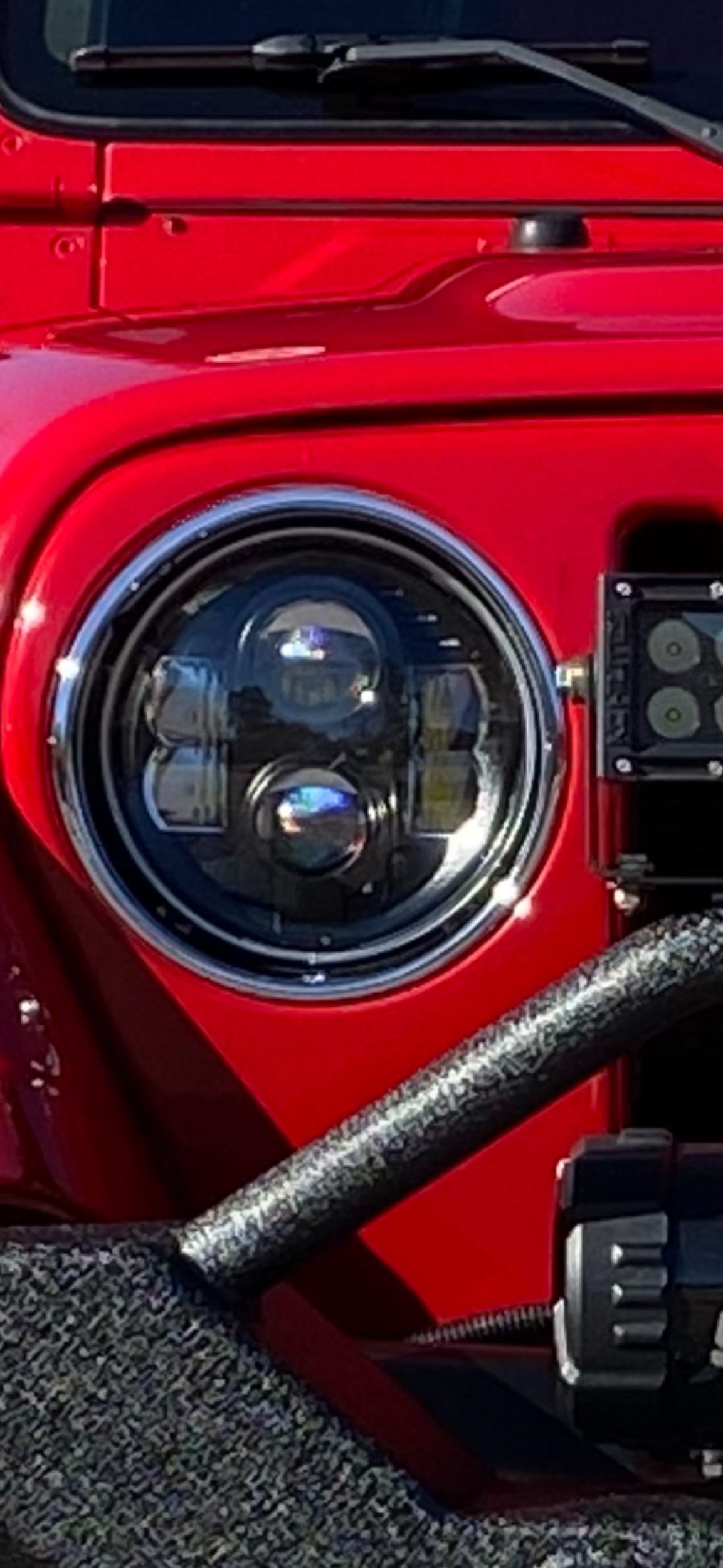

Howdy. I'll be replacing my headlights soon due to the ones that came with the Jeep having an odd projection and just not being very bright. For whatever reason, the PO cut the headlight connector and spliced into the lamps themselves. I've researched lights that you'd need to do this with and don't see much. So, for that reason and just out of curiosity, does anyone know the brand of these lights? No labeling or etching on the lens or backing from what I see.

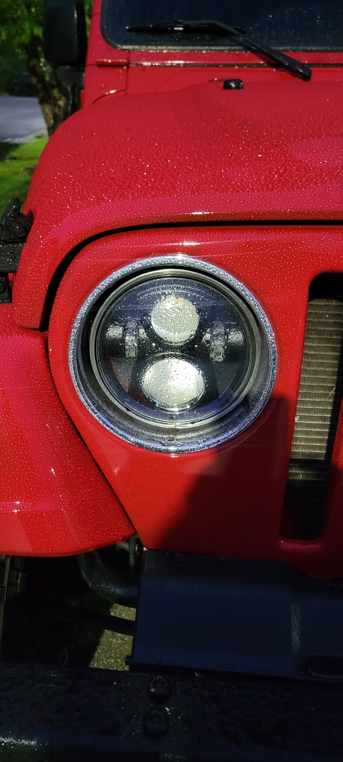

I could be wrong, but they look like my Pro Comp LED headlights. I can’t remember the model number. I’ve got no complaints with mine. They’ve been great.

Not being a Nay-Sayer, but there are probably a gajillion lights that look like that.. but suck. By design.
With no name, logo or other indication as to origin.. my next move would be to trash them.

I think the safe assumption is that if they don't have some sort of brand marking on them anywhere, they're Chinese knockoffs. That doesn't necessarily mean they're bad, but they are what they are. Mine has some that I'm unsure of, possibly Raxiom, but they're bright as hell and for LEDs I don't get people flashing at me.

The headlight connector was cut because the PO did not opt for the optional H13 to H4 adapter.

SKU
EXP76402P
DETAILS:
Specifications:
  • Intensity: 2,800lm (Low), 3,300lm (High)
  • Power: 30w (Low), 35w (High)
  • Input: H13 with included H13-H4 Adapter
  • Input Voltage: 9-32V DC
  • Traffic Pattern: LHD Only
  • Material: Die Cast Aluminum (Housing), Polycarbonate (Lens)
  • Light Source: Philips Luxeon ZES 6000K
Parts Included:
  • Headlights: 2x (One Pair) Pro Comp 7" Round LED Headlights
  • Wiring: H13 and H4 inputs, Integrated Anti-Flicker Modules
  • Warranty: Lifetime Limited
Compatibility:
  • Jeep Wrangler JK: 2007-2018
  • Jeep Wrangler TJ / LJ: 1997-2006
  • Jeep CJ-8: 1981-1985
  • Jeep CJ-7: 1976-1986
  • Jeep CJ-5: 1955-1983
  • Input: H13 w/ Optional H4 Adapter
  • Drop-in Replacement: 6014, 6015, 6016, H6024, and Par56
