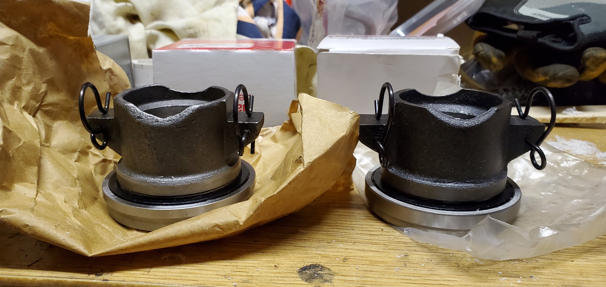

Use a Luk kit. Includes the TOB and a pilot bearing or bushing.
