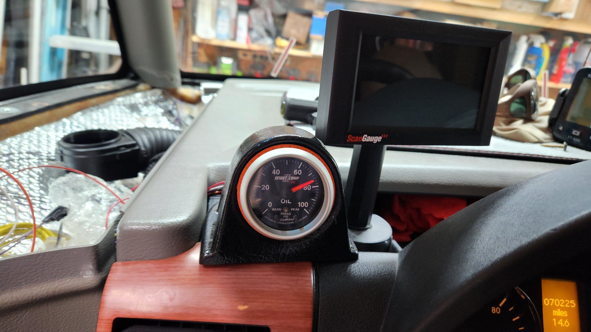

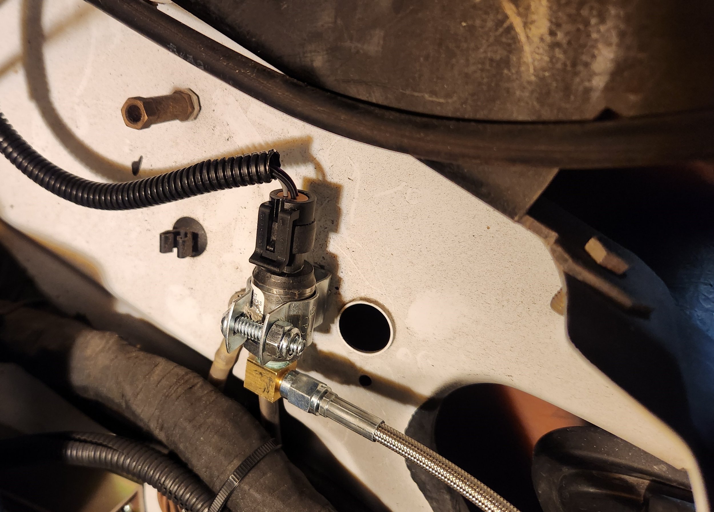

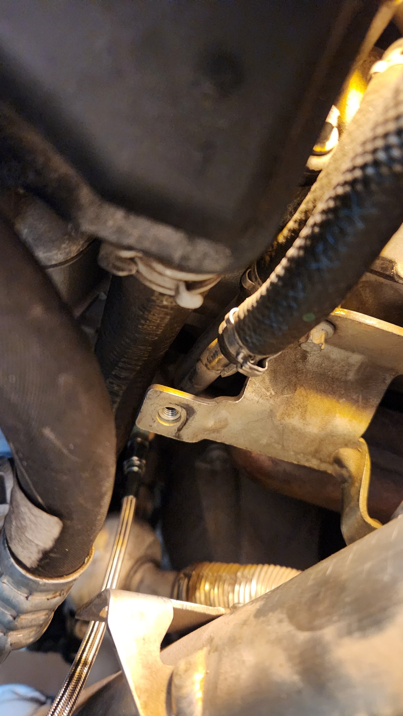

The V6 3.0l diesel that comes in the 2007-2019 Sprinter has no oil pressure warning system whatsoever. There have been a few engine losses due to this as there are a couple of things that can happen, resulting in the engine suddenly spewing out all it's oil in a very short time without the driver's knowledge. (The oil pressure on these engines can reach 110PSI)
A couple guys on the Sprinter forum found an oil galley plug buried behind the down pipe and hooked up a gauge. I ran a steel braided high pressure line to the fender and mounted the sender there, away from the engine heat and vibration.
For the gauge I used an Auto Meter 0-100 PSI with an adjustable alarm setting. The alarm triggers a red light on the gauge but there is also a 2 amp output on the back of the gauge that can be used to trigger a relay, buzzer or other devices. I bought some cheap halo lights and took the LED ring out of one and filed it down to fit around the 52mm gauge then painted it to match the dash lighting.
Now if my oil pressure drops below my set point I will know instantly by that bright ring of LEDs in my face. Just waiting on a smaller pod to arrive that will fit nicely beside my Scan Guage III.

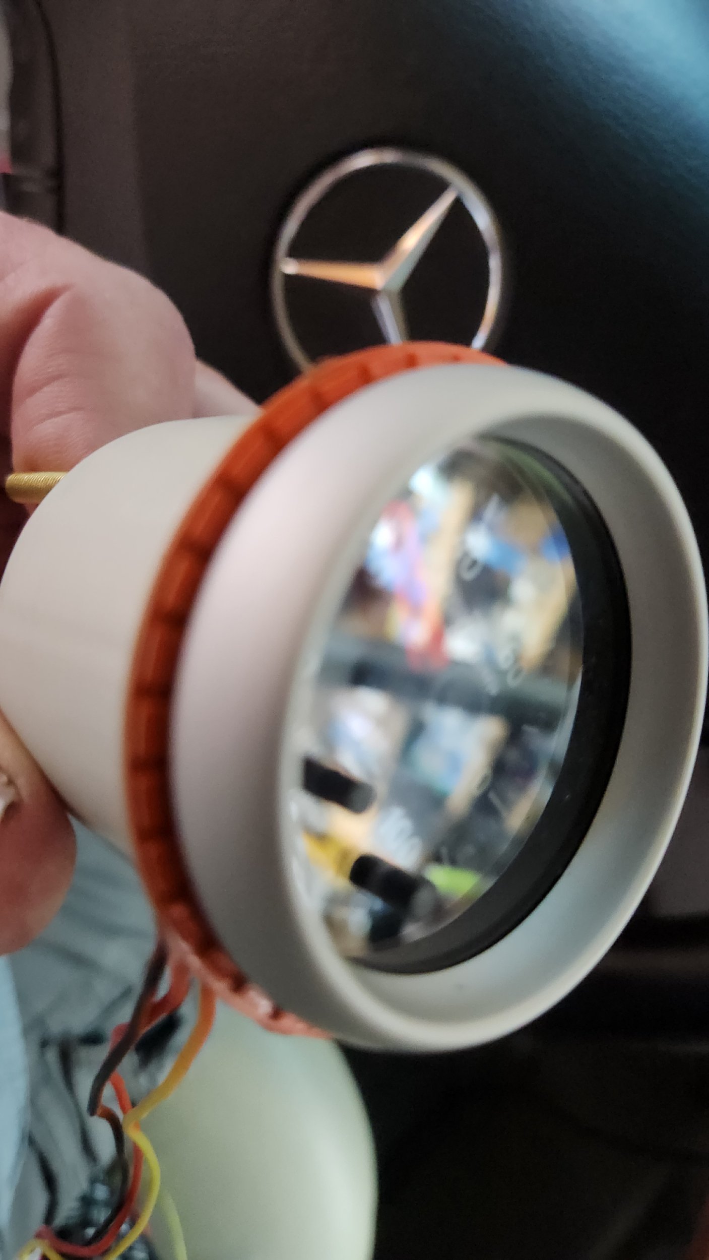

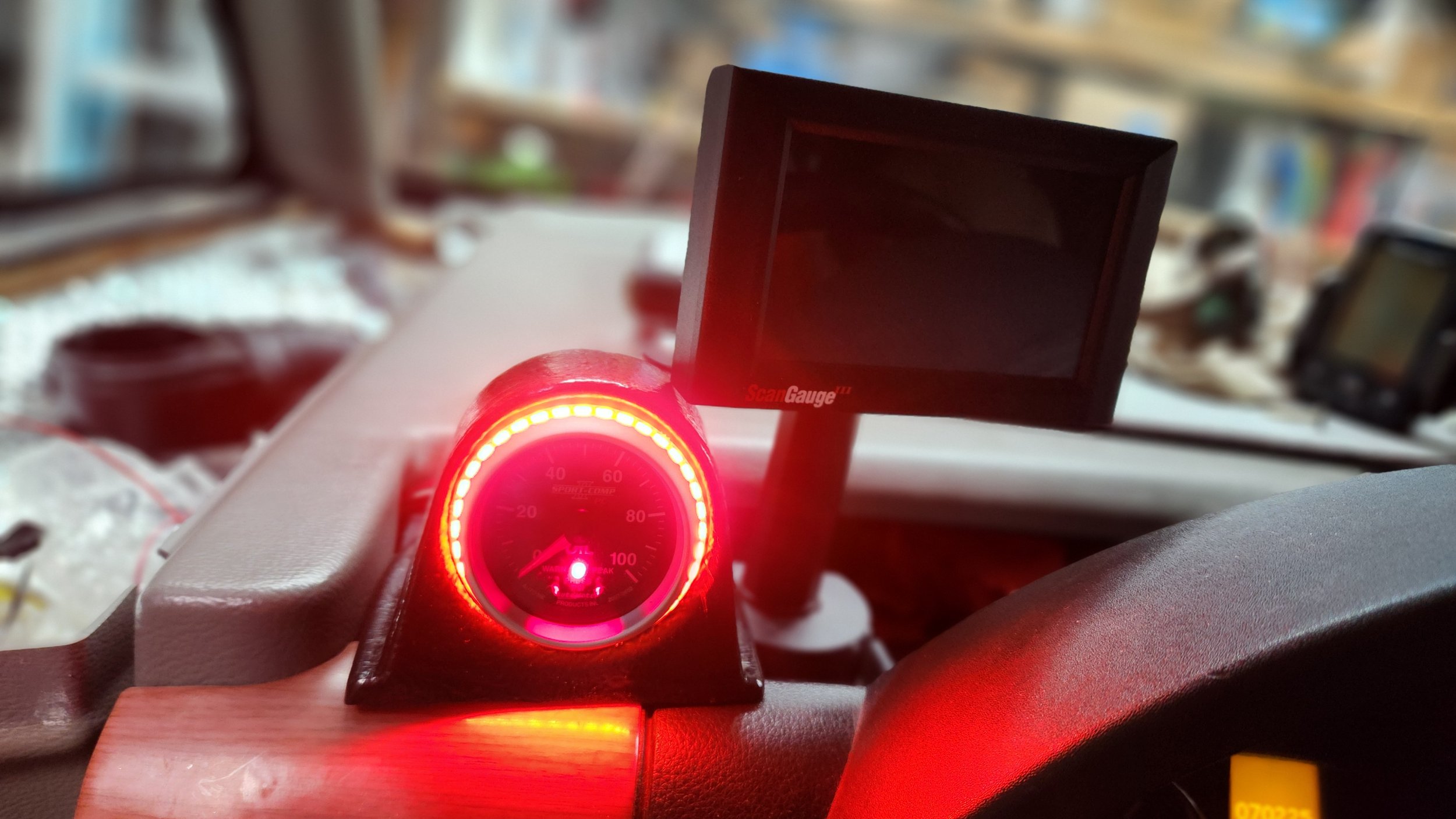

Very nice job ! , too bad you had to install a warning system that even a Kia has. In my opinion , MB has been living on a pre - mid 1970's reputation and making a ton of money from people who think they bought a top shelf vehicle . My kid's bought a 2003 Sprinter and traveled to Alaska and lived in it . The I-5 diesel was great , the automatic trans absolutely sucked and was very unreliable at 132000 miles. It was brain dead that the trans used special ATF that cost $ 25.00 a quart and had to be flown to Anchorage because it wasn't in Alaska. I hope your after treatment system plays nice with you , it gets real spendy when it doesn't . But again , great job !!!

Nice install on the gauge! I'll echo what @ColoJeep said about M-Benz. Sadly all modern vehicles and especially modern diesels are becoming a nightmare to own. I love diesel trucks but wouldn't touch a modern one with a 100 foot pole. I have friends with them that have had 5 digit repairs due to just the emissions systems. That can buy a lot of gasoline, and many of the modern diesel trucks get terrible fuel economy, so between that and the expensive initial purchase price there really is no benefit over gas engines like there once was.

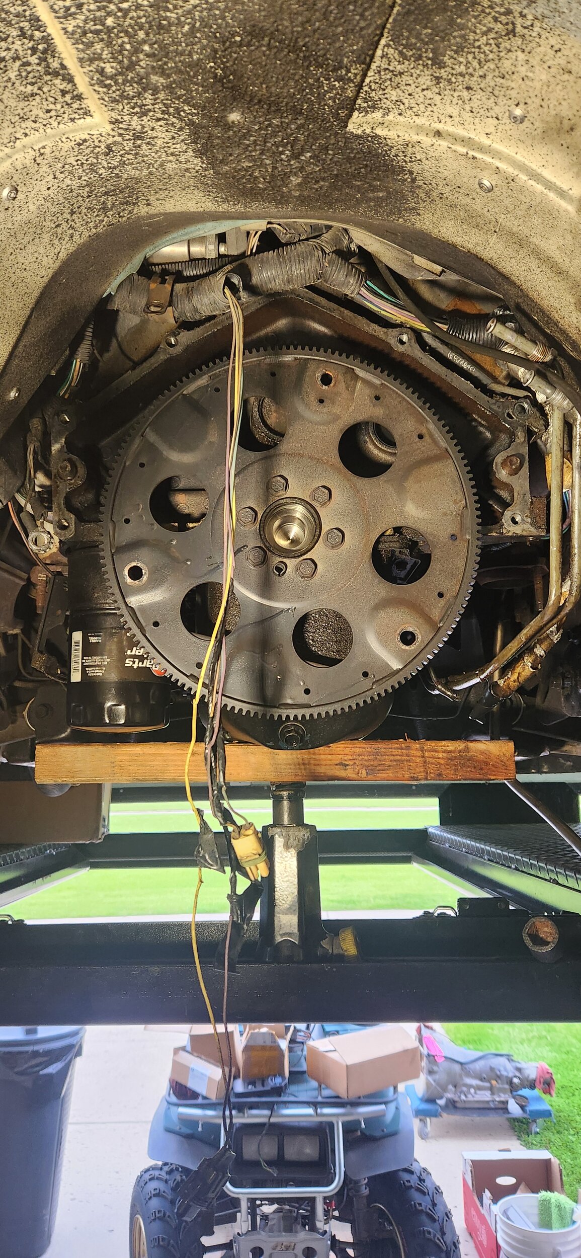

'91 'vette. Acquired car with known trans issues- all gears except park are neutral. Picked up a junkyard trans and R&R'd it this weekend and addressed other issues along the way.
Discovered the extent of electrical butchery in the trans harness. Below is the "before" photo. TJ jack puttin' in work. A replacement pigtail was installed using solder, shrink wrap, and split-loom tubing.
Other accomplishments not visible in the "after" photo.
Trans: replaced torque converter/input shaft seal, new filter & pan gasket, swapped speedo sensor between old and "new" units, flushed trans cooler and lines.
Engine: replaced rear main seal, cleaned oil pan and replaced gasket, oil filter, O2 sensor, and fuel filter. Got lucky and extracted a broken exhaust flange stud using heat, a crayon, and hammer-on stripped nut remover. Replaced some brittle split-loom with new split-loom. Finally, got the exhaust system mocked up.

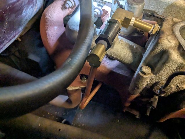

I told you that to tell you this. I added a crankcase ventilation system to the engine over the weekend. I did it for two reasons. One, I'm tired of the car marking its territory through the puke tube. And two, there are several oil leaks I cannot trace on the engine due to crud. We'll add a third reason. I'm getting more and more of my Dad's finger prints off of the car.
The military used the Chrysler flathead 6 cylinder for years and they were fitted with a PCV system. The system was offered as an option on civilian vehicles but there were few takers. There's an outfit called Vintage Power Wagons, https://www.vintagepowerwagons.com/ that sells the retrofit kit. It consists of an NOS cast iron manifold, a 3/8" steel tube, a PCV valve, and a whack of brass fittings. The guy at Vintage Power Wagon was pretty helpful and easy to talk to. Because I was doing this on a DeSoto and not a Dodge, I'd probably need to modify the tube. I did.
I couldn't locate any 3/8" steel tubing locally on a Sunday, so I bought a 10' roll of copper. Good thing, because it took three tries to get the length right and bends correct. Other than bending the tubing, it was a pretty straight forward install. I had to yank the carb and drop the exhaust pipe for access, but that was it.
The Rube Goldberg at the intake manifold.
The NOS manifold replacing the puke tube.
The stripes are from an LED flashlight with a low battery.

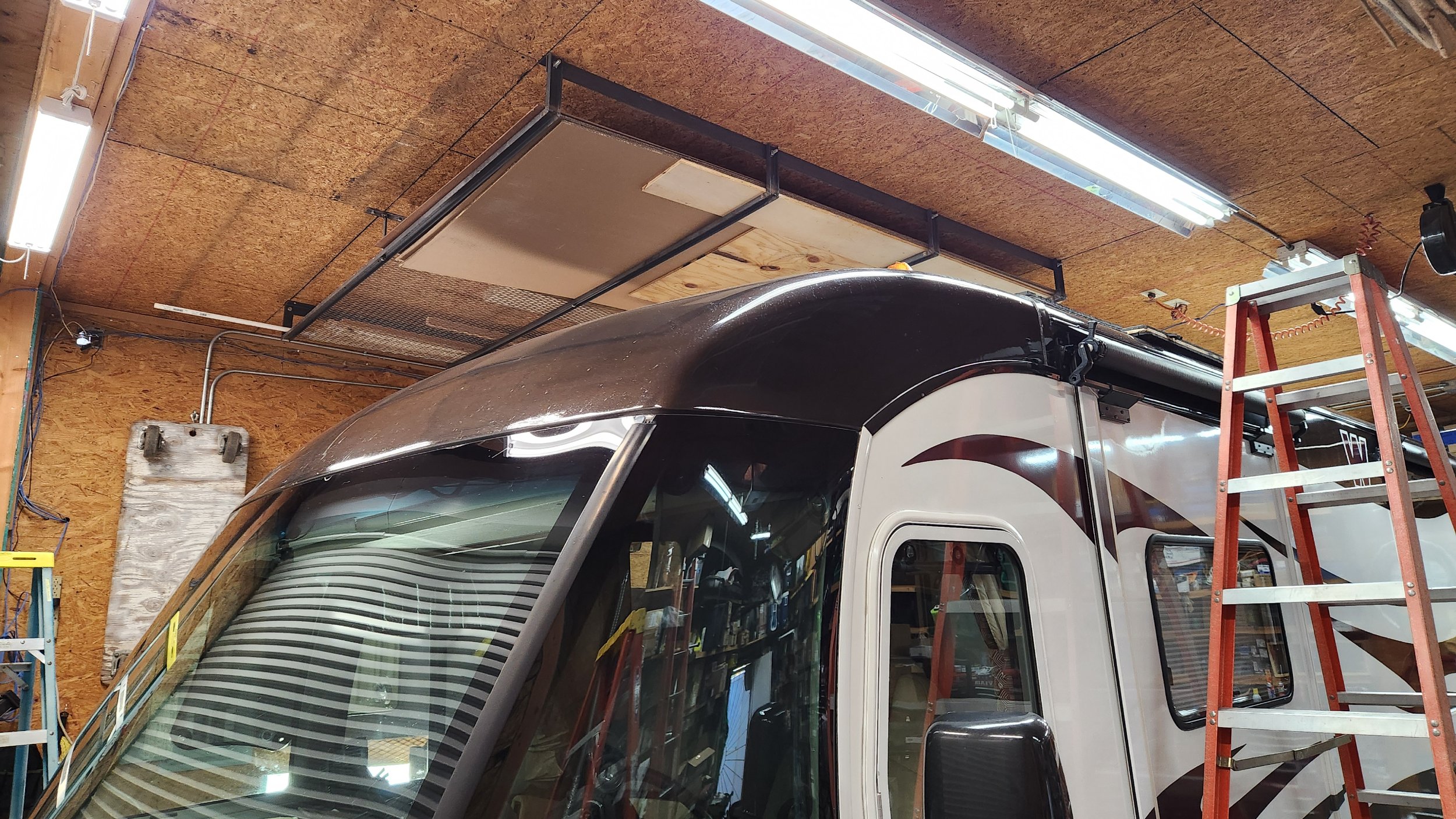

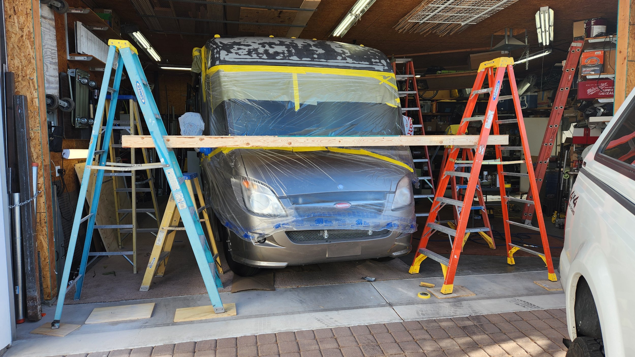

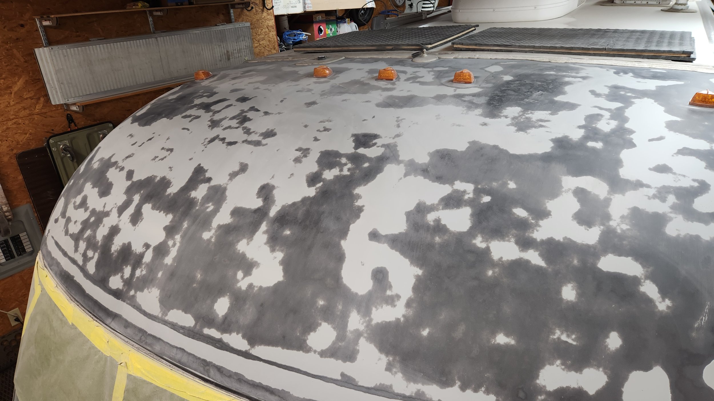

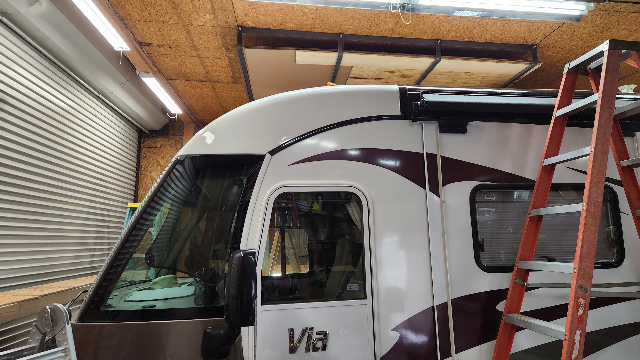

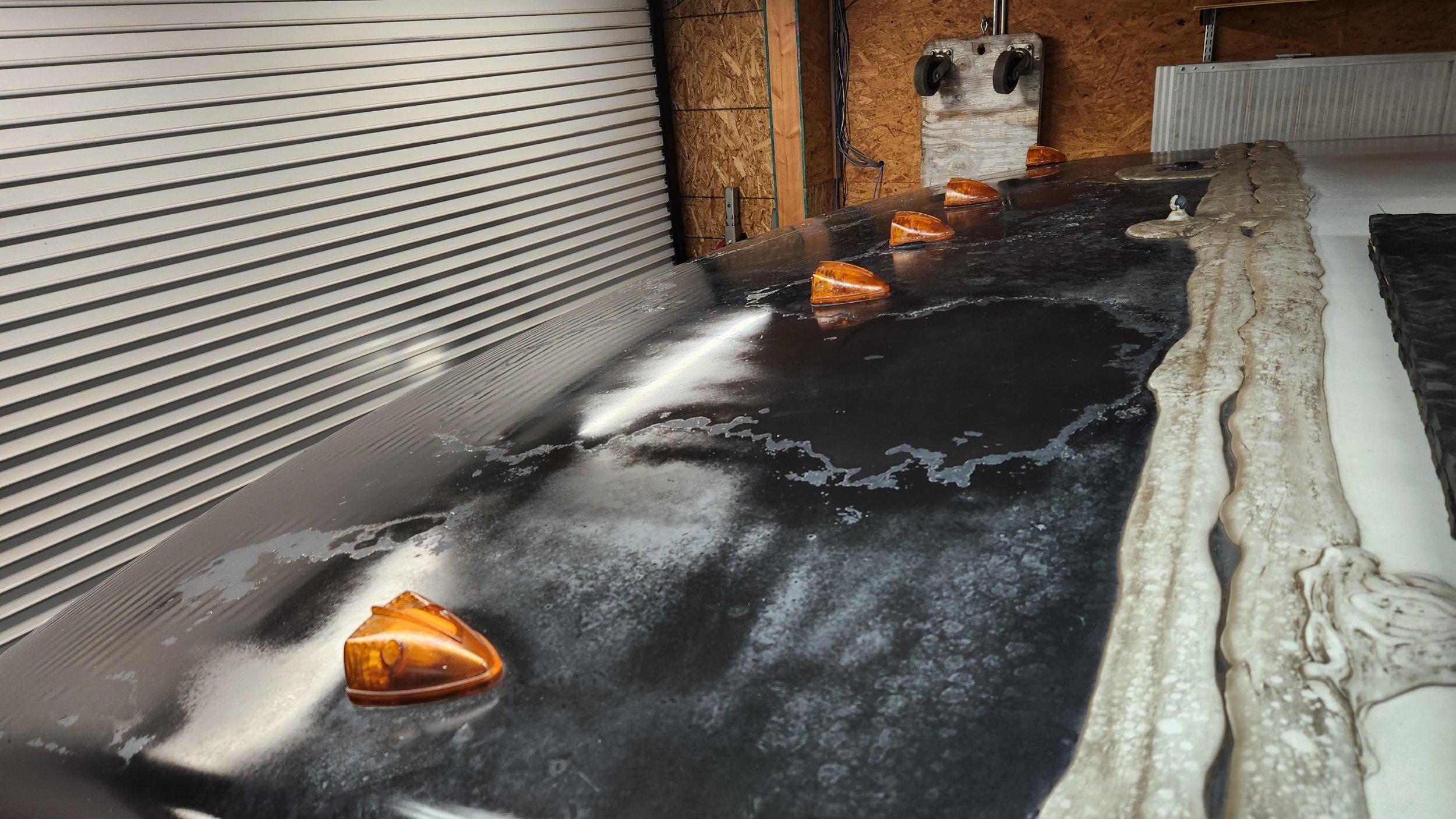

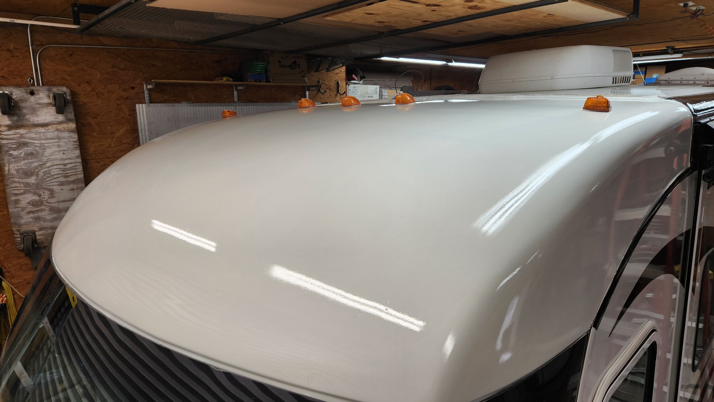

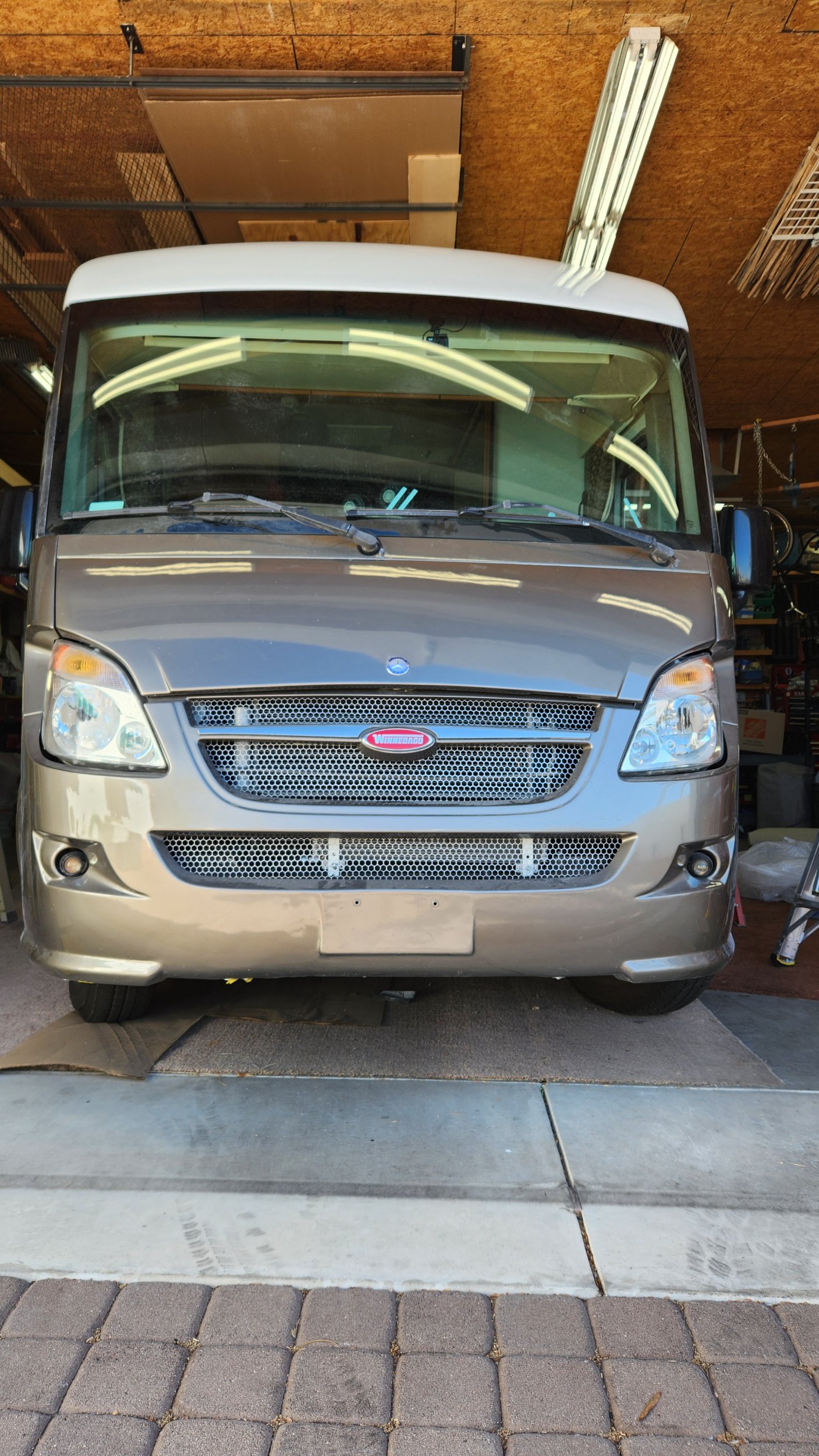

Decided to paint the cab roof on the motorhome which was in bad shape and dark brown which makes it hotter, the cab is our lounge when parked as the seats turn to face the other way and recline. 2 days of prep and then 2 coats of sealer, 3 coats of base coat and 3 coats of catalyzed clear coat. I parked it in the sun to cure and I can already tell the difference inside. Before, during and after.

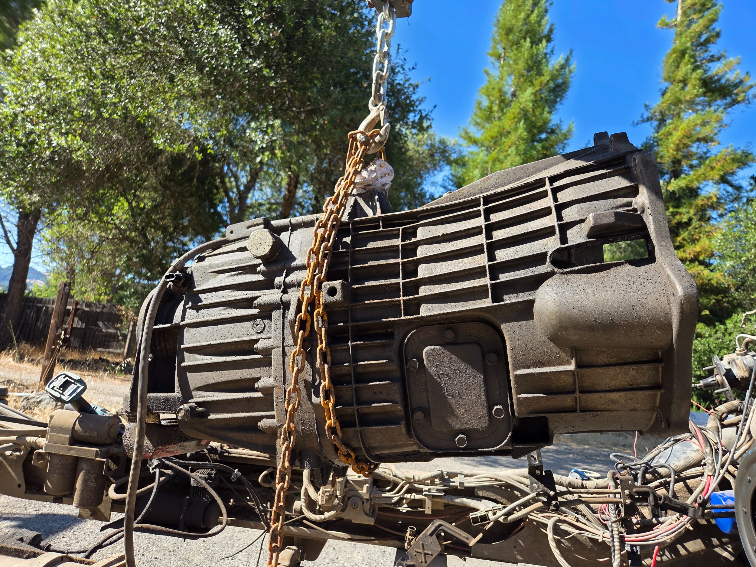

Pulled this big SOB zf6 out of my Chevy to change the slave/throwout. You know it's meant for a dump truck when it makes the Chevy bellhousing pattern look small..
I pulled the cab. No way was i going to get squished playing around under it
I've never seen a D-max that didn't have an Allison 1000 , Cool truck .
