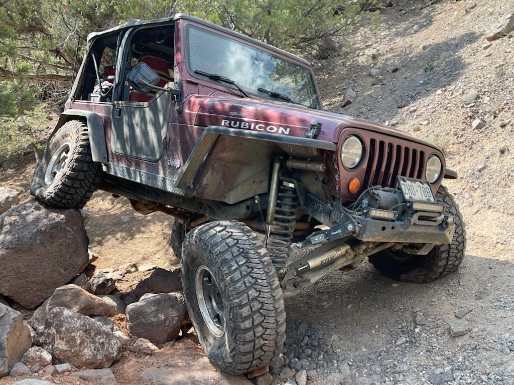

It is kind of funny that so much of what we do is the antithesis of ride quality. We jack them up, put heavy tires on them, load them down with a ton of armor - then wonder how to get the ride quality we murdered back.
Shocks will always be a compromise - most of the time on road vs off, cost vs value, etc... But without a doubt we can improve or destroy on this one. Tire rating matters, but probably far less than size and design. At least there are generally no trade offs fixing the stearing angles and drive train angles we destroyed with our lifts. While not directly comfort related-fixing the gear ratios that were messed up with larger tires will make driving more enjoyable (and to be fair, the ratios were probably off from OEM due to the Goverment getting involved first-tuning for an EPA rating rather than for actual driving).
Do you not believe me when I say something like this can have near sports car like handling? More than one might ever expect?
i said many times my old lift felt like sports car suspension.................................. and a brick off road. the balance is the tricky part.
tempted to send you my MC shocks to get that info into the mix, from an individual who's tested several others. but i have a feeling they'd end up on the stiff end of your spectrum.
